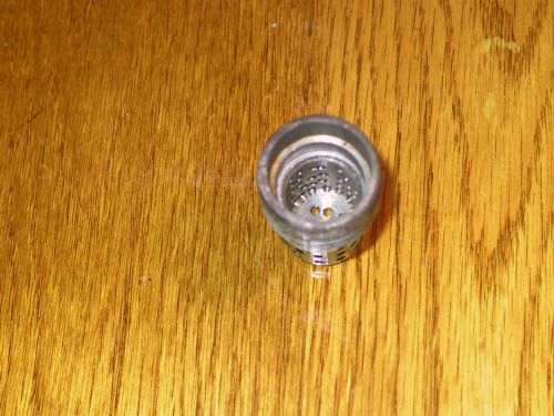

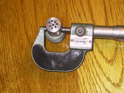

After much thinking and experimenting, here's what I've come up with (the part is not completed, this is what I've done so far) :

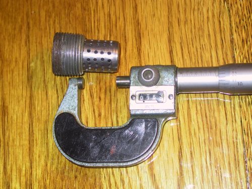

I managed to drill 70 holes, 1/16 inch diameter. The area is thus approximately the same as on a 1/2 inch hole. I suspect there's issues of dynamic flow that affect the equivalence (i.e. 64 small holes may not flow as much as 1 big hole, at certain fluid speeds) but this is what I will go with.
The oil lines are not going to be near 1/2 inch id in any event.
Here's a picture of the fitting, as it is now, from the inside.

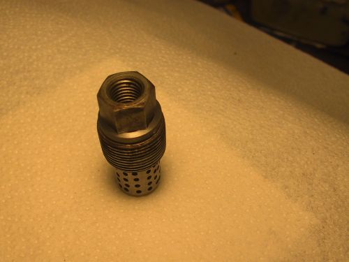

The threaded portion I made by removing the upper side plug on a spare tranny and machining it. I used the upper one, because there's no magnet in it and it was simpler.
Here's an end view.
I don't understand how the original part fit (it is visible in one of the links above). The portion with the strainer appears to be pretty long, and there's limited depth available at that spot inside the tranny. I'll post more pictures to illustrate that in the morning.

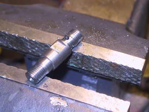

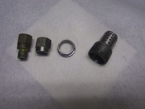

To exit the drain fitting, I made a collar and modified a fitting that I had. The fitting is whole on the left and sawed off next to that. Then a collar I turned to make the parts fit (If I had thought this one through ahead of time, I would have made a smaller hole in the plug). Here are the parts.

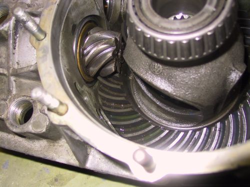

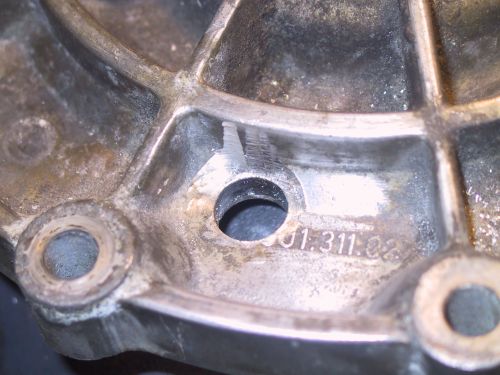

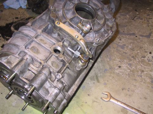

On to the next fitting. I got to work on the nozzle to spray oil on the pinion gear. First I did a quick assembly to see how the pinion and ring gears mesh. I want to be spraying oil right below the mesh point, on the ring gear:
michel richard
post Mar 26 2006, 07:54 PM
Posts: 1,291
Joined: 22-July 03
From: Longueuil, Québec
Member No.: 936

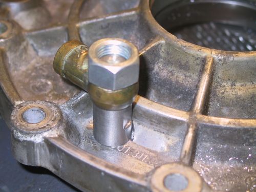

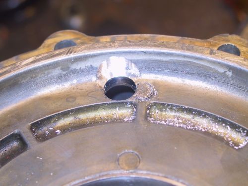

This let me figure out where to put a hole in the side cover. Once again, this requires some faith. I drilled the hole 1/2 inch because that's a tad larger thant the 12 mm thread I want to use on the fitting itself.
michel richard
post Mar 26 2006, 07:55 PM
Posts: 1,291
Joined: 22-July 03
Member No.: 936
And here's where the hole ends up on the inside of the cover:
michel richard

The webbing on the outside of the side cover makes it necessary to turn a fairly long fitting. The thread is 12 x 1.5 mm. I will braze or silver solder a small tube from the end of the fitting nearest the camera to reach the ring gear. Stay tuned. The part that goes into the side cover is a press fit.

Here it is, pressed in. I cut the fitting a little short, unfortunately, but there's not a lot of torque on the end nut. I will use a capnut.

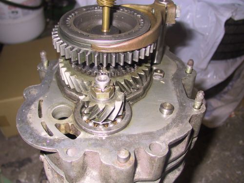

There will also be some oil injected into the tail housing of the transmission. I think the most important part here is to spray some oil onto the bearing for the input shaft, in the intermediate plate.
It's the ball bearings under the small gear in front of the picture:

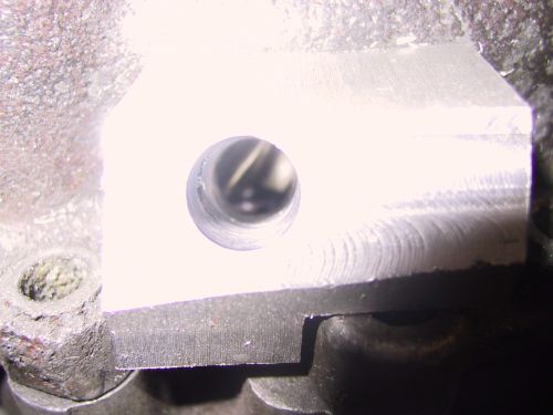

Member No.: 936
So I machined a small block of aluminum to support an oil squirter, drilled a hole through it and through the tail housing of the transmission for the squirter, as well as a couple of holes to run screws to tie everything together.
Here's the view down the hole for the squirter. It's not the clearest, but the best I could do.
The gear that can be made out is the first gear pinion on the input shaft.
