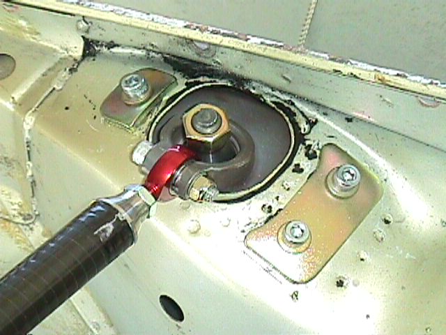

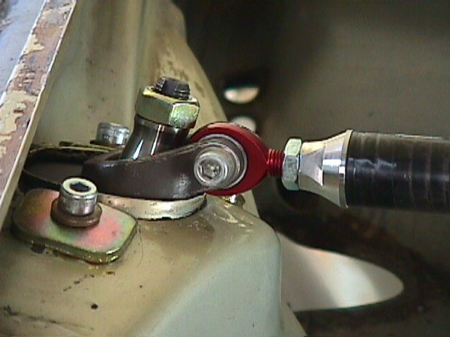

WEVO Camber King. Front strut top kit for 911's, a modified version also planned for the 914 crowd. The Ultra compact top plate is a heat treated Stainless Steel investment casting. Our top plate is lighter than the Almunium billet parts. The major advantage of the steel casting is the additional strength that allows us to make the unit more compact and shift the top bearing further inboard - for more negative camber. Maximum camber in an unmodified and un-distorted (an alarming practice becoming fashionable) 911 chassis is negative 2.8°. I am not sure how this would equate in a 914 chassis. With our cross brace attaching directly to the top of the strut - this is as pure an installation as has ever been available. Our manufacturing vendor is delivering product as I write this. Smart racing will be a major re-seller of the Camber King or come direct to WEVO. Retail price of the whole kit is $695, making it just $66 more than the Weltmeister alternative. The 914 version will be $515 without the brace, but with all the strut top hardware. You guys got to see it first, this is not even posted on the WEVO web site yet! Attached image(s)

Here you go JP. NO modifying of the 'tub' to get parts to work.
"leaked".. I gave you 30 more days (sorry) (IMG:style_emoticons/default/happy11.gif) The key to the WEVO setup is the smaller bearing they can use at the top. The other billet pieces HAVE to use a wide bearing insert which also has to have a wide holder. The wide holder always hits the tub first. This commercial brought to you by Nabisco (chew on that for awhile) B |

From the spherical surface where the strut top mounts to the chassis to the very tip of the damper shaft = 46 mm.
This is without the dust cover fitted to the Bilstein damper. With the dust cover it would be about 44 mm. It might be a little taller than stock, but is fine in a 911. We wanted to achieve the maximum damper travel at low ride heights. With this in mind, we located the bearing to suit. Is this dimension a problem for the 914's ? (at 44 or 46 mm??) We use a wide series spherical bearing, same size and quality we have been using in this application for almost 20 years (including cars with coil over struts where the weight of the car is carried by the bearing). The advantage comes from a more compact housing, not a smaller bearing. Regards Hayden PTBT |
