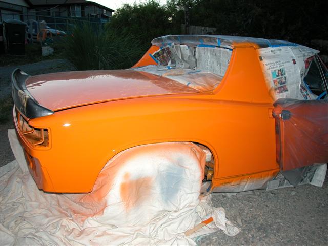

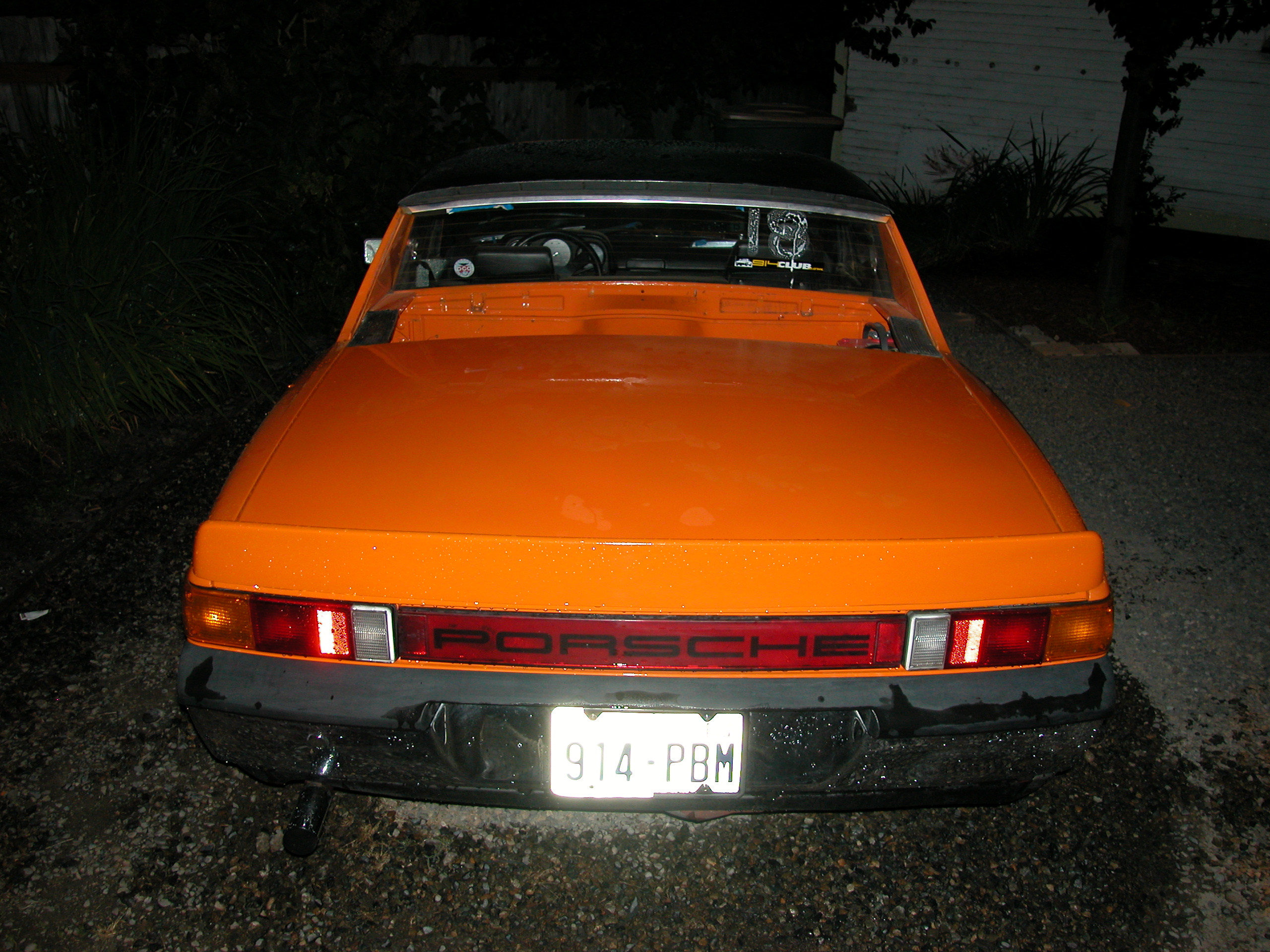

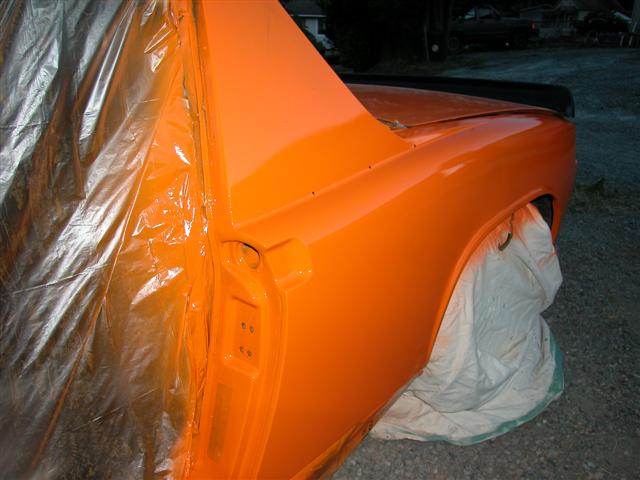

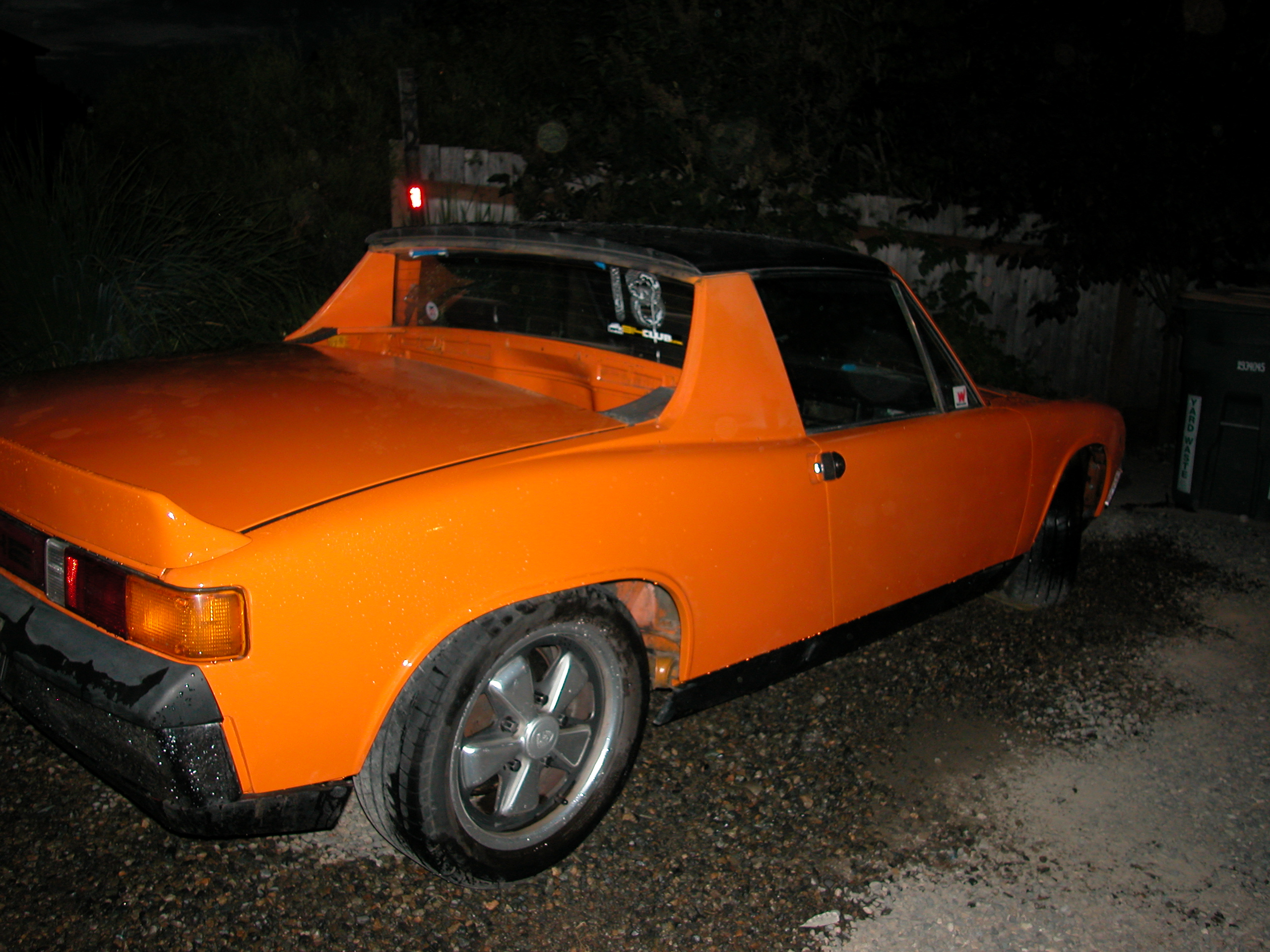

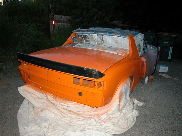

Well, WCC is only 9 days away so I decided to paint the car. Got started late but I still managed to paint the rear of the car but not the rear deck. Wow the new HVLP gun works great!! I didn't have clouds of paint flying around as it just goes right onto the car. Two quick coats after sanding and sanding plus alittle primer here and there. Well actually there was a lot of primer on the rear of the car cuz of my stretching out the rear fenders a few years ago so 15x7's would fit.
The next day I finished the front end but still have to do the drivers door.

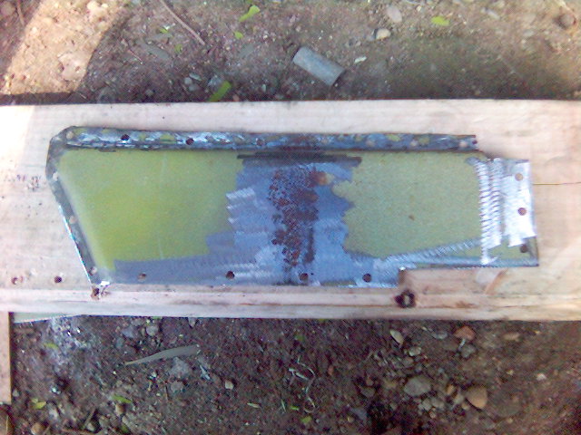

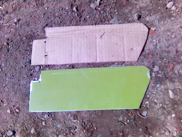

Blair finished up the hellhole but was having trouble fabbing up something for the passenger side rot spot. I made a cardboard template and then a metal piece. Then the fun began as I bent, pounded out, shaped and finally drilled 1/4" holes for the puddle welds. Fits good and Blair just has to weld in it.

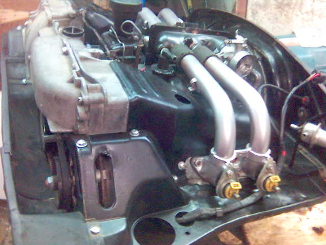

The 1.7L is now setup to go into the car as I installed the endplay shims, flywheel, seal, PP and clutch. The thermostat went in also so the engine is ready to go! Although it needs a 4 pin TPS to finish up the FI. The aircleaner and elbow came in from Mueller too.
We hooked up the LC1 and ran a bunch of test runs really nailing down the A/F mix on the MPS and now the car really has some power. Running thru the gears at WOT is a blast! blowup.gif

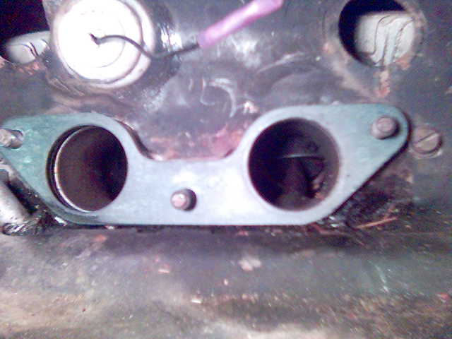

I torn apart part of the 2.0l and did a bit of checking and my feeling is that #1 intake valve has a dropped seat. The motor turns until TDC and the exhaust valve looks ok from the exhaust port. Still have to pop a valve cover or Blair will tear the top end down to verify the condition of the engine. Hopefully, the bottom end is good as the heads are pretty messed up from a bad mechanical shop installing new SSI HE's and the new flywheel, clutch and PP. These brand new parts along with the new unused starter made the purchase of the car a decent deal as thats a $1000 in new parts alone.
