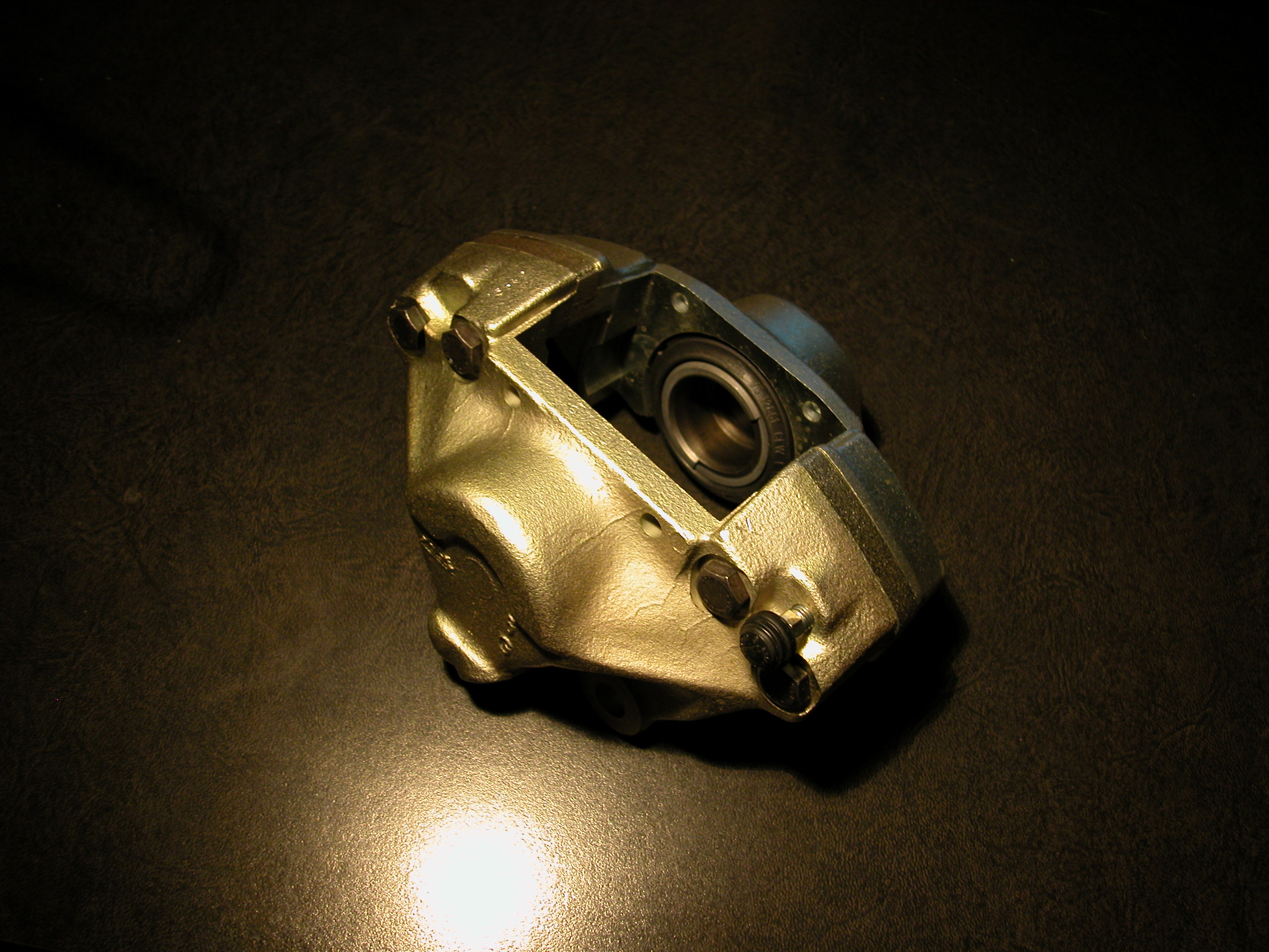

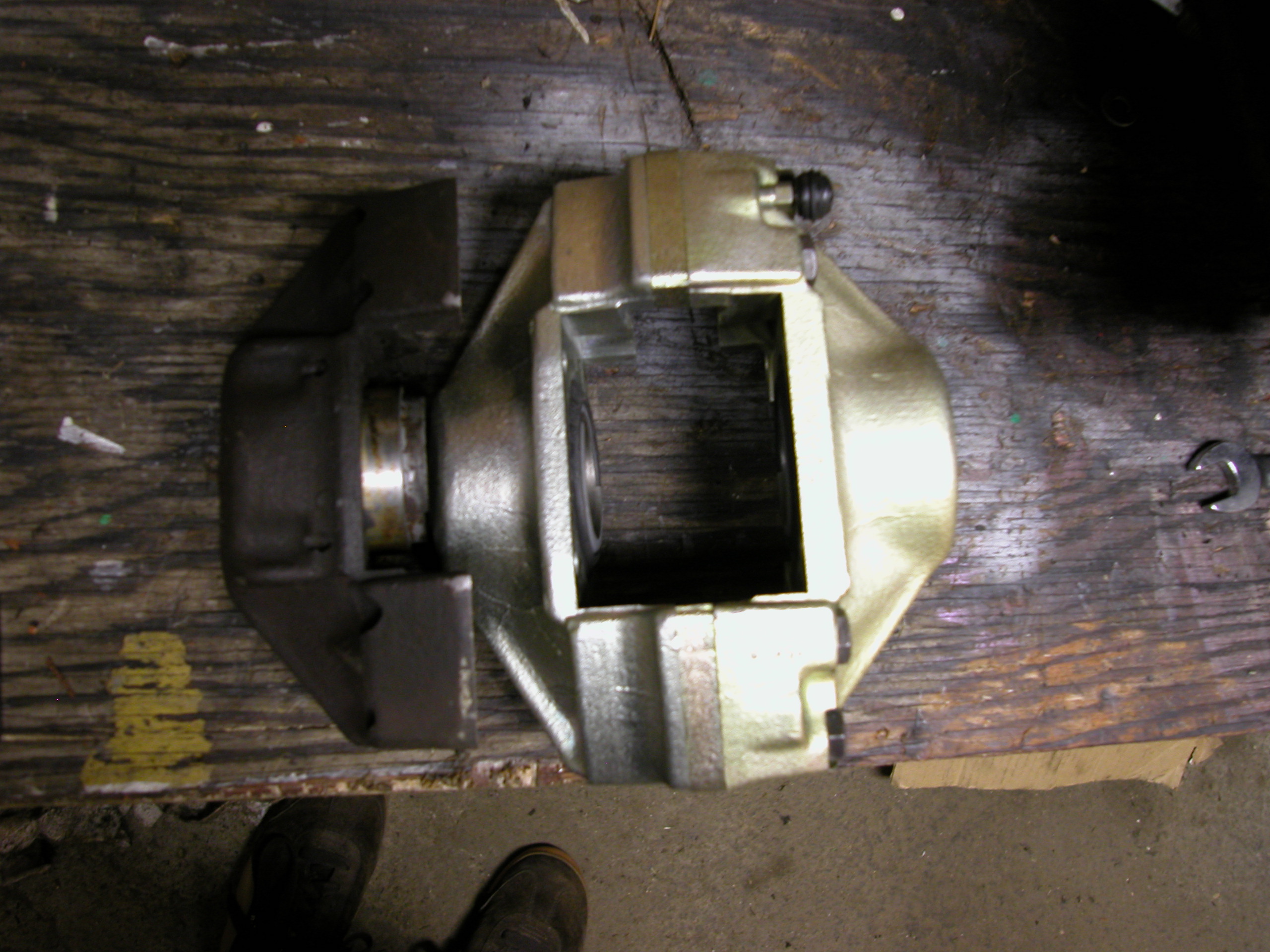

Ok, I tried out the new Carrera calipers and they bolt up just fine.
Damn, look how much bigger they are compared to the M caliper half.

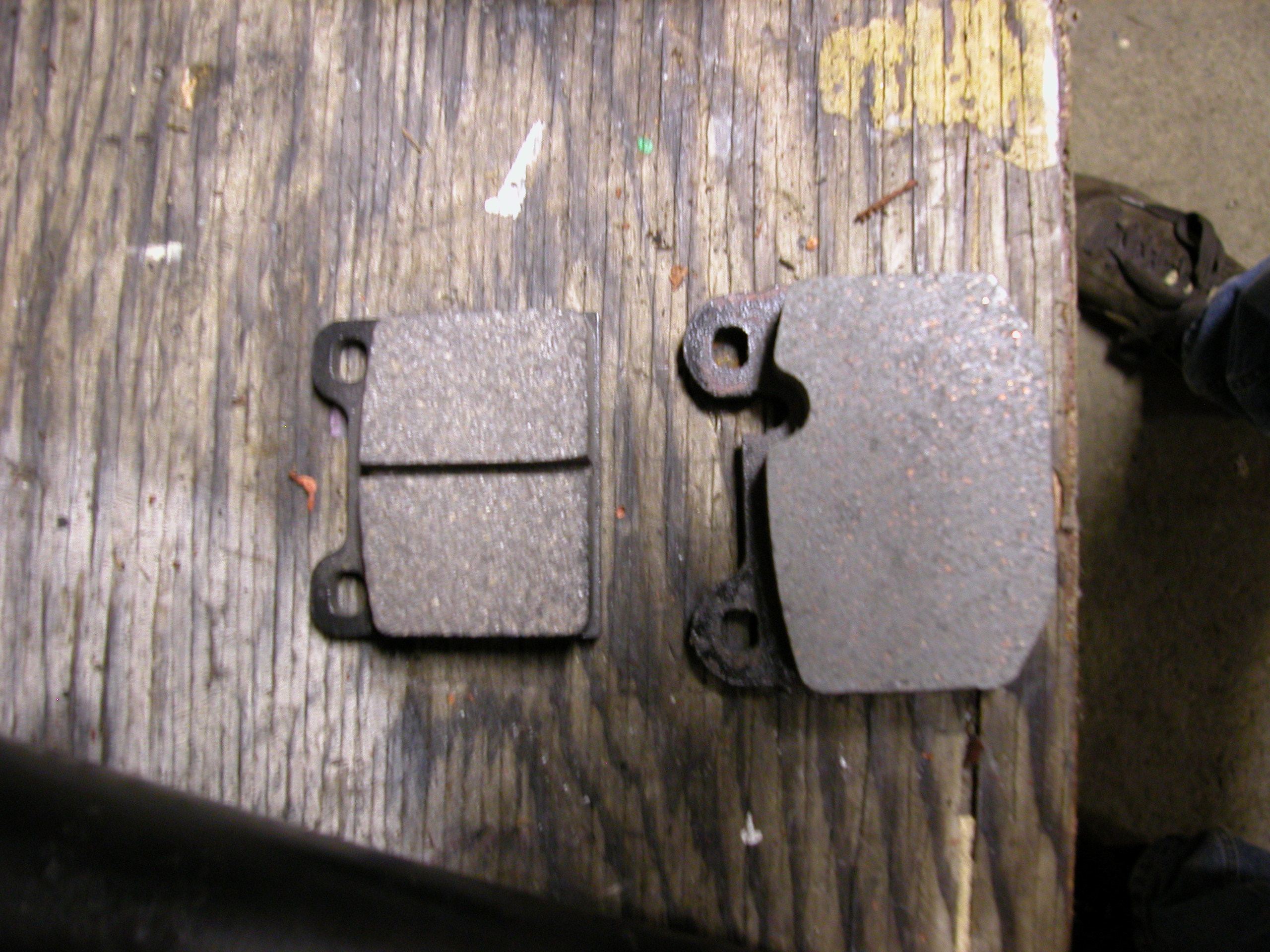

Then look at the pad difference! atleast 50% more pad!

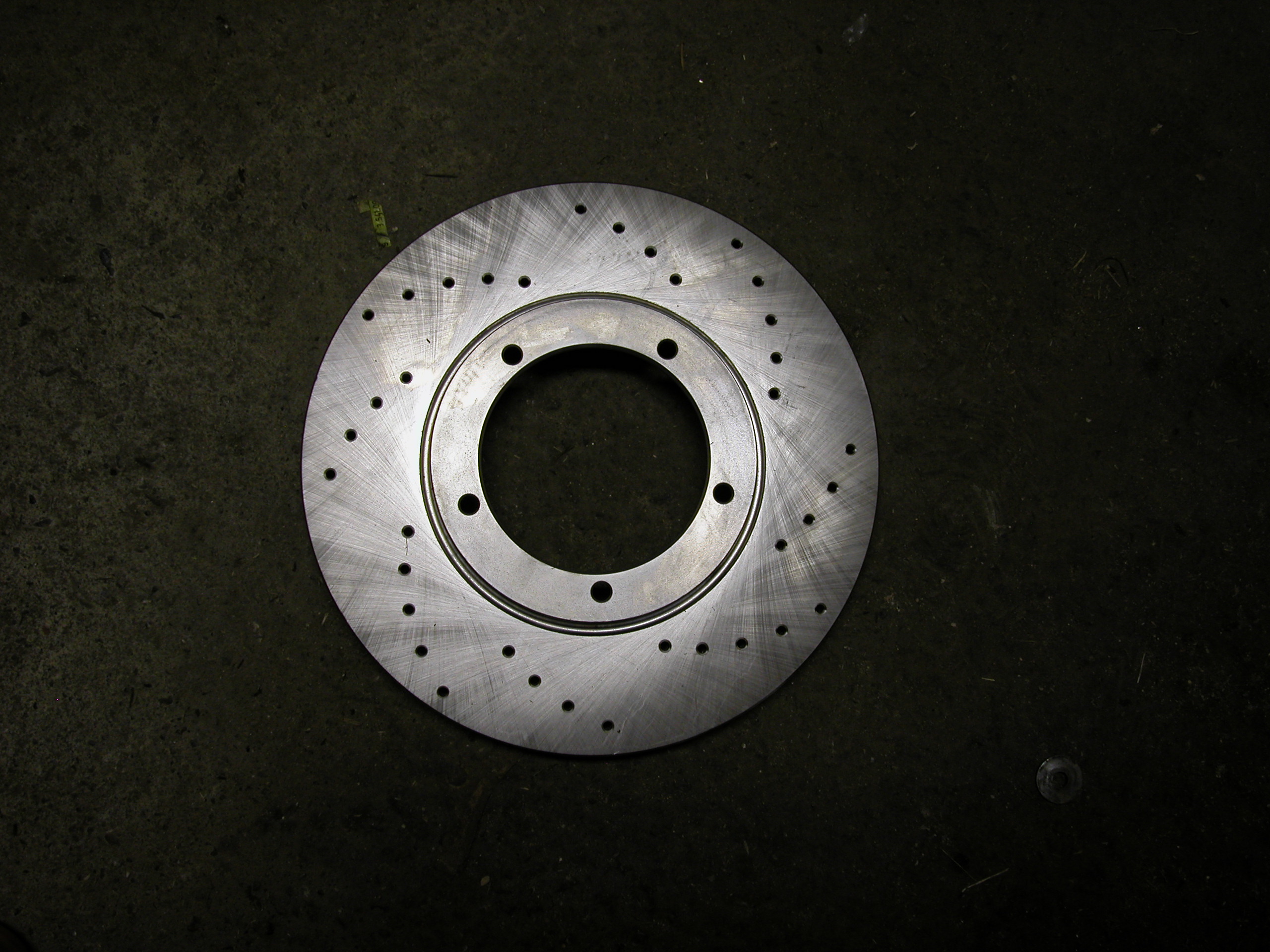

See the pic of the sweet drilled, vented rotor that these babies will run on.

Ordered a set of Carrera calipers for the front as they are " supposed" to fit my new struts. Can't wait to see...and try them out! Should be hella improvement in braking and with the vented discs I'll have no fading problems. Now to install the rear spacer setup and install vented rear discs. All in all it will be quite ricey with the 4 wheel vented drilled rotors. haha I don't care! flipa.gif 051103-stupid4.gif

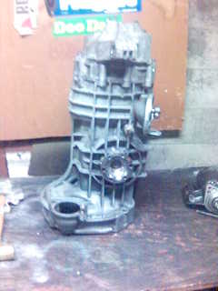

Finally got the paper gaskets today so I finished the transmisson. Blair and I switched 3rd and 4th gears to a set from a 5 speed 912 box so I now have a close ratio 914 901. Replaced the pilot shaft seal and set the shift forks today plus buttoned it up.
Now back to the engine assembly, which I need to install the FI, set the valves, Alt install and remaining tin.
Last week I repaired the battery tray which had ripped out the welds when I spun her. great! So I rewelded it back in.
I also will start on installing the new front bushings and the 73 911 struts with the vented discs and M calipers.

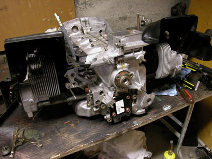

Well, its been awhile but I finally have the 914 block assembled with the new cam and 26mm oil pump. I have been test fitting the cylinders and had to order base shims to set the deck ht. Jake sent them and they arrived yesterday finally. I assemble the cylinders tomorrow and take more measurements and check everything again. I still have to set the ring gap, and install the pistons. Heads of course are sitting there all done waiting for installation.

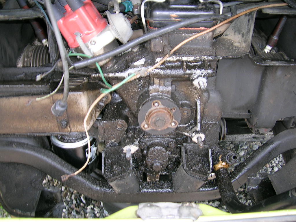

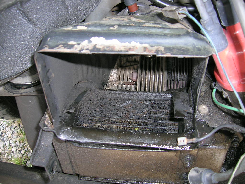

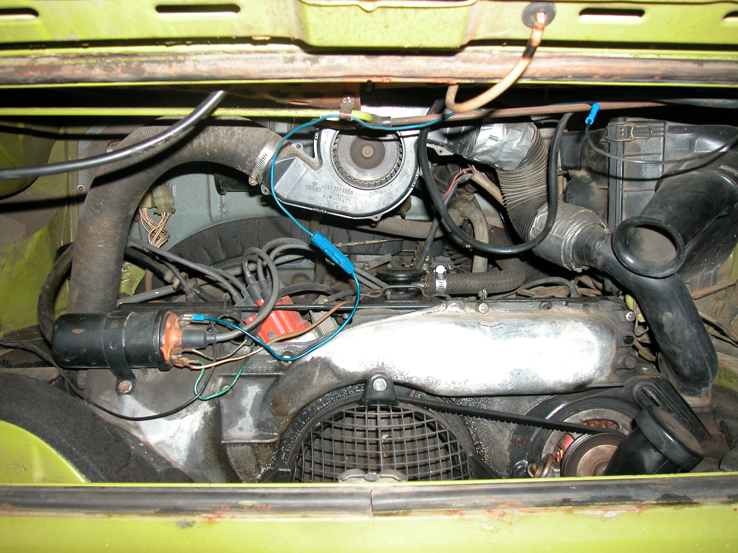

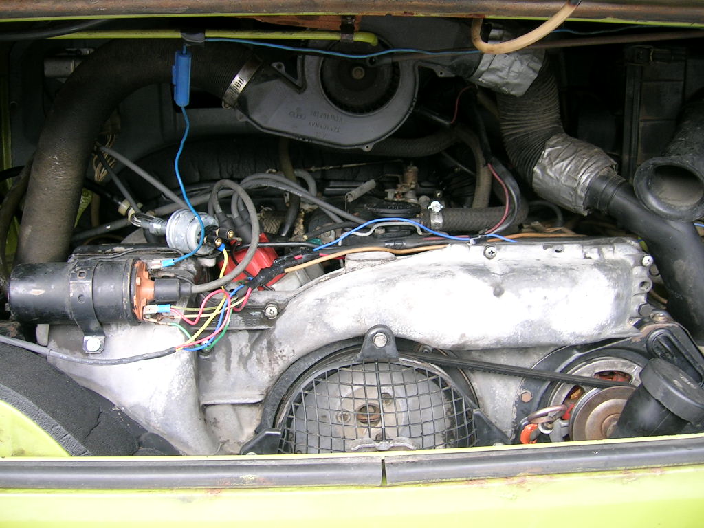

Sunday July 2 I spent 8 hrs tearing apart the engine to stop the oil cooler leaks. Cleaned the tin, resealed everything I could, installed the oil pressure hose, oil temp taco plate, CHT sensor and the gauges laying in the glovebox waiting for the 3 holes gauge plate.
New points cap and a rev limiter rotor plus new plugs and the Westy runs sweet!

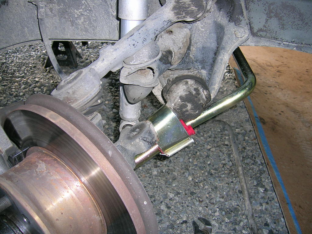

Tuesday, I installed the 5/8ths front sway bar and the new Boge shocks. God Damn what a difference driving it around. Body sway is gone, bumps and pot holes don't shake the whole bus to death anymore!! Wow, I am impressed.
