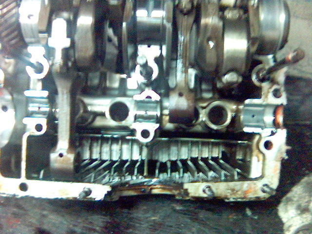

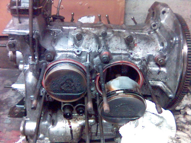

entry Mar 10 2005, 02:58 PM
Got the 2056 motor all broke down and I am pissed!!! here are some shots of the motor and you can see the local asshole engine builder left out something. No effin wonder I was having problems with oil sloshing on hard cornering!
I also like how he balanced the rods by grinding the bottoms!!WFT! I will completely rebuilt the motor myself now, looking at a new CW crank with type 1 journals so I can get different hipo rods.
