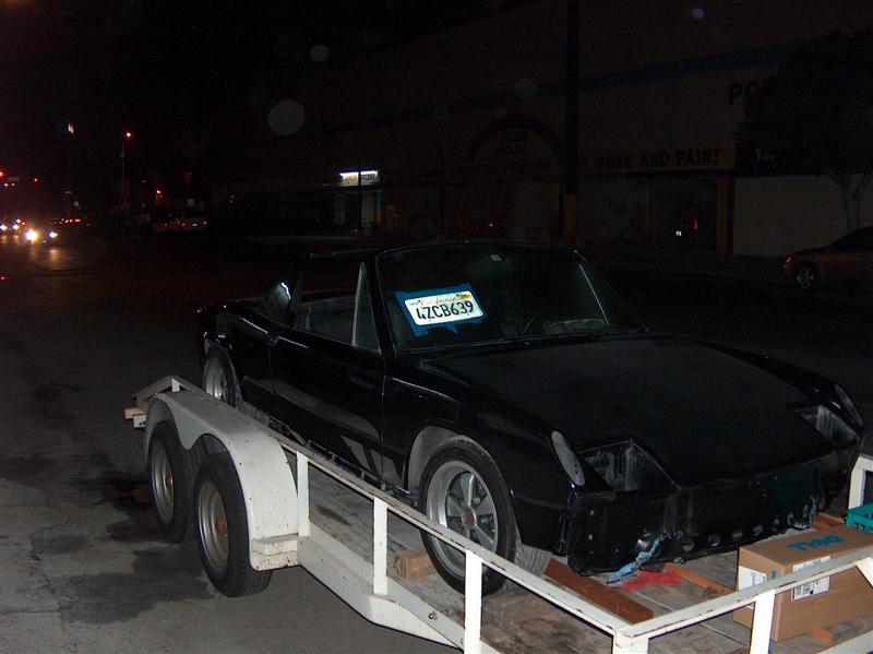

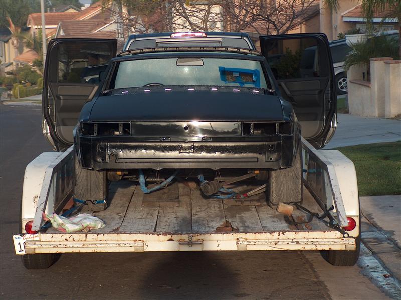

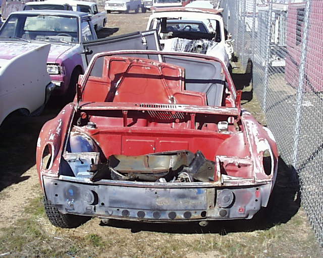

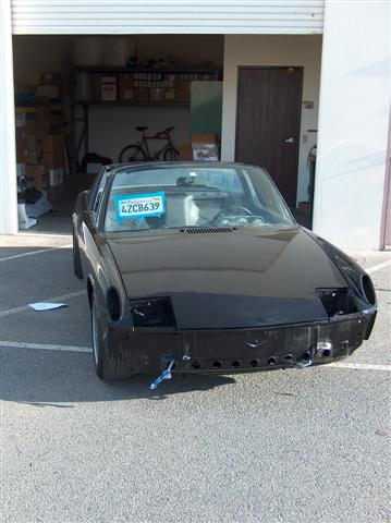

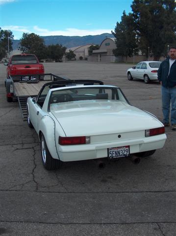

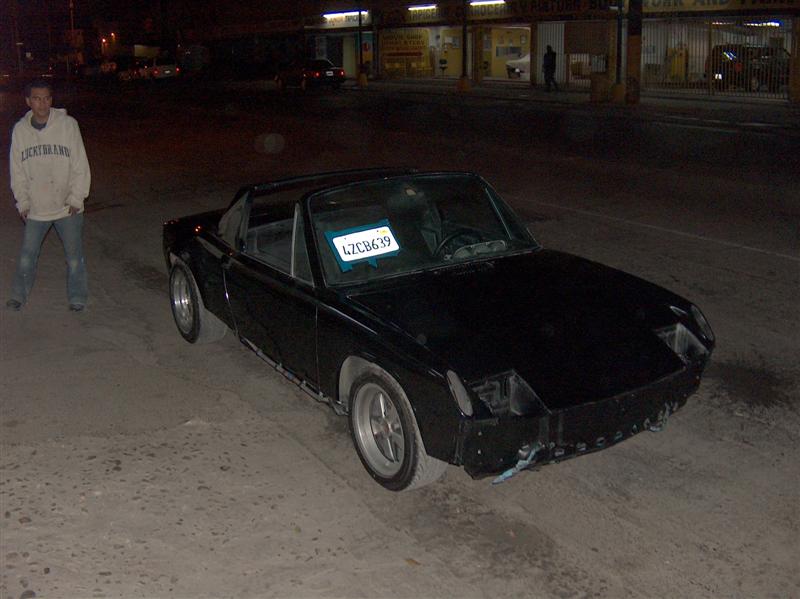

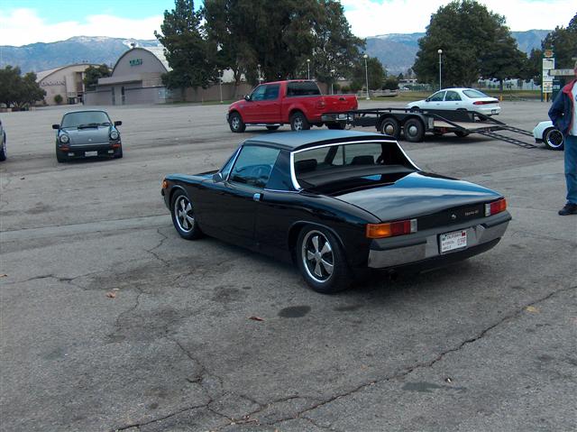

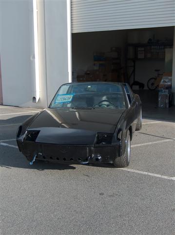

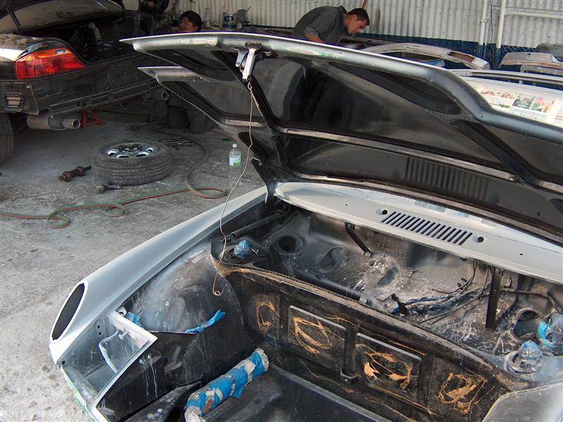

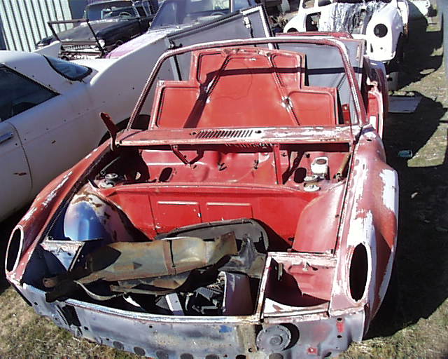

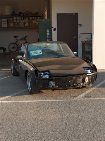

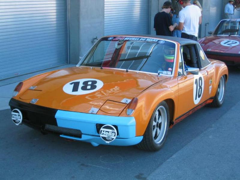

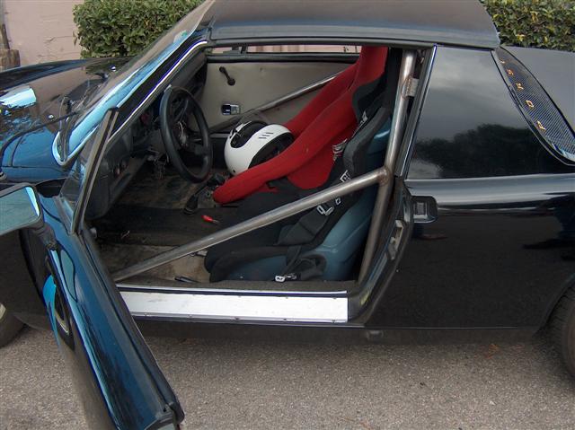

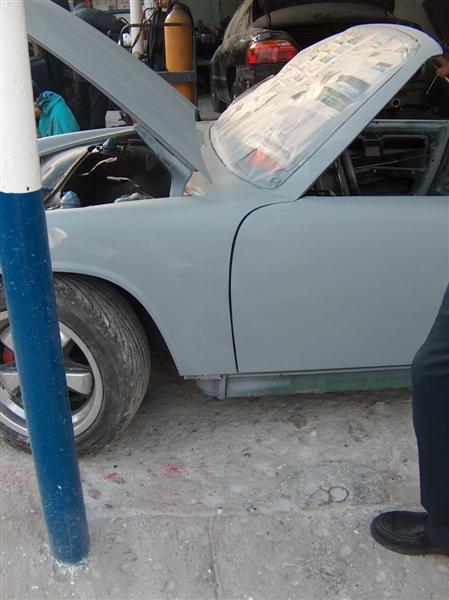

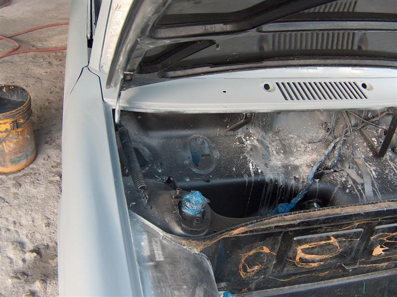

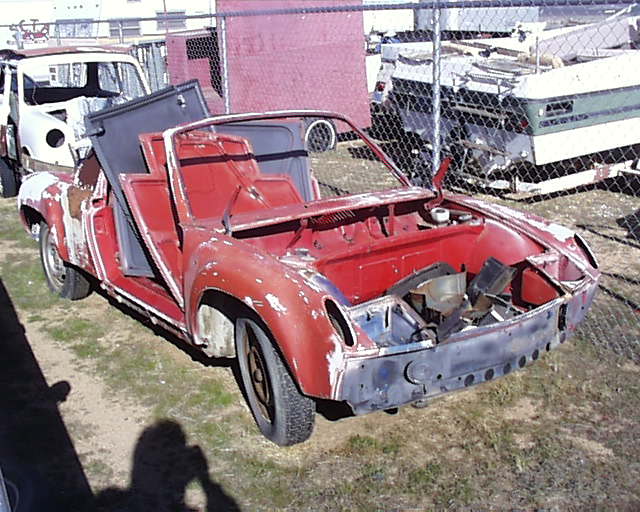

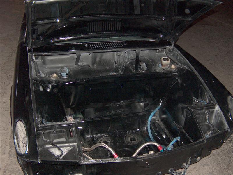

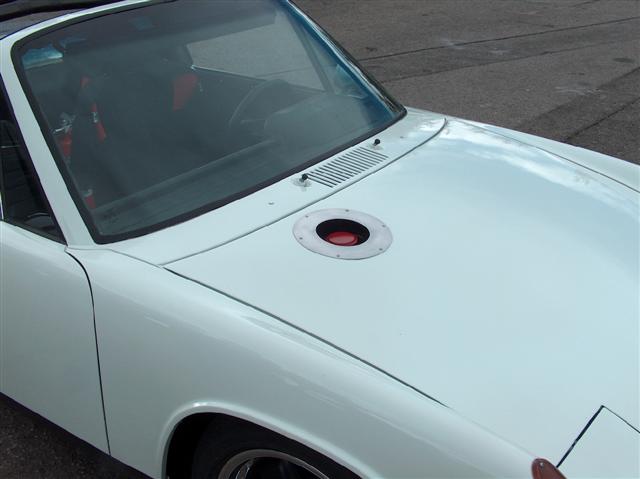

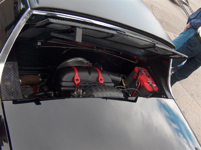

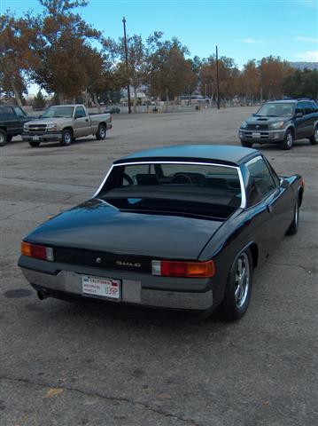

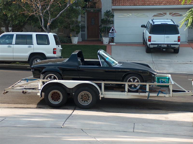

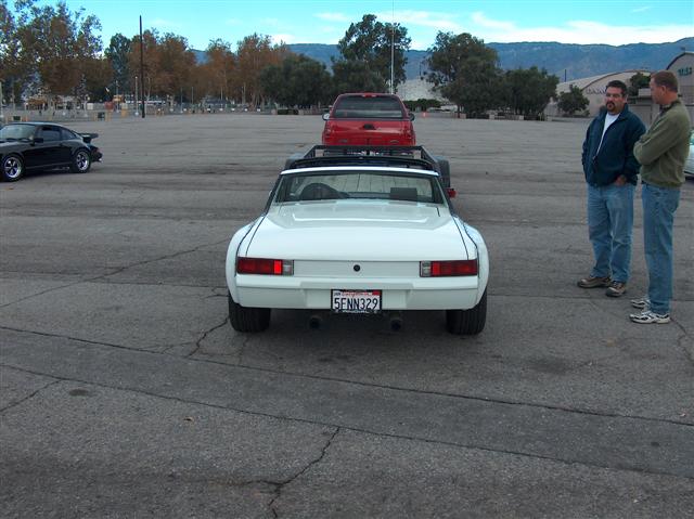

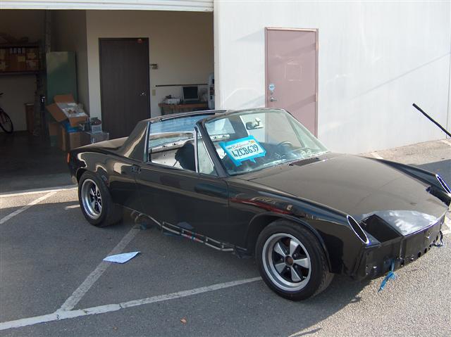

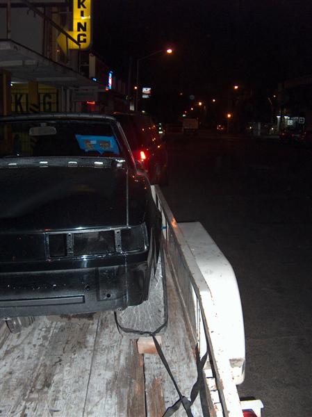

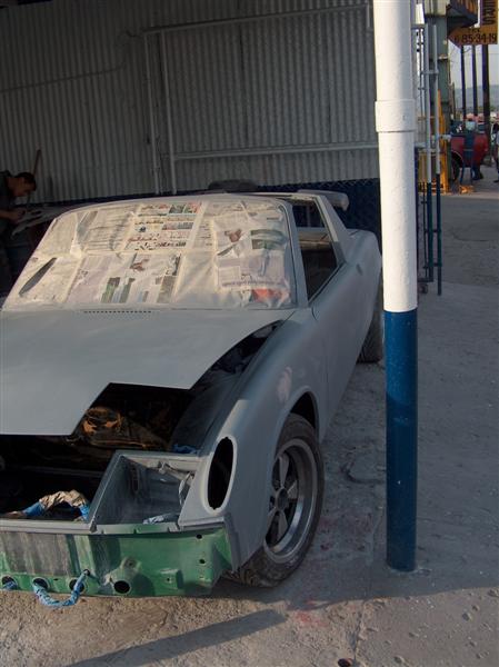

when the beast is assembled and complete it will be as follows:

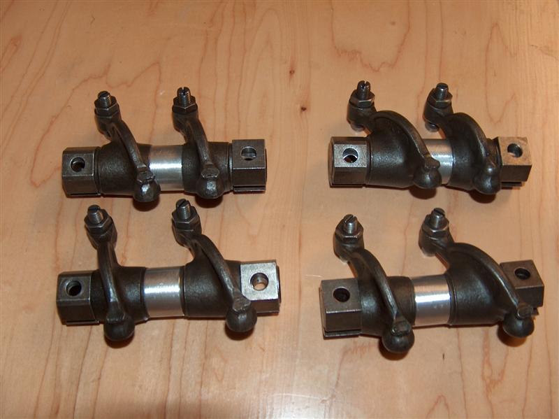

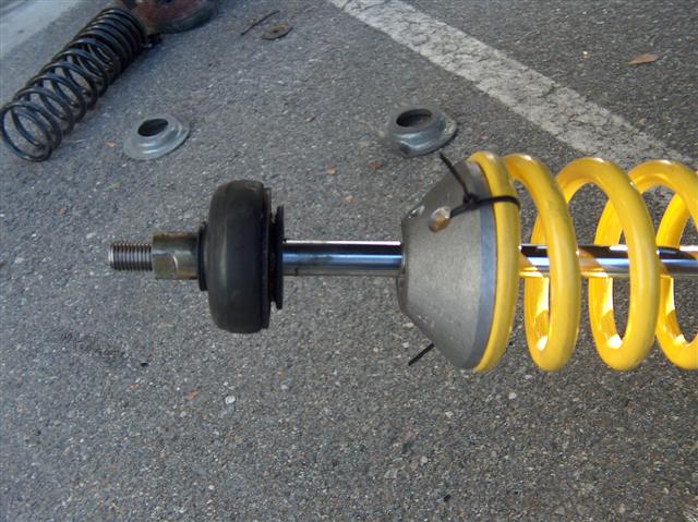

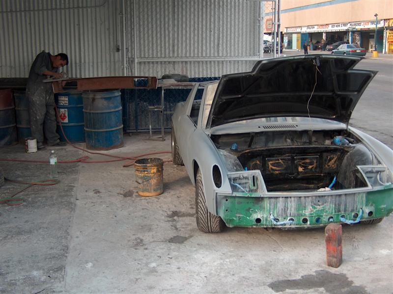

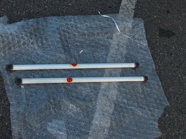

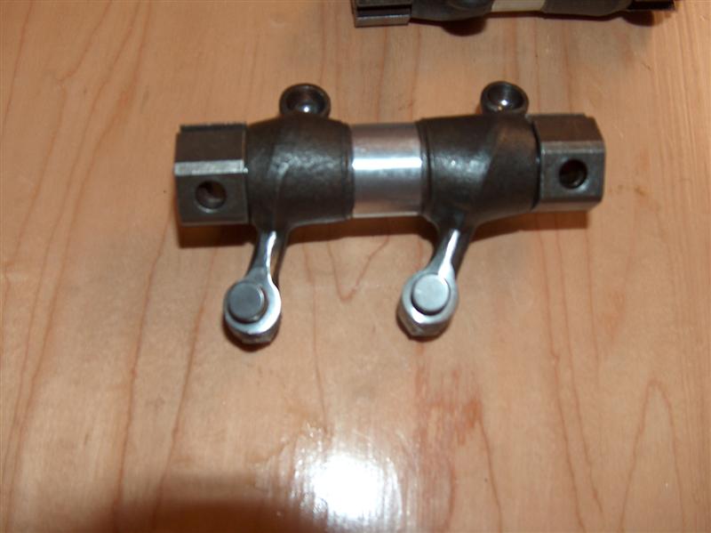

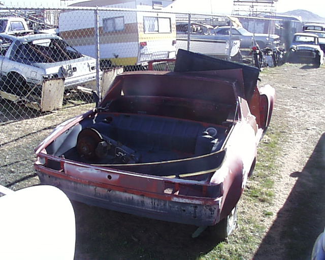

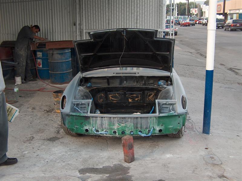

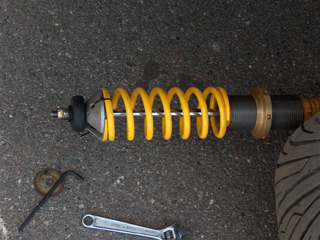

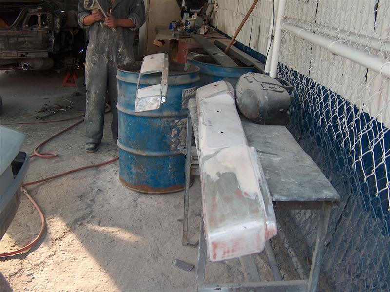

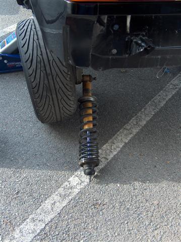

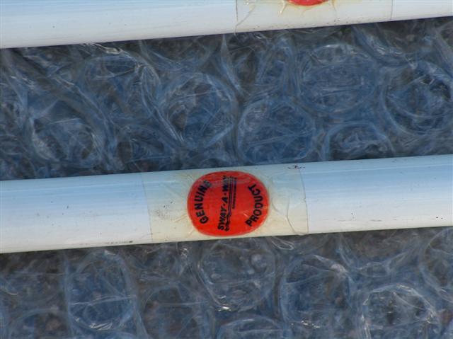

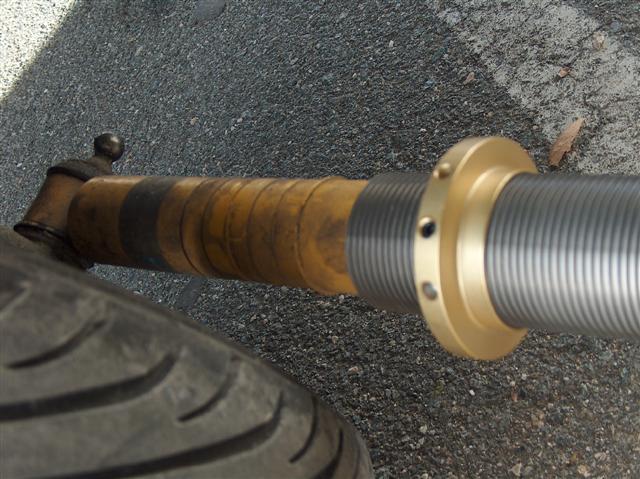

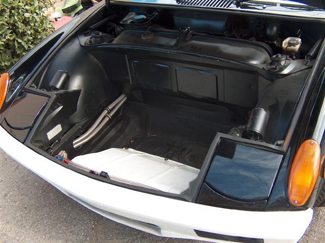

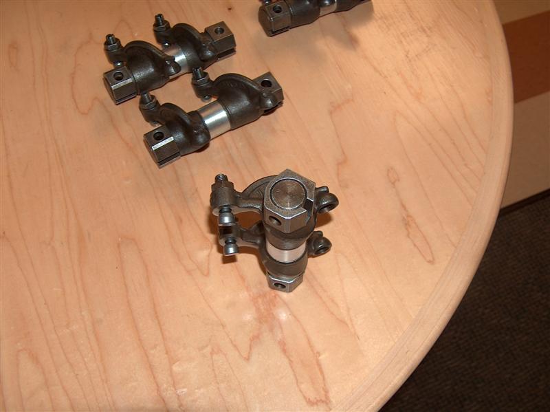

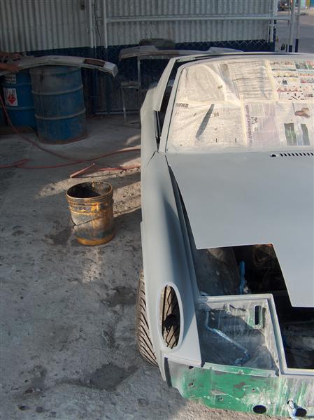

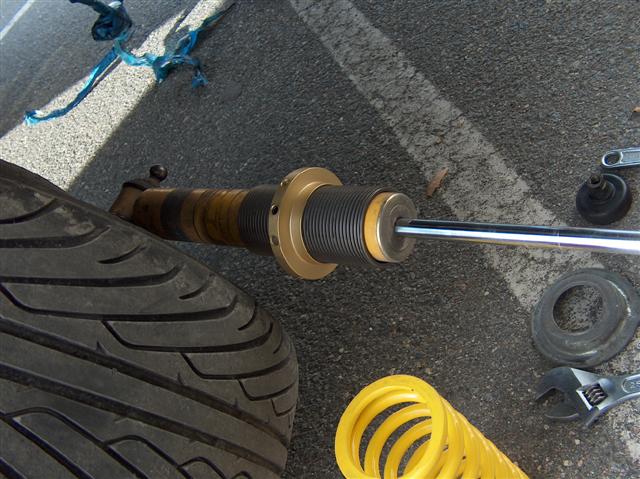

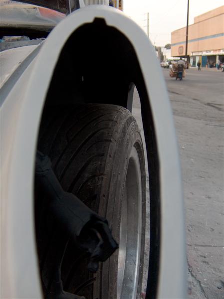

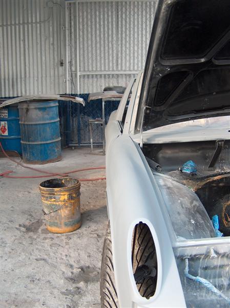

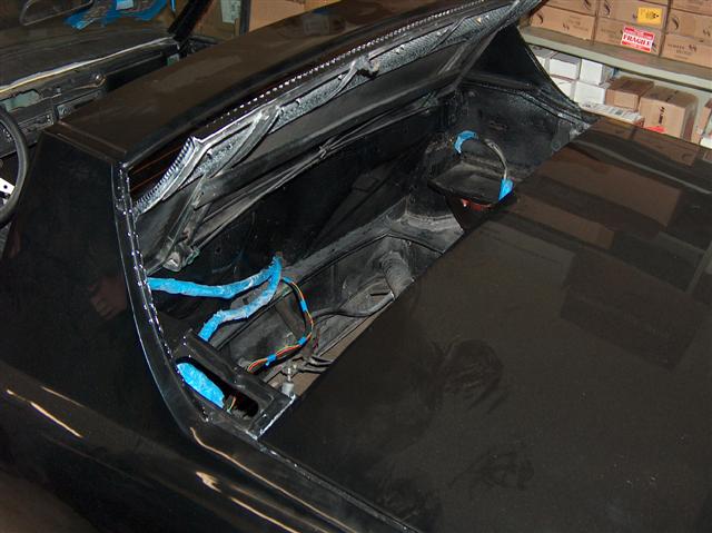

1973 2.0 Body Butt welded in Steel Flares, cut offs from Dan Calicott 914 RaceCar Metal worked, and pulled 1" out by Los Panchos Garage Side marker holes welded up and ground smooth Freshly Painted GT front valence, with notch for oil cooler 914/6 Rear DEEP Valence with porthole exhaust cutout. 914/6 rolled tip. Camp914 Rear trunk Shox Motor 71x94 2L heads 8.5 C/R Big cam 1.7 rockers with 911 swivel feet, Aluminum Solid rocker spacers Scat/Manton chrome-moly cut to length pushrods Weber 44 IDF's Mallory Unilite distributor. 12/28 grey/grey advance curve Mallory Hyfire 6A capacitive discharge ignition Mallory Promaster E-Coil high output CDI type coil Aurora 8.5 mm CDI capable spark plug wires European Racing Header 4 into 1 Header MOCAL Thermostat controlled sandwich adapter plate Aeroquip/XRP -10 braided oil lines Setrab 13"x3" Front Mounted Oil Cooler Suspension Front Koni Red - ext. adjustable 22mm Sway-A-Way (SAW) solid torsion bars 24mm Tarett hollow sway bar Weltmeister Poly street bushings 72 911 front suspension M calipers and Carerra vented rotors Porterfield R4s Turbo Tie Rods Rear PMB (eric shea) 5 lug control arm kit Weltmeister poly street Bushings Billstein Sport Valved Shocks Coleman Racing threaded Perches 225 lb/in springs 16mm OEM swaybar Mintex Pads 914/6 Solid rotors Wheels Street 15x7 Fuchs with 205/50 Yokohama AVS ES100 tires. 15x8 Fuchs with 225/50 Yokohama AVS ES100 tires. Al reed refinished Autocross and Track 15x7 Cookie Cutters with Falken Azenis RT-215 Stickies Transmission Short Gear Ratio Box (A) (F) (Flipped ZD) (S) (ZD) New synchros, sliders, dogteeth, diff. carrier bearings, bushings and seals. Weltmeister Solid trans mounts Interior and Extras Momo Prototipo Vintage wheel 904 combo gauge Rear Defrost window Reupholstered Seat.Dashes.Backpad by Evilwerks Rennshifter Momo contour leather knob M&R racing, 5 point camlock race harnesses Weltmeister Harness Guide Bar Polished aluminum Gauge Bezels by Spunone NAPCO front and rear soft targa holders for painted tops Black domestic carpet Lighting Omega h4 housings with Hella 55/100w h4 bulbs Pilot Automotive driving lights 100w h3 bulbs Hella 500 914/GT lights. 55w h2 bulbs OEM European front and rear lenses

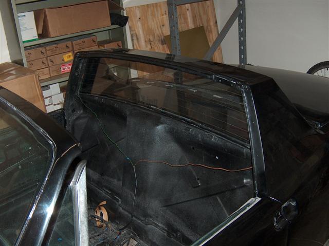

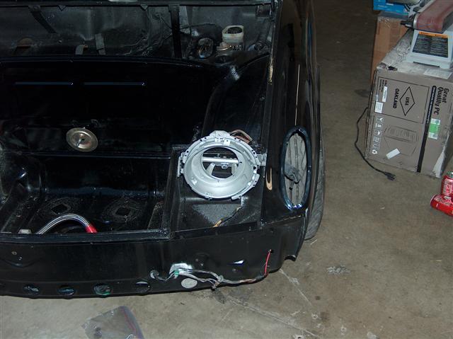

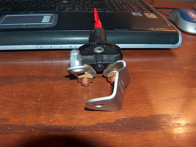

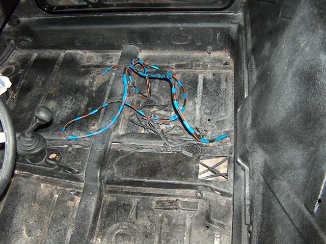

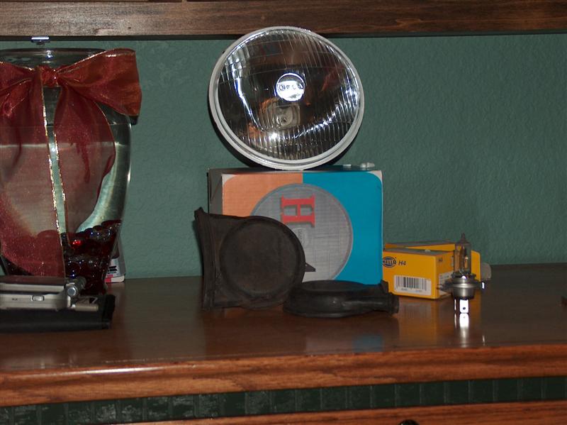

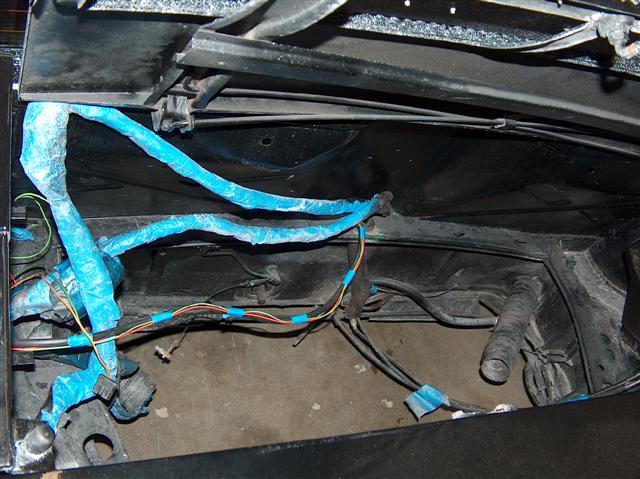

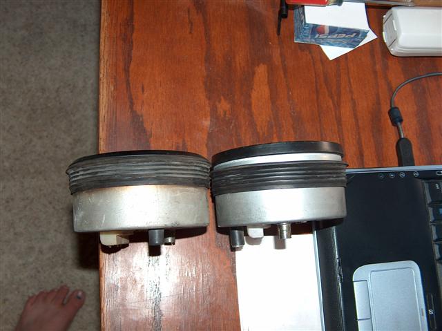

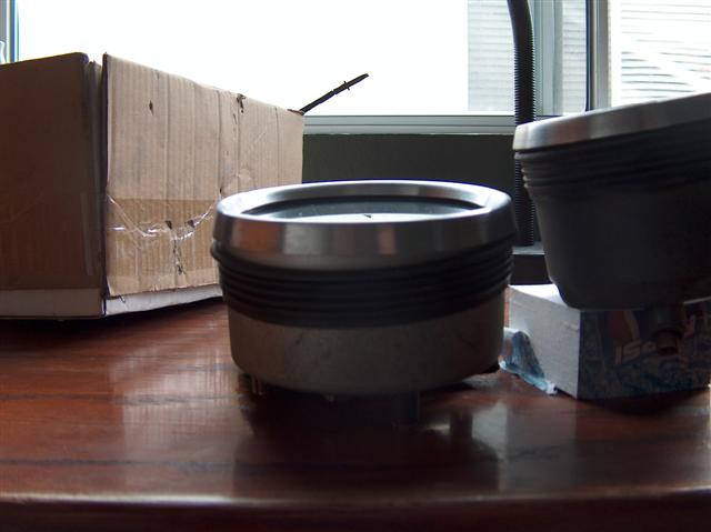

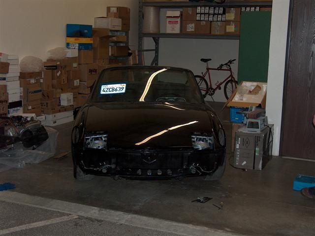

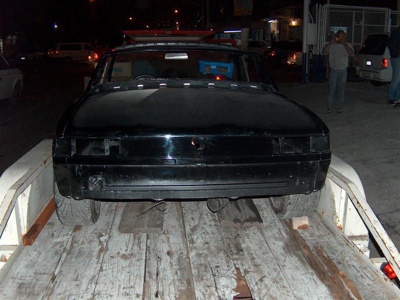

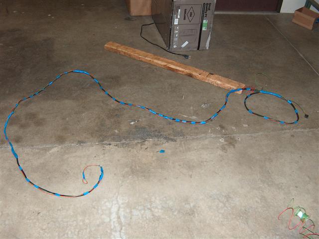

Stuff to do when i get my tub back...

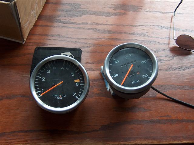

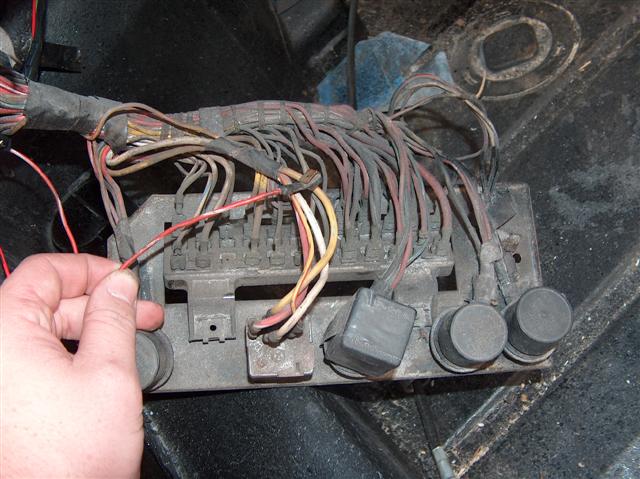

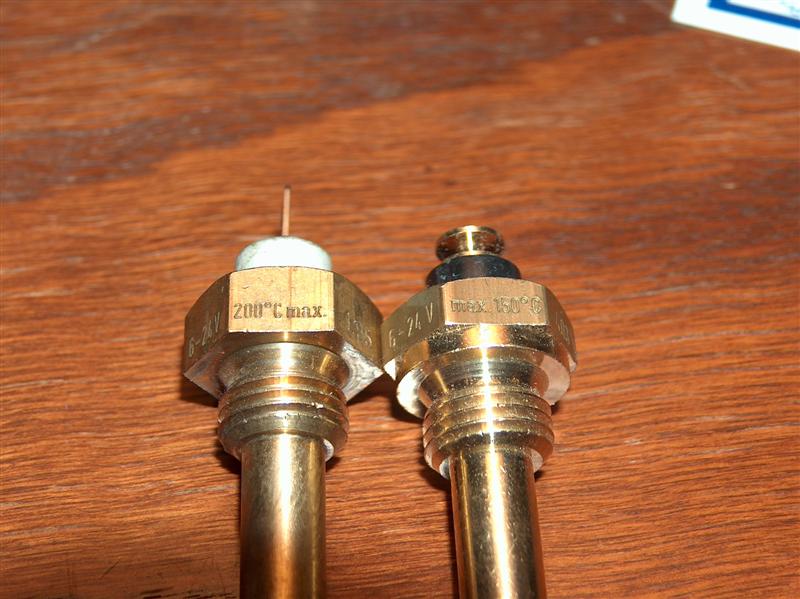

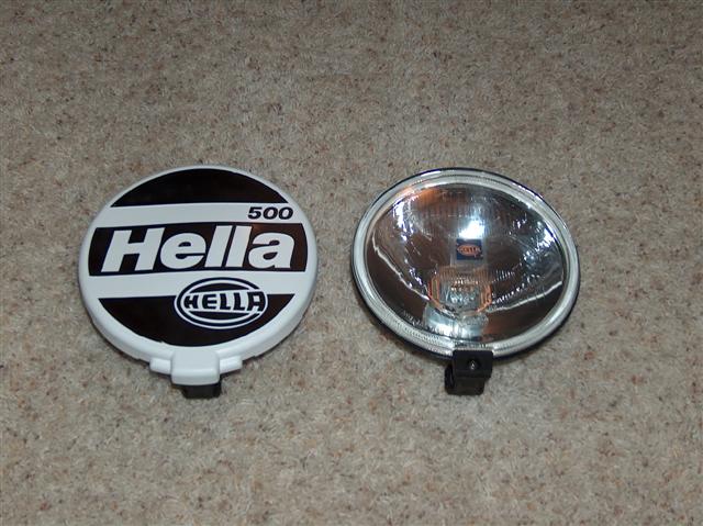

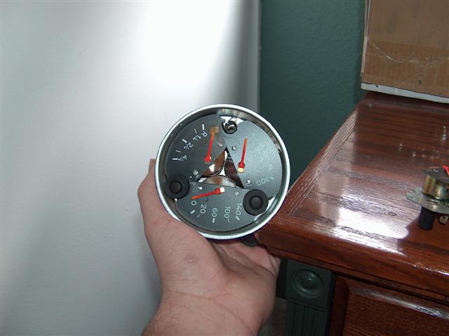

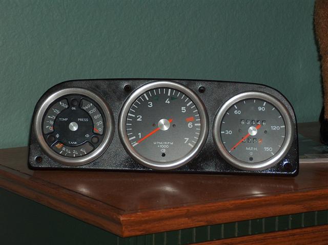

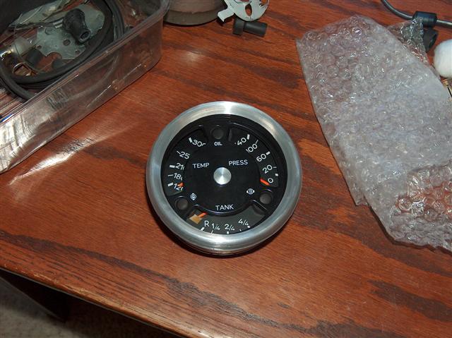

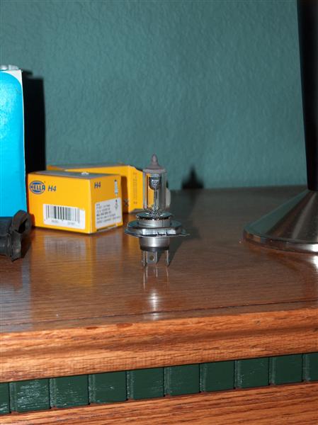

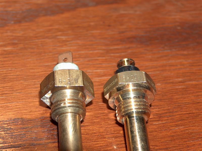

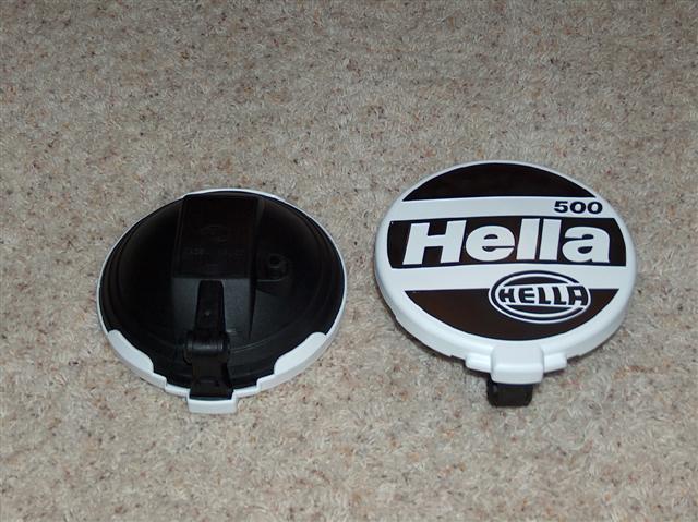

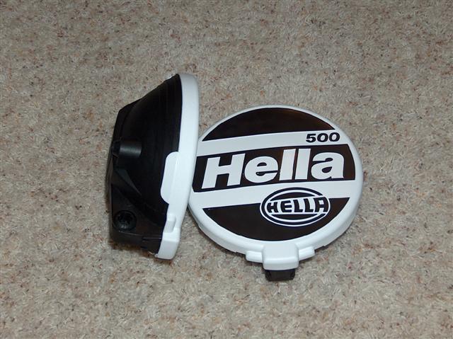

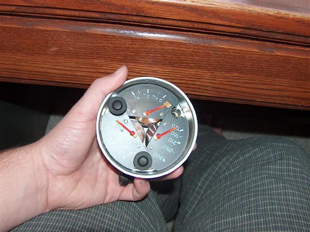

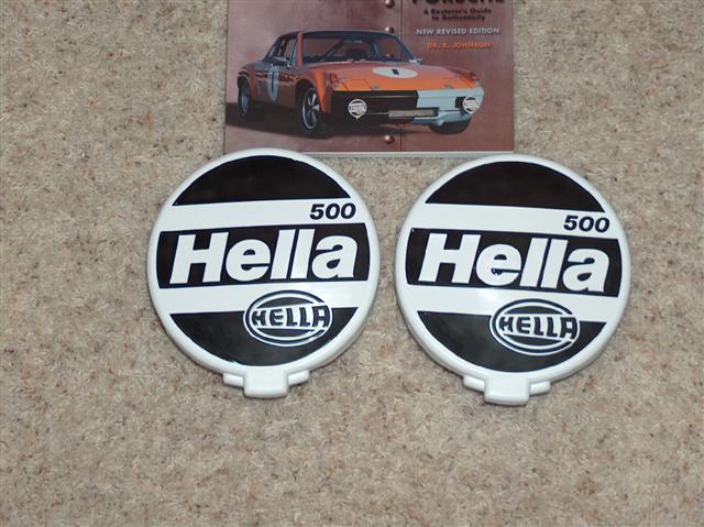

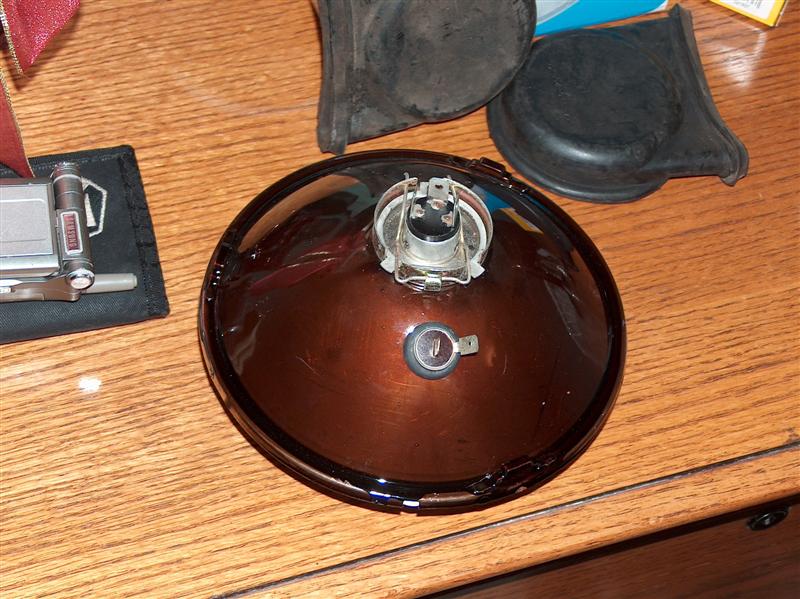

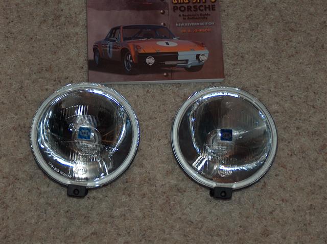

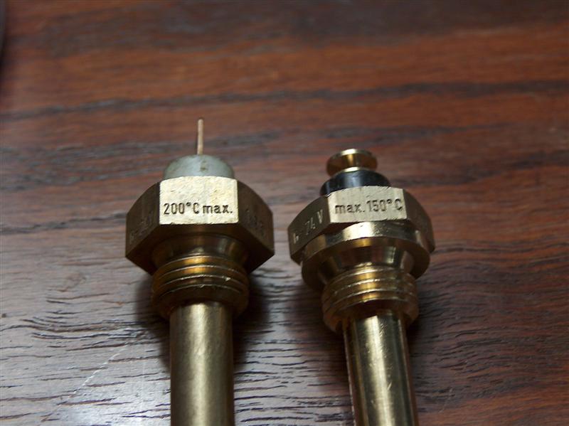

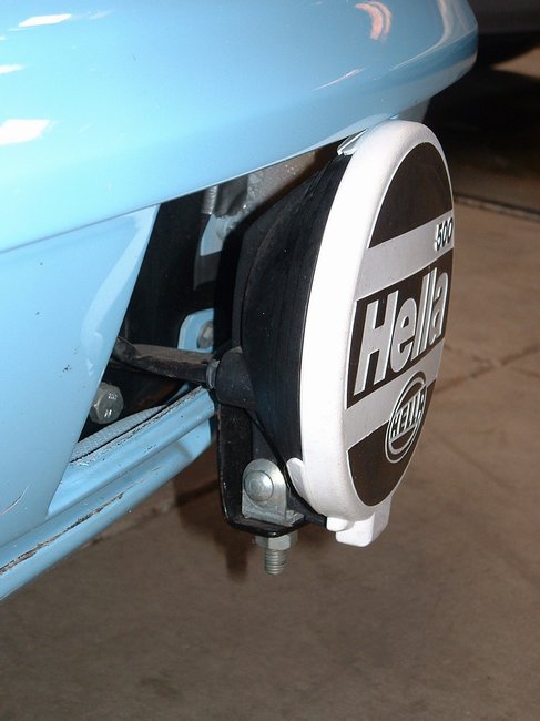

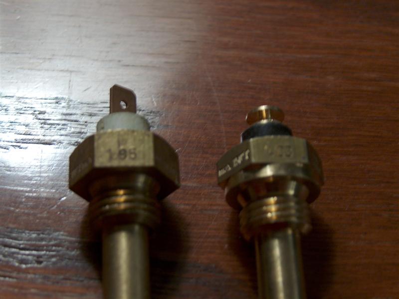

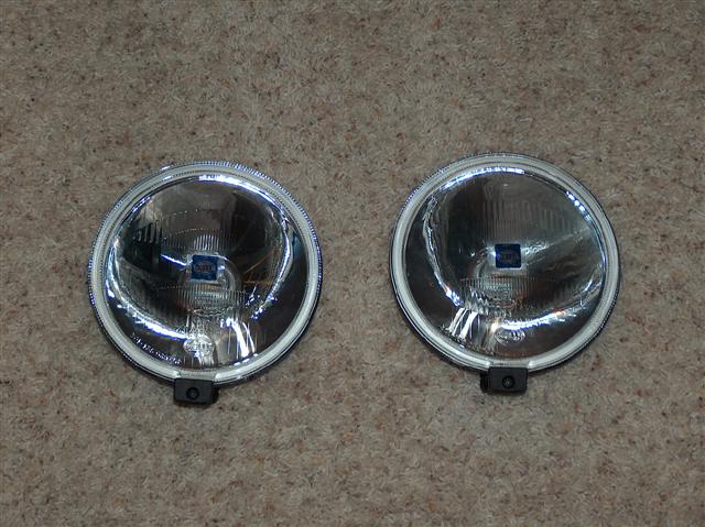

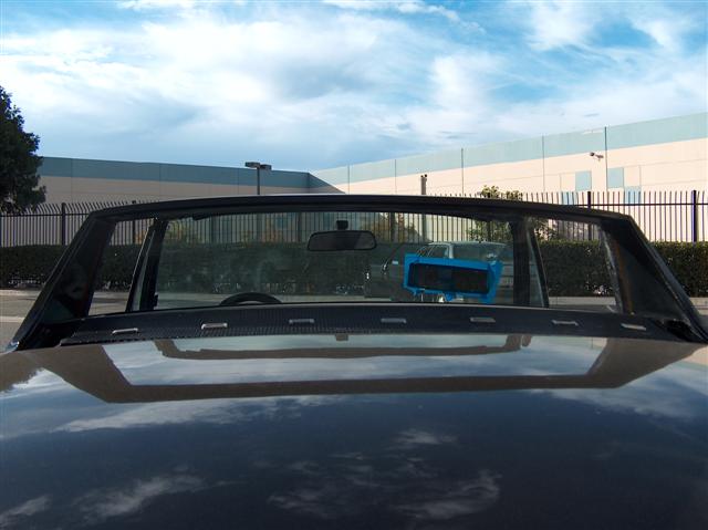

Wiring: Install Complete Rear Defogger Harness Run a green wire from oil pressure sender on block, up tunnel to 904 gauge Run rally light wiring for new Hella 500 driving lights
