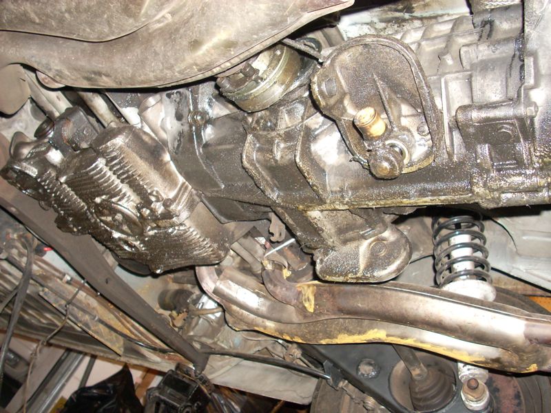

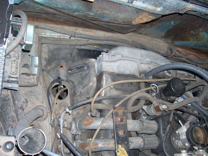

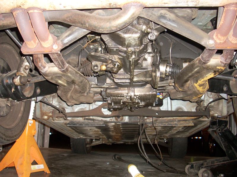

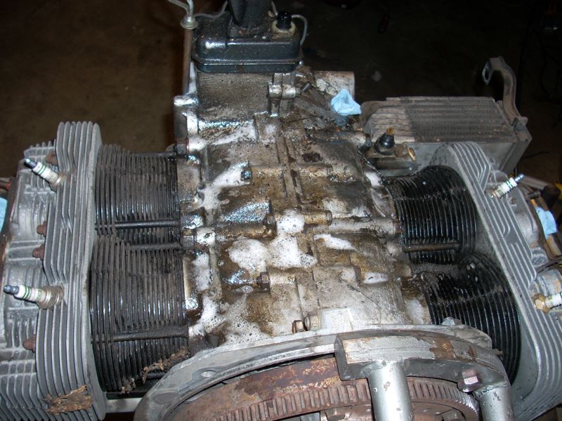

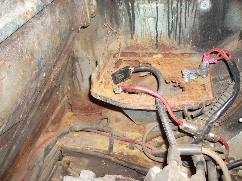

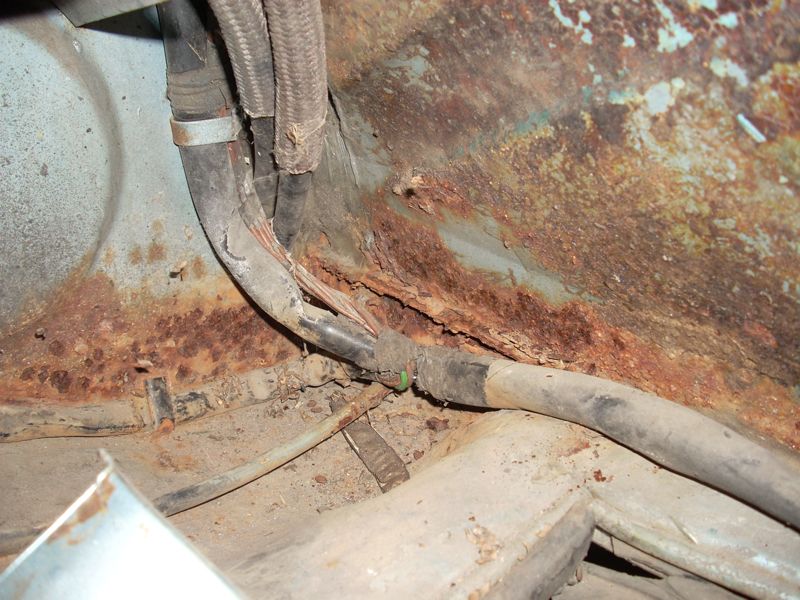

It's been a long time and a lot of little things have happened. Here's an updated list of where I am on my Get-The-Car-Running project. 1. Pull the motor and fix oil leaks, pull the ceramic lifters, clean everything, install carbs (for now). I ended up selling my motor (in a round about way) and so now Jeff Keyzer has it and I have his old 1.7 motor to put in my car. Which is fine with me. As long as it drives, I'm happy. I'm getting a set of VW bus carbs to put on the motor instead of fuel injection. Why, you ask? Two reasons: first because I expect it will get me on the road the quickest, and second because I'll learn something by using them. I expect that they're a great option for small motors. 2. Fix the hell hole and firewall rust, plus weld all the little holes in the firewall. New battery tray and new rear trunk pivots. DONE!!! 3. Fix the 'access hole' some DAPO cut in the rear trunk. The top starter bolt is not THAT hard to get to. DONE!!! 4. Clean and paint the engine bay and rear trunk. Not until the welding work is done. 5. Clean and reseal the transmission and replace the speedo angle drive. DONE!!! I've also decided to execute my five lug conversion while I'm doing the rear end. I already had the drilled hub installed. Marty Yeoman is going to machine some four lug rear rotors for me and I'll get a set of rear calipers rebuild by Eric Shea. DONE!!! The sunny weather is really pressuring me to keep moving on this.

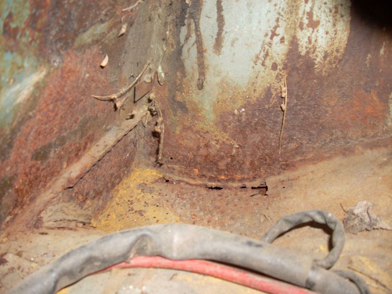

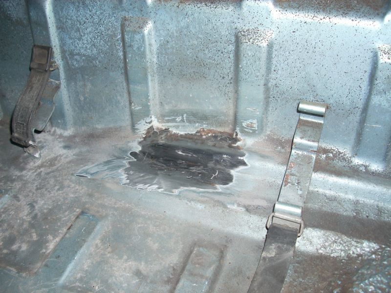

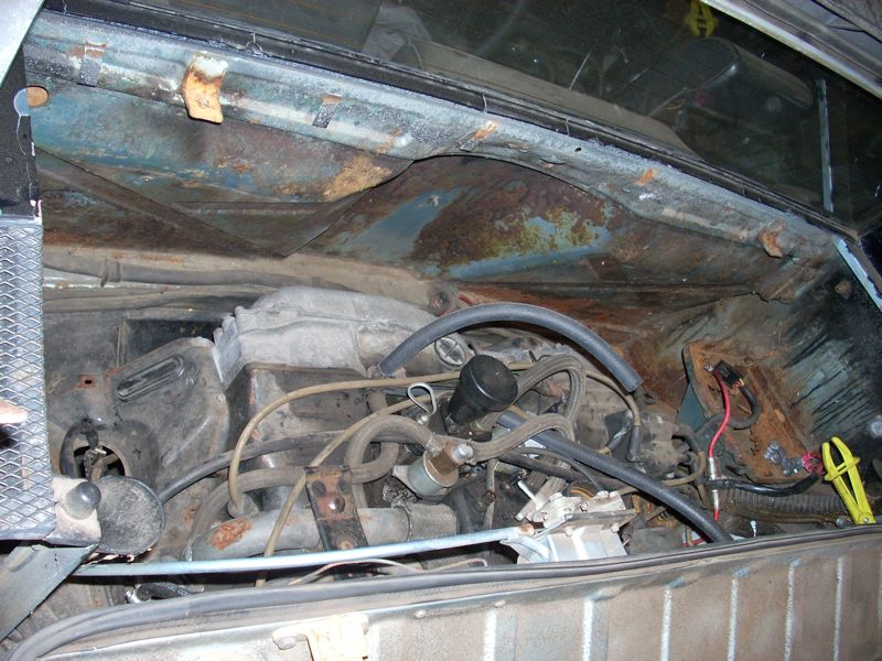

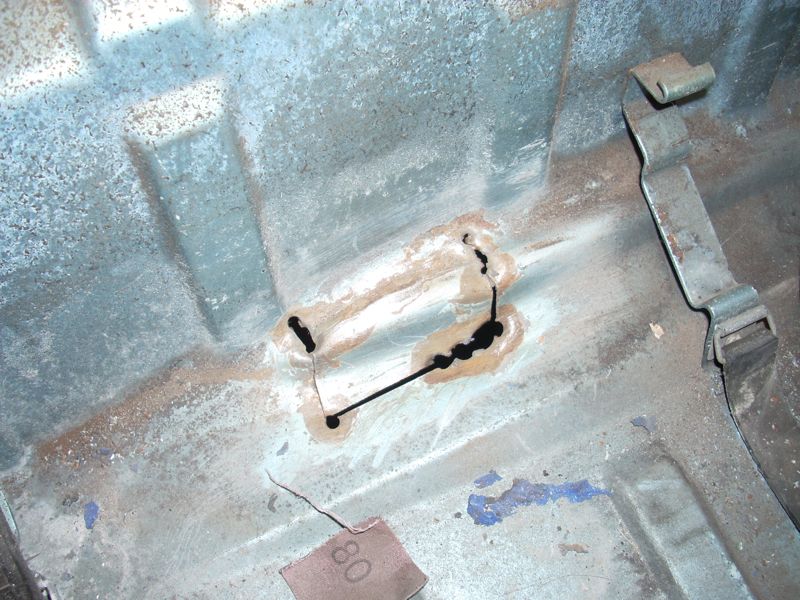

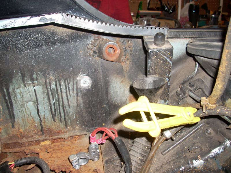

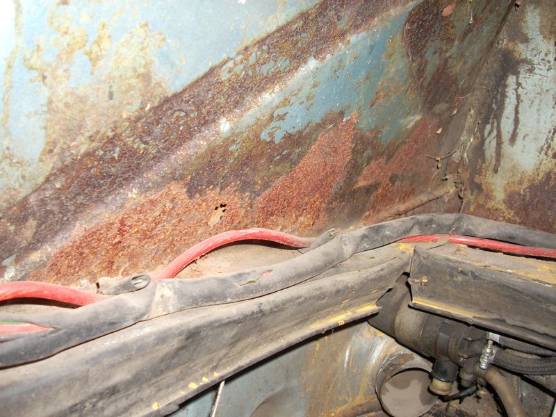

I think it was the Tied House meet that gave me the kick in the pants, but I finally decided to jump in and get started on my car. It's been begging for work for a long time. I'm starting with the rear end sections. Can't wait for it to actually DRIVE! 1. Pull the motor and fix oil leaks, pull the ceramic lifters, clean everything, install carbs (for now). 2. Fix the hell hole and firewall rust, plus weld all the little holes in the firewall. New battery tray and new rear trunk pivots. 3. Fix the 'access hole' some DAPO cut in the rear trunk. The top starter bolt is not THAT hard to get to. 4. Clean and paint the engine bay and rear trunk. 5. Clean and reseal the transmission and replace the speedo angle drive. Here are the pictures from day one. Attached thumbnail(s)

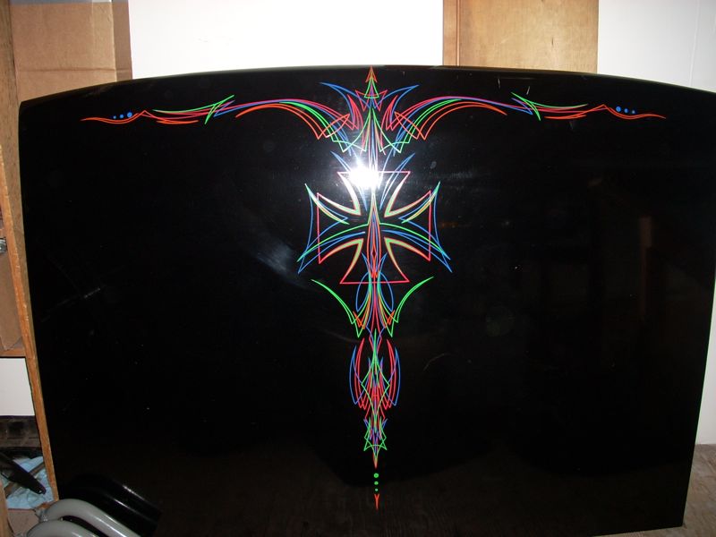

My neighbor has been playing around with pinstriping and so I offered my decklid for practice. Here are the results. Really beautiful. Of course this will go away once I paint the exterior, but it's fun for now. I kind of love having a 'beater' that I can do this kind of stuff to. Attached thumbnail(s)

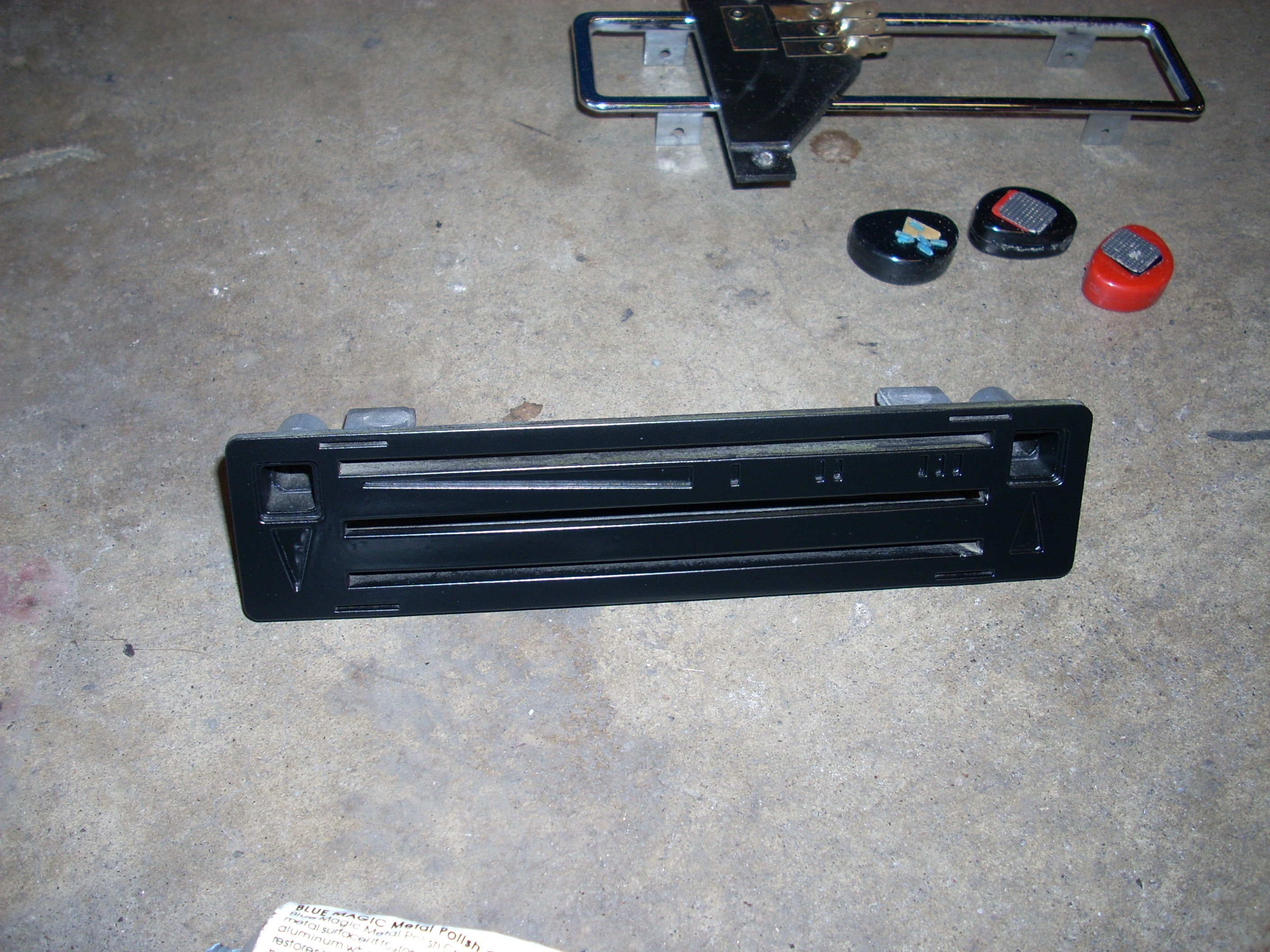

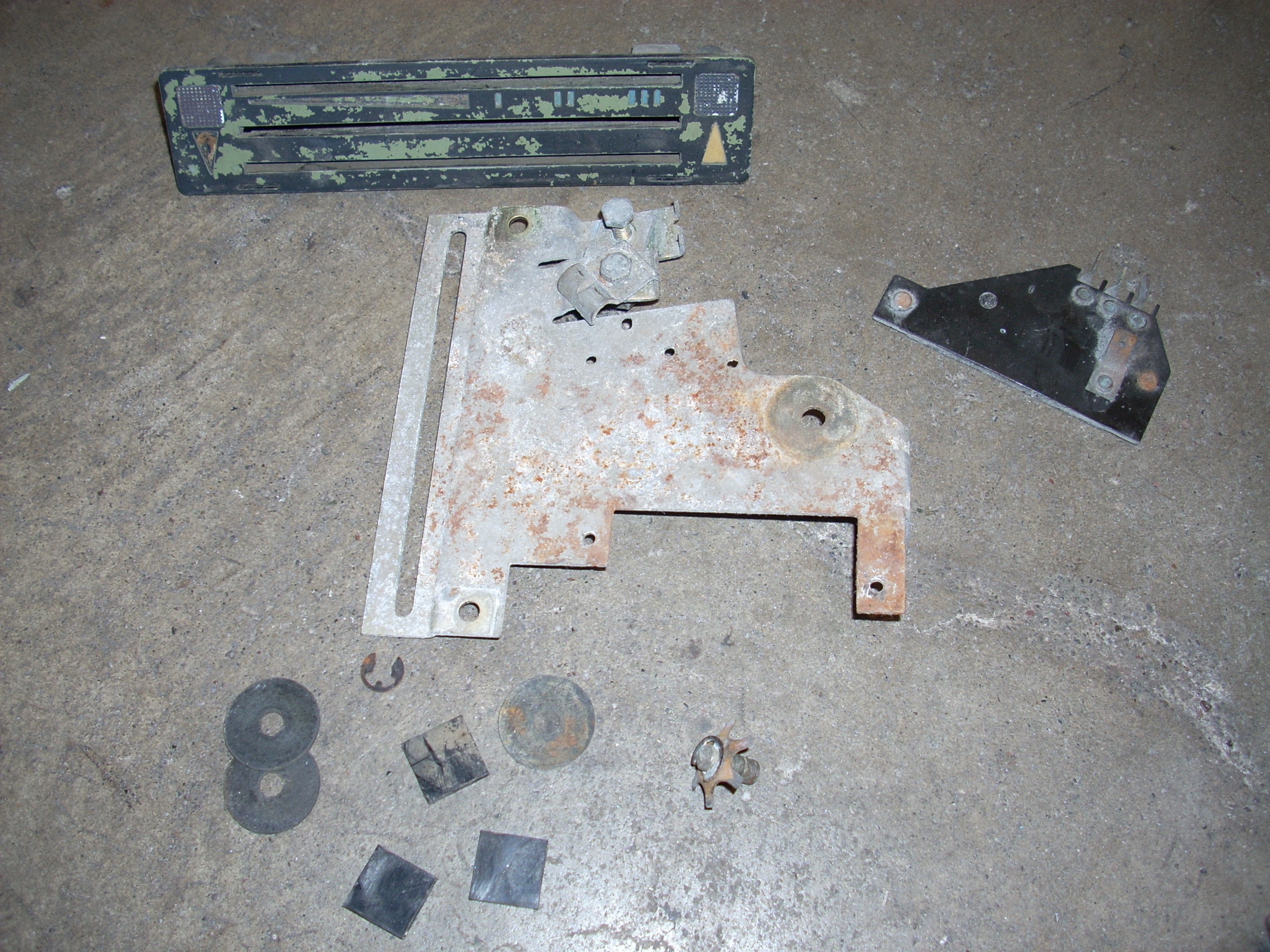

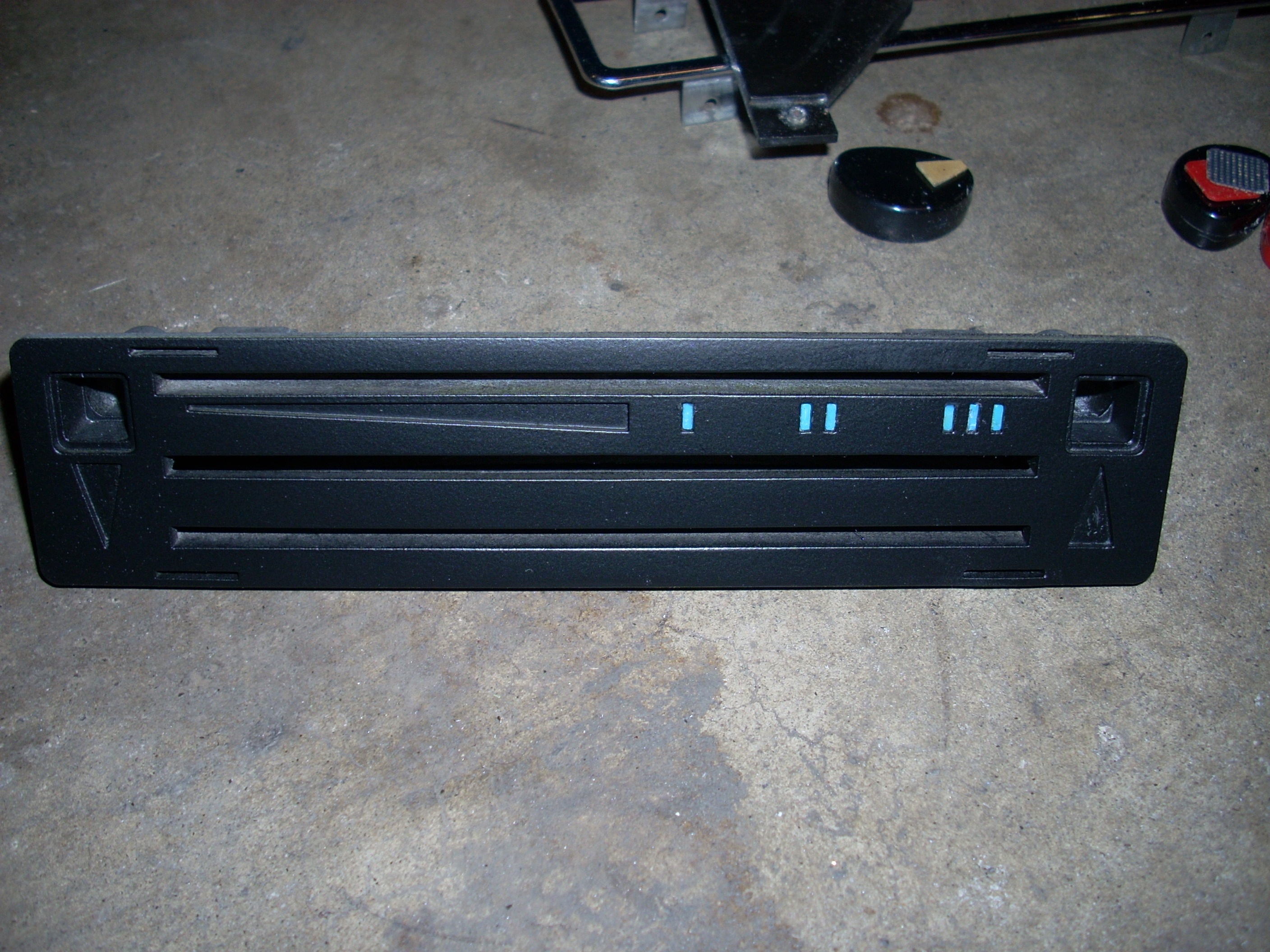

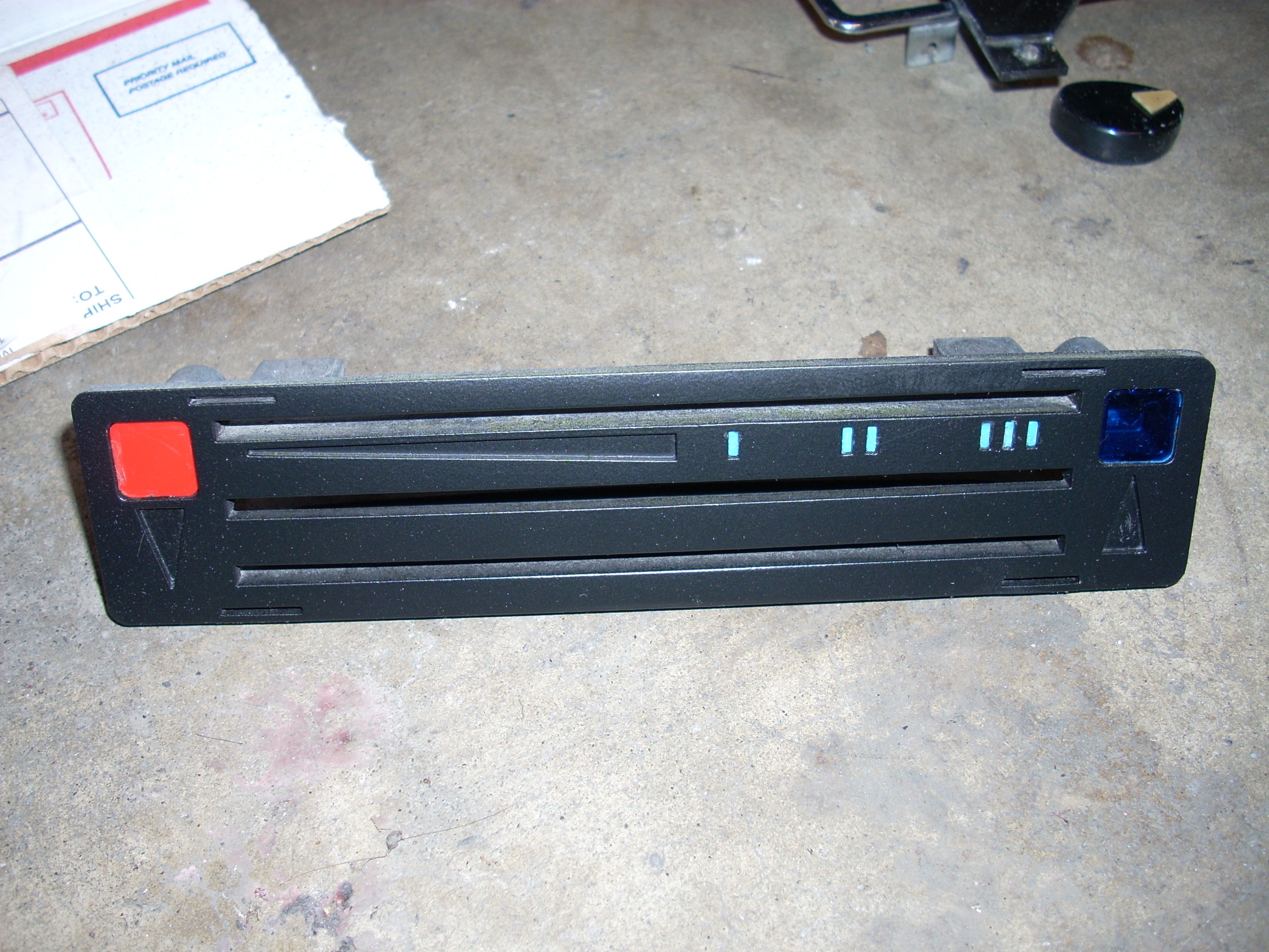

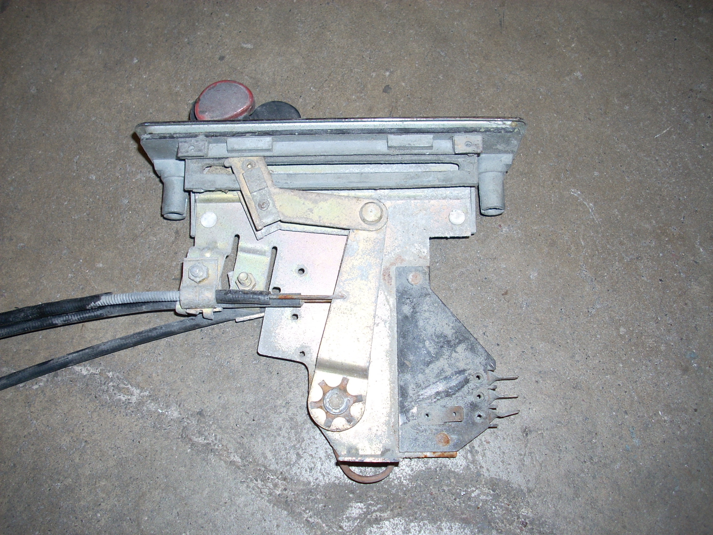

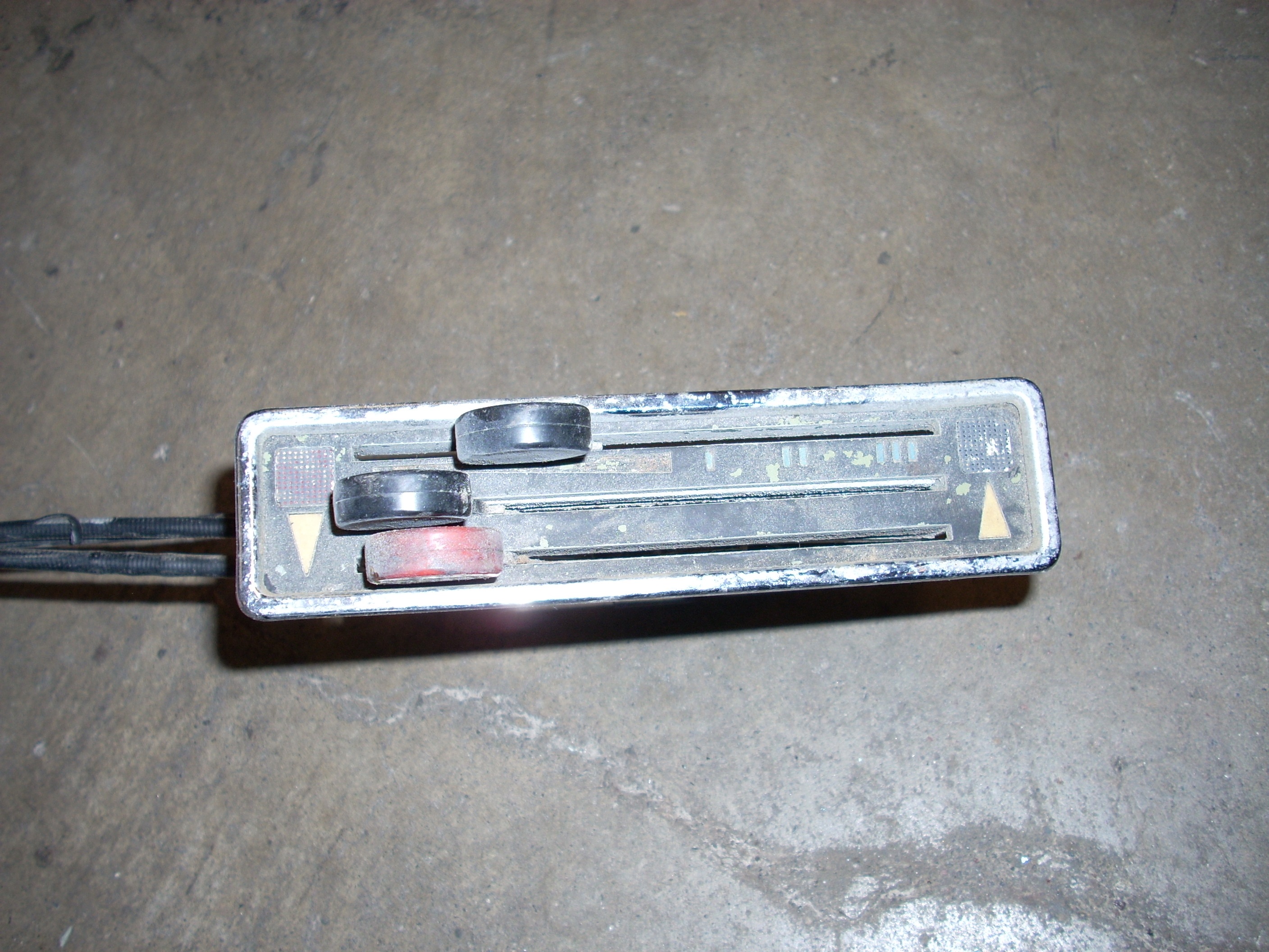

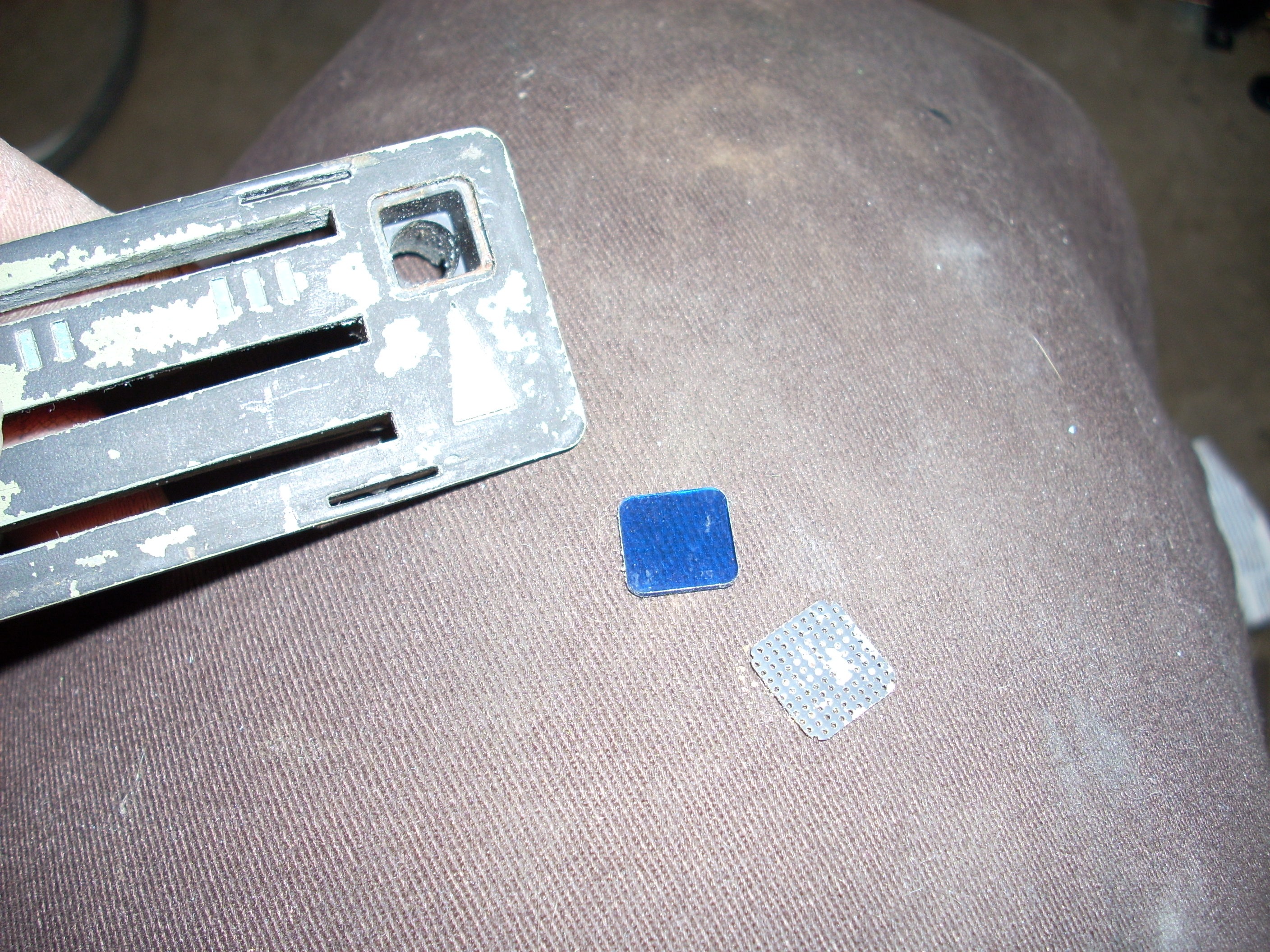

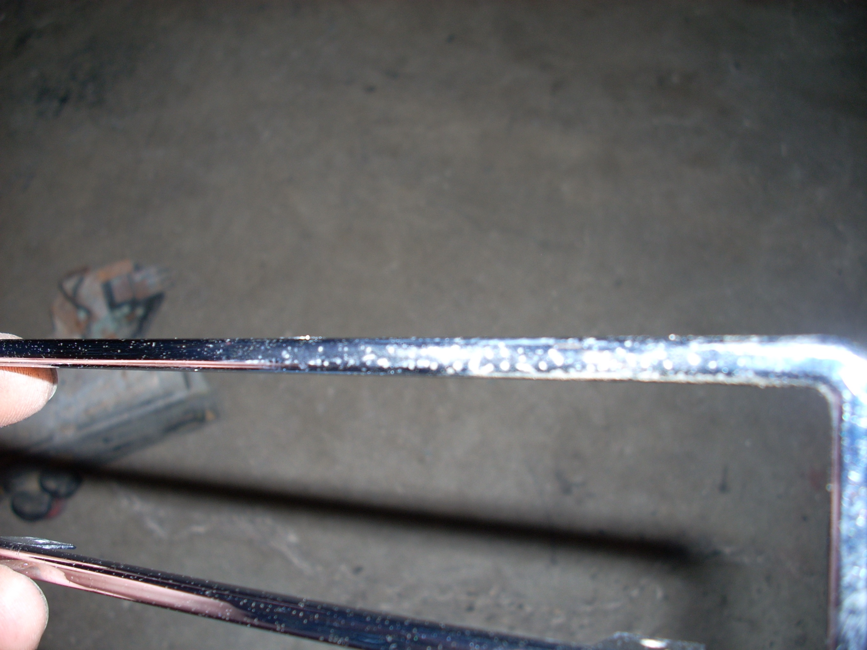

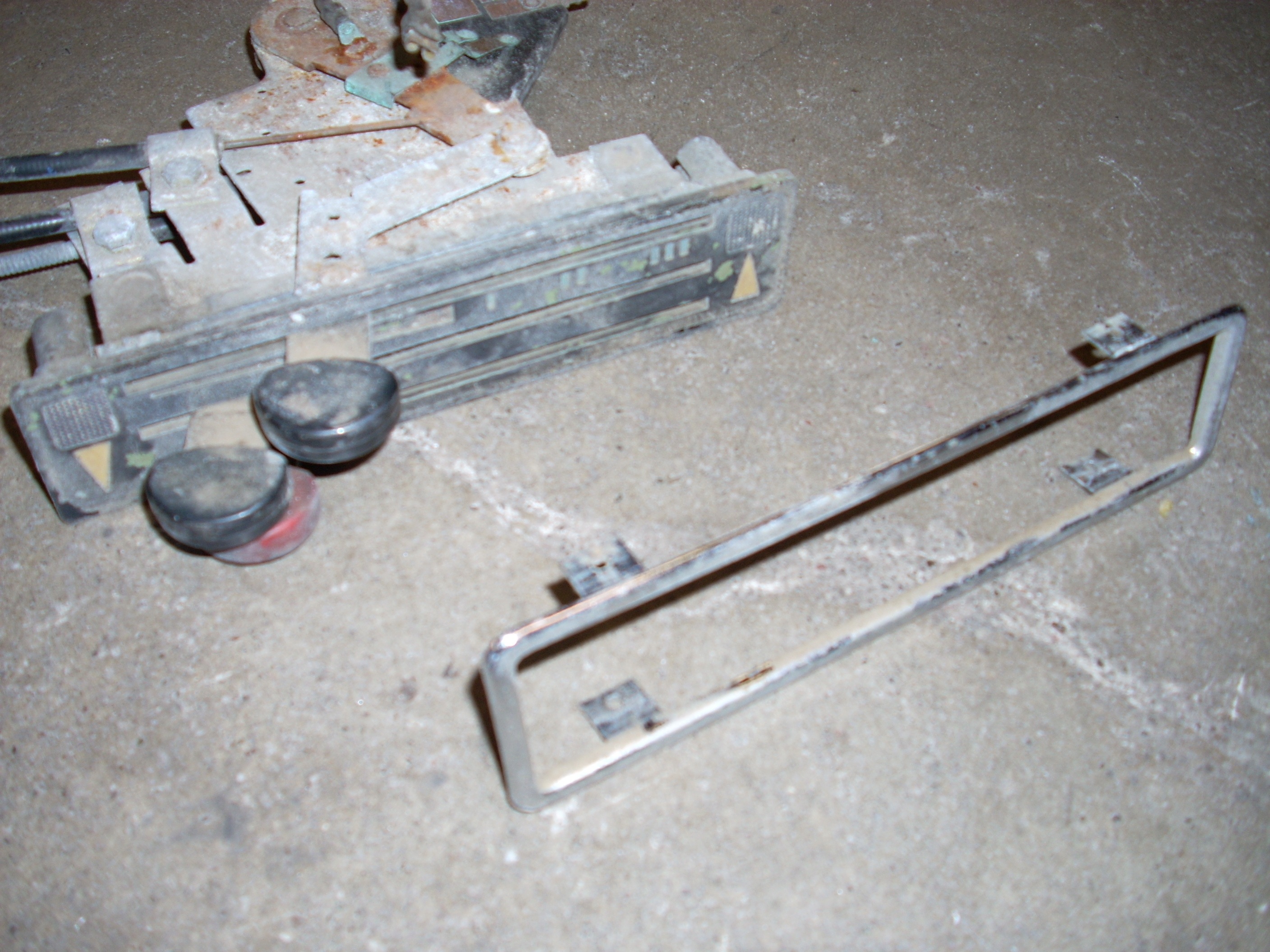

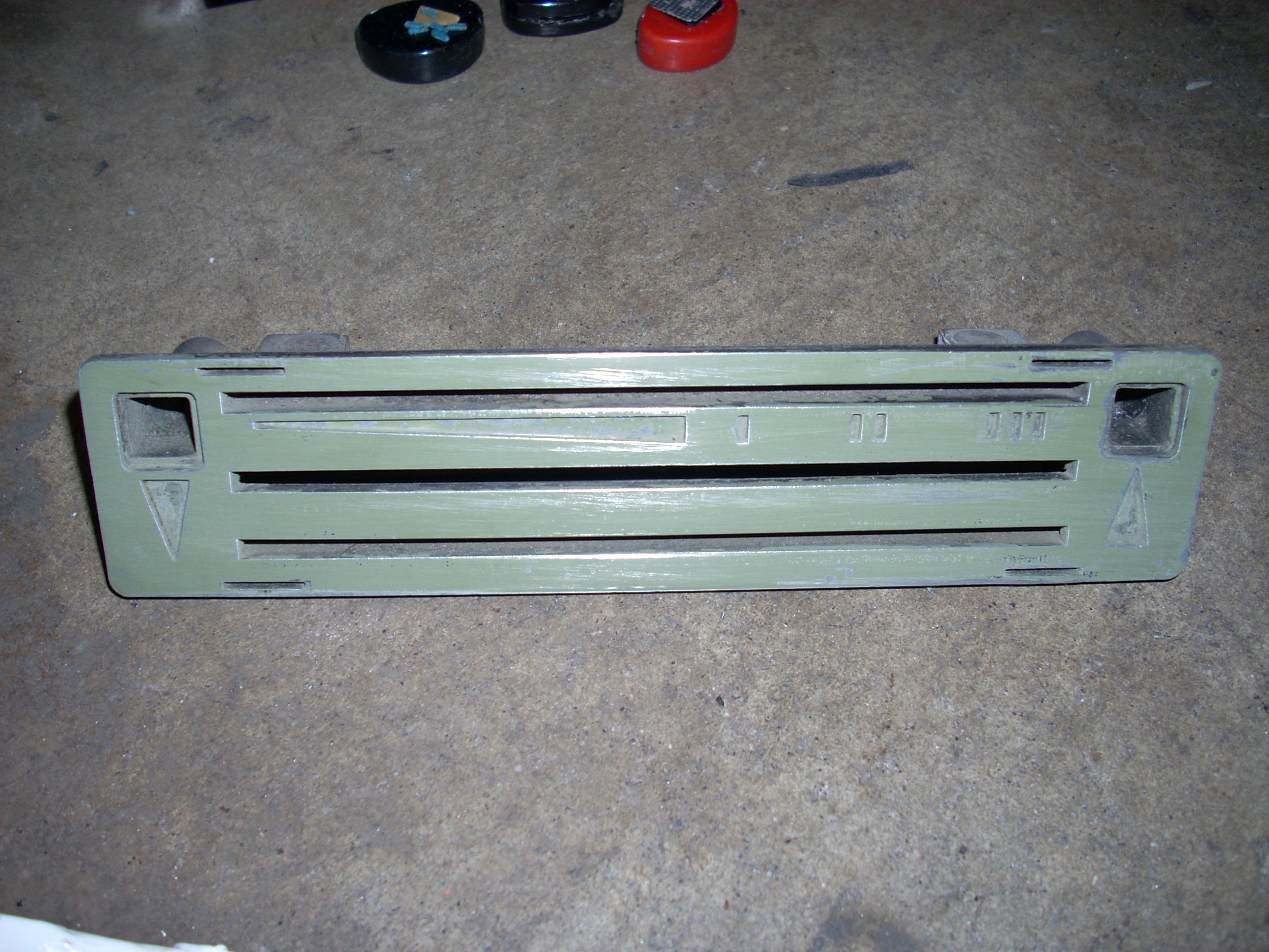

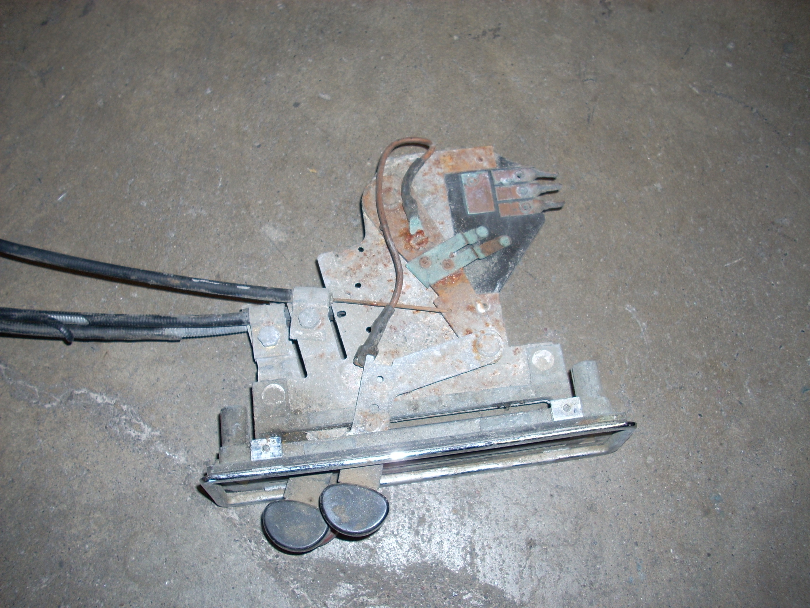

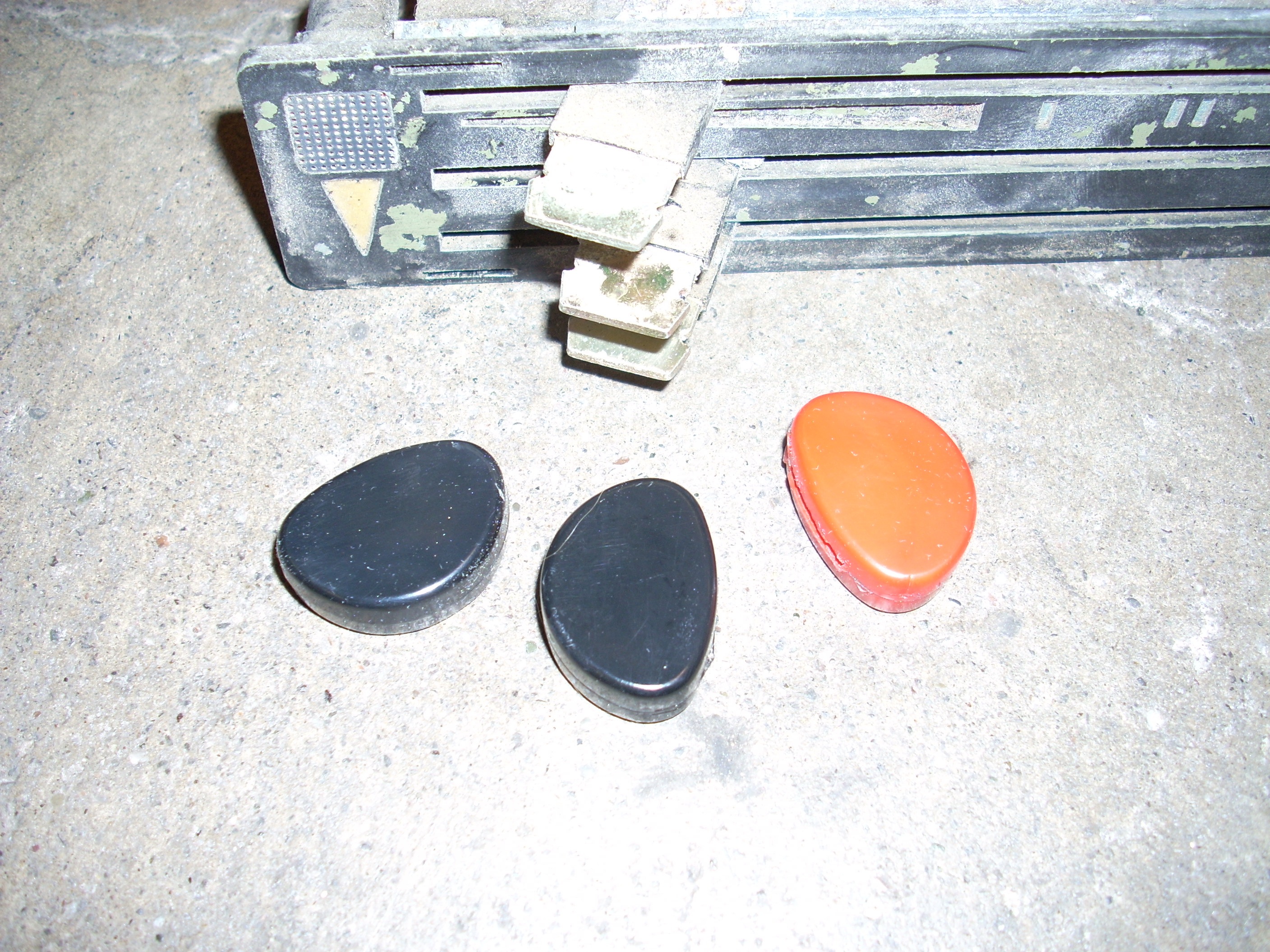

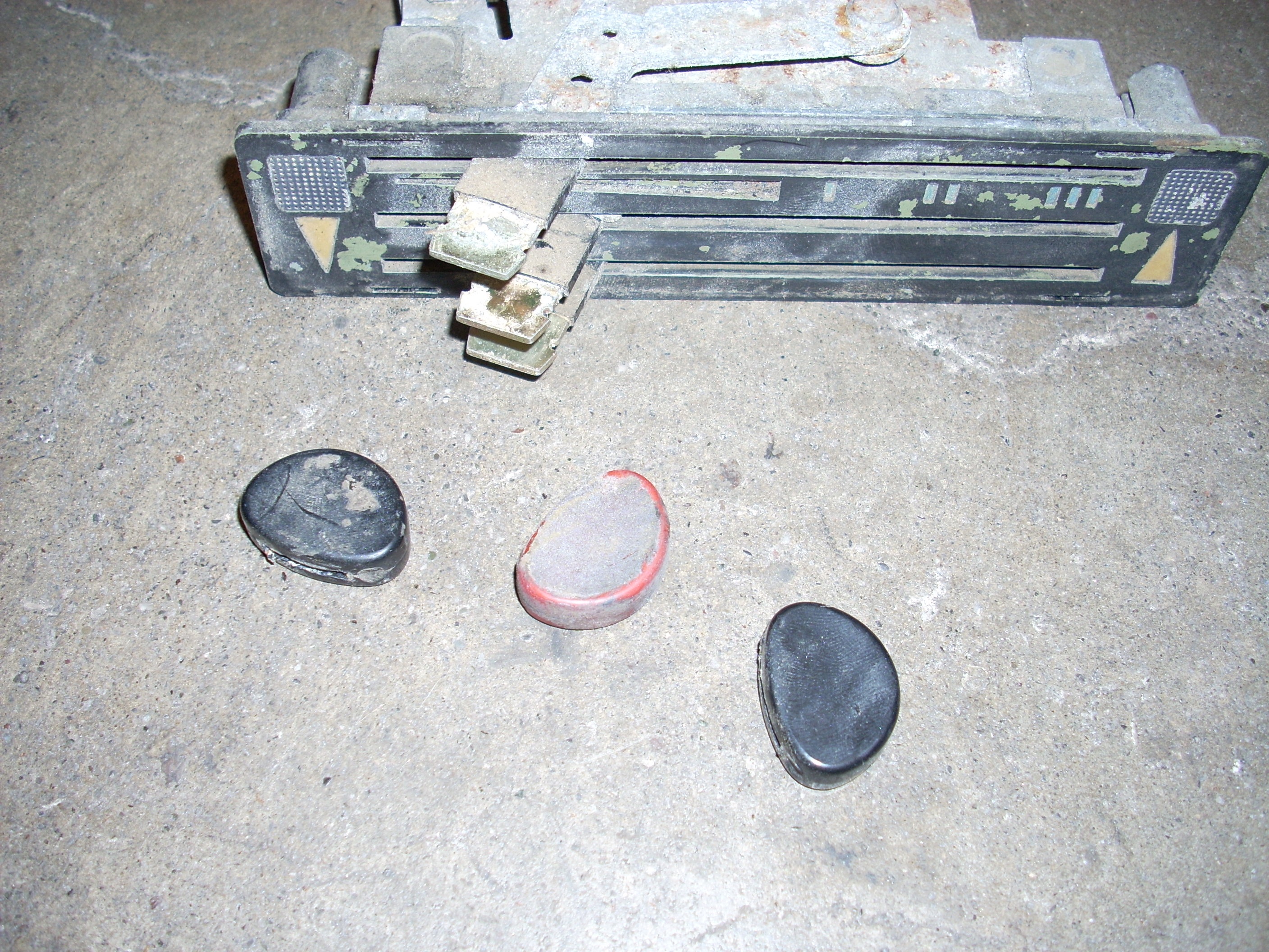

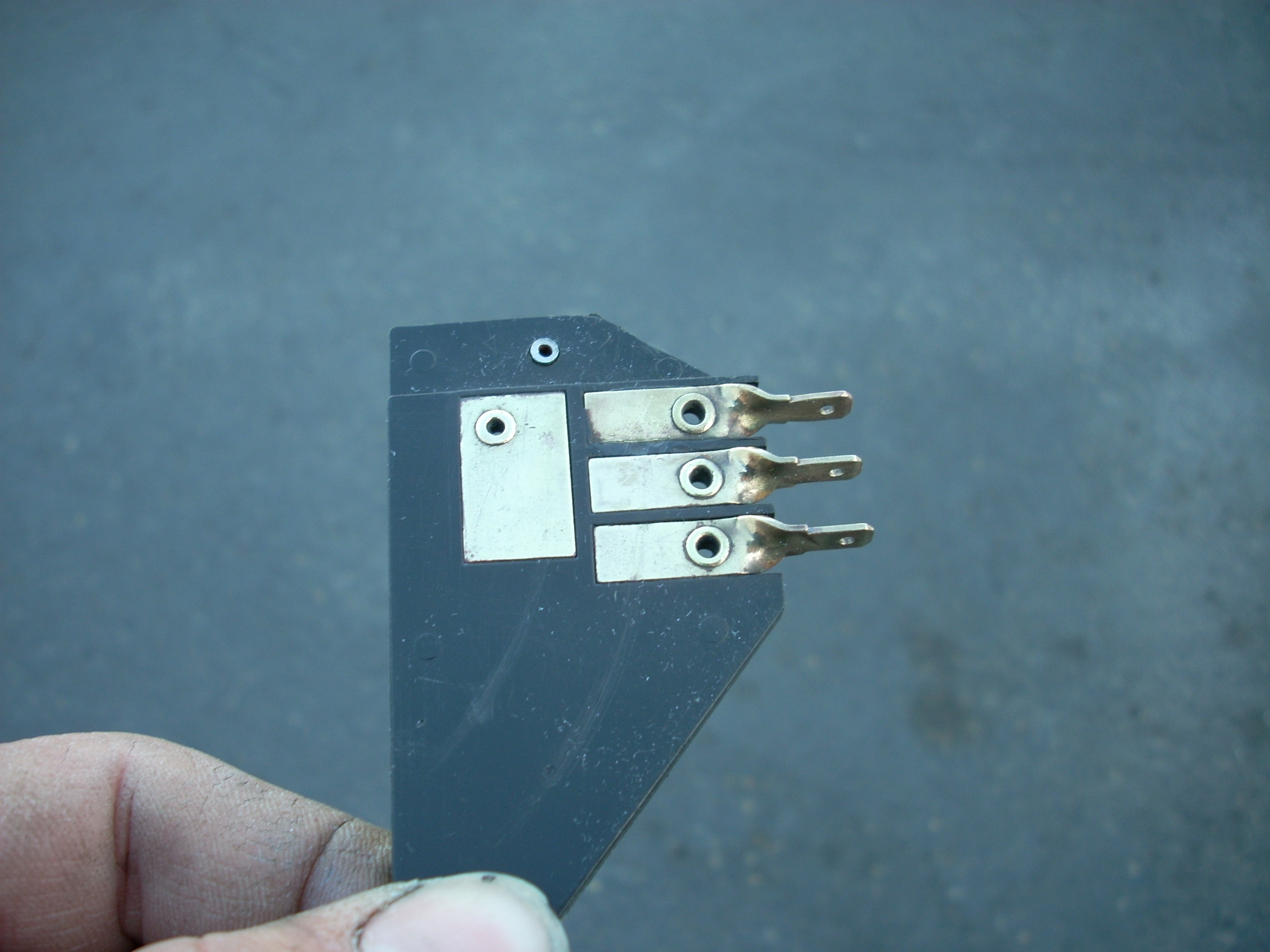

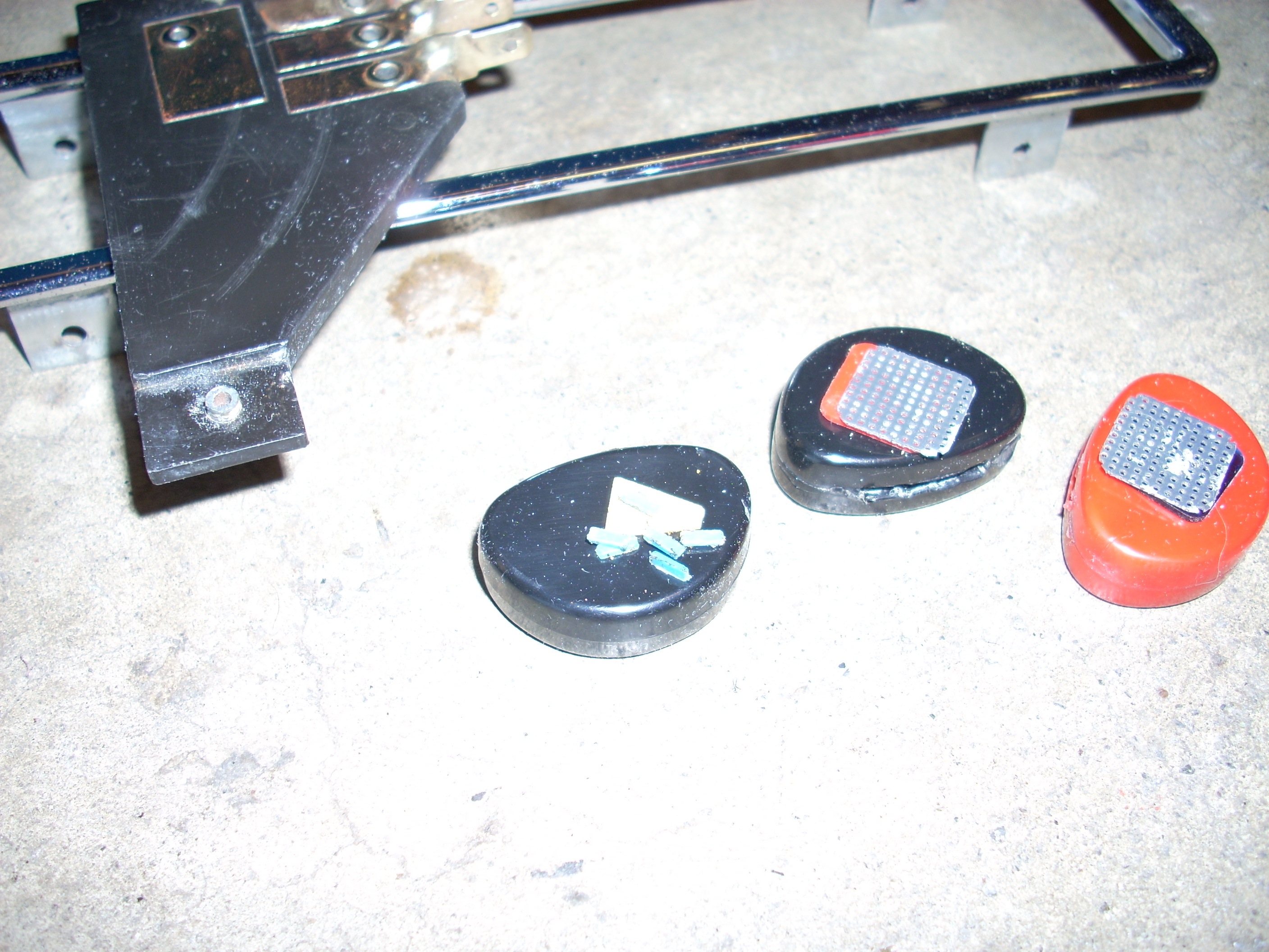

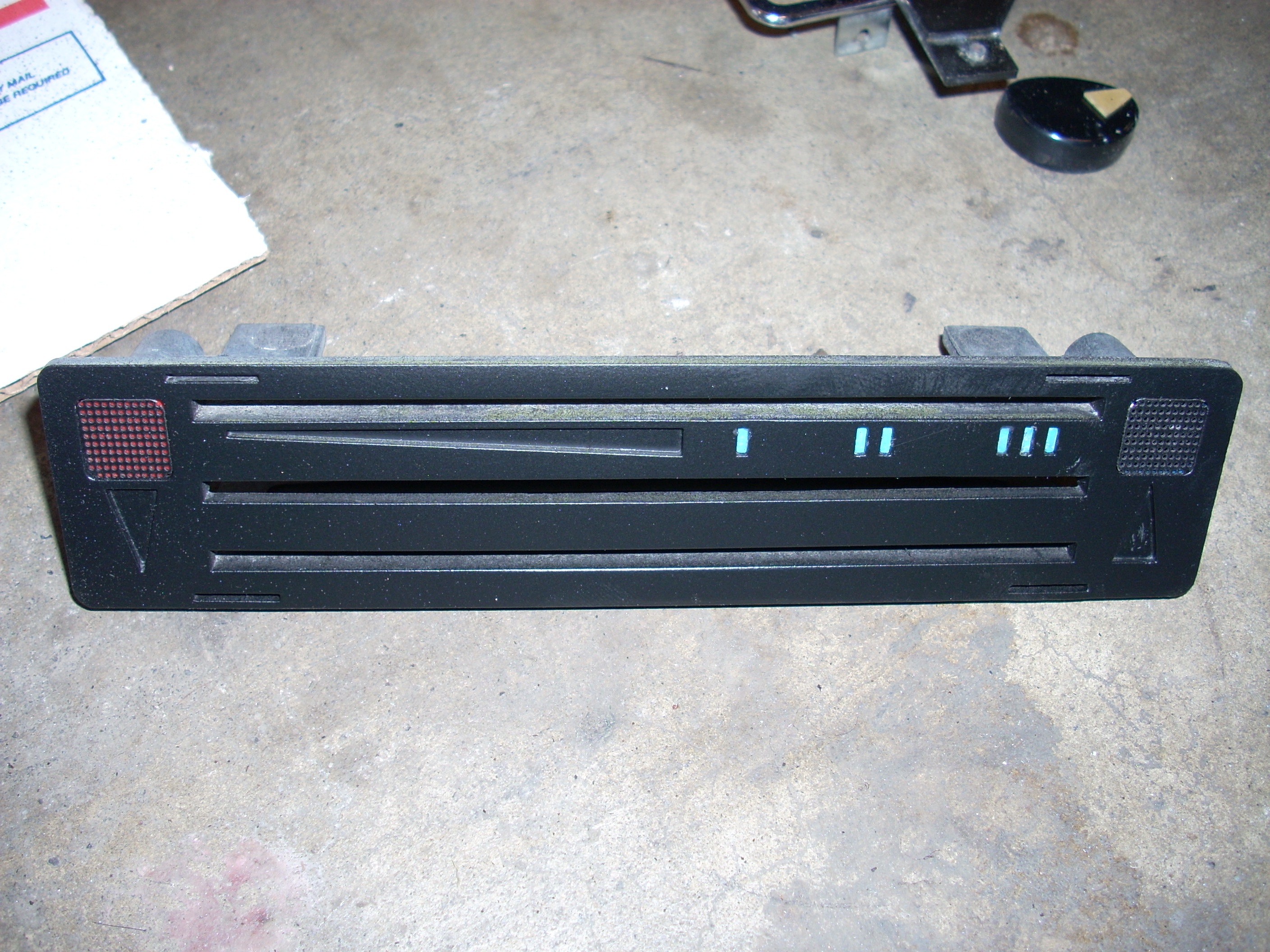

The official first part has begun... These heater controls are the early/european type without words. I like that. Here's what we had to start with: Pulled off the trim ring and hit it with some fine steel wool. Unfortunately the chrome is pitted, so it'll have to be replated. Nasty knobs pop right off. After a thorough cleaning with alcohol and a little polish, they look like new. I cut the rivets holding everything together. Two are holding the cast front section to the rear plate. And two are holding the 'circuit board' to the plate. I also removed the control arms by undoing the circlip and pushing out the pivot pin. The 'circuit board' cleaned up really nicely with a Dremel using a wire wheel tip for the cleaning and a felt pad tip with Blue Magic metal polish for the shine. The red and blue colored lenses and the aluminum 'grills' pop out with a little push from the back (through the light bulb hole). The white and blue accent pieces pop out using the corner and edge of a razor blade. You can see all the blue 'tick marks' and one of the arrows (with a broken tip). Now that the face was relieved of all the 'extra' pieces, I removed all the old paint and sprayed it with flat black enamel. I cleaned each individual blue piece by rubbing it on some 1500 grit sandpaper taped to glass, then rubbing it in some Blue Magic polish. I then glued each one back in with gel type SuperGlue. Keeping track of and working with those little suckers is a major PITA! Then I glued in the lenses, and finally I sanded, painted and glued on the aluminum 'grills'. All of the arrows were either broken or missing, so I'll have to search for replacements. I wouldn't mind finding some reflective material to use instead of plain white arrows. The arms and plate will be sent out in a batch of yellow zinc plating. So until those come back from the platers, this episode is over. Time spent this episode: 2.5 hours Total time overall: 2.5 hours Total cost of this episode: $0 Total cost overall: $0
