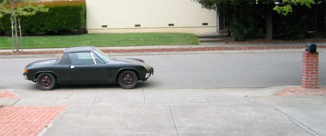

Jim Tabor, Andy Schmidt, Jeff Keyzer, Fiid Williams and I all drove out for this years desert event. We had a great time. My black 914 only made it as far as Reno before I lost a CV joint. The real pisser is that I replaced all four CV joints only around 500-1000 miles ago. ![]() ![]() Regardless, I had a great time. It was a real adventure, but at the end of the trip, we were all rolling home under our own power. So I call that a success. ![]() Attached thumbnail(s) ![]() ![]() ![]()

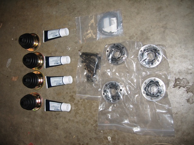

I busted my CV that had been warning me of imminent failure for awhile. It was an un-eventful failure and didn't cause any other damage. I had new CVs from Eric Shea on the shelf ready to install. It took me a few weeks to get around to doing the work, but the new CVs are now installed (what a PITA job) and tested. No performance improvement obviously, but it's back on the road and those should give me any problems for a good long while. I'm very happy with the kit. I also installed the 19 mm Weltmeister sway bar that I got from Mike Mueller and adjusted the ride height in the front so the car is level. I almost went so far as to install the new ball joints and turbo tie rods I have waiting, but I can't keep my car in the shop that long. Customer projects demand attention! ![]() I removed the 914Club banner awhile back. ![]() Attached thumbnail(s) ![]() | Search My Blog
