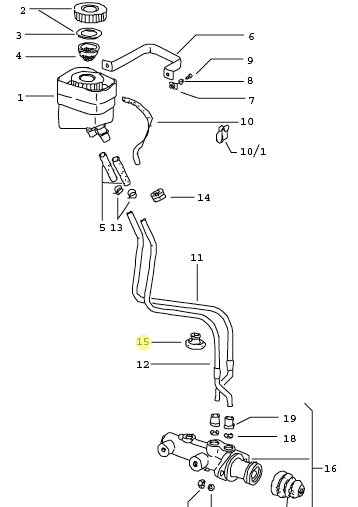

1. Lock Cylinders (ignition, front trunk release, glove box, rear trunk). I'm just interested in scavenging the individual plates inside to rekey other locks. 2. Odometer Reset Cable - Comes out of the back of the speedo, and connects under the dash. ![]() 3. Brake Lines - If you can pull original brake lines out without bending them, they're handy for when I have a car in and one of the ends strips out (happens too often). 4. Headlight Pivots/'Washers' - The actual pivots and the 'plate' that the bolts go through. ![]() 5. Third Seat Belt Plugs - Early cars had the bolt holes for a center third seat belt and shipped with large black plastic screw in plugs. 6. Brake Fluid Feed Line Grommets - Under the tank, the two grommets from the reservoir to the M/C. ![]() 7. OE Door Mount Bolts - Original bolts have a pointed tip. These are always handy for a restoration. 8. Plastic Plugs - The holes in the transmission mount bar as well as the suspension bolt holes in the front trunk shipped with white plastic plugs in them. If you're not familiar with these, I'll send a picture with arrows. There are three on top and two on the bottom, plus two in the front trunk, IIRC. 9. Seat Belt Bolts - Bolts, washers, plastic rings. I like having spares of these. Image Numbers: 5, 6, 7, 8, 9, 12, 13, 14 ![]() 10. Seat Rail Washer/Plate - The bolts that hold the seat rails to the floor had a plate with two holes in it. 11. Underheadlight Plastic Edging - The brace under the headlight bucket (two large holes) had a plastic strip to protect the wiring from getting cut. 12. Bumper Hole Plugs - Behind the front bumper, the plastic plugs. 13. Center Tunnel Covers - The two small plates that cover the access holes in the center tunnel. 14. Heater Tube Grommets - The rubber rings that seal around the heater tubes as they pass from the passenger compartment into the front trunk area. ![]() 15. Headlight Motor Knobs - If you're tossing the headlight motors, I'll take any top knobs that are there. ![]() 16. Hell Hole Drains - Black plastic drains in the engine shelf on either side. (white arrow) 17. Oil Line Hole Plug - White plastic plug for the hole used in six cylinder cars. (blue arrow) ![]()

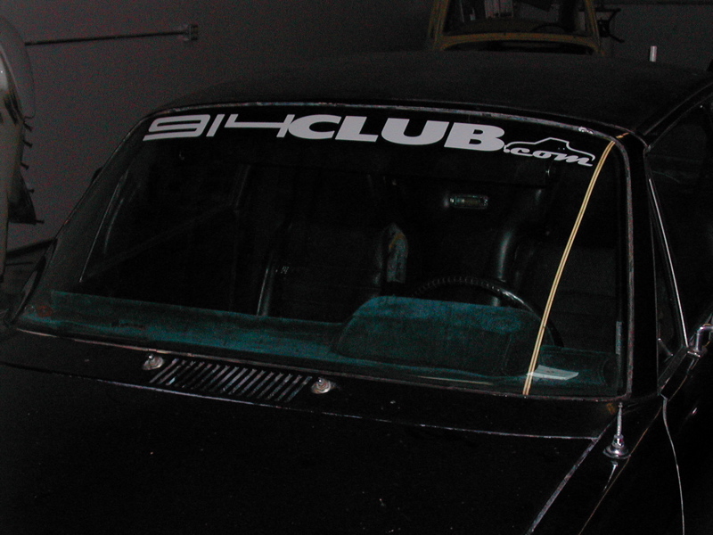

I busted my CV that had been warning me of imminent failure for awhile. It was an un-eventful failure and didn't cause any other damage. I had new CVs from Eric Shea on the shelf ready to install. It took me a few weeks to get around to doing the work, but the new CVs are now installed (what a PITA job) and tested. No performance improvement obviously, but it's back on the road and those should give me any problems for a good long while. I'm very happy with the kit. I also installed the 19 mm Weltmeister sway bar that I got from Mike Mueller and adjusted the ride height in the front so the car is level. I almost went so far as to install the new ball joints and turbo tie rods I have waiting, but I can't keep my car in the shop that long. Customer projects demand attention! ![]() I removed the 914Club banner awhile back. ![]() Attached thumbnail(s) ![]()

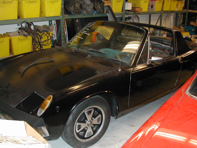

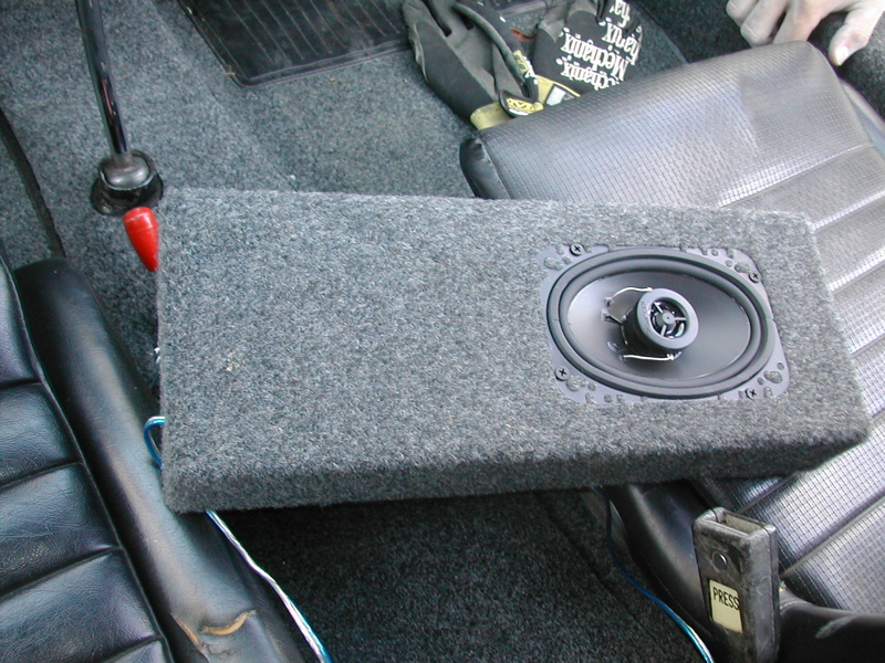

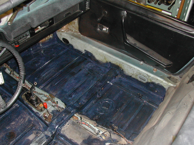

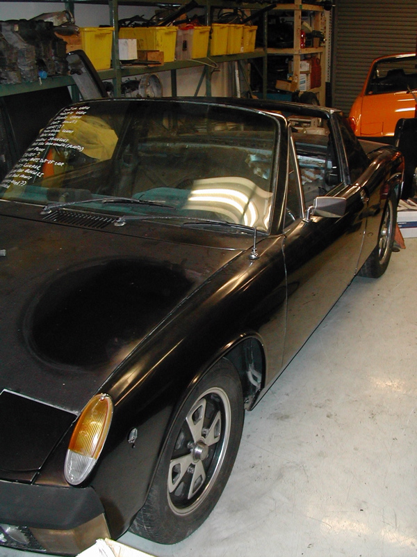

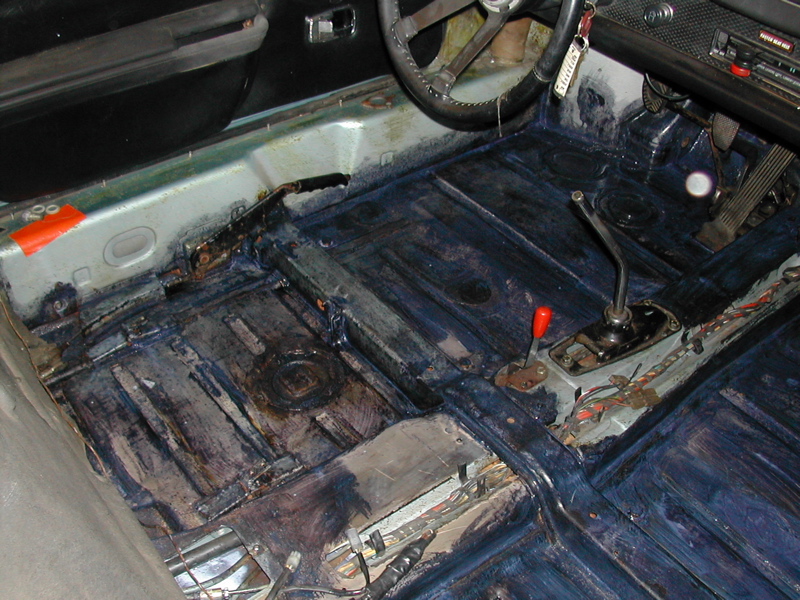

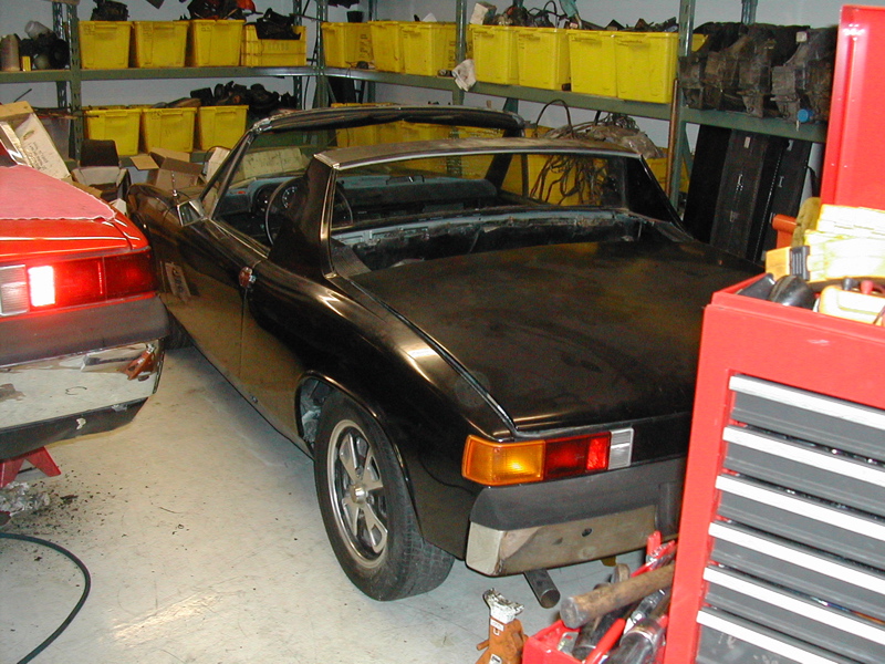

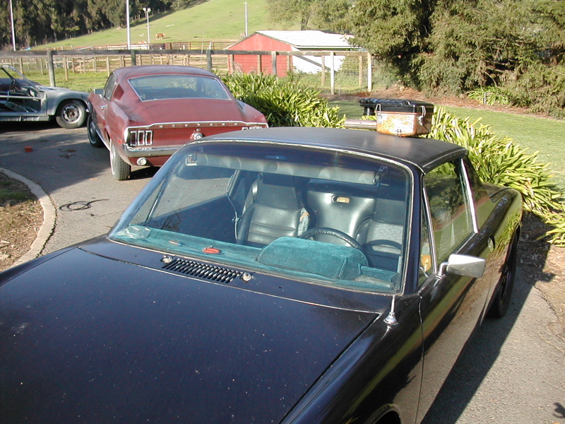

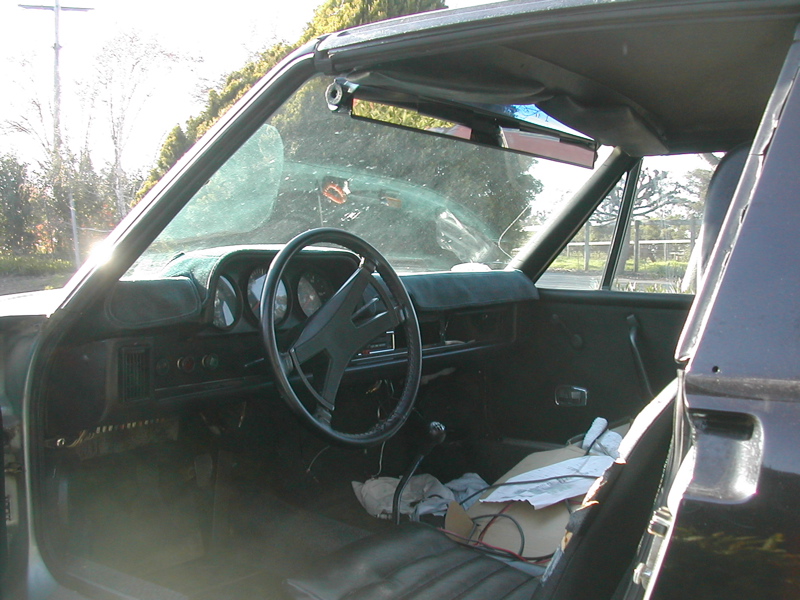

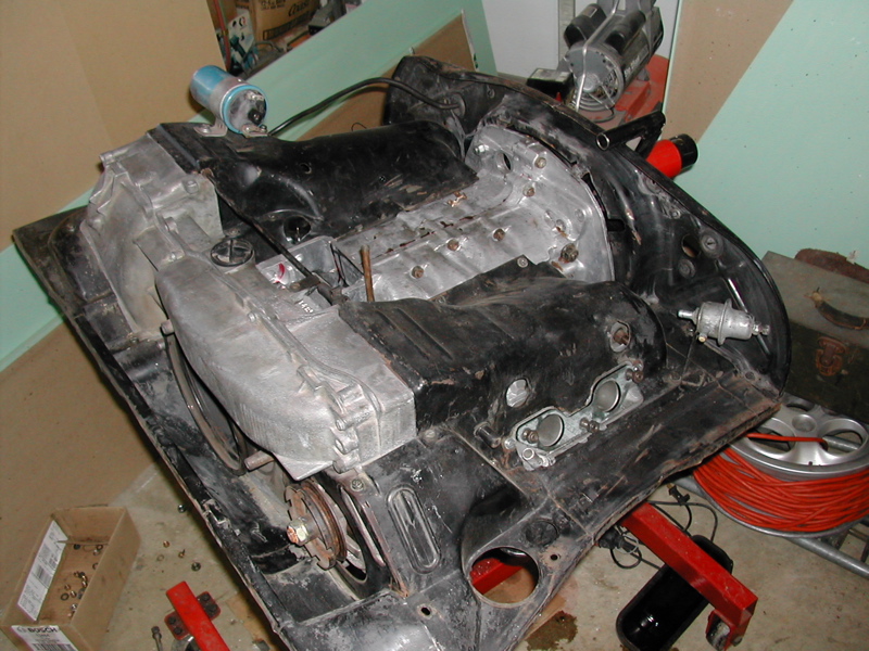

The is the history of my black car as I remember it... I purchased the car from Brad Roberts, in December of 2003. I had recently totaled my green car when I hit a deer. ![]() These are my earliest pictures of this car. ![]() ![]() ![]() The first thing I did to the car was strip the floor tar, lay down some rust converter, and install a morphenspectra carpet kit. ![]() ![]() ![]() ![]() Here are a couple pictures of the hell hole area. ![]() ![]() We pulled out the 2.0 that was in there because of piston slap. ![]() Speaker pods were added April 2004, also from morphenspectra. I went with Eclipse speakers. ![]() I built a 2056 the night before WCC 2004. Unfortunately I didn't make it to the full event, just the AX. But I didn't run because I had an oil leak and was running hot. ![]() ![]() Speakers behind seats went in June 2004. ![]() ![]() I added a 5 panel Wink mirror in March 2005. It's still in the car, but it severely reduces forward visibility. ![]() ![]() And finally, a 914Club banner was added in March as well. ![]() ![]() | Search My Blog
