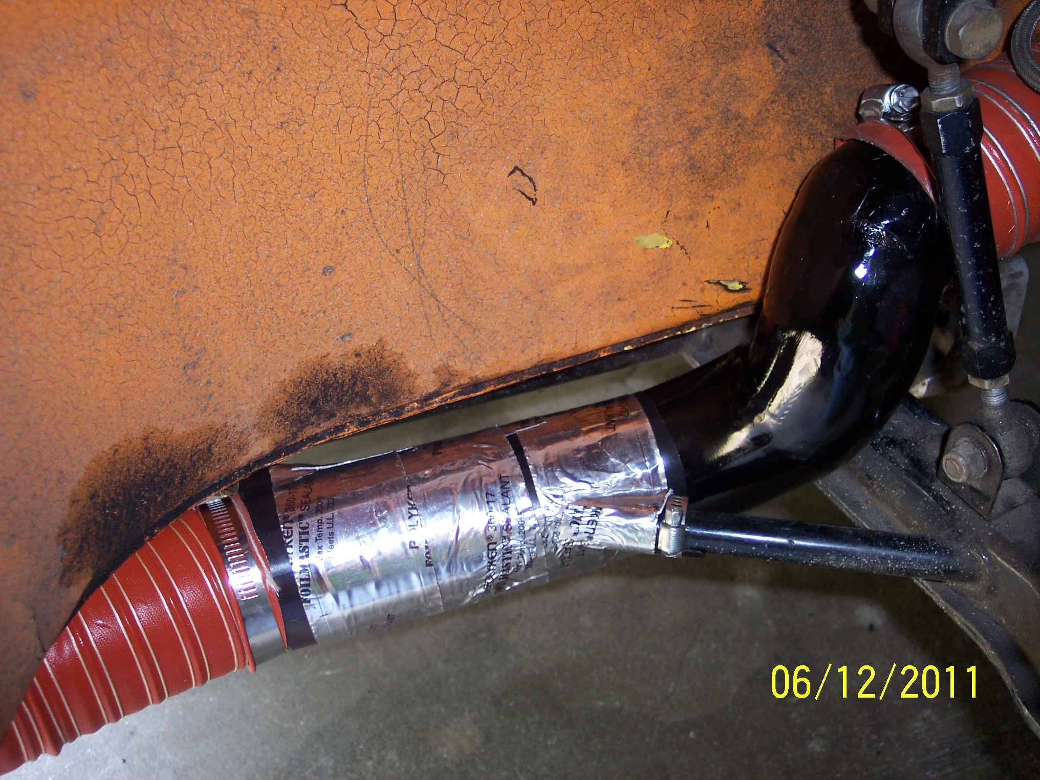

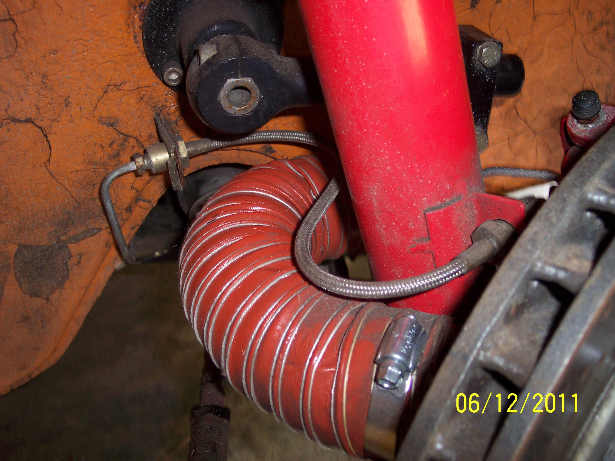

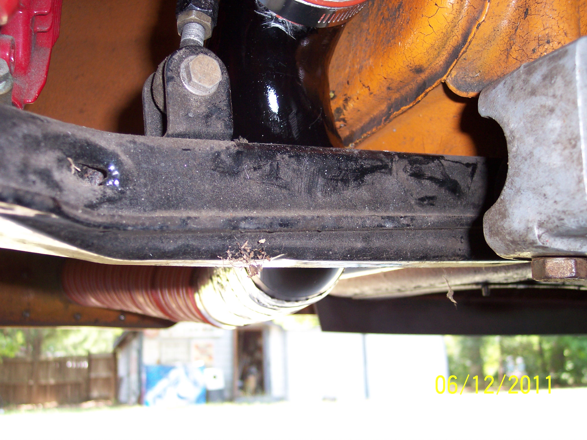

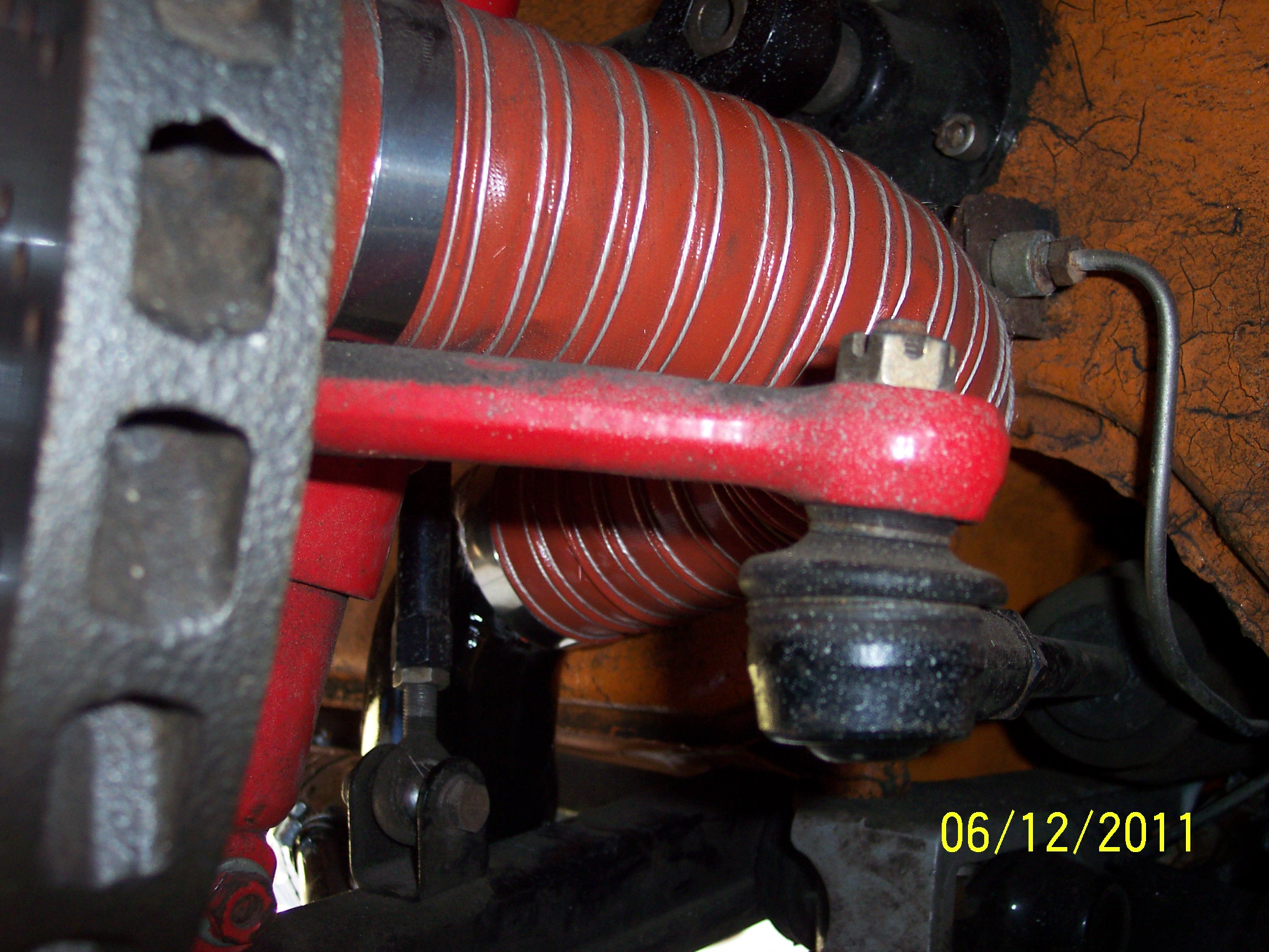

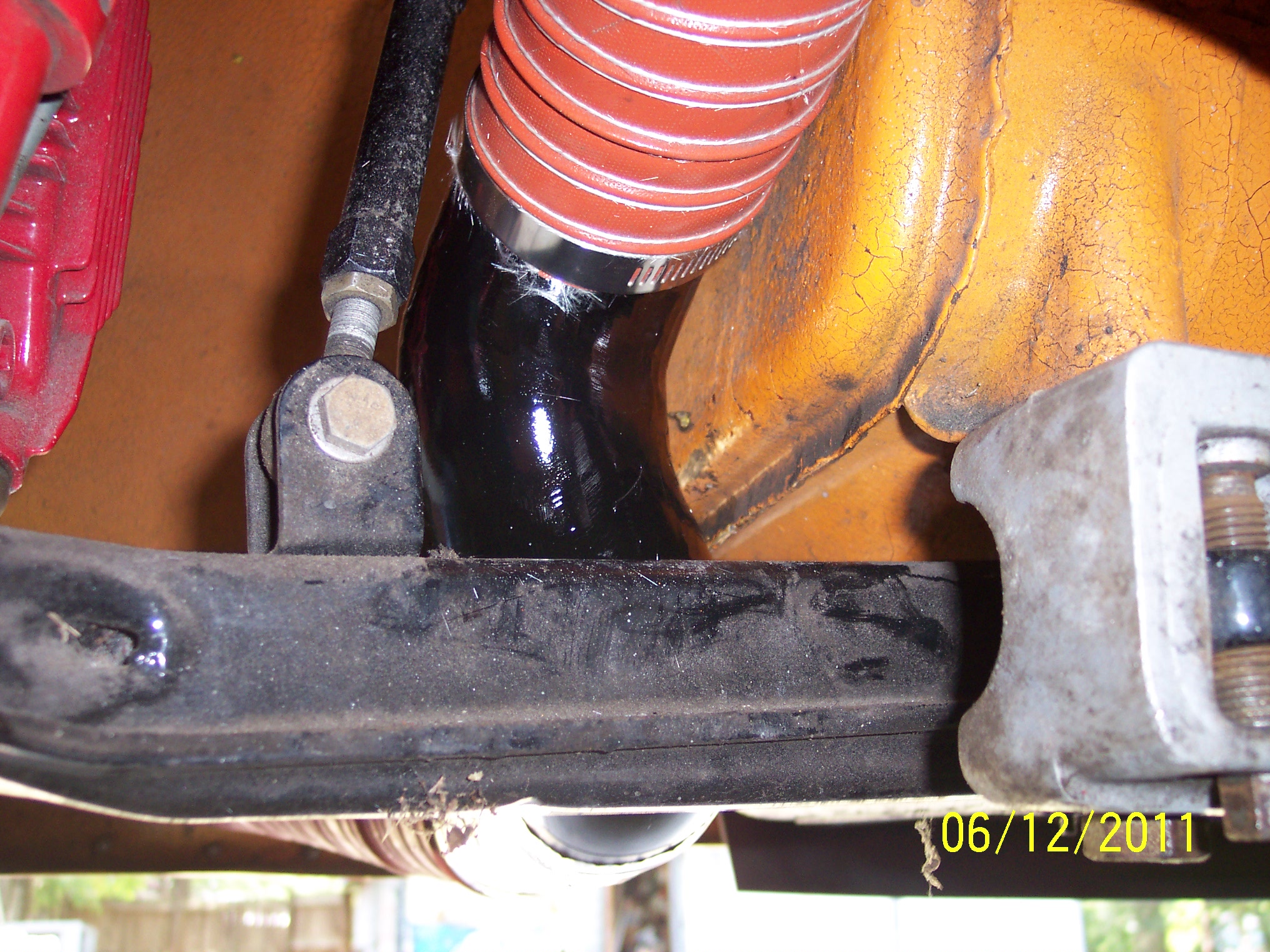

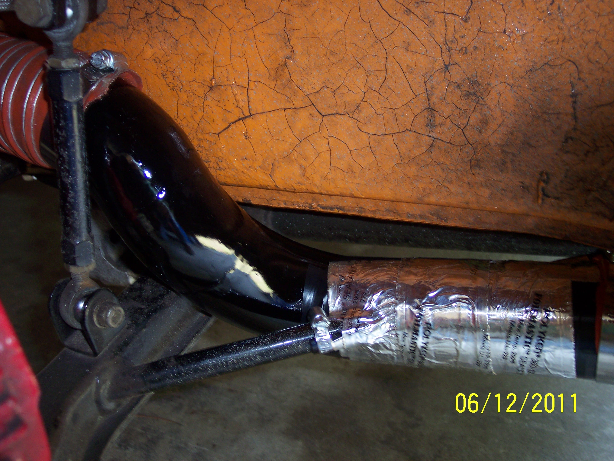

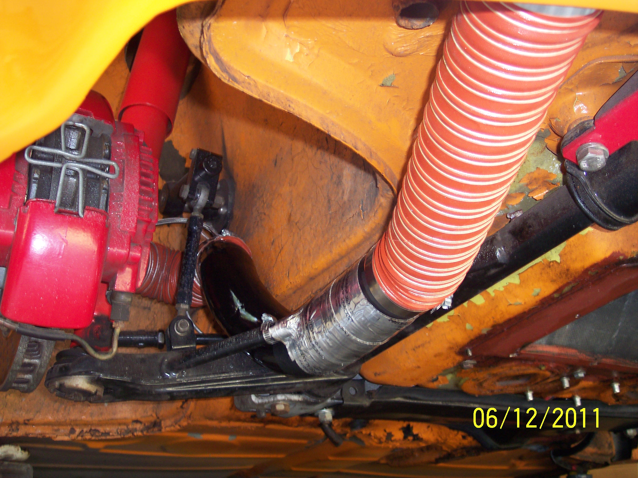

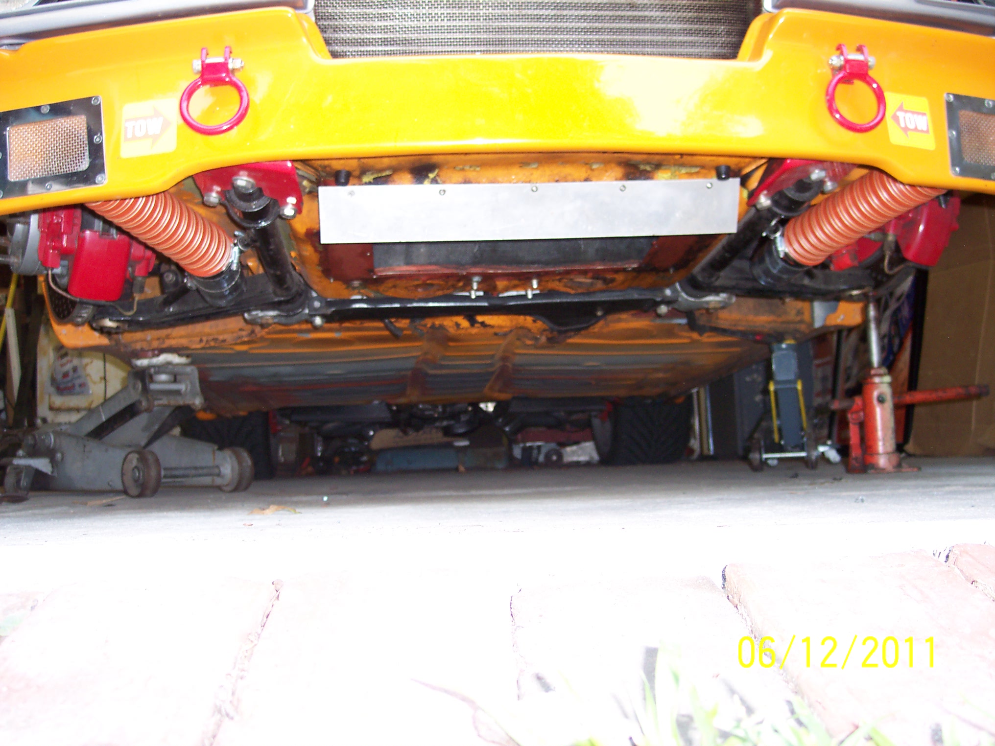

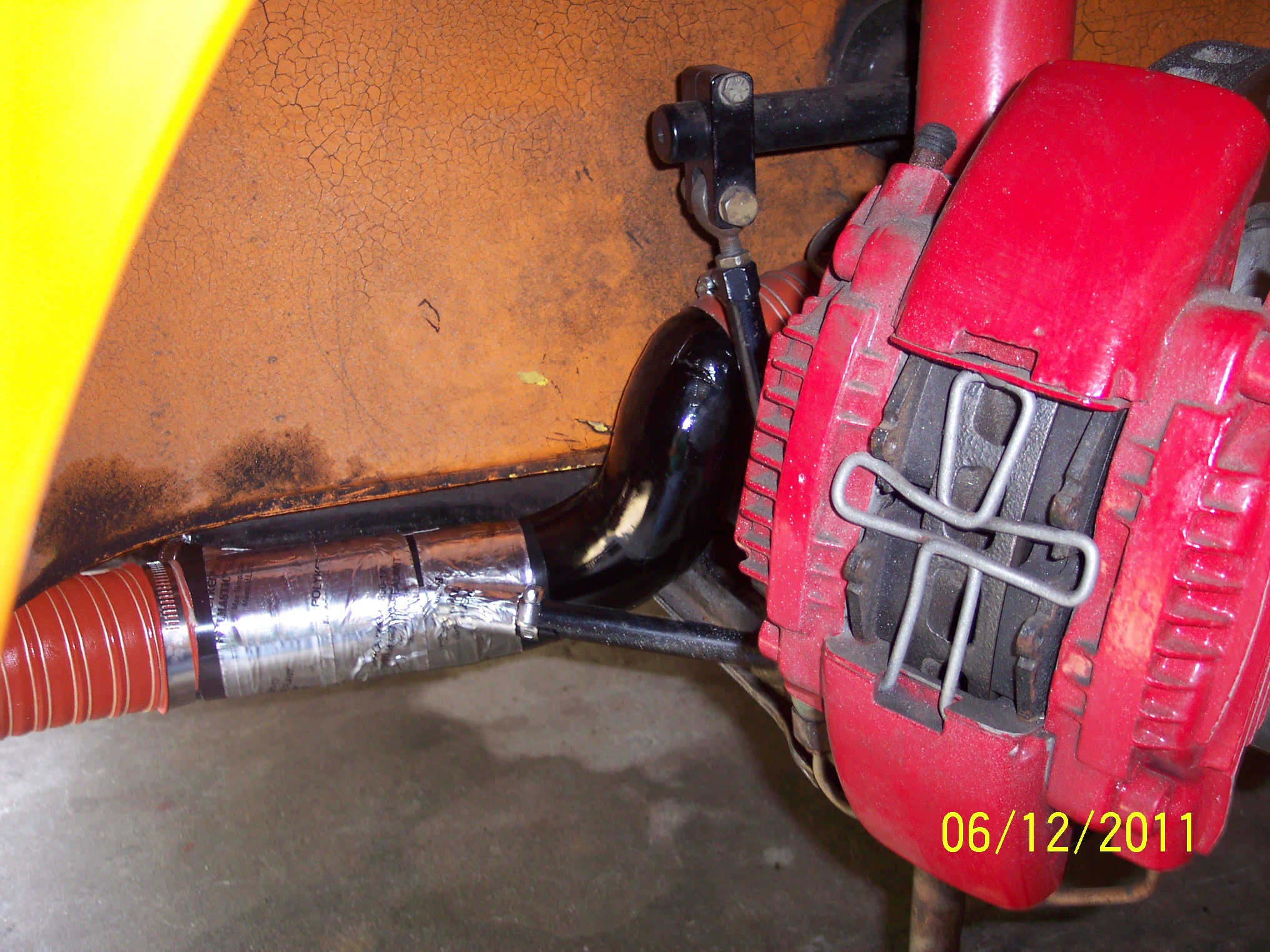

This weekend I made my front Brake scoops on my spoiler functional. I'd seen the brake manifolds from Smart racing but I thought I could make a better looking unit for less money. I made mine from a couple of 2-1/2'' J-bend exhaust pipe sections from Summit Racing. The pipes were $18.00ea. I cut, sectioned, and reshaped them to go up and over the A-arms. Nice tight fit. They may not be perfect but I guess it's better than nothing. Plus it was a lot cheaper than the Smart units. Ron Attached thumbnail(s)
