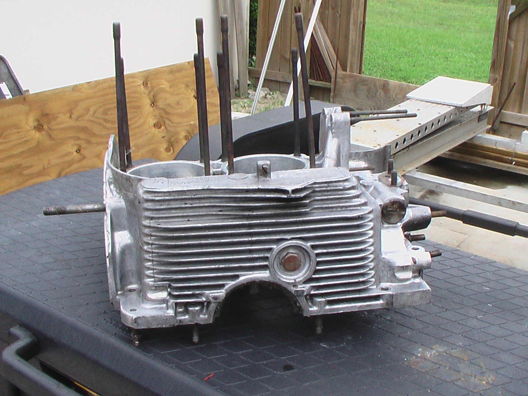

I've got parts from a 2.0 "GA" 914 engine. The case and heads are gone so this is whats left. All items are OEM stock: Crankshaft.....$75.00 Cam......$25.00 oil pickup and baffle with rubber gaskets....$25.00 94 mm cylinders (ready to be 96's).....$75.00 I will sell items separately. you pay shipping costs. If you don't like the price make me an offer. Use these as cores for that killer 2316 you've been wanting soooo bad. Paul flag.gif Attached thumbnail(s) ![]() ![]() ![]()

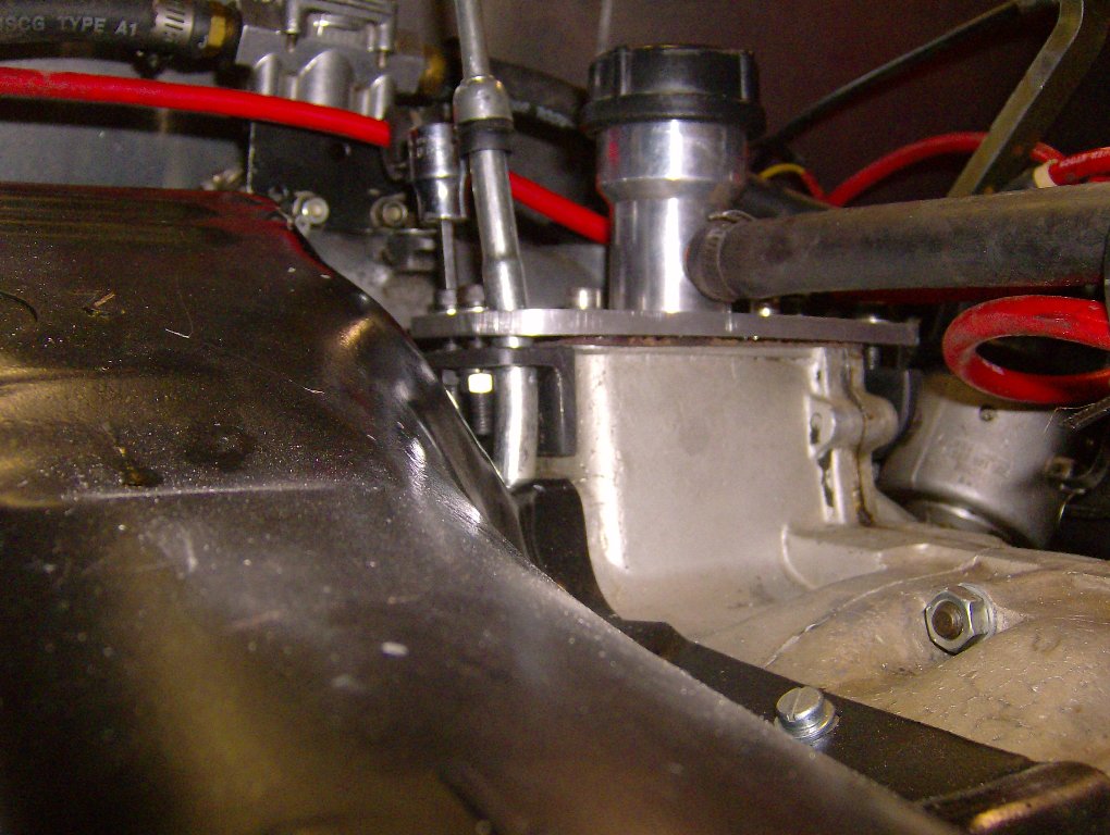

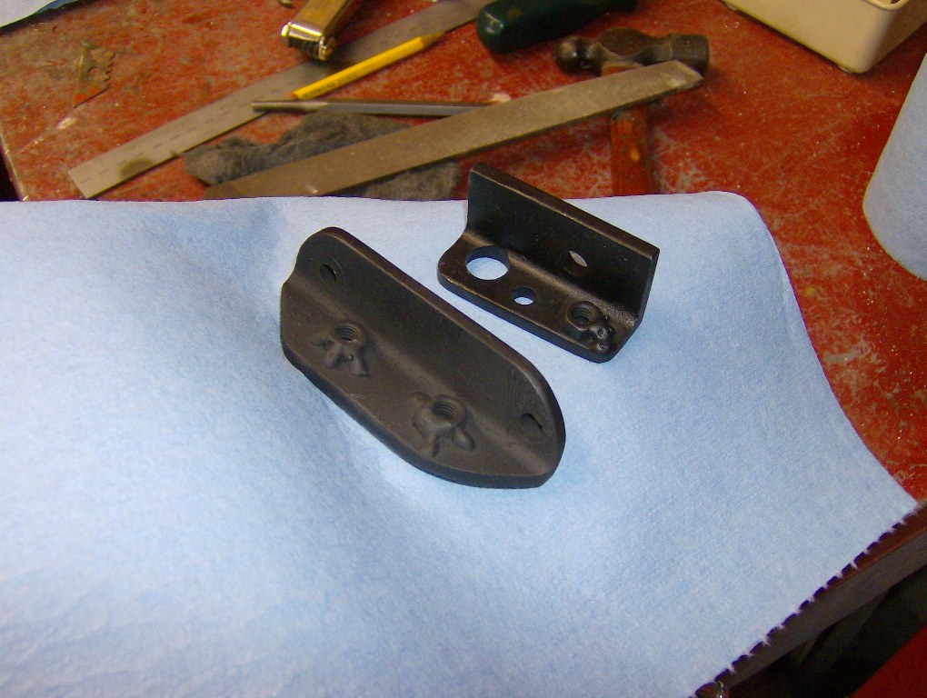

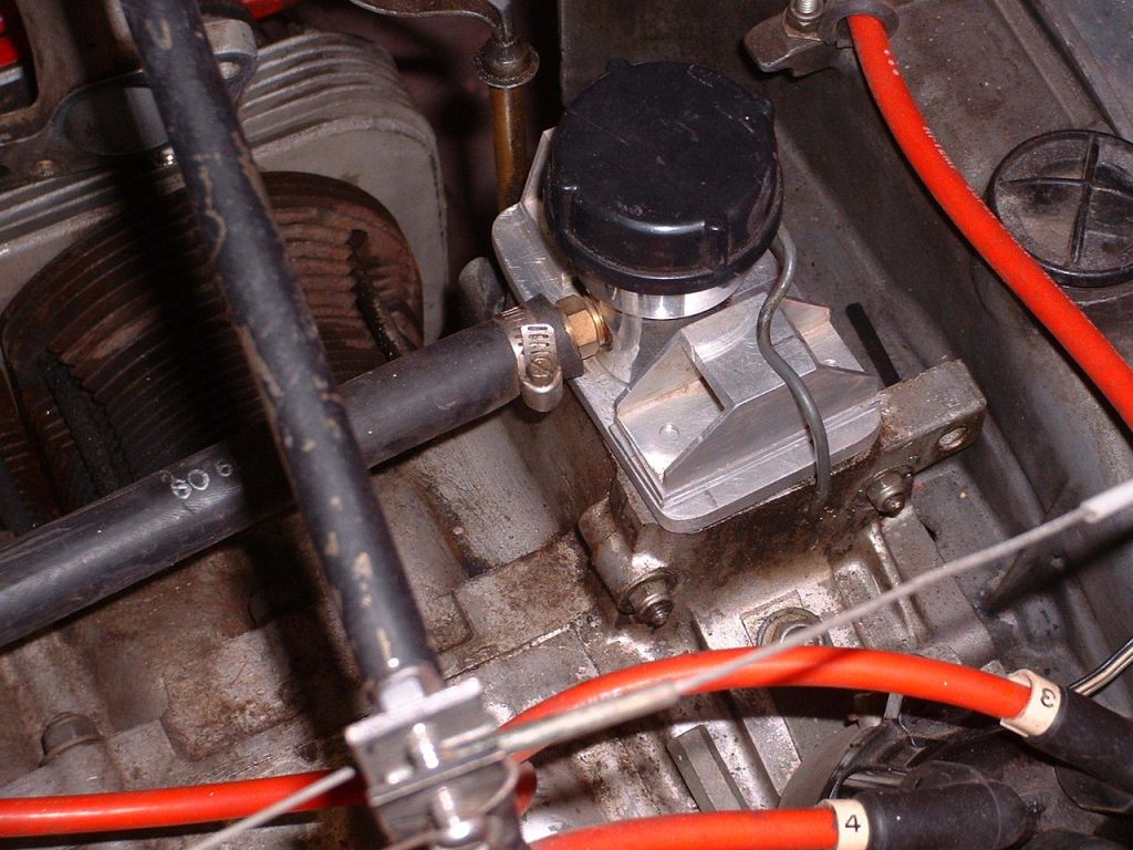

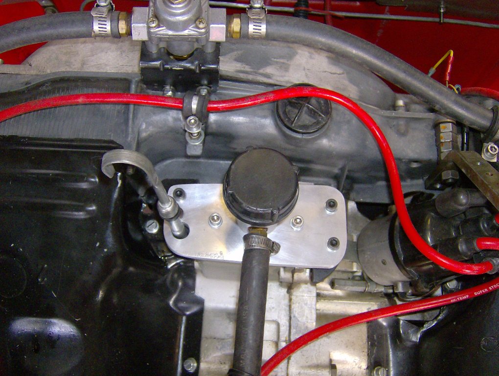

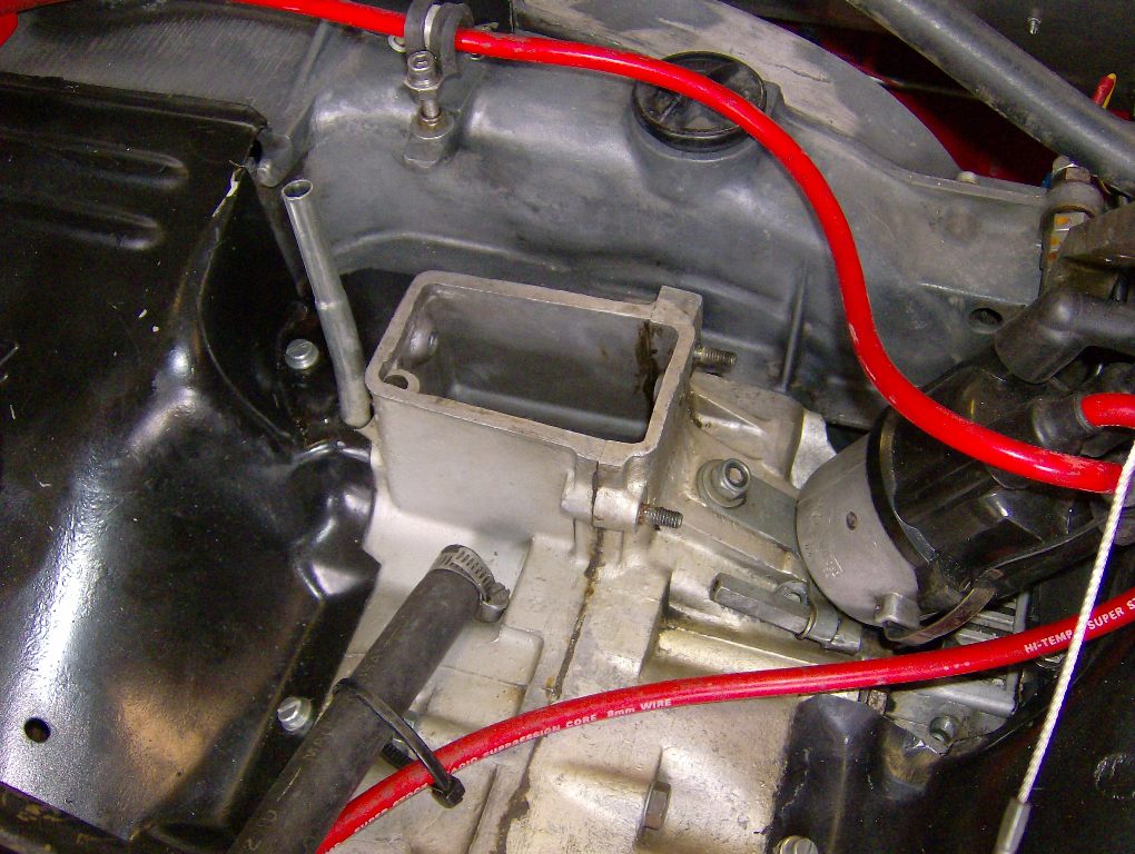

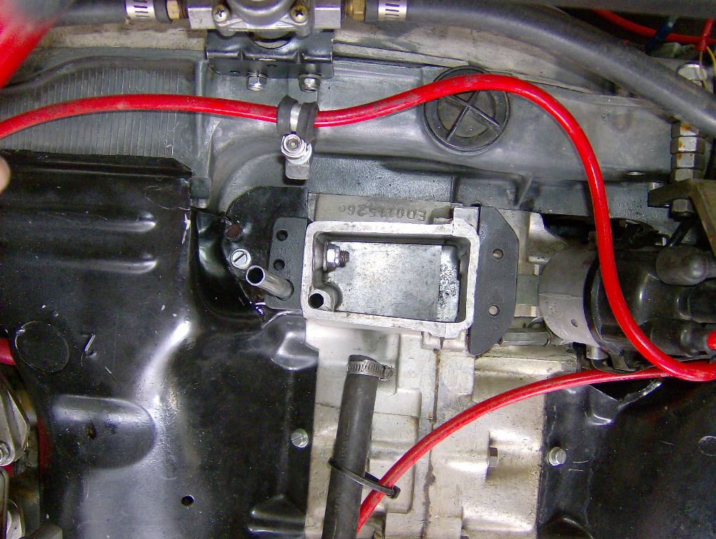

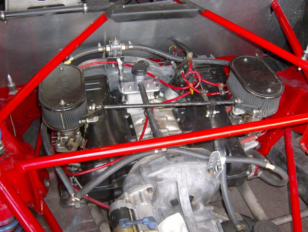

Last weekend during an a/x I had a problem with my oil filler cover coming off the “neck” of the engine case. I made the oil filler cover pictured below a few years ago because I didn’t like the stock tin one and wanted something with some bling. It never gave me a problem until last weekend but it did leak some oil once an awhile. The problem was the stock bale wire spring didn’t apply enough pressure on the gasket so give a good seal. I thought there must be something else I can do. Picture of old filler cover on engine I figured if I could bolt a cover to the case, the bolts would tighten to apply pressure to the gasket. I looked at a spare engine I had and saw the two small 6mm case studs on the right side of the filler neck. All I needed to do is cut and fit a small steel angle to bolt on to those studs. I used a piece of 1/8” x 1” angle and cut/drilled it to fit. It also helped that Jake seemed to have changed these studs out to longer ones because the ones on the spare engine were much shorter. The studs were long enough to get the angle over them and have room for a lock washer and nut. On the left side of the neck was not as easy as the right side. The dipstick was right next to the neck and there were no studs to use to attach the angle. The dipstick would mean the angle would be much shorter. On my engine Jake has drilled out the small hole where the bale wile spring attaches to the neck. He then installed a bolt with a hole drilled in the head of the bolt to receive the end of the bale wire. The intent I assume would be to spread the bale wire out therefore placing more pressure on the filler neck gasket. I decided to bolt the angle to the case using this hole. I also welded the nuts to the bottom of the angles. The less parts to come loose the better. Picture of the case with no filler cover Picture of the angles. Picture of angles installed The new filler cover was made from a 1/4” piece of aluminum. I made it so it would cover the neck and by about 3/8” on the front and back sides and wide enough to be bolted to the angles. A hole was drilled for the dipstick. I used JB Weld to epoxy the filler funnel to the aluminum plate. The second picture below shows the gasket installed. A second piece of ¼” aluminum is used locate the cover on the neck and holds the gasket in place. Pictures of the cover on the table. I used socket head cap bolts because they look cool and dirt and engine grime doesn’t stick to them like hex head bolts. Pictures of cover installed. I was able to get some shots from the bottom which show the gasket squeezed down tight on the case neck. I’ve adjusted the bolts from the time I took these pictures so that the gasket is tightened down as evenly as possible. The only problem is when I install the engine scoop, you can’t see this piece at all. Attached thumbnail(s) ![]() ![]() ![]() ![]() ![]() ![]() ![]() ![]() ![]() ![]() ![]() ![]() ![]() ![]()

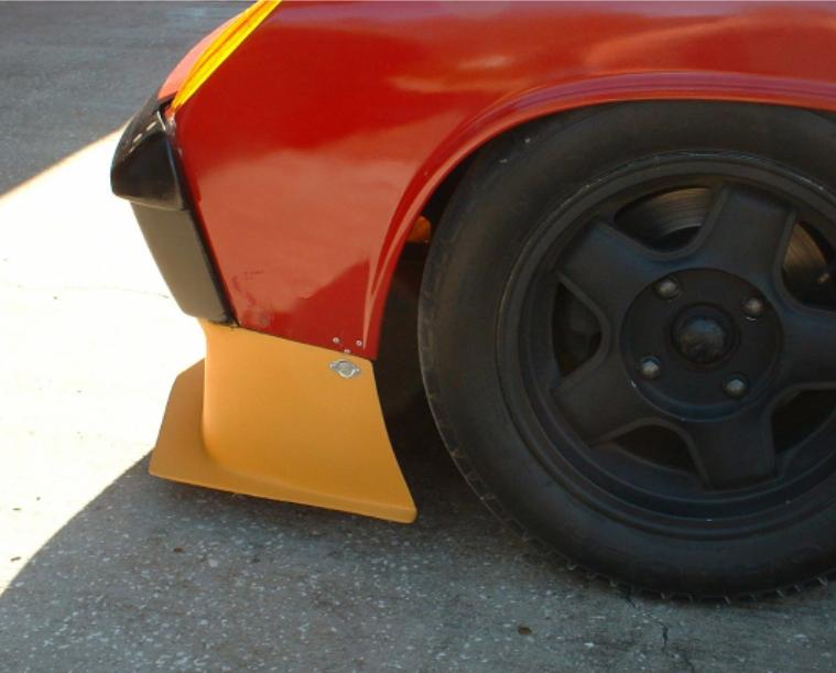

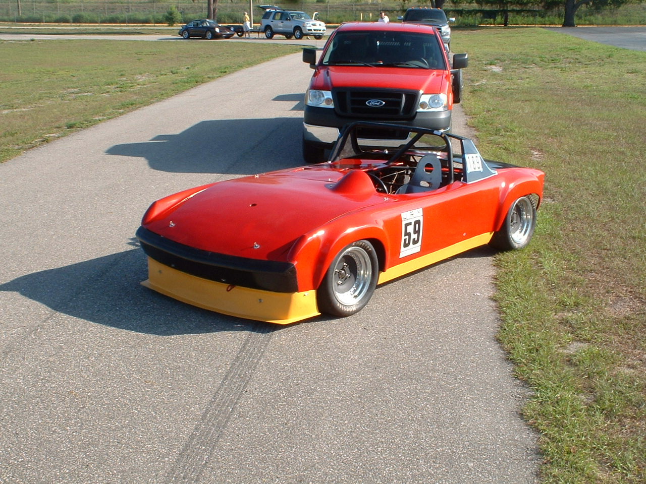

This is some details on my front bumper/spoiler. The bumper started as a standard AIR f/g bumper with a GT oil cooler cutout. I closed up the cooler cutout with f/g. The spoiler started as a "Deep Limited Edition" spoiler from AIR. It had the same shape as the LE spoiler but was about 3 inches deeper. At first I added a aluminum strip to it to lower it another inch or so and I added an aluminum splinter. I later replaced the aluminum with f/g as I kept bending up the aluminum. At one point I added huge brake ducts but they kept cracking the f/g, so when I went to an a/x only car I deleted them. I also f/g the bumper to the spioler so it is now a one piece unit. It is held on to the car with 6 dzus 1/4 turn butterfly fasteners. I can get it on and off in about 10 seconds. I have to take it off when I load it on my trailer because it is too low and hits the ramps. The lip or splinter is entirly f/g and is about 3/16" thick. It will rub the track surface under hard braking once in awhile. I also have a towing eye that is screwed onto a theaded rod which sticks thru the bumper. This lines up with my winch on the trailer. Attached thumbnail(s) ![]() ![]() ![]() ![]() ![]() ![]() ![]()

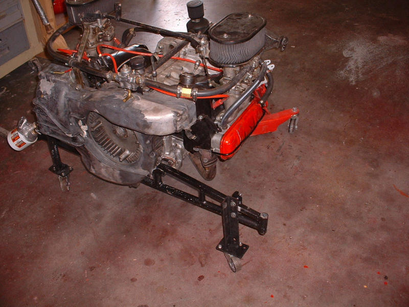

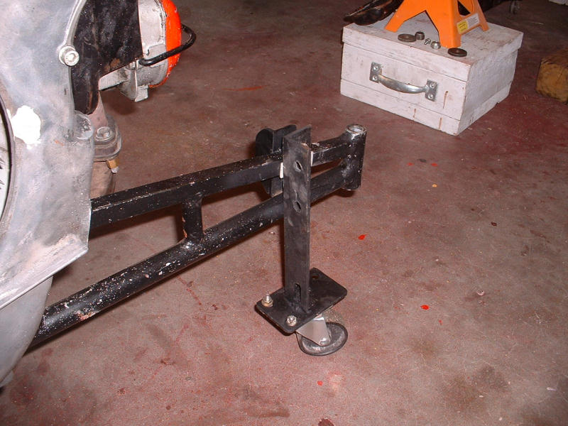

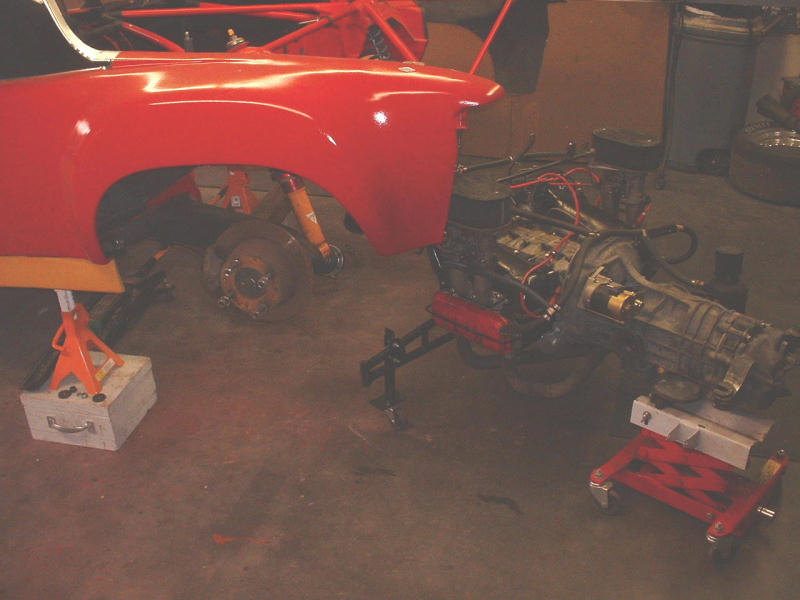

After looking at several ideas for engine removal devices I begain thinking of another option. What if I had a set wheels that were bolted to the engine or maybe the engine crossbar that I fabricated? I rounded up some angles and some caster wheels and came up with a plan. I welded 3/16" x 2" x 2" angles to a 1/4" plate that I bolted the caster wheel to. I first bolted the angles through the crossbar than I removed the engine. Once the engine was out of the car I removed the crossbar and welded the small angles to the bar. Than they are always in the correct location and makes things much easier. Here is how it works... 1. Jack up the car so it is level. 2. Bolt the angles with the wheels to the crossbar. 3. Place the floor jack under the front of the engine. 4. Place my cheap tranny jack under the tranny. 5. Unbolt the engine crossbar bolts and the rear tranny bolts and lower the engine to the ground. 6. Jack up the car high enough that the engine can clear the car. 7. Roll it out. 8. Have a cold imported beer. ![]() BTW, I removed the engine from start to finish in 45 minutes by myself. Could have been quicker if I had all the tools laid out and took the body sides off. (4 engine bolts, 4 wires at the dizzy, cl/th cables, fuel line, 2 wires to the starter, 2 axles, shift rod) ![]() Attached thumbnail(s) ![]() ![]() ![]() ![]() ![]() ![]() ![]()

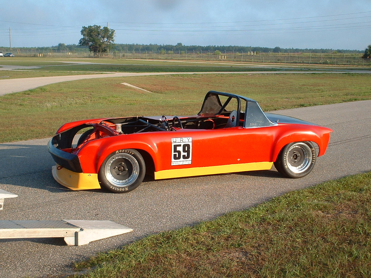

I ran a PCA event today. I was fourth overall. A Boxster with a four time National Champ driving, a 996 GT3 and a early 911 beat me. My group ran last in the hottest part of the day and I was sliding all over the place. This time the frontend was sticking and the backend was loose. Also the oil leak is back but it is not the v-cover gaskets, it seems to be a p-rod tube seal on the right side. I'm going to adjust the valves before the next event so I'll fix it than. I have another idea at the front on the engine that I need to look at too. Now for the rant: This was a "multi event weekend" hosted by the Citrus Region of PCA. It is held in Mt. Dora FL, a little village type town with shops and a old hotel that is the main site. The typical PCA weekend get-a-way. I only attend the a/x as I can't drive my car in the rally and my car is not really concours prepped. We have a ten year old daughter and there nothing for her to do. The entire weekend is $2-$300. I go to register of the a/x and the entry fee is $50.00 fuching dollars!!! And the kicker is because I only am registering for the a/x and not the entire weekend I don't get classified with the other cars. This means no trophy if I win. I could get FTD and don't get anything. $50.00 for 4 runs with no stupid trophy? There were only 6 guys that showed up for the a/x and each of us were saying we won't be back. I spoke to a few of the people and they were saying the intent is to have you sign up for the entire weekend and each event of the weekend will be cheaper. So they may have made $300 from the six of us this year but they will make $0 from us next year. If they would charge $20-30 as most regions do for a typical a/x I'd be back. Instead of making a little money, they will be making no money next year. Who is the marketing wizard that put this plan together? Rant #2: The average age of the people at the event had to be 55 or older. At this rate the PCA will be gone in 15 years. Attached thumbnail(s) ![]() ![]() ![]() ![]() ![]() ![]() ![]()

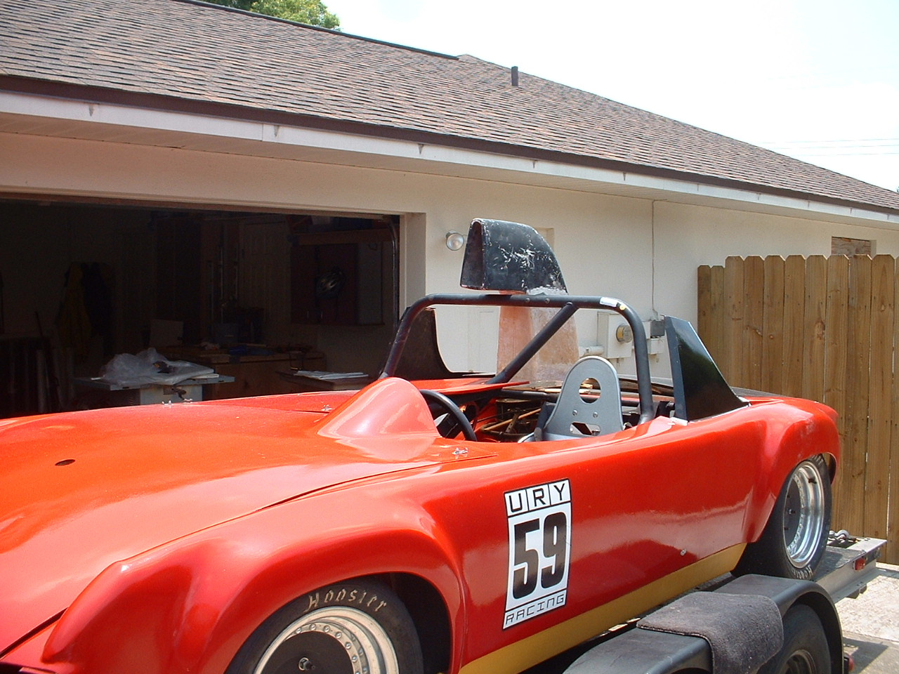

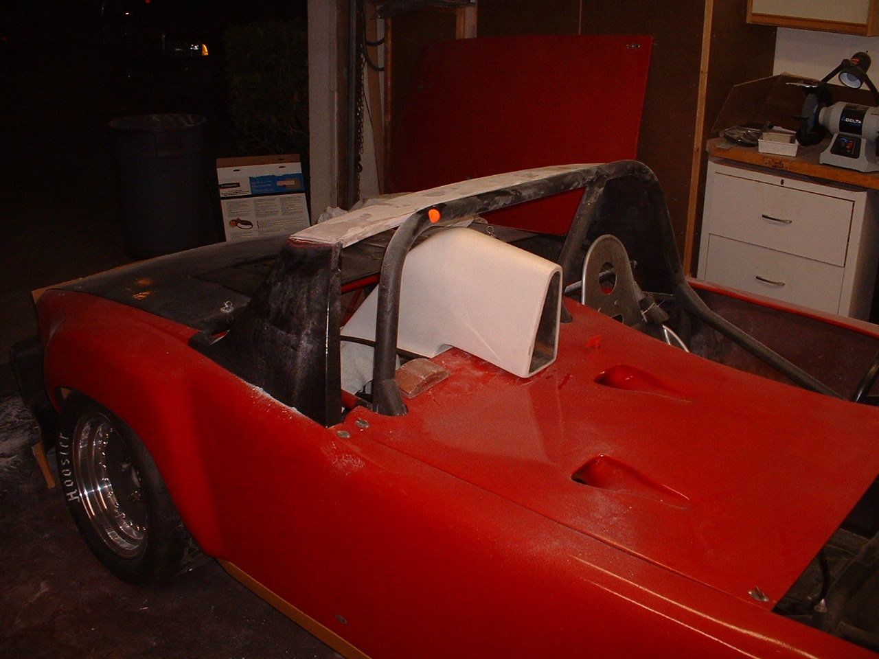

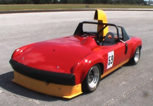

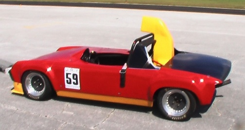

I need to fabricate a engine lid. Someday I'm going to beat someone and they're going to protest that I don't have a proper "hood" on my car. Rules do say you need someing over the engine. I thinking I add a cover that also has a scoop so I can bring some cool air to the carbs for a few extra HP. And besides it will look cool. The first picture is a Ferrari but I don't like how it sticks over the top of the bar. The Ferrari 333 had the scoop sticking thru the roll bar which is what I want to do. I found a Baja bug oil cooler scoop on Samba.com for $40.00. It is in the last picture below. With a little work it will be perfect. 4-7-06: I recieved the scoop to day. It will be a great starting point. 5-24-06: I've been working on the scoop and have extended it about 12". I decided to mount it so it is OVER the TOP of the roll bar. 6-26-06: I've now decided to duct it to the air cleaners. It will sit on a cross bar which will be held in with pins so it can be removed quickly. The bottom of the scoop with be formed so it directs the air. There will be a seperate bottom piece which will mount under the carbs and remain in place. The carbs will only be 1/2 covered with the scoop. 10-22-6: Ran my first a/x with the new scoop. It didn't fly off at speed so that a good thing. I realize it's not making me faster but it is getting cooler air to the carbs and that was the point. See the pics below of the finished product. It must have done something good. I set the fastest time of the day. Attached thumbnail(s) ![]() ![]() ![]() ![]() ![]() ![]() ![]() ![]() ![]() ![]() ![]() ![]() ![]() ![]() ![]() ![]()

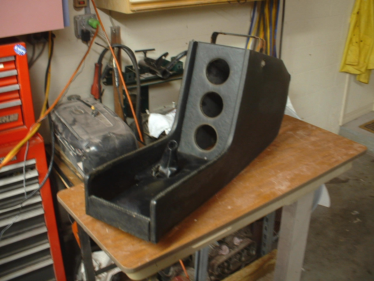

My console.... The "boot" that goes around the shifter is not original and something has chewed on it a little. The console itself is in fair shape. Maybe some Armorall will clean it up a little. I wiped it down to get the dust off of it and it looked good when it was still damp. But when it dried it could have looked better. The console has been sold.[b] Attached thumbnail(s) ![]() ![]() ![]() ![]() ![]()

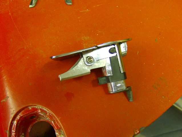

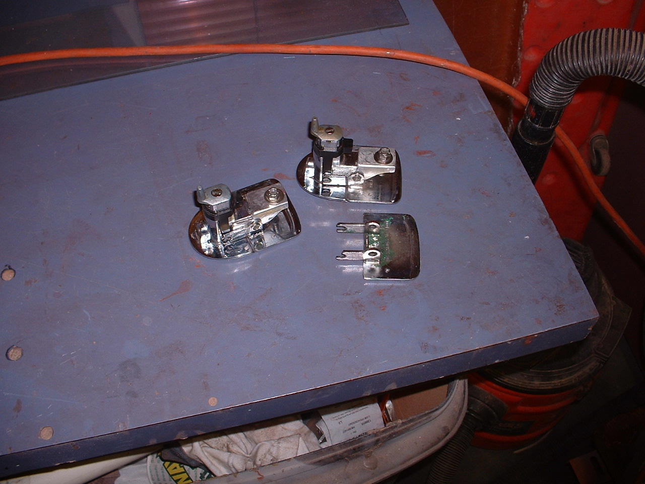

Let me explain the ins and outs of one of the poorest designed aspects of the 914; the outside door handles. They can break in several different ways and without warning, but they can be repaired and broken parts can be replaced. New repacement handles are about $200.00 from the retail outlets. Why it breaks: First an overview. The handle is made of "pot metal" which is a cheap material which is cast in a mold and than chrome plated. I believe there are several things that cause the handle to fail. 1. First of course is simple abuse. People pull on the handle as if it were a door on a truck. Pulling too hard will cause the handle to bottom out and puts way too much stress on several different parts. Don't pull the handle to open the door. Only pull the handle with enough force to hear it "click" and release. The hatch is spring loaded and the door will pop out when the handle releases the latch. 2. The pivot pin becomes clogged up with 30+ years worth of crap and the handle become harder to release, so you pull harder on it. See item #1. 3. As the cars become older and when rust starts in the longs this weakens the structure of the car, the car sags at the doors. The door gap begins to close up. This effects the alinement of the door latch and the pin that is mounted on the body of the car in the jamb. As the door gap changes the pin and the door latch become harder to release. So you pull harder on the door handle. See #1 again. Parts of the Handle and How They Can Break: Handles are different from the right side and the left side and they have a "R" and "L" on the back to indentify them. The difference is the flapper piece is shaped different to follow the curve of the door. You can use a right side handle on the left side and vis-a versa. But a right side flappers can not be used on a left side handle. 1. The "Slider" is the plastic piece that actually strikes the release piece in the door to unlatch it. This can break in a couple of different places but when it is broken your door can not open. It is plastic and over the years get hard and brittle and breaks. The slider has a tab on it that pushes on the door latch, this tab is what break off in most cases. When you go to remove you handle you'll find this little piece of plastic in the bottom of your door. The good news is this piece is being reproduced and sold by Pelican Parts and several other suppliers. It costs less than $20.00 to buy it but you do need to take the handle off of the door to replace it. It can be replaced without taking the handle apart but be careful with the arms of the "flapper" when you do it as the arms are also a weak point and will break. See the first picture below. It shows a stock yellowing one, the broken one in the middle and the black replacement from Pelican. 2. The "Flapper" is the hinged piece that you grab and pull to release the door latch. The flapper has two "arms" or "fingers" which break off. The handle will work with one of the arms broken but not for long. A broken arm allows for the flapper to hit the body of the handle and the other arm will soon break. Once both arms are broken, the handle won't unlatch the door. The left (driver's) side being that it gets used the most use, is the most likey to break. Pelican has them in thier catalog but the are "NLA" (no longer avaible). Mid America has them in thier printed catalog but not in thier on-line catalog. (Mid America's 2004 catalog had them listed for $49.99 and the 2005 catalog has them listed as $129.99!) When I spoke to them they said thier vendor dropped out about 6 months ago. Finding good left side flappers is getting harder and harder. You have to shop for one in the classifieds, find a shop with one or hope one is being sold on ebay. Picture #2 below shows broken flappers, the one on the left has a crack in the arm and is ready to break, the right one is broken off. The fifth picture below shows two left flappers with the arm cracked. Be careful when shoping for a good handle. This crack is hard to spot. To remove a flapper you'll need to grind/file the pin head off and than drive it out of the handle body. But putting it all back together with the spring is a PITA. Go slow and easy and you'll get it after several trys. 3. The rear mounting "Tab" often breaks off the body of the handle. The tab is the piece that you can see when you open the door and look under the flapper. The tab has a short stud, nut and small rubber gasket which holds the rear of the handle to the door. When the tab breaks off the handle will become loose on the door, but in most cases you can still get in the car by holding the handle tight against the door with one hand and pulling the flapper with the other. The stud can also pull out of the tab. This can be repaired by drilling a hole through the tab and installing a bolt and nut. You don't need to remove the handle to do this, but be careful. You will now have to be careful when reaching for the flapper that you don't jamb the end of your fingers into the head of the bolt. I can repair a broken tab but you need to remove it from the door and send it to me. I take two pieces of aluminum angle and file them to fit inplace of the plastic bushing which are on the pivot shaft. I need to fit the pieces to the handle and drill a hold for a tension pin to hold it all together. I also provide a stainless steel counter sunk machine screw and nut. I counter sink the the head in to the new aluminum tab so that you can't catght you finger on it. I made my first one of these 20 years ago and no one have ever come back to me and said it failed. The third picture below is of a broken tab on the left and a original tab on the right. The forth picture is of one of my repaired handles with the new aluminum tab.. Changing a Lock Cylinder in a Handle: If you have found a handle with a good flapper and mounting tab to replace your broken one, you don't need to take it apart to exchange good parts for bad. Just switch out the lock cylinders. Remove the handle from the door and put the key in the lock. Remove the small phillips head screw that is on the back end of the cylinder. Carefully pull off the gray end piece which has the offset pin on it. There is a spring below this piece so don't let the spring fly across the room. The spring returns the cylinder to vertical when you turn the key. With the key still in the handle, push the cylinder out of the handle body from the back side. Don't pull on the key or it will just back out of the lock. Once the cylinder is out of the body of the handle DO NOT remove the key form the cylinder. If you do the small key plates that the key is holding in the cylinder will fall out on the floor. The plates (my word for them) are what your key is matched to. If the plates get out of order your key won't work. It is a PITA to figure out the order they all are arranged in to fit your key. I've had to to this before. Tips for Longer Door Handle Life: 1. Keep the pivot pin and return spring clean by shooting it with some WD40. Open the door, pull the flapper out and you can see the pivot pin and return spring. 2. Never force the handle if you think there is a problem. Go around to the other side and open it first and open your door from the inside. 3. The door will still latch without having a handle on the door. And you can get in from the outside by sticking your finger in the door and pushing on the plate which releases the door. So if you need to send me your handle you can still get in and drive, but of course you can't lock it. 4. Most importantly, to extend the life of the Flapper, ALWAYS PULL THE FLAPPER USING YOUR LEFT THUMB. Sounds stupid I know. If you pull on the handle with your right hand you end up pulling too hard and you usually "over-pull" the flapper. This causes too much stess on the weak flapper. Just pull with your thumb with enough force to release the latch. Here is a link on how to remove the handle from the door. http://www.pelicanparts.com/techarticles/9...door_handle.htm And another from a member: http://www.icbm.org/erkson/personal/porsch...replacement.htm If you have questions PM me. Attached thumbnail(s) ![]() ![]() ![]() ![]() ![]()
