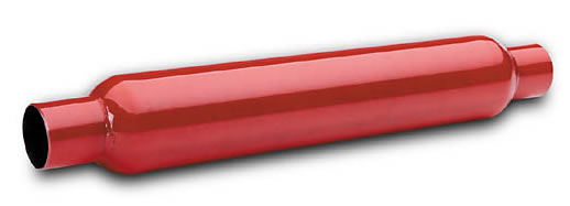

Alright! Finally got the glasspack on. It definitely makes a difference in the car sound-wise. I can actually hear the bass on my stereo now, and I don't have to turn it up as loud. Feels like I even picked up a bit of mid-range torque. Outside the car thought -- wow. I thought it'd be loud but DAMN... if my car were YELLOW I'd re-name it to the 'rumble bee'. I got some cheapie $5 glass-pack made by flowtech. As skline says this muffler will probably be a 10k-mile muffler at most. That means I can cut it off and weld another one on in... a year? heheh.

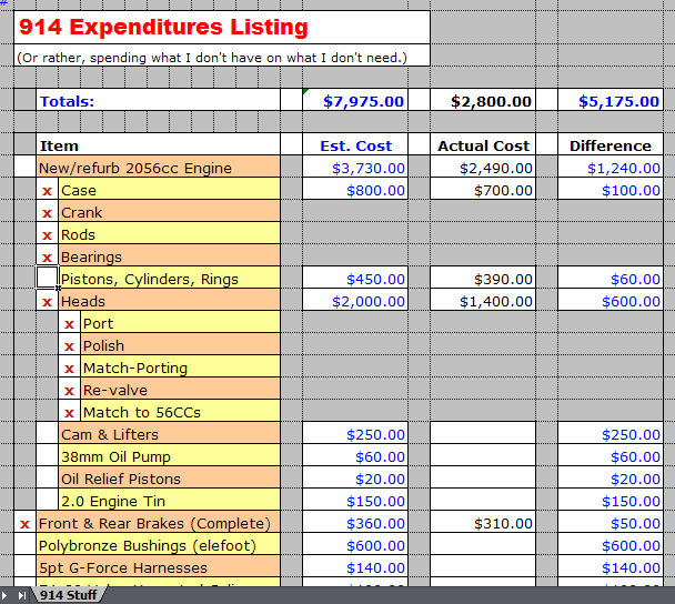

New H4 headlights arrived tonight. Still waiting on my P&Cs from Steve Stromberg. I dont know if they've been delivered yet -- appears someone has been rifling through our mail at my parents' house. They're getting things 2-4 days late and opened. Very peculiar. And if packages are delivered before anyone's home -- who knows. ![]() I did it. I spent a whole hour and a half last night updating my expenditures spreadsheet. The estimated total made me want to cringe. It's like half my yearly income ![]() Ordered a pair of "T" fittings to replace my proportioning valve. Those Volvo calipers are sounding pretty good about now. "Summer Project" it would be, worth it? I s'pose so. More effort than it's worth? I'll know after it's done ![]() My heads are still down at Ollie's Machine Co. in Santa Ana. Just need a pair of tall intakes to give them so they can port match everything. The bill will be large enough and definitely money well spent. In a couple years I when it comes time to freshen up... maybe I can throw some 105mm nikkies. That'd be nice. With all the work to the bottom end it should easily last 150k-200k miles. I'd expect so. Times I wish I were rich... Attached thumbnail(s) ![]()

This blog is a bit belated... I've already sunk hundreds into the car since acquisition (last august) but only lately have I begun moderate updating. The 2056 is still being pieced together. I'm awaiting the 96mm Pistons and Cylinders (with rings) from Steve Stromberg. Supposedly shipped out Monday, i'm just impatient. My running tally on the engine is as follows: -Case, Crank, Rods, Bearings, Flywheel: $700 -Heads: $400 -Work to Heads: $1000 -Pistons & Cylinders (with ring set): $390 -Carbs: $450 I still need a cam, lifters, oil pump, oil relief pistons, 2.0 tin, CDI unit + distributor, and the bottom end balanced/counter-weighted. I guesstimate i'll have about $3600 spent for EVERYTHING. Not to mention all the little things i just haven't been able to 'live without'... Trunk shocks, trim pieces, lenses, windshield. My $6000 is almost gone ![]() Work on the 914 this week has been hampered. The last thing I did was install my CAMP914 front shox and a pair of poly-urethane strut bushings from German Parts & Restoration in the front. They made a bit of difference in squishyness of the front end bouncing around. I'm sure that'll go away with all-new bushings, a front sway and new joints. Before I go on... I have to update my XLS sheet of expenditures. Damnit. I didn't want to cry over my bank account tonight. |
