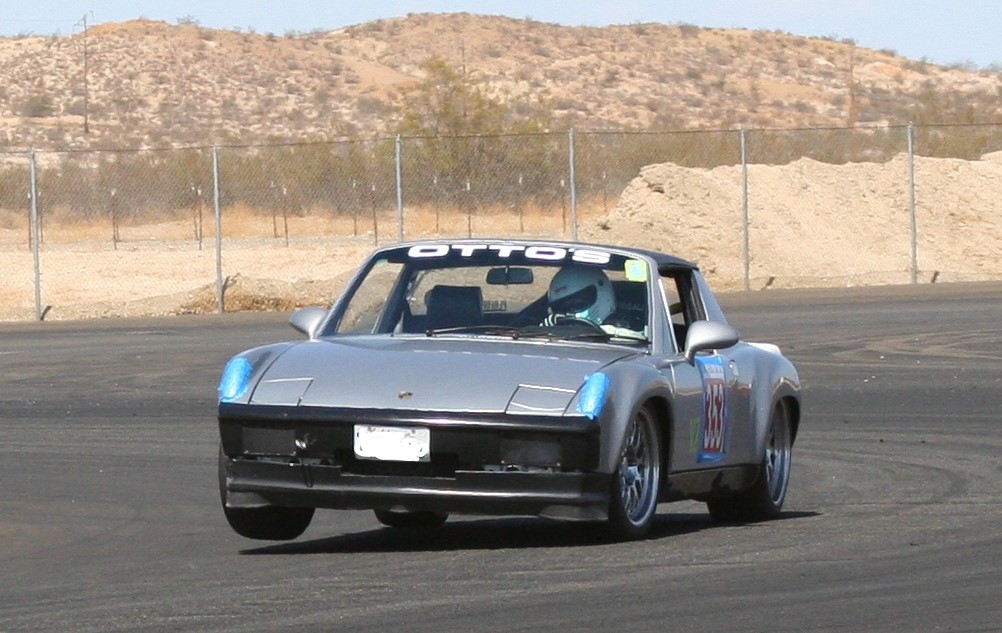

2005, sold car to Sandy, who raced it for four years in POC.

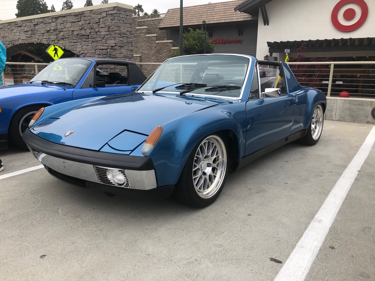

2017, converted to street with chrome bumpers and 916 Trans
2019 painted Alaska Blue Metalic

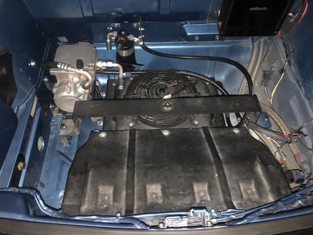

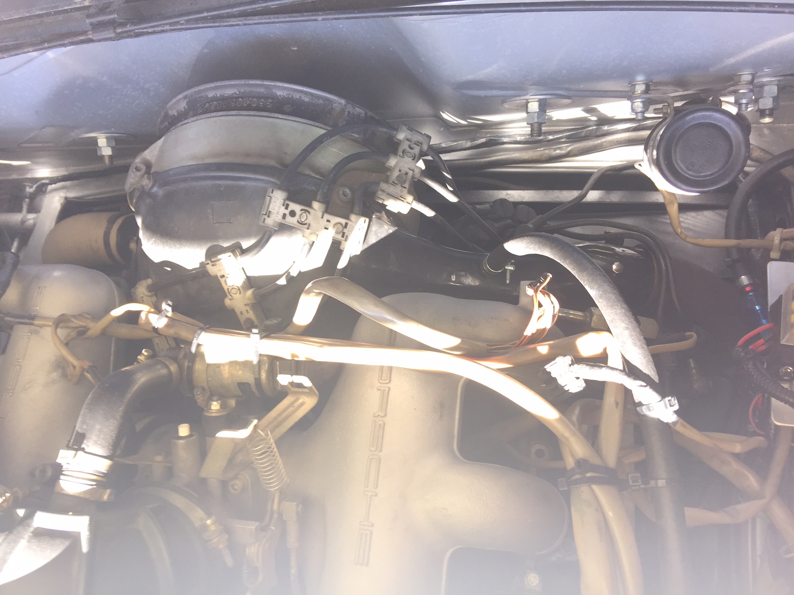

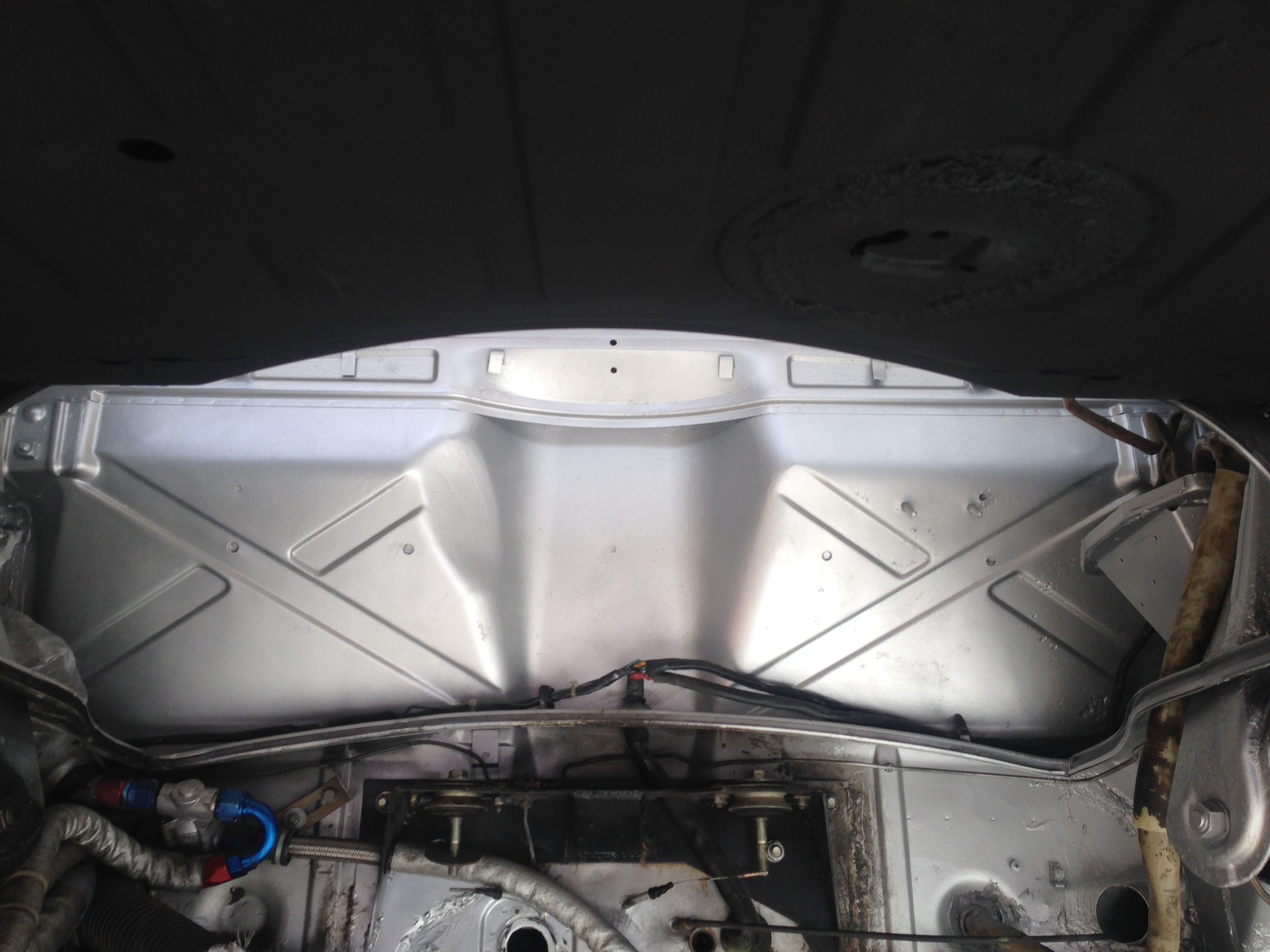

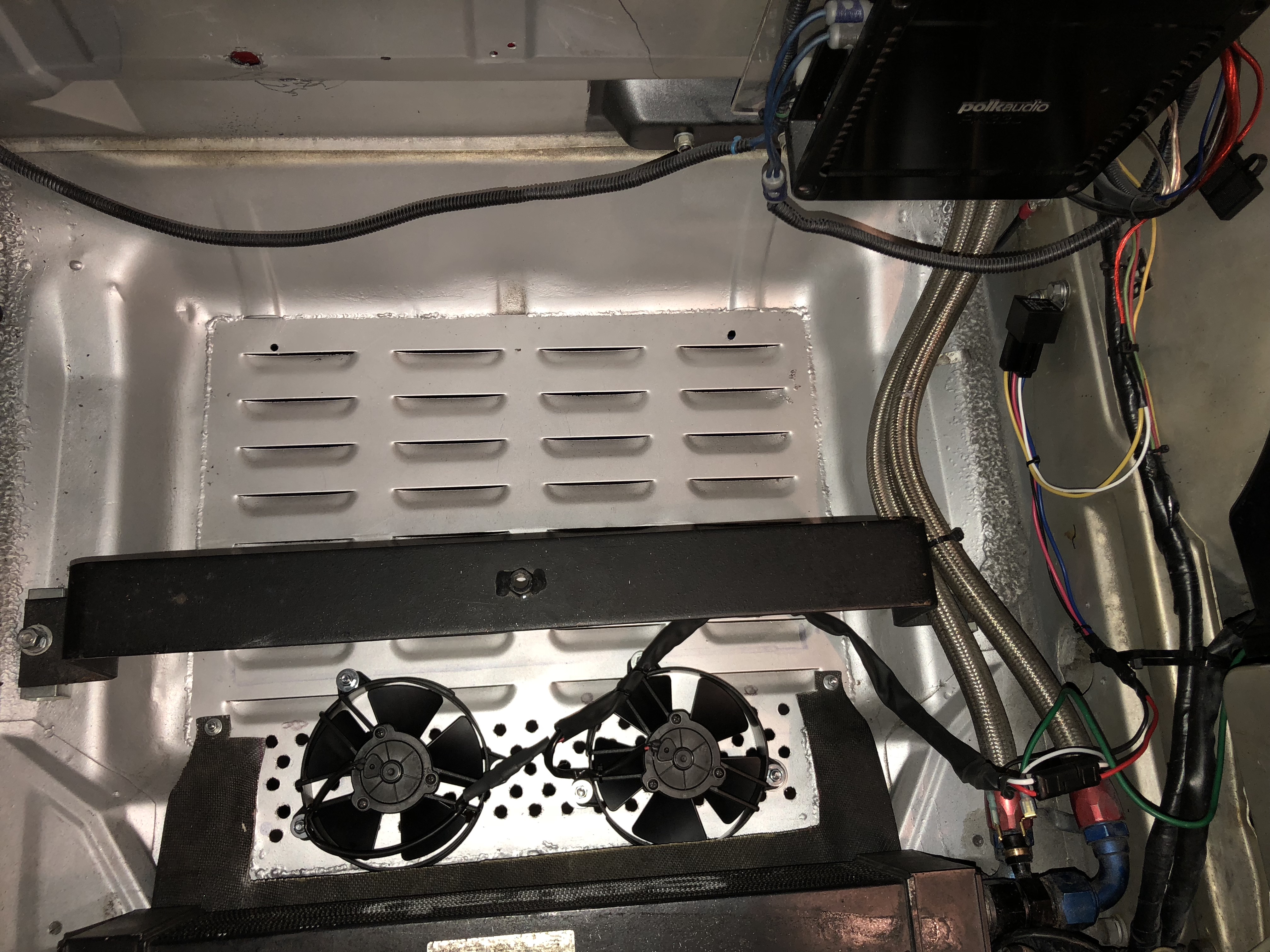

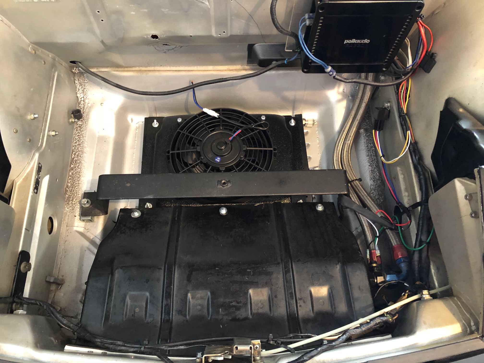

Southern Rods Condenser, mini evaporator https://www.southernrods.com/out-of-stock-m...--a-c-only.html and Patrick Motor Sports Oil Cooler and shroud. Electric Compressor is a Benling DM18A7. The carpeted trunk board goes over the shroud and condenser. I also drilled holes in the front spoiler to direct air over the condensor. So far it blows cold and then the amps go over 100 amps and blows the breaker. 914toy is running the same evaporator horizontal under the dash and his works fine. He also has 3 condensers. One in front and one installed with fans in each rear fender. Hopefully I will have time this summer to get mine working.

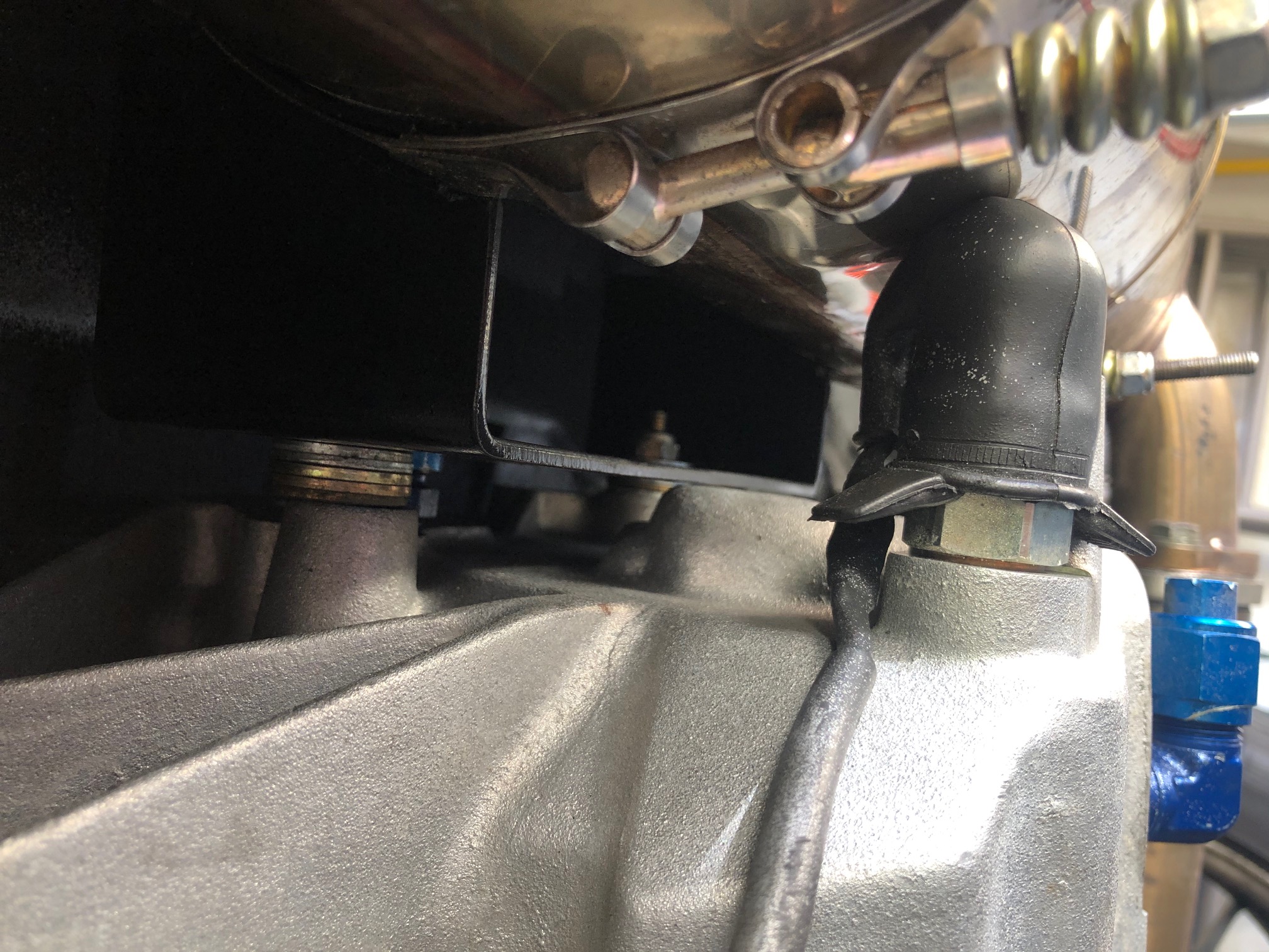

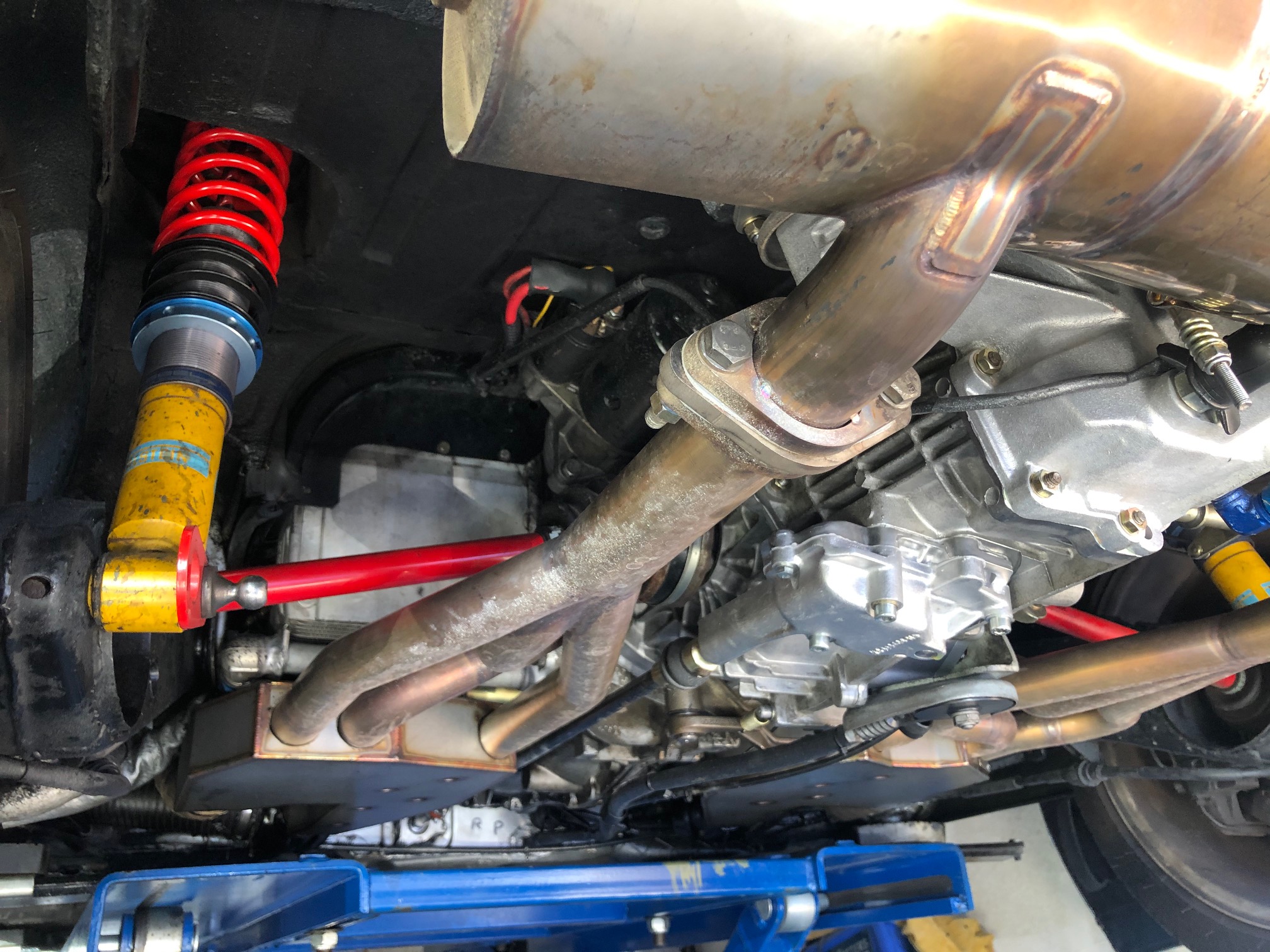

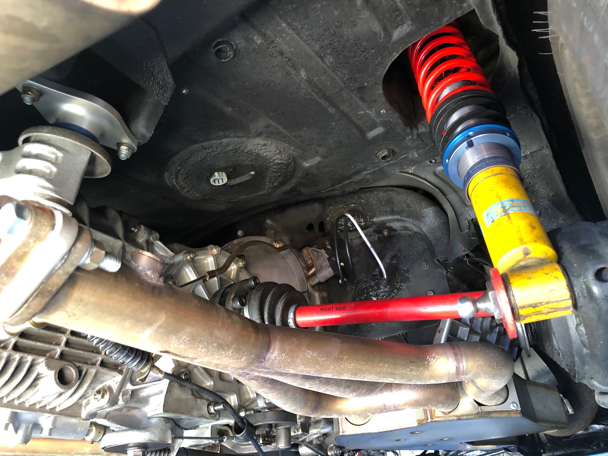

To clear the rear back up light switch on my 916 trans, I had to space the muffler out 3/8". Ben sold me a couple of muffler flanges, that I used as spacers. As you can see in the picture, I also had to install longer studs on the 916 trans and use fender washers to equal the muffler spacer.

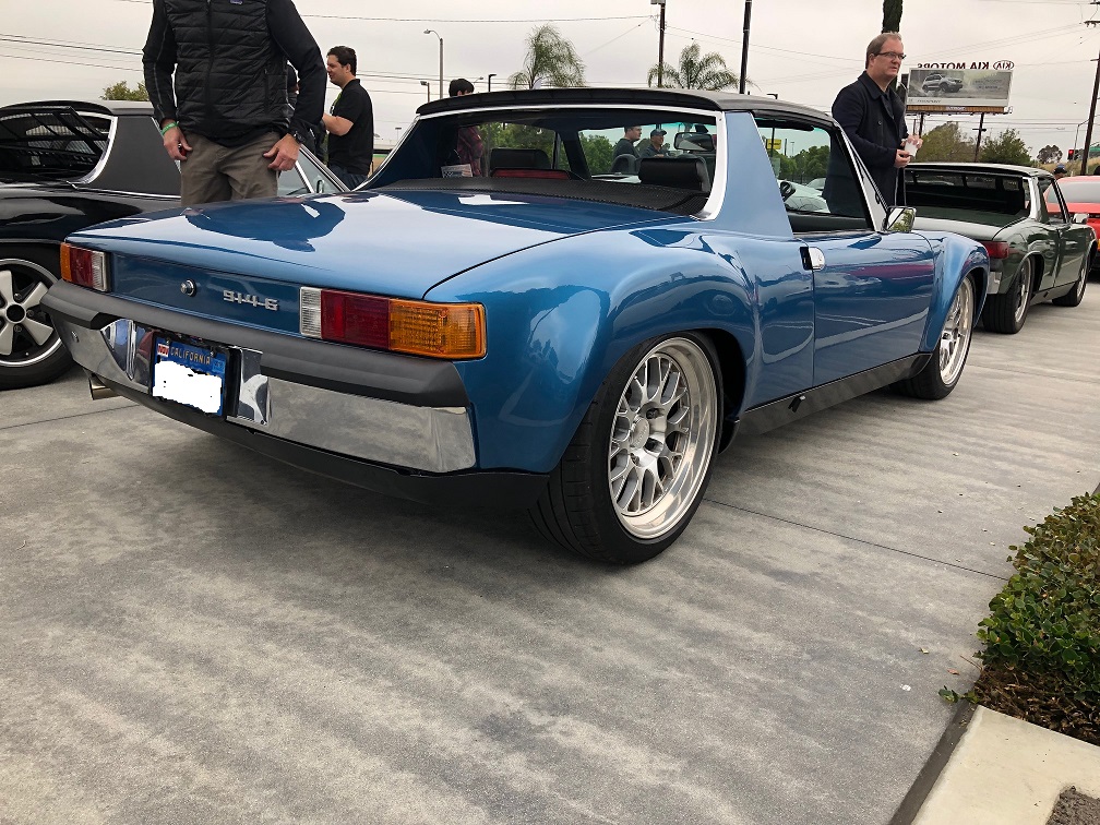

In 2019 I did a Color Change from Diamond Silver Metallic, to two stage Alaska Blue Metallic by Imperial Auto Body in Huntington Beach
AA GT Replica Steel Flairs were installed by Beach Boys Racing in Venice Beach

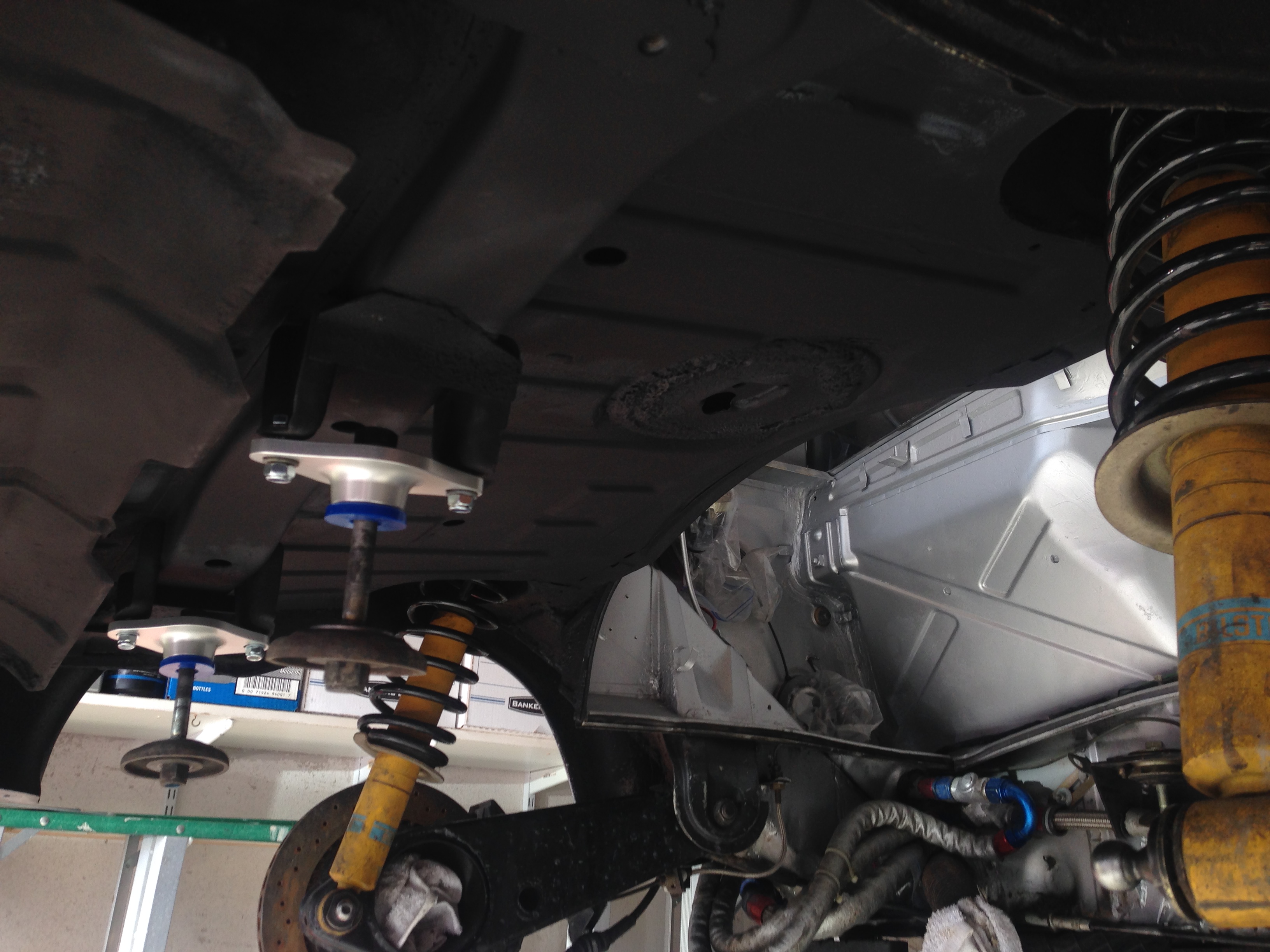

200 lb 2.5" Rebel Racing coil overs with Eibach springs
Boxed trailing arms and GT Stiffening kit
Koni Shocks

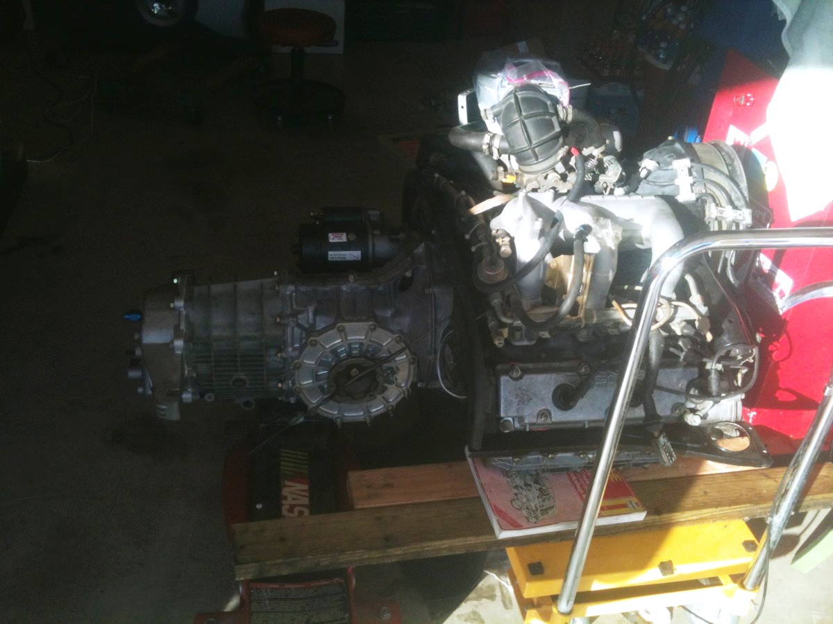

Here is a shot of the 916 trans with my 3.2 out of the car. Next step. Wiring, air cleaner and then onto the body work repair.
