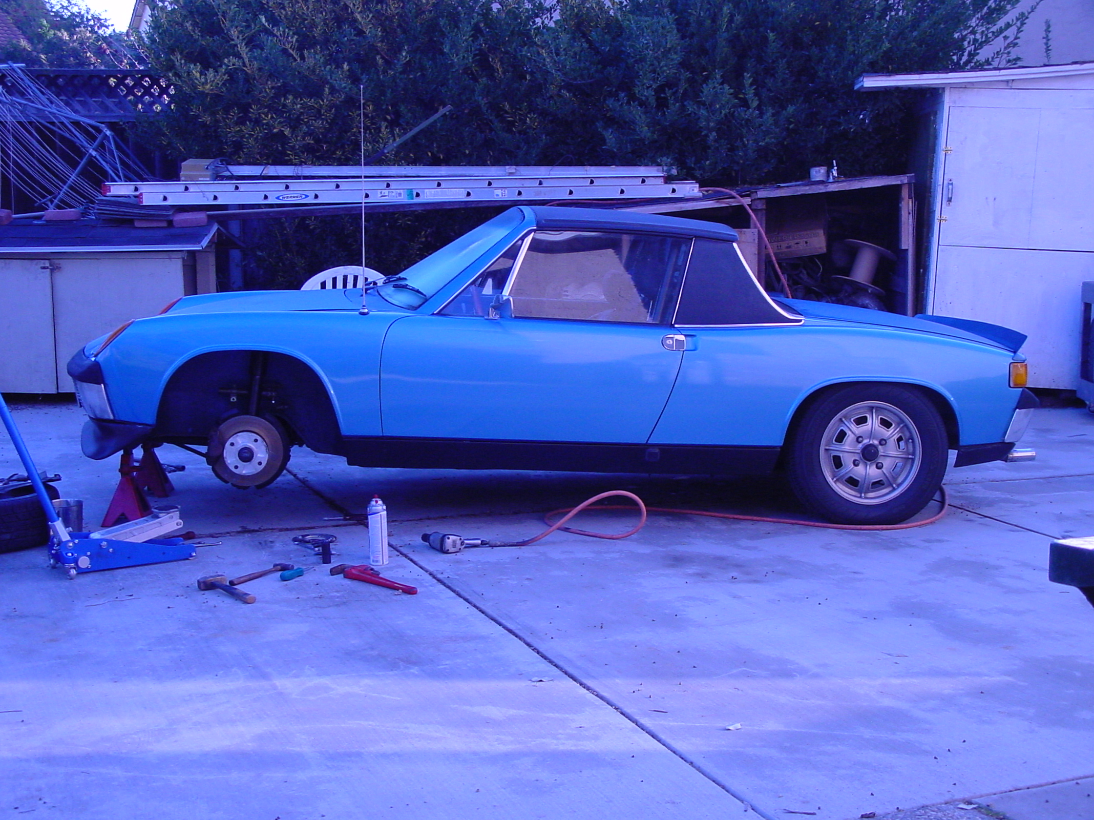

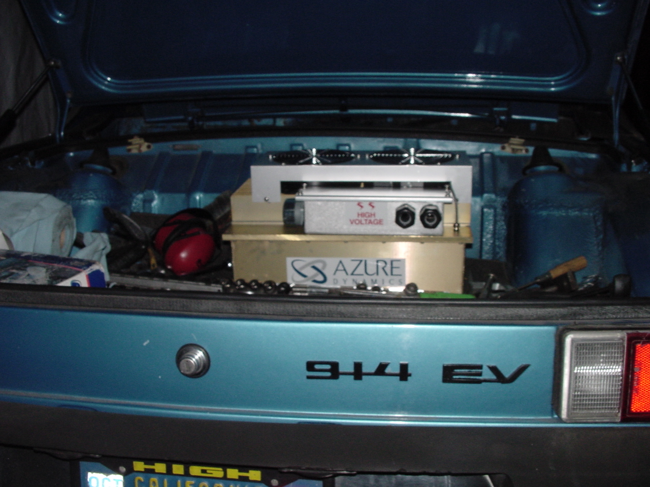

"71 has the same old pads on the A calipers, they seem to have seated in now. I should put the new ones in around January. This has been my DD for several months now due to dropping the ICE out of my '74 to convert it to a Battery Electric Vehicle. A few delays in securing parts has me looking at suspension and brakes while I'm waiting. So far I have a nice AC motor and controller, waiting on the tranny adapter, motor mounts, cabling, charger ,DC-DC converter and instrumentation to arrive. Spending time getting the battery racks built up
and building a heater, and enjoying the rain.
