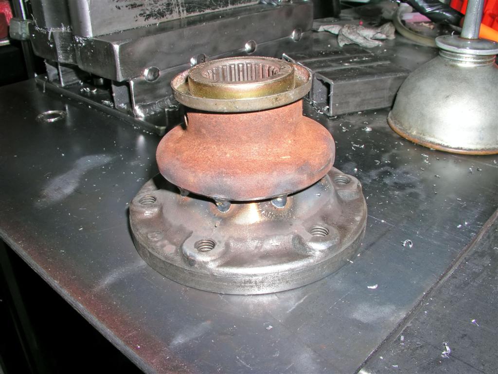

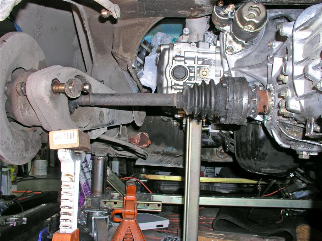

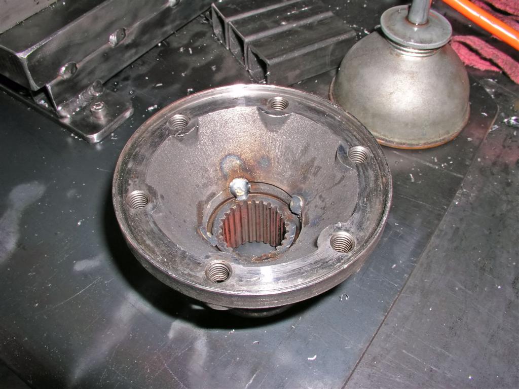

Progress! I made up one flange today - Thanks for the suby flange James!
I chopped up the Suby flange and a VW rabbit 100mm CV flange (probably a 16V Scirocco flange - rabbits had smaller CV's probably the same as a 914) Then I tack welded the two together.
Looks pretty good in the car. The suspension is at ride height.
I got another axle and flange today - I will make up another set soon. Busy with the tubing bender these days.

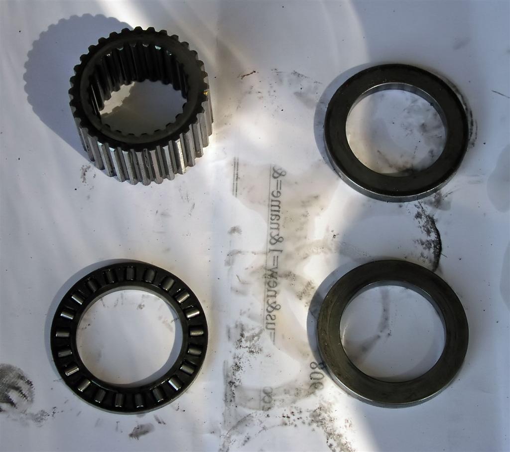

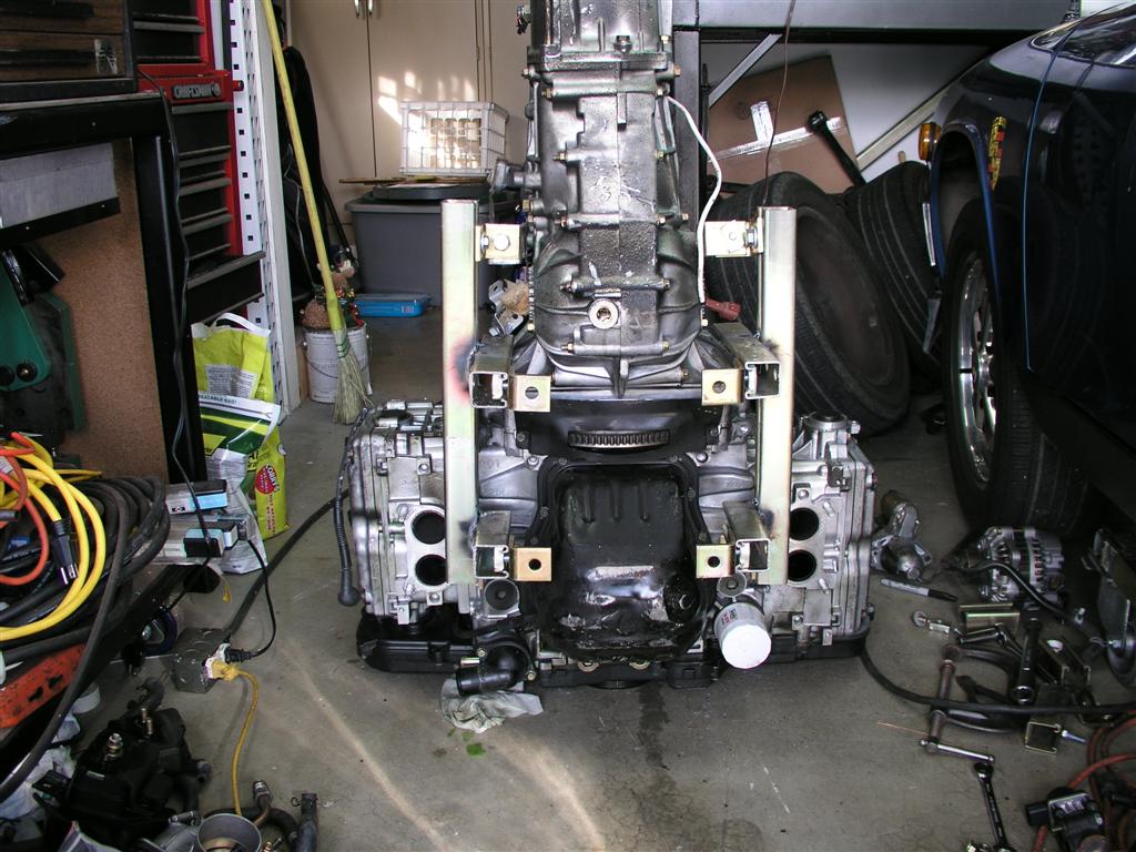

Picture #1 - Made a "tripod" to hold everything in place, the threads allow really precise adjustment.

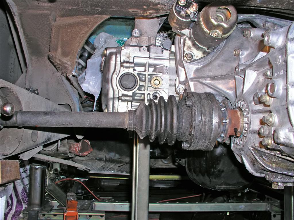

Picture #2 - Checking CV clearance.

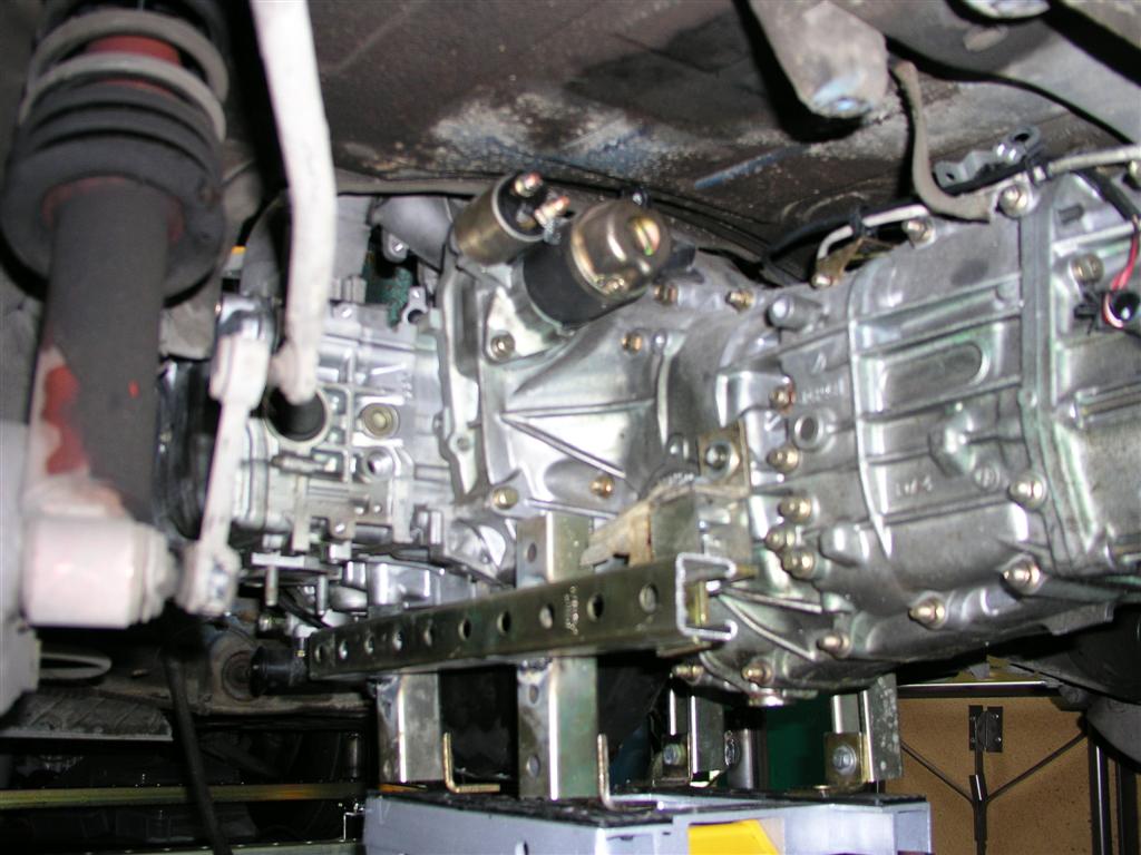

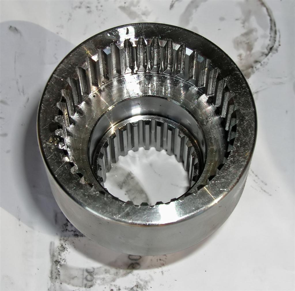

Picture #3 - The AWD to FWD conversion sleeve.

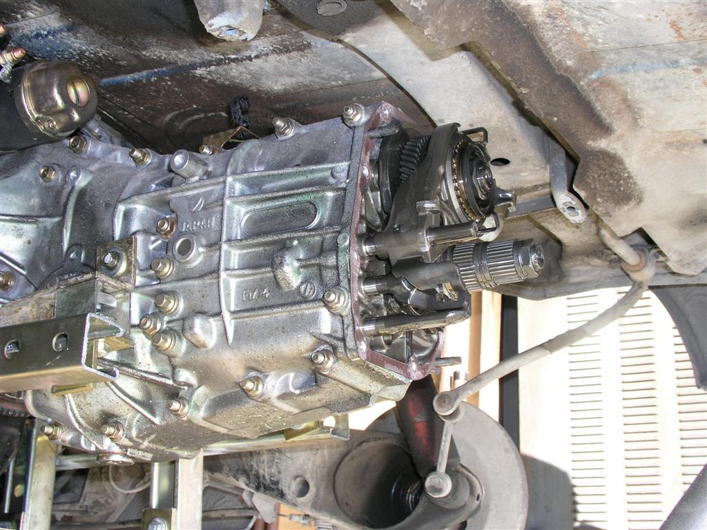

Picture #4 - The sleeve goes here.

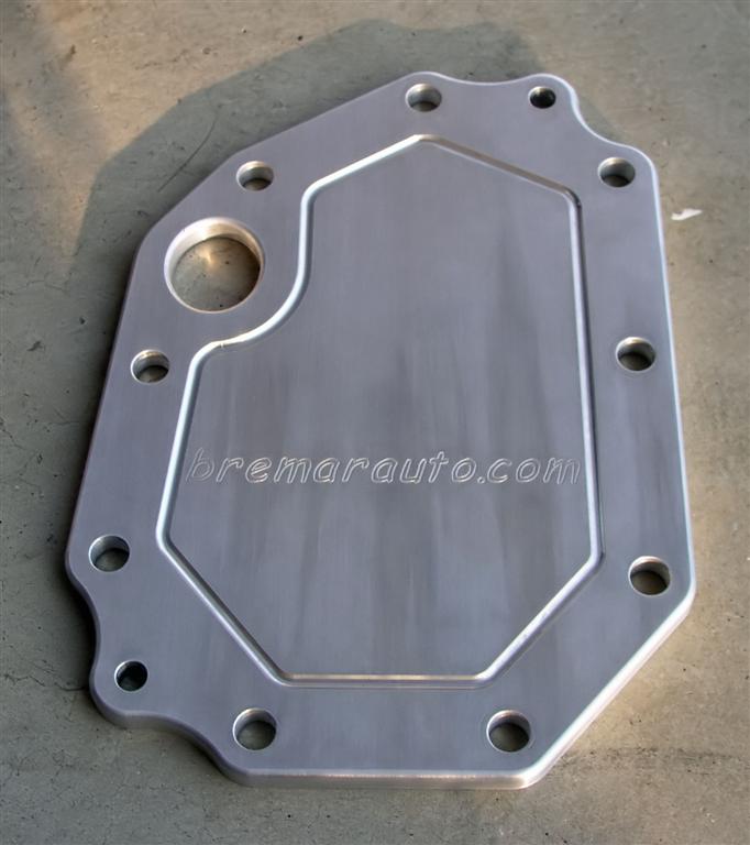

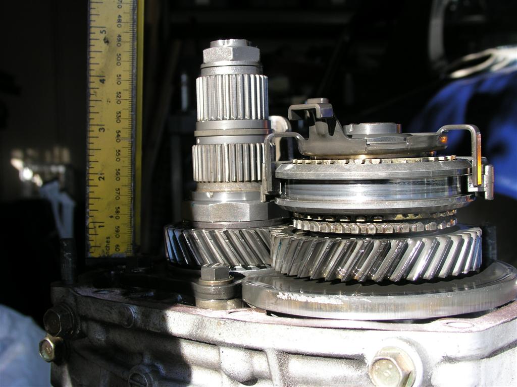

Picture #5 - The parts removed from the transmission output shaft
Picture #6 - The cover plate

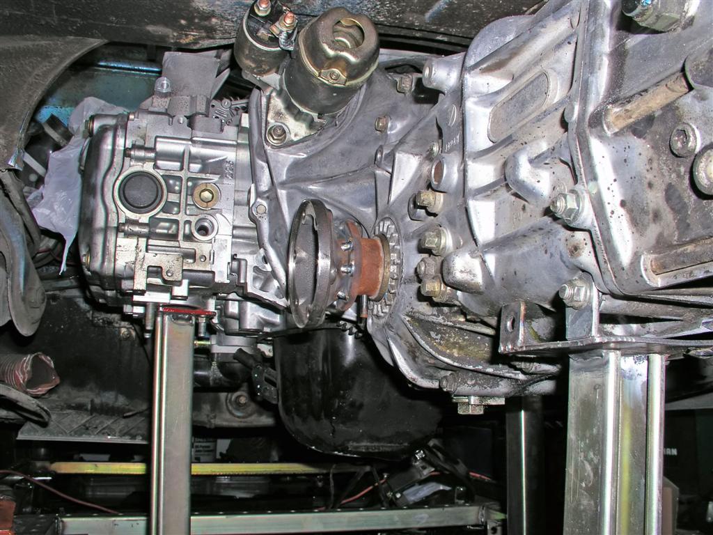

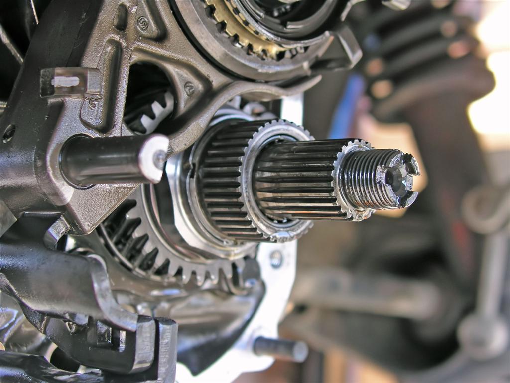

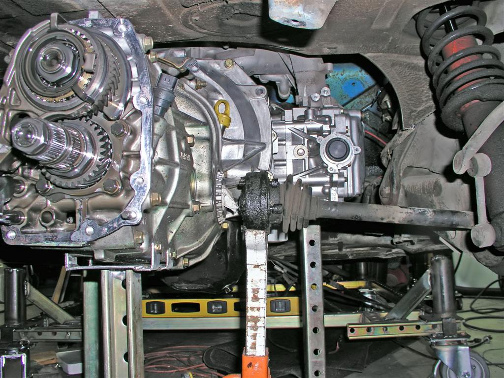

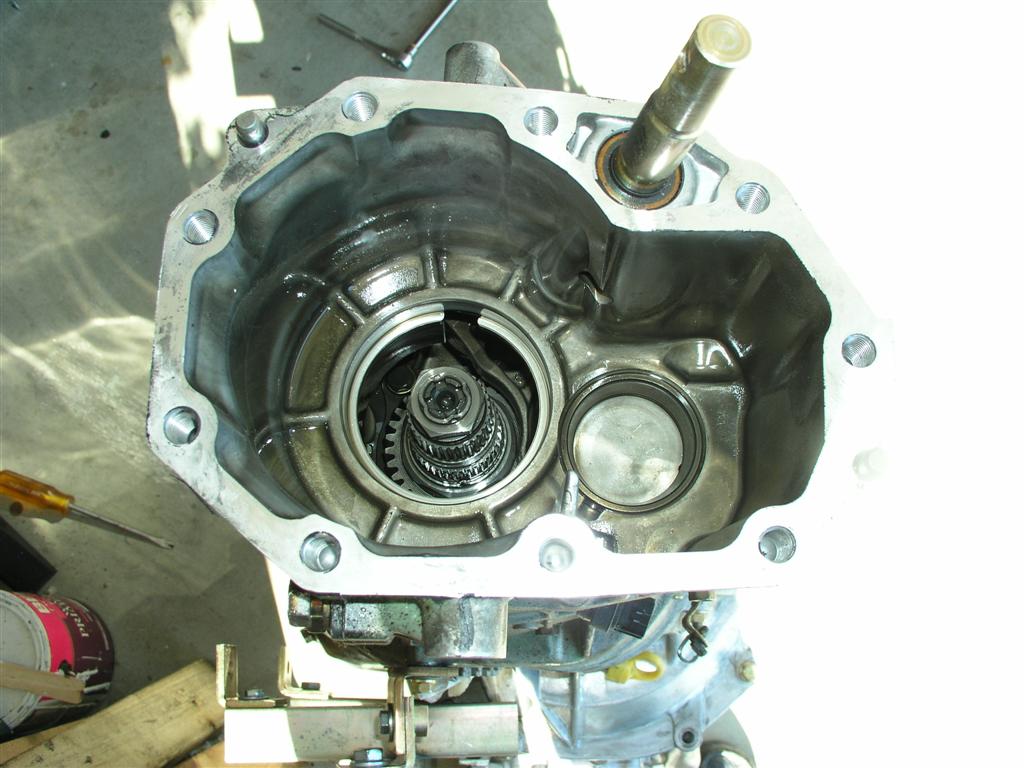

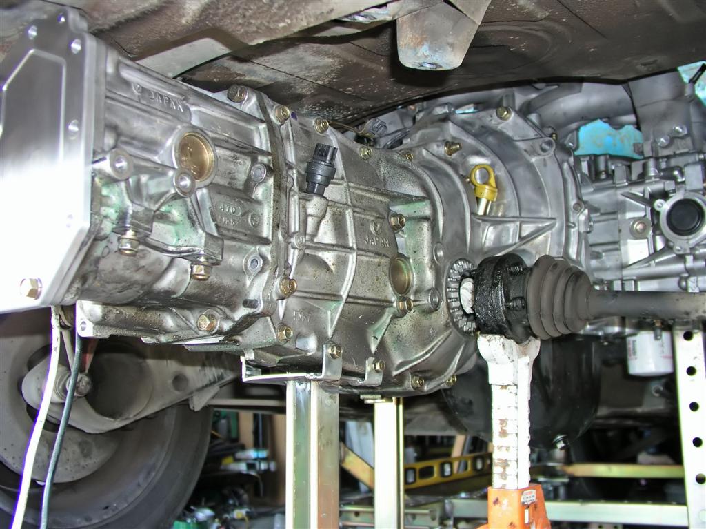

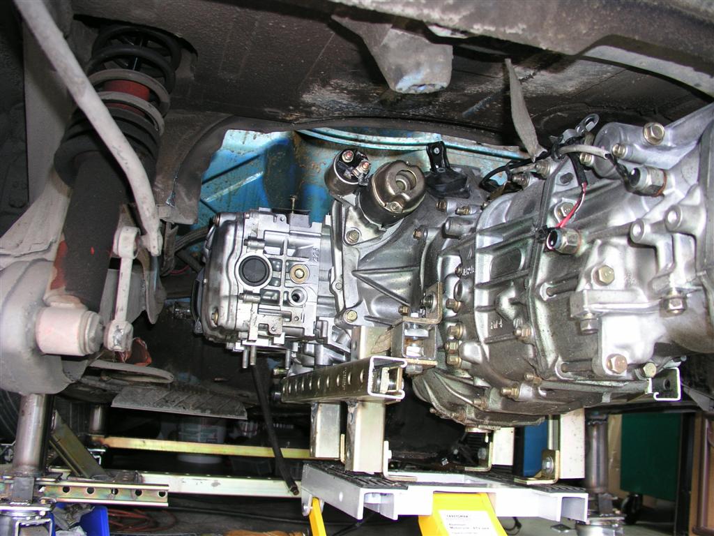

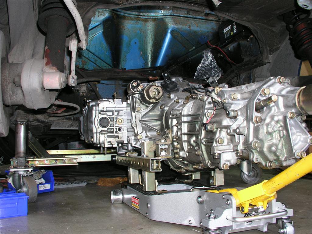

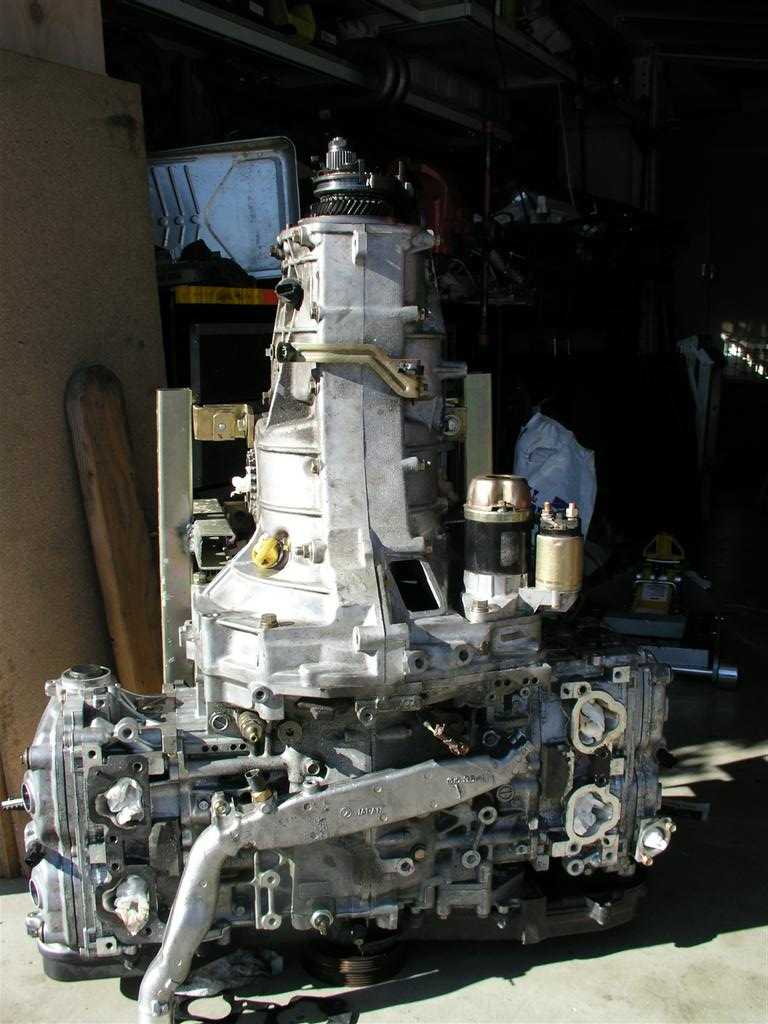

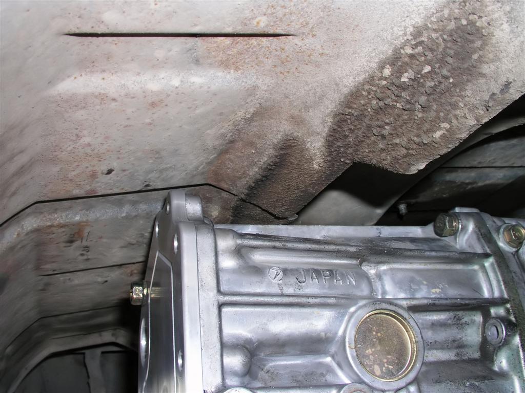

Second engine fitting. The AWD extension housing hits the muffler shield so it will be replaced by a much shorter FWD version. I hope it fits, if not the AWD housing will be cut sawzall-smiley.gif and welded welder.gif to make it fit. The release arm (hydraulic version) hits the floor so it needs some work to fit. I will use a hydraulic release bearing or modify this one to fit, it's just more cutting sawzall-smiley.gif and welding welder.gif
I need to look into the stock cable release hardware before doing any modifying.
1st picture shows the almost empty AWD extension housing before I removed it.
2nd shows an overall view of the engine and transmission with the AWD extension housing removed.
3rd shows just how long the AWD extension housing and the output housing really are.
4th picture is 5th gear and the splines that will be tied together with the coupler from Saker cars in Australia. The top splines are the end of the pinion shaft the lower splines are the output of the transmission.

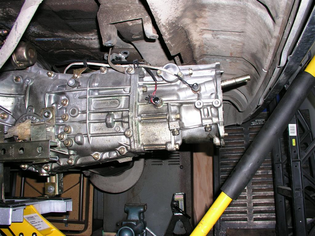

5th picture shows the transmission back in the car in the correct position.
6th picture shows clearence above the bellhousing area.
Last one is a side view of the trans in the correct position.

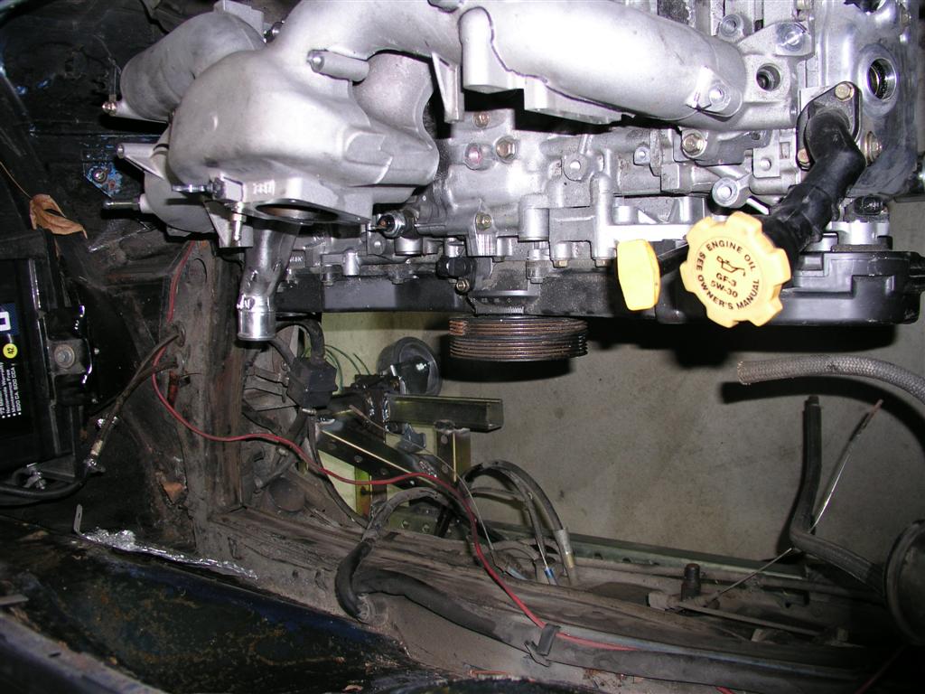

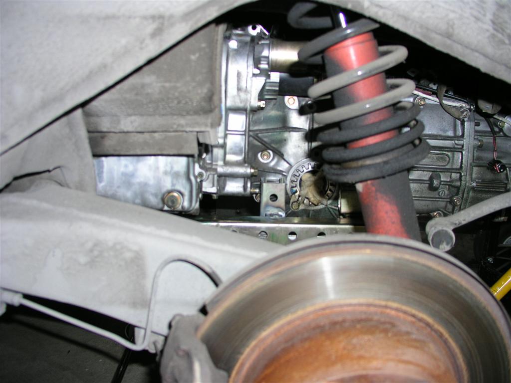

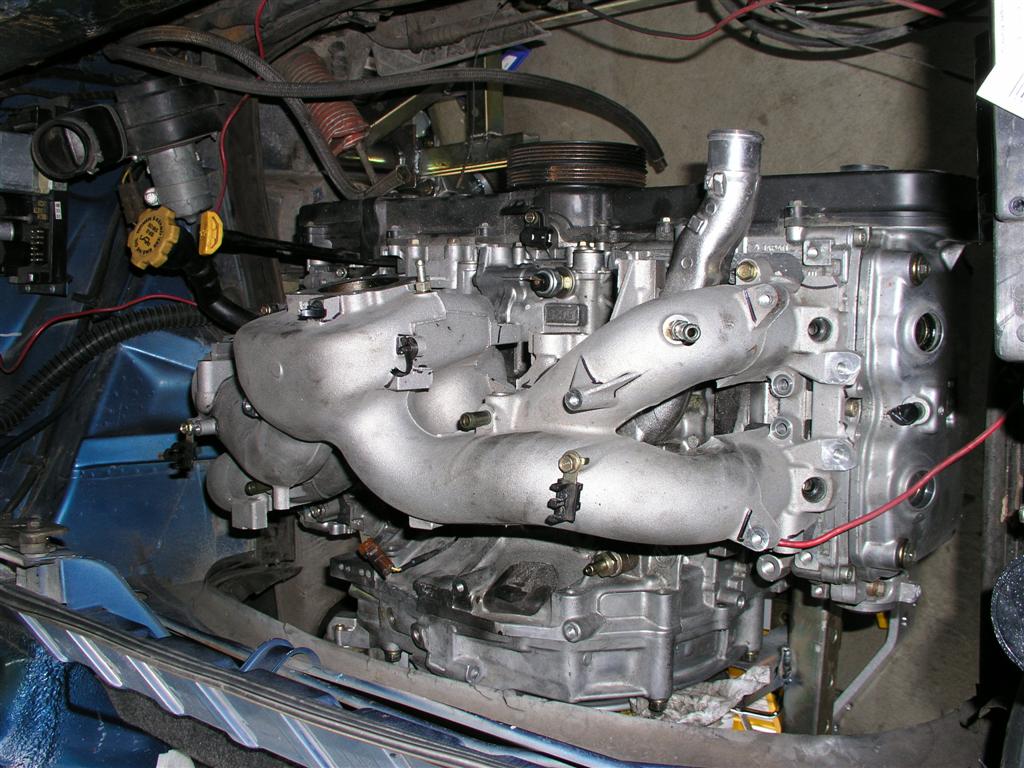

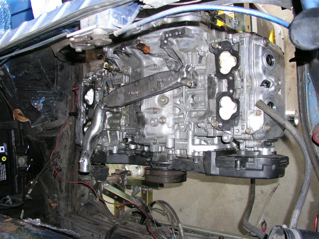

First engine fitting. The intake manifold needs to come off along with the oil filler and the dipstick.
Note that the AWD trans is a bit long. I will fix that later. See the ground strap just hanging in air - that explains the slow cranking of the original engine.
In the last few pictures the engine is in the correct location front to back but it is 1-1/2" low because the back of the transaxle is hitting the muffler heat shield. There is a comfortable 12" between the engine and the firewall.

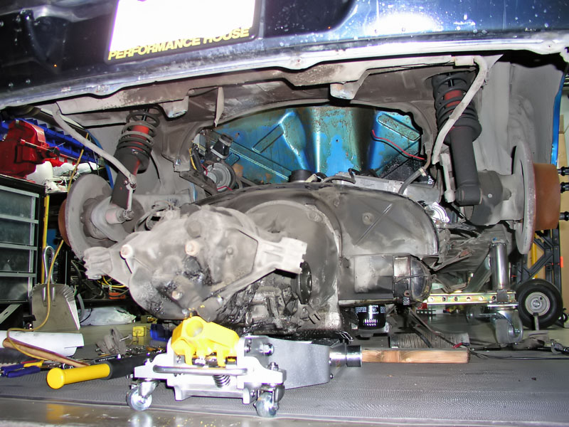

entry Feb 4 2006, 10:23 PM

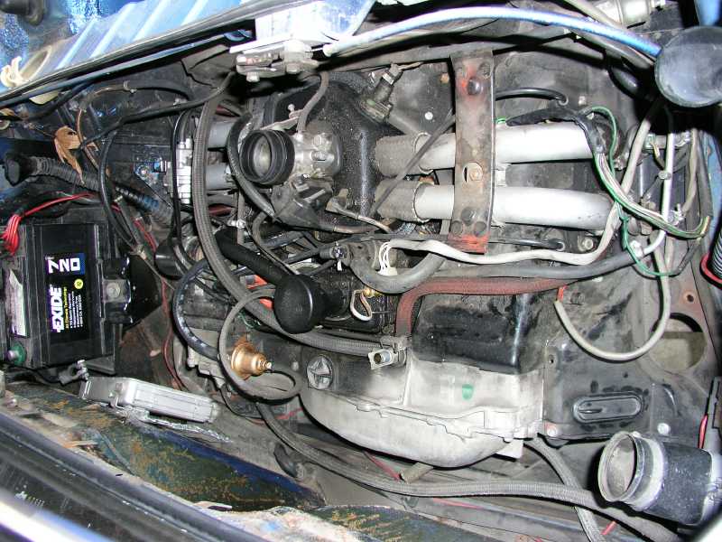

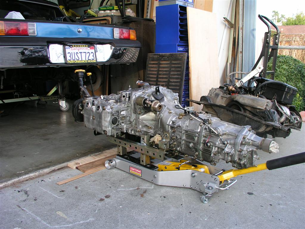

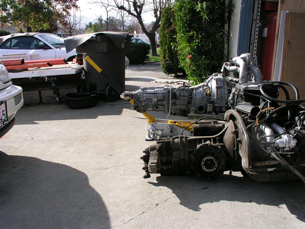

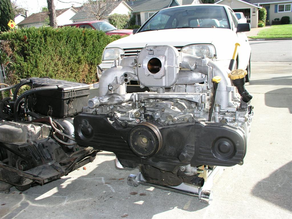

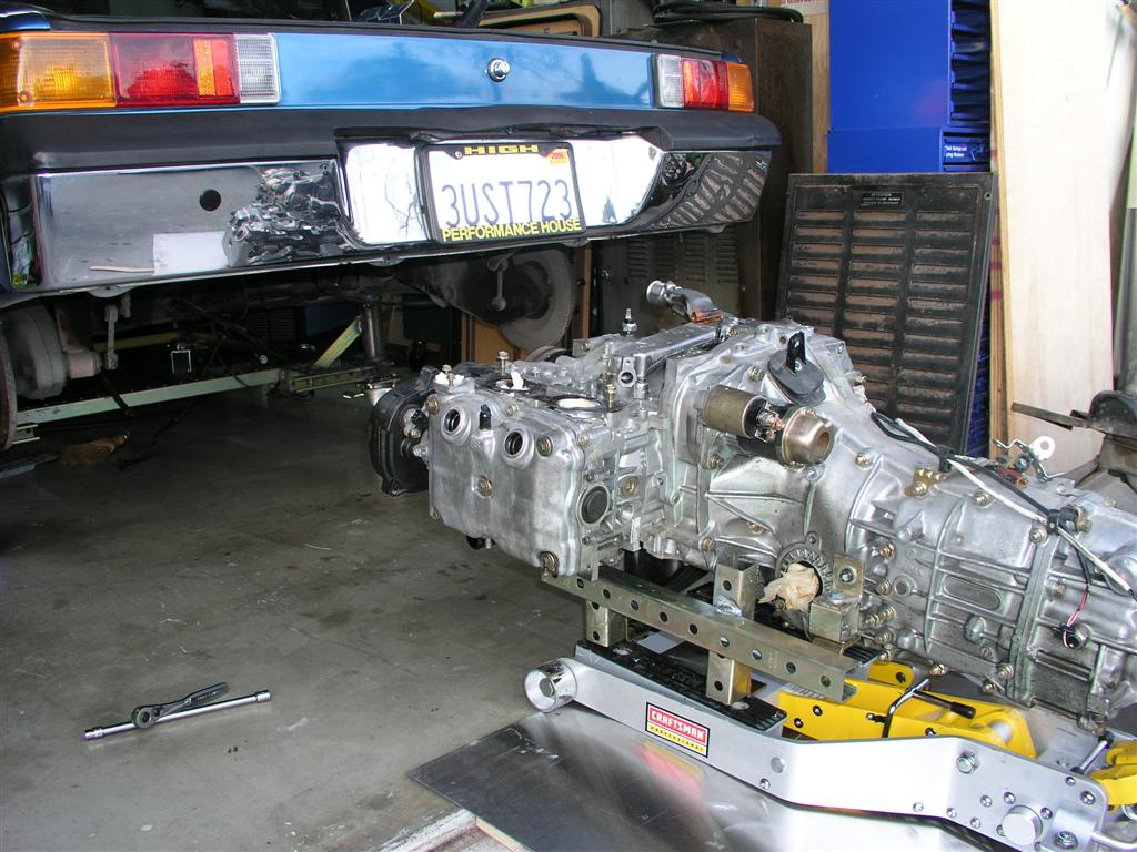

Getting ready to put the new engine in for the first time. Please excuse the crude temporary engine cradle - it works great.

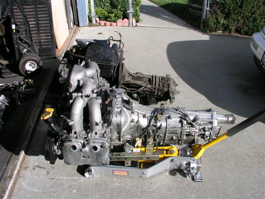

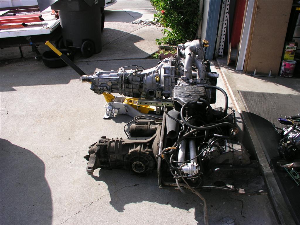

Old vs. new - the engines are lined up so the back of the blocks are inline. That Suby trans is LONG. The intake manifold on this 2005 Suby is a work of art.
The Suby trans is 110 pounds with the center diff removed. The 901 was 85 pounds.
The Suby engine is 236 pounds plus 18 pounds for the fuel supply and injectors, alternator and bracket plus the throttle body. The Type 4 engine showed as 210 pounds on the scale but I think the scale may have jambed because I needed help getting this engine on the scale and I was able to weigh the Suby engine myself. The T4 is also harder to move around - I hope to get it on the scale again.

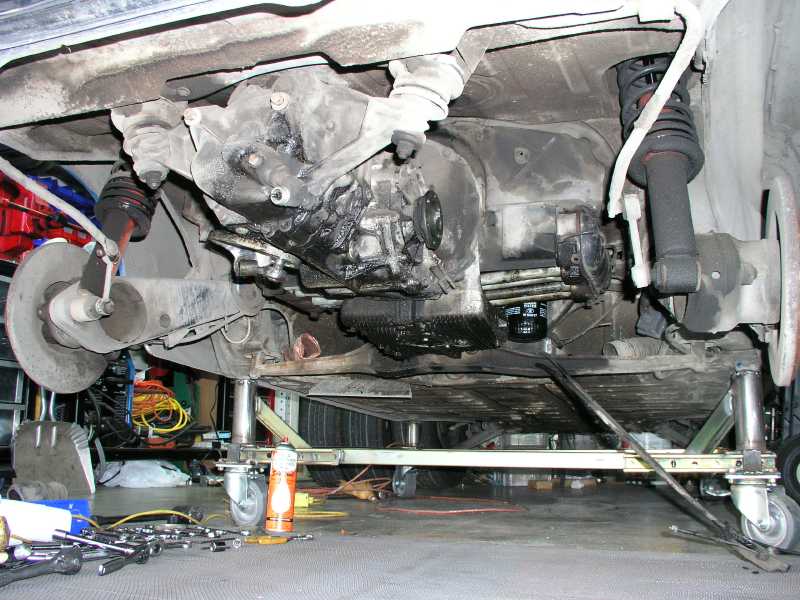

The Subaru engine and transmission project has officially begun. Car is on a dolly and the engine and transmission are out. mueba.gif
