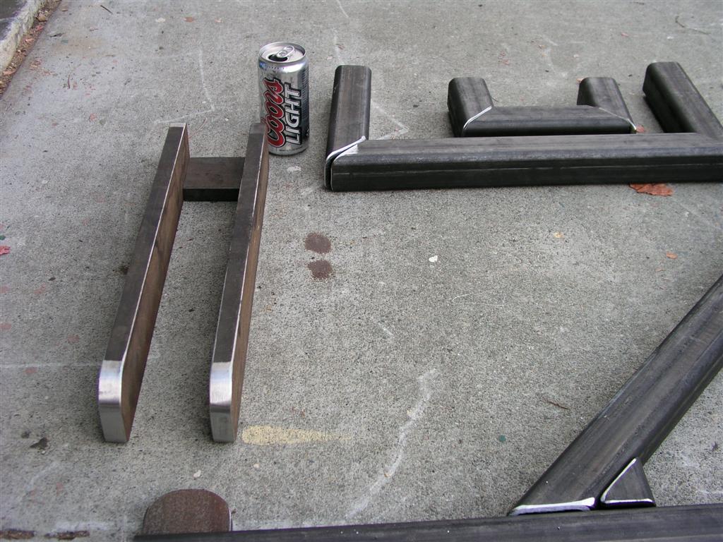

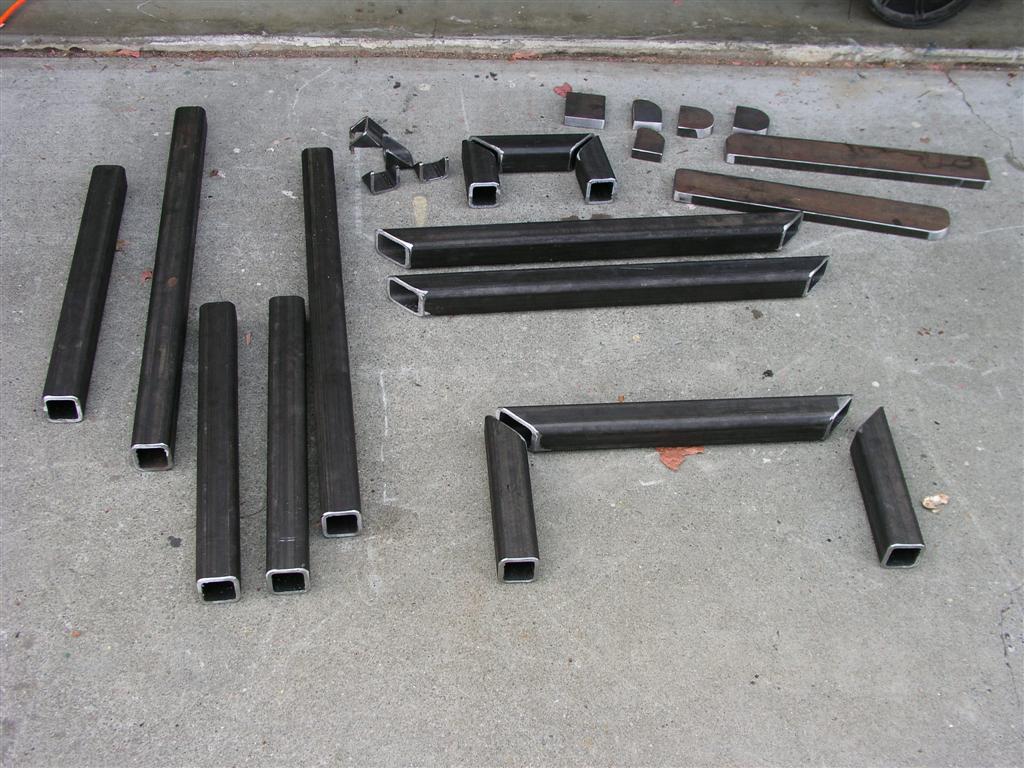

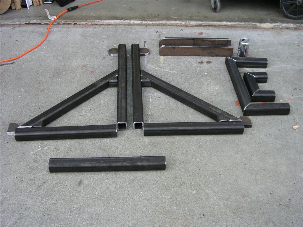

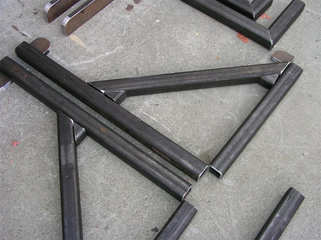

Chop it up into little pieces. 2 hours or so to lay out and cut. sawzall-smiley.gif
Deburr everything nice and smooth. Another hour or so.
Here is a few pictures. This is big thick tubing. 2X2X1/4 the flat stock is 3/4X2-3/4 cold rolled. I don't think this is going to flex much.

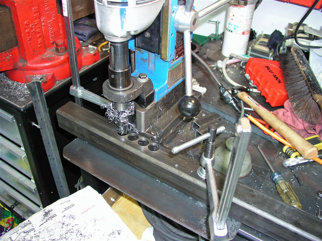

Now I need to make a bunch of big holes in thick steel. Check back in a few days.

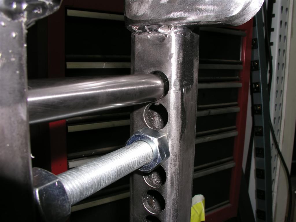

I finally made some holes - I had to buy some tools. That's a magnetic drill press and an annular cutter. Took about 20 minutes to punch 24 7/8" diameter holes in the 1/4" steel tubing.

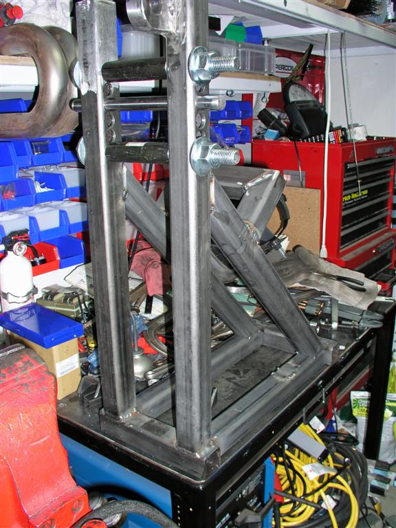

Started welding it together. Forgot one of the pins for alignement. Just an hour of cutting and grinding to start again. Oops.

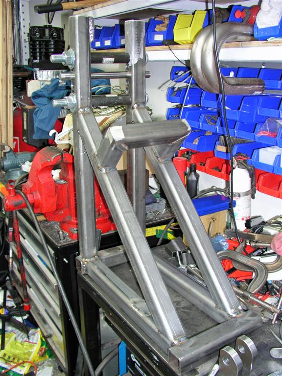

One more time with more fixturing - Those are 12" long 7/8" bolts and some pipe for spacers along with the 7/8" hardened rod that will be used in the bender to hold the dies.
This thing is pretty big and heavy - at least 100 pounds. Those u-bends hanging out are 2-1/4" diameter. I know my benches are a disaster area. I'll clean them up soon.
