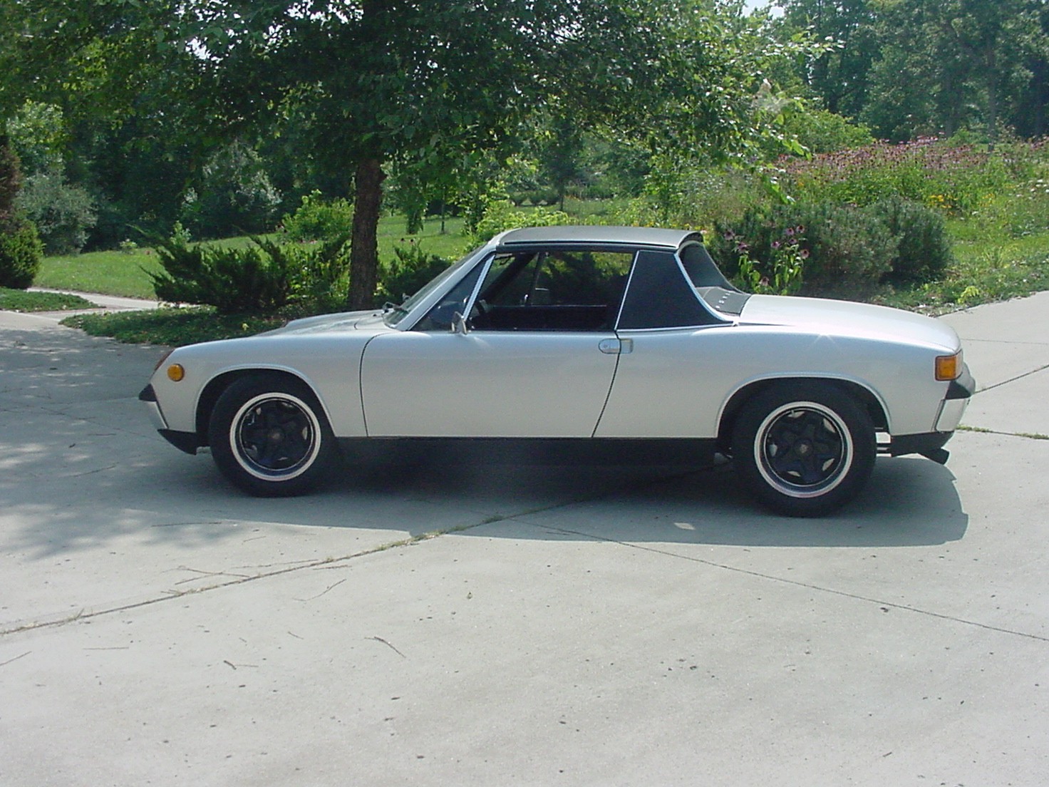

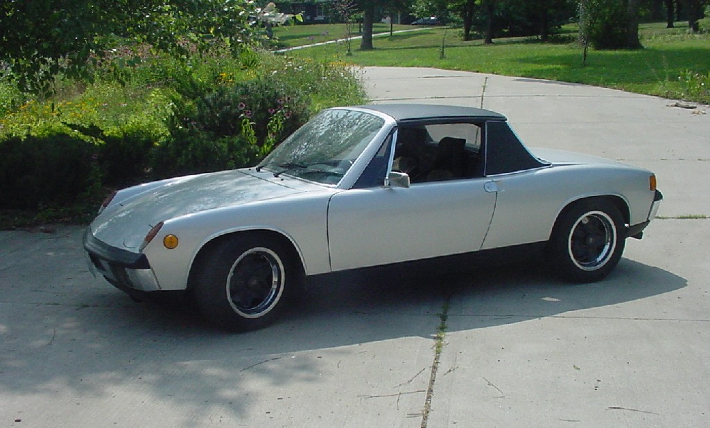

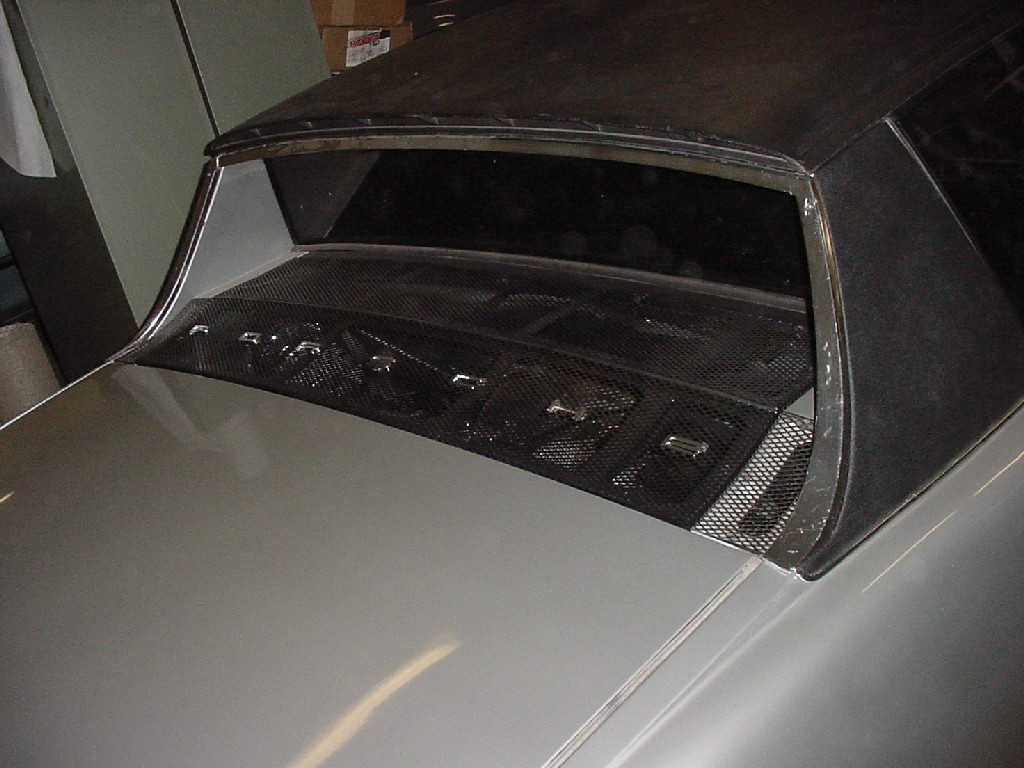

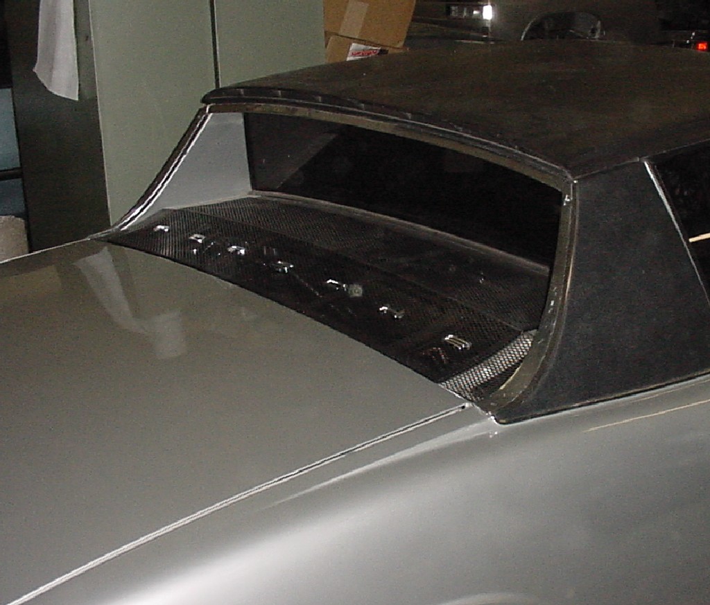

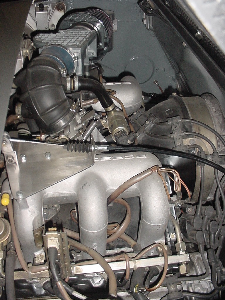

04-20-2007 I installed my windshield to top seal the other day it took about 1/2 hour total. I used plenty of temporary rubber lubricant (P-80 rubber lubricant). Here is a couple pics of the engine lid installed as well as a couple shots of the 3.2 in the car. I still need to pull the engine to fix a couple oil leaks (timing chain covers leak at interface to cam carriers). Attached thumbnail(s)

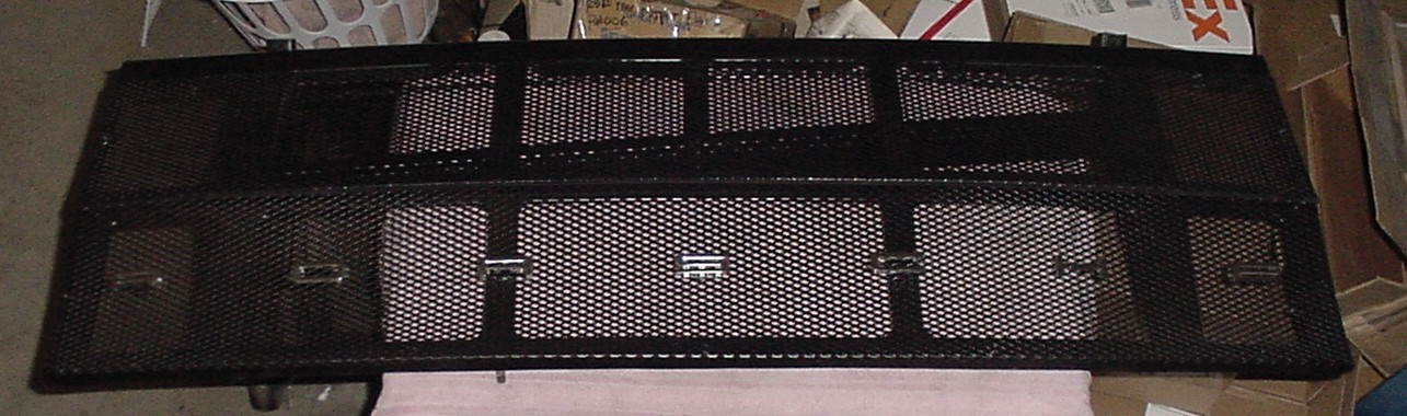

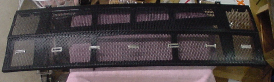

01-11-07 I finally did something to my car (well almost). I created my version of a double grill engine lid. I bought new letters and the new grill seal (between the grills). I modified the lid several months ago, but only now got around to completing it. I will mount it this weekend and post a couple more pics with the lid installed Attached thumbnail(s)

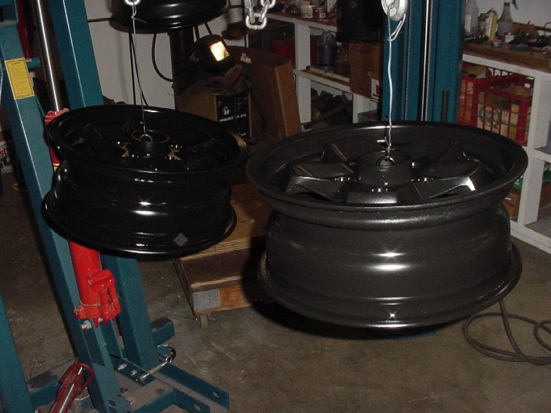

07-09-2006 I fired up the 3.2 today. It was the first time the car has run since February when I started this project. It has taken longer than anticipated, but the car should be driving by the end of the week. I hope to have the bi-annual inspection done either this week or next so I can get current plates for the car and drive it this summer. I had forgotten how well I like the sound of a 3.2 with the triad exhaust. I should buy a new one and send it out to JetHot.......... I mounted tires on my black rims and found 4 center caps for them (thanks Dad). I am waiting for my accelerator pedal to show up (expected 07-11), and it will be virtually ready to drive. I'll take some pics tomorow night....

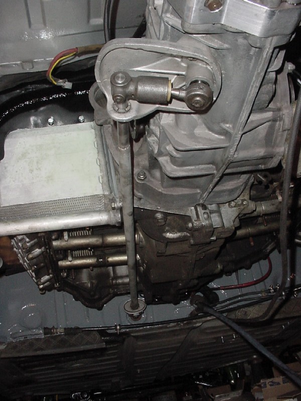

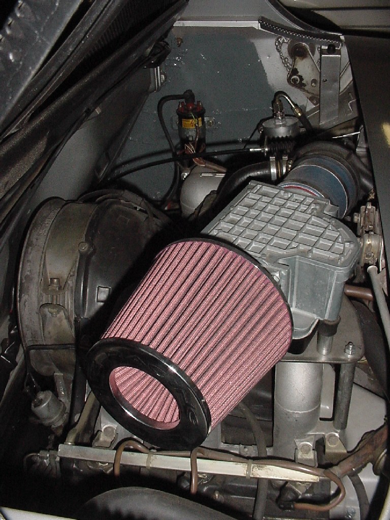

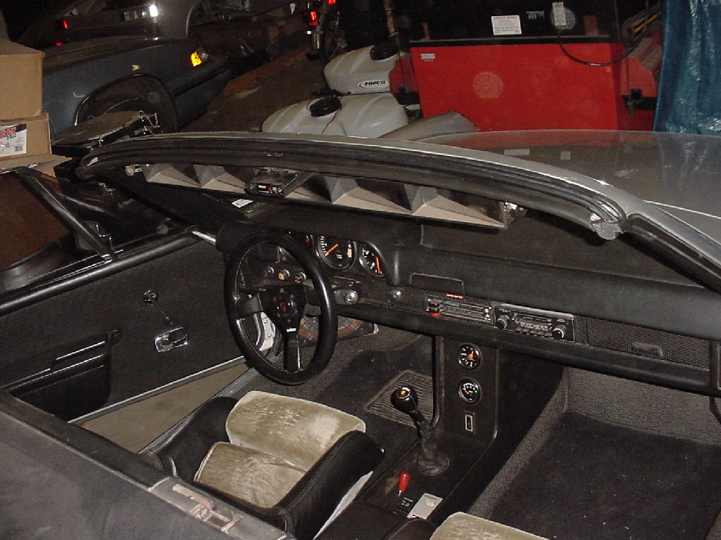

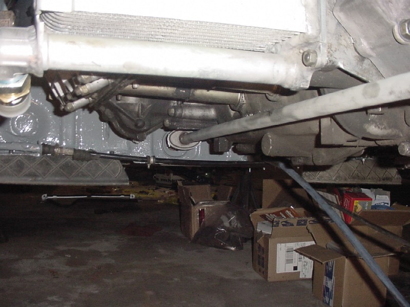

06-29 to 07-08 2006 I was busy completing my checklist and took no pictures, but I: Painted and installed the shift rod Installed my interior (less accelerator pedal, driver seat, driver carpet) Installed my rebuilt 19mm master cylinder Plumbed and blead my brakes Packed and installed my 911 CV joints on 914-6 axle shafts Filled the transmission with gear lube filled the oil tank with oil Installed a new battery in the marine case up front Installed the throttle cable (914-4) and set up my custom linkage Fabricated and installed a relocated AFM bracket to keep the original engine lid latch Painted the bellypan of the car (POR-15 and Rustoleum) Re-bled the brakes (those rear proportioning valves trap air) Installed starter and terminated the starter wiring Terminated the Backup light switch wires Basically I got the car ready to fire up.
