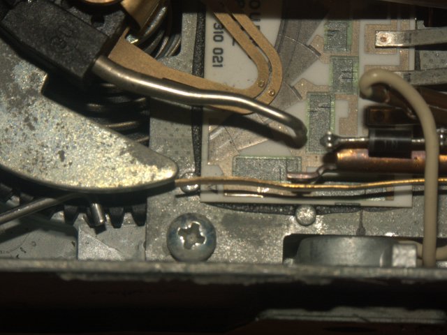

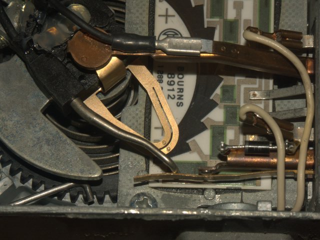

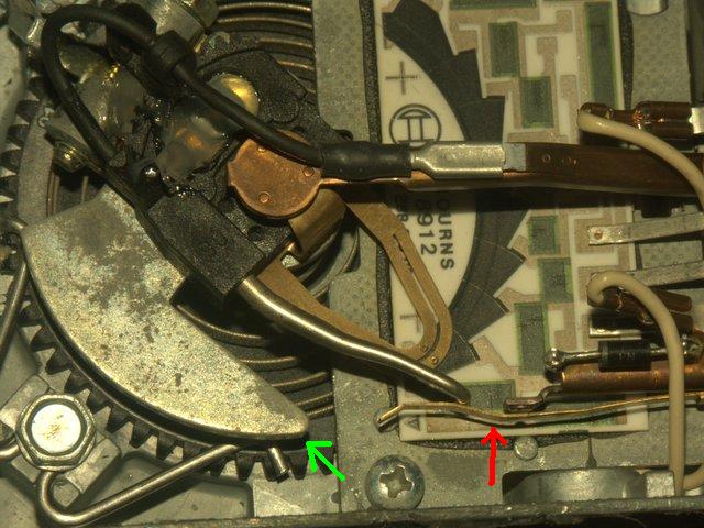

I made a major breakthorough over the 4th wekend! My fuel pump always ran all the time with the ignition on. I knew this was not right, but at least it ran, right? Well, finally ther was athreadthat talked about this. Clay Perrine posted a good description of the whole L-jet system, including pictures of the inside of the airflow sensor. Because I am stupid, but jst for fun, I opened my airflow sensor. The fuel pump contact looked like it had been twisted. ![]() The red arrow points to the contact. I straightened it out a little and tested it. Sure enough, the fuel pump shut off, but would come on when the airflow flapper was moved. But, ther was another problem. The green arrow points to what I call the cam thingie. It rotates with the flapper. It would hit the end of the fuel pump contact and cause the fuel pump to shut off! SO, I decided to straighten the whole contact and bend the silver arm a little instead. Now the contact set looks like this: ![]() Now here is a picture of the airflow sensor witht heflapper rotated part way. it does not hit the fuel pump contact: ![]() This also may explain the missing I had on the way home. At certain RPM's the engine would miss badly. I think it was when the flapper was at a certain poit that the miss would occur. Fuel starvation!?! With everything hooked up, there is not enough vacuum to open the flapper. I can only keep the engine running with my finger holding the flapper partway open. Now, back to the #2 cylinder problem, sigh.

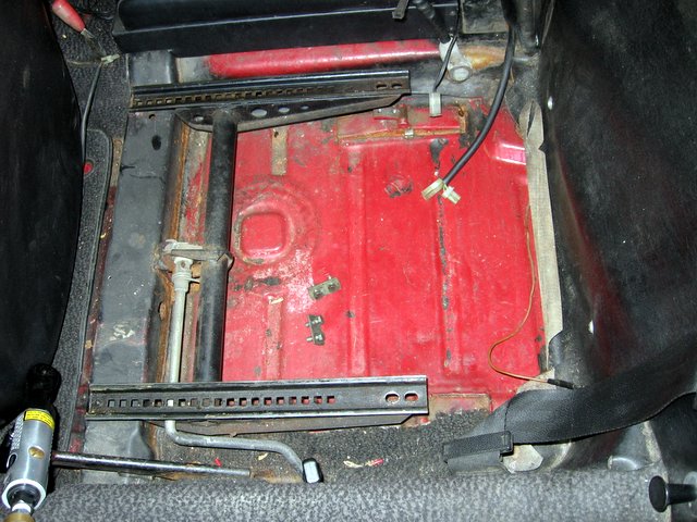

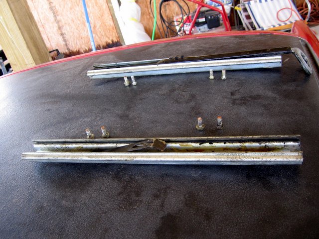

I was not going to do any work on the car while I was waiting for the injectors, but I decided to look at the seats. The seat onthe driver's side was very difficult to move. I finally got it to move, and figured out how to remove it. THe spring that holds it in is very far forward. There is also very old and very thick. Therefore, I removed the rails from the seat, and also removed the base mounted in the car. Now I can clean them and get them running moresmothly. I'd also like to swap the left and right seats, and also the side that has the adjuster on it, to make it easier to slide the seat back and forth. Here are a few pictures: ![]() ![]() ![]()

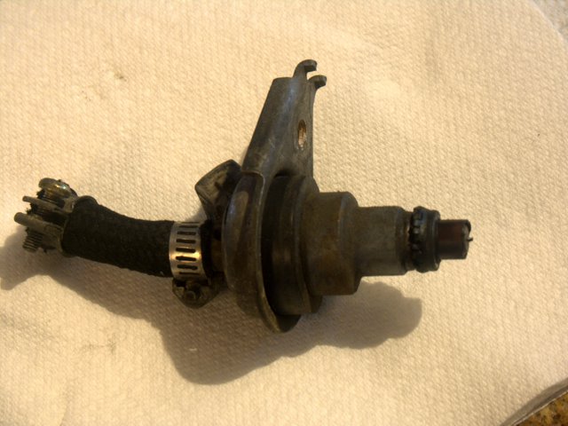

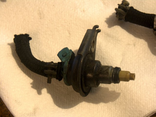

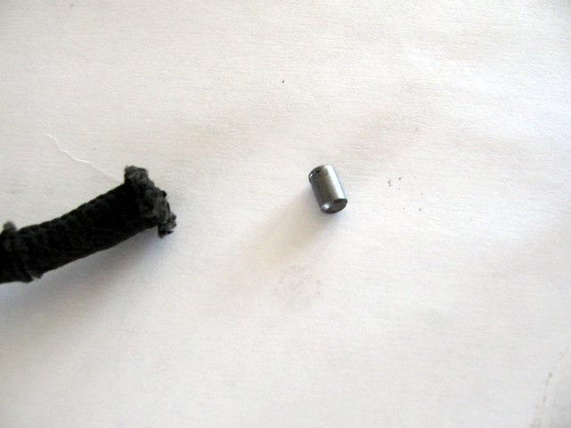

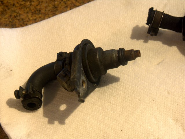

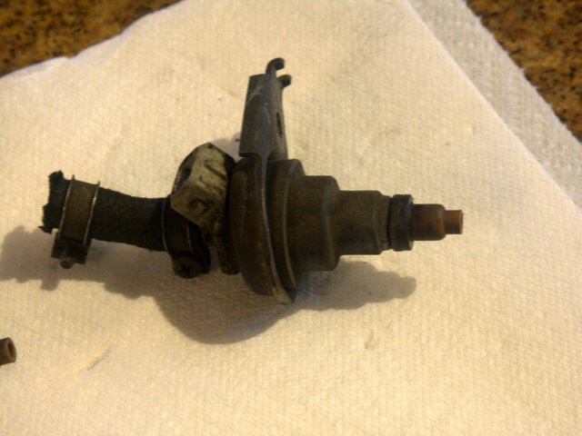

Yesterday, I pulled #1 and #2 injectors. I was going to swap them to see if the problem moved, but after geting them all the way out, the flexible hose on #2 was pretty bad. So, I just pulled them all and packaged them for shipment to witchhunter for cleaning. A few "interesting things abouit them though: #1 is blue! THe others are white??? #3 is missing most of the pintle cover(?). Anyway, witchunter said they replace those. I can'tread the numbers onmany of them. Here are the pictures: #1 ![]() #2 ![]() #3 ![]() #4 ![]() The injectors should be back in a week. Hope so!
