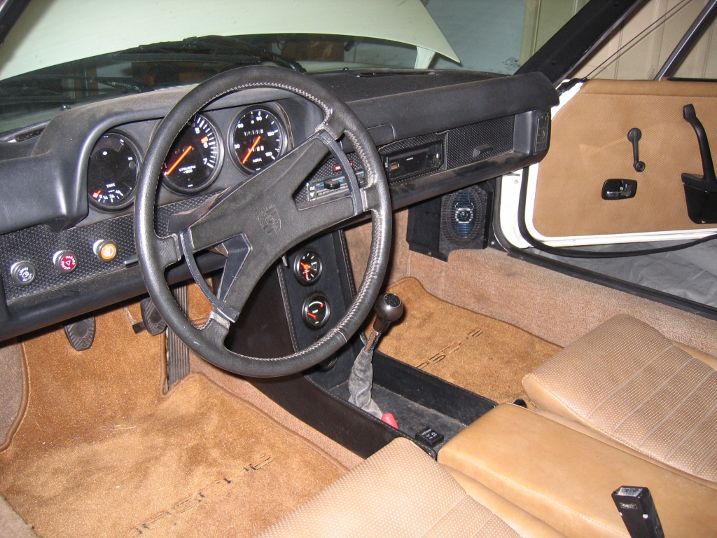

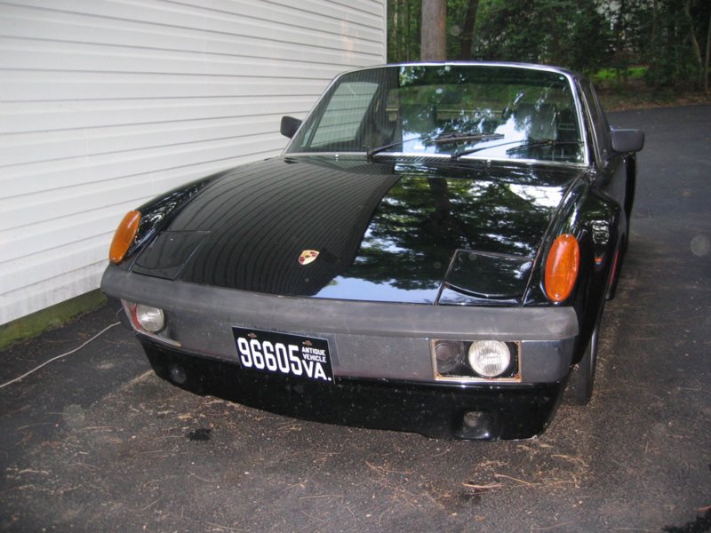

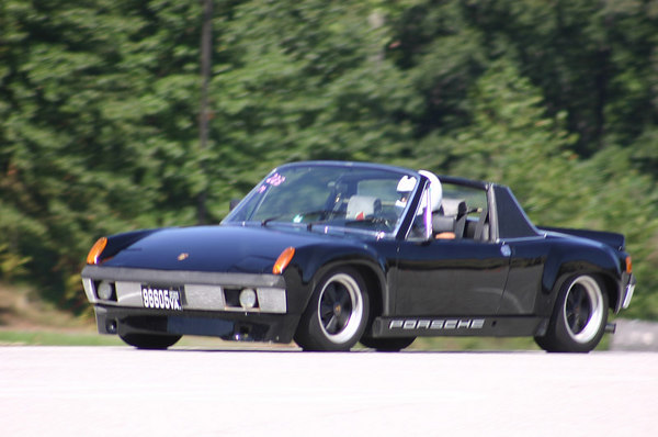

Still needs all over lovin but the rims look right now. Have to fit the body parts on better, repaint all the exterior & eventually weld a roof on. Also working on a Tan interior & rust repair. All for the love of the Teeners. Insanity! I included 3 shots of how she looked when I bought her. Note the old ill fitting front spoiler & rockers. I also hate spoilers on the trunk, don't care if they work or not... IMO they're ugly ![]() ![]() Attached thumbnail(s) ![]() ![]() ![]() ![]() ![]() ![]()

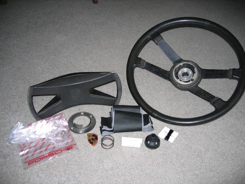

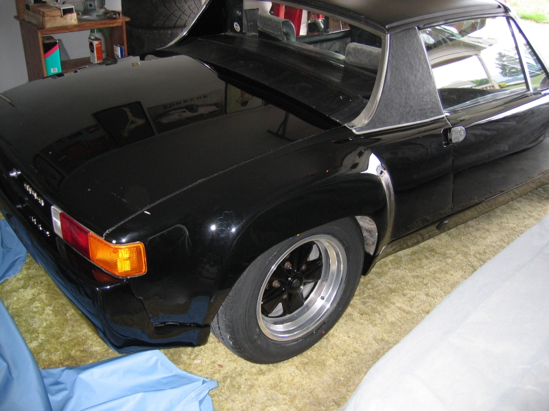

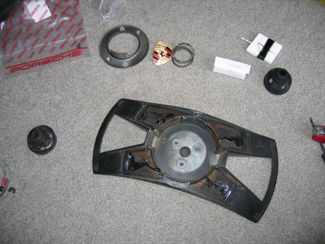

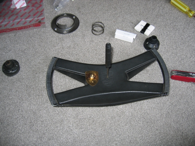

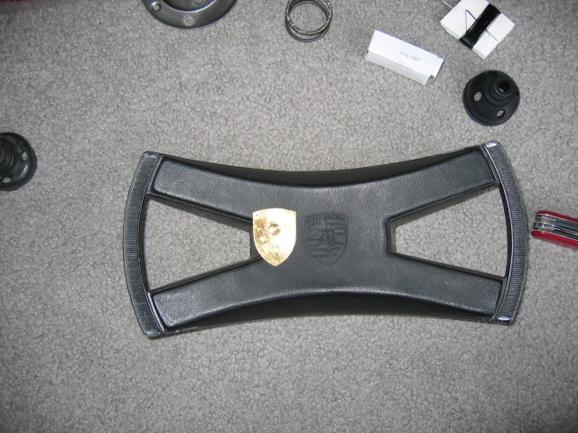

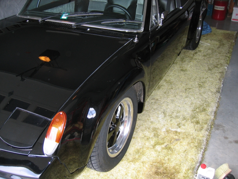

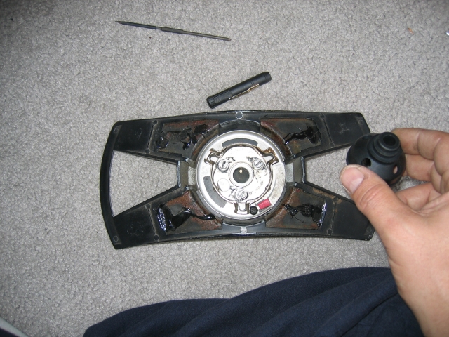

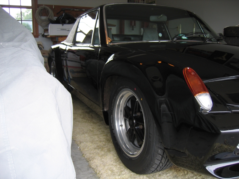

Too much on my plate so I find the most ridiculous ways of procrastinating. I've got as far as rebuilding the innerds of the horn trigger, mounting a genuine 356 Porsche crest in the centre pad, (I flattened it), & got the leather around the steering wheel. I haven't felt like stiching so I plopped on some new, (reconditioned 944 rims), wheels & tires onto the six. I used the calculator here on "the world" & mounted 215s in the front & 225s in the back. When I first bought the six, "Sir Andy" told me I needed wheel spacers up front & I agreed. So instead of stiching my steering wheel cover I poped off my calipers, undid the spacers from them, hammered out the old studs using a nut to protect them & hammered in new, longer welmeister studs. Put it back together, packed in new grease & added 21mm 944 spacers on top of the stock ones that are bolted to the rotors. I like the wide look & so does the car. Cheap Falken tires but she feels/rides great. I call that useful, instead of useless, procrastination ![]() ![]() ![]() Attached thumbnail(s) ![]() ![]() ![]() ![]() ![]() ![]() ![]() ![]() ![]() ![]() ![]() ![]()

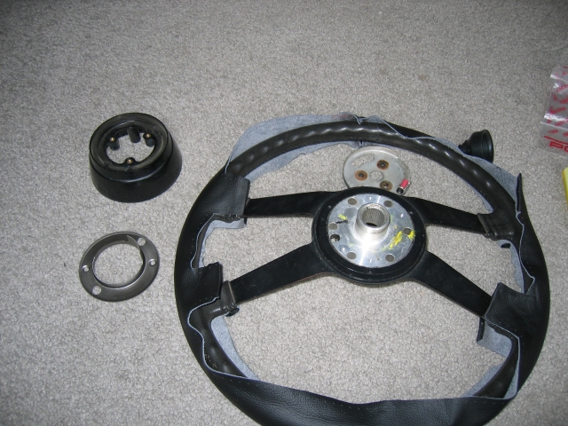

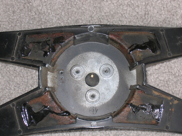

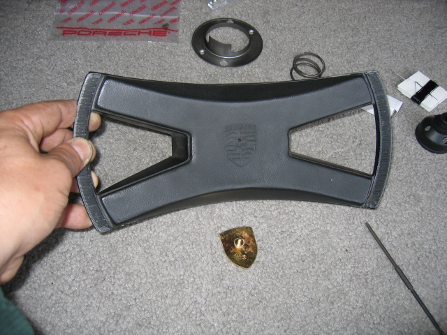

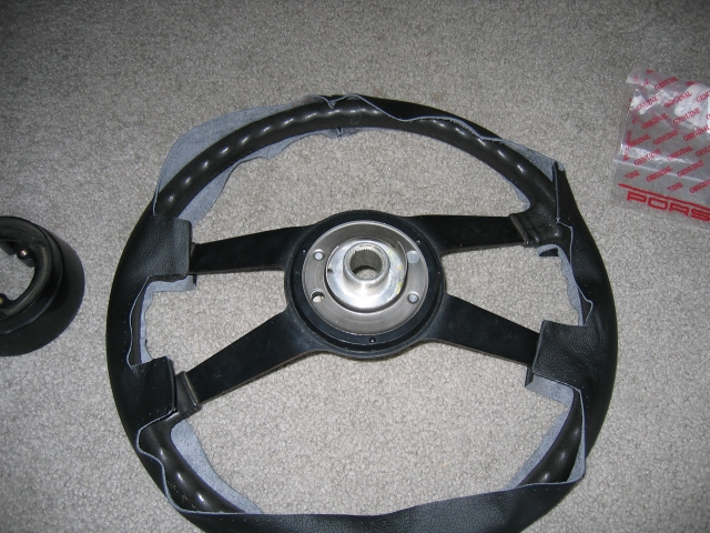

Alan Gunn may do excellent work but he's a bullshitter on the phone, period. I ordered a leather cover for the latter 914 rubber steering wheel back at the begining of March & it's now the end of April & calling him is either a BS hit or just a plain miss. Originally it was supposed to be mailed to me on March 13th ![]() ![]() edit- Yesterday, May 2nd, I opened my mailbox & lo & behold a package from Alan Gun, mailed out parcel post on Saturday 28th, not Priority Mail on Wednesday the 25th as he promised me on the phone. I placed this order on March 9th. I don't enjoy badmouthing someone but I will not stand still when I know I've been lied to. I don't lie & if you're lazy & forgot something admit it & be a man... don't bullshit someone. Missing one screw & once I got that I'll start my steering wheel project... my interpretation of a 914GT/RSR restomod steering wheel. ![]() Attached thumbnail(s) ![]()

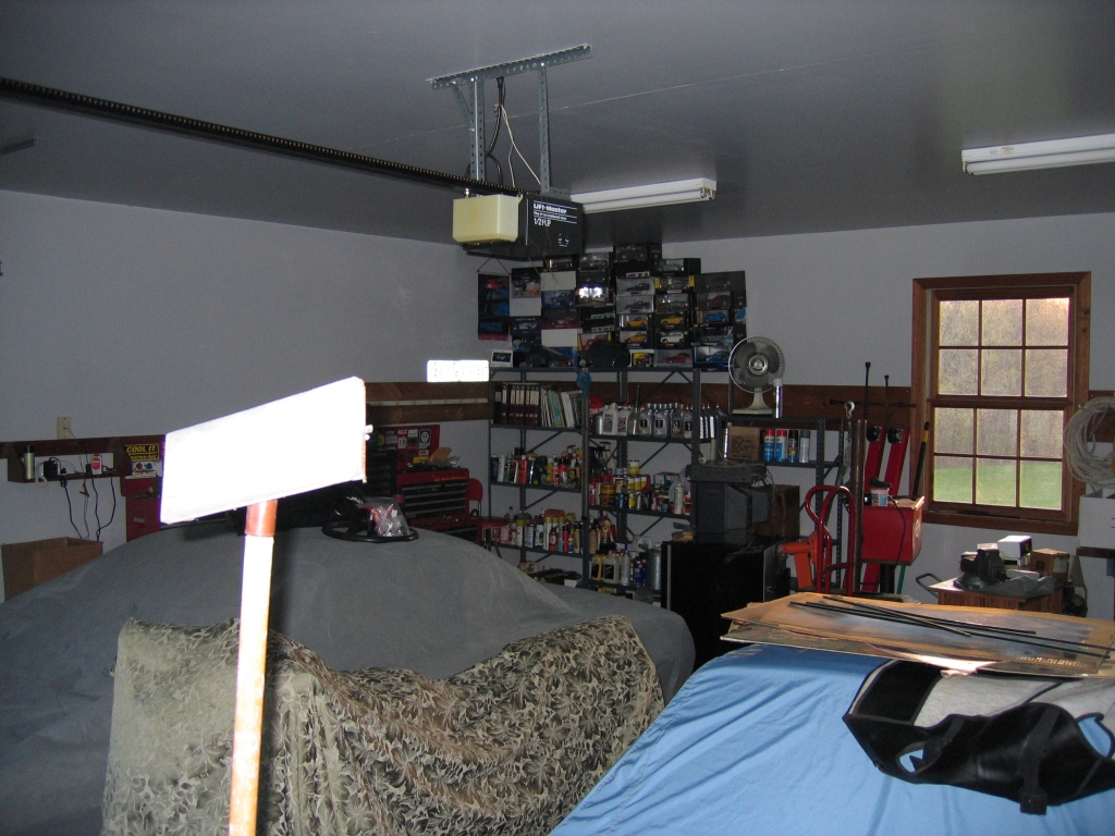

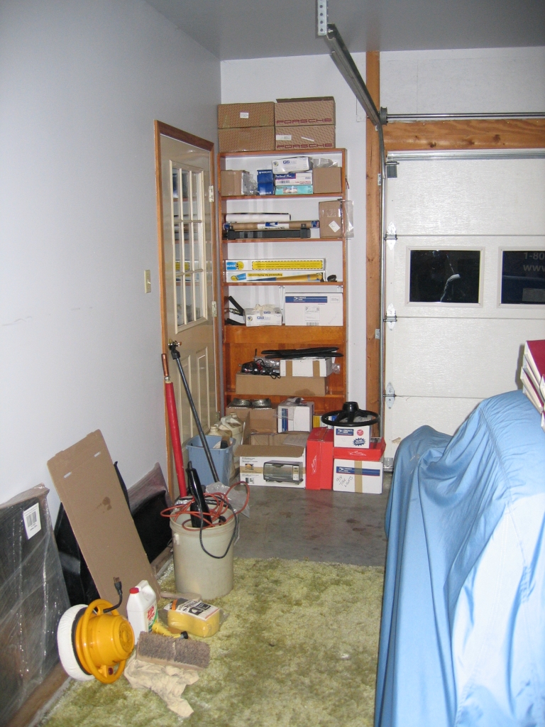

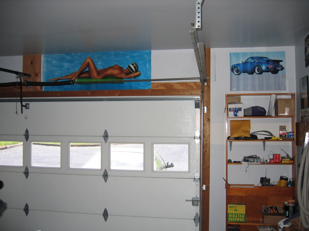

I hate unpacking but I do like decorating gargages my way ![]() ![]() ![]() ![]() Attached thumbnail(s) ![]()

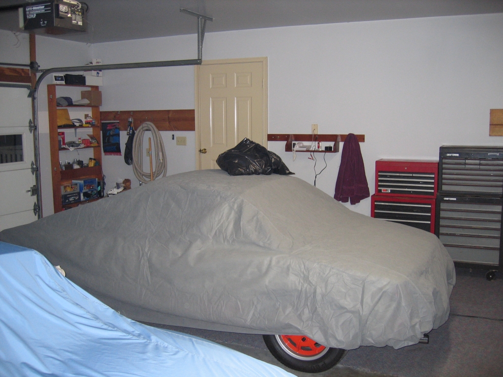

Been neglegting the teeners as of late dealing w/ the rest of my stuff & the big move into the new house. Nice to be able to just leave them covered in the garage. Plan on doing a mini segment on the rebuilding of my "new" steering wheel for the six. Photos & thread to start as soon as I have all the components lined up. Mr. Gunn sure takes his time w/ everything & is a serious telephone BS'er. One screw & the actual leather kit & I will make myself a sort of stock looking RSR steering wheel. ![]()

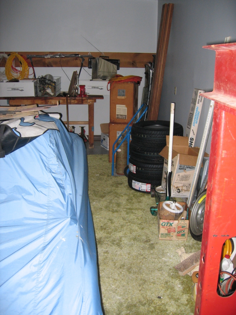

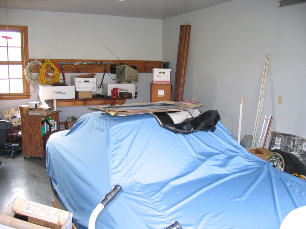

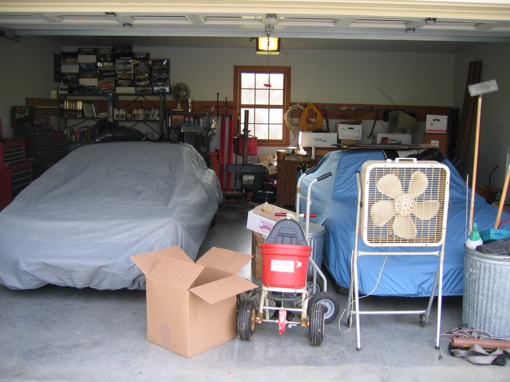

I remembered that this blog is an attempt to document the construction/assembly of my 914 room. So after hauling a bunch of loads from storage I got lucky & managed to shoot some photos today after taking a shower & drinking some coffee. Somehow all this clutter is progress. Now if I can find the keys to my tool chests ![]() ![]() ![]() ![]() Attached thumbnail(s) ![]() ![]() ![]() ![]() ![]()

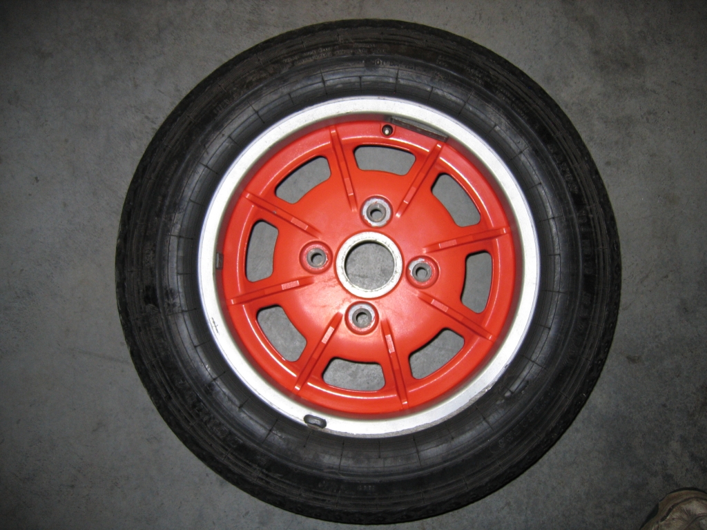

I have DSL @ the new pad & I'm up & it's fast. Did some more moving from Rockville to New Market today in the Truck. Also pulled a run on my storage unit. Busy day. Not organized in any way, just sorting out parts between the four & the six. Snapped this pic of Knikkis' interior showing 47,557 original miles. Also snapped this shot of an original Dunlop 165/15 on my original, un-repainted spare. Councours baby ![]() ![]() ![]() ![]() Attached thumbnail(s) ![]() ![]() ![]()

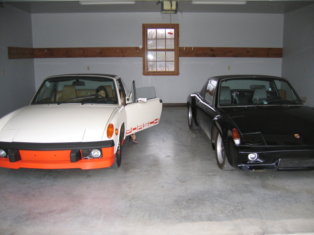

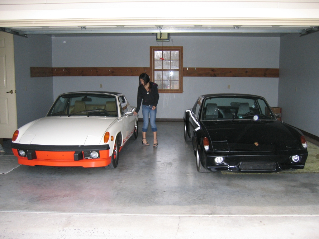

Well once again I'm here & was not expecting to be. Perhaps this will be my last entry for a while as the "Twins" are home. Everything else I have to do now won't be so Porsche related so maybe I will be absent a few days ![]() I did something today I have not done in quite some time, years now. I drove 2 different teeners in one day, one right after the other. Wow! What fun! ![]() ![]() ![]() ![]() ![]() ![]() ![]() I enjoyed the company of a 19 yr old goddess named Melodie today. Mel is a local Nopi Chic who also works at the body shop my friend Mark ownes. She was the one following behind in her car, packed w/ my ![]() ![]() Attached thumbnail(s) ![]() ![]() ![]() |
