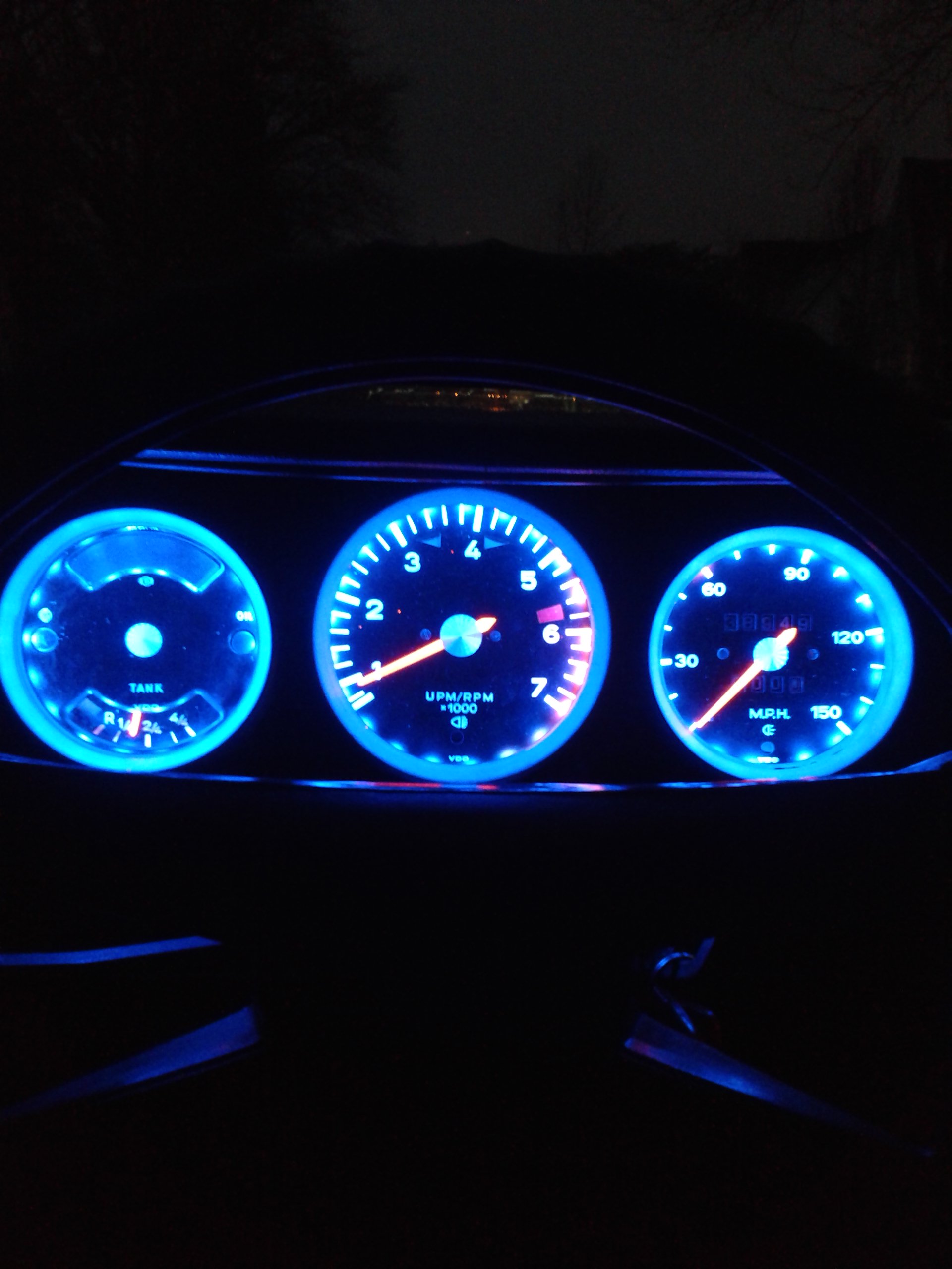

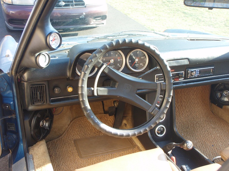

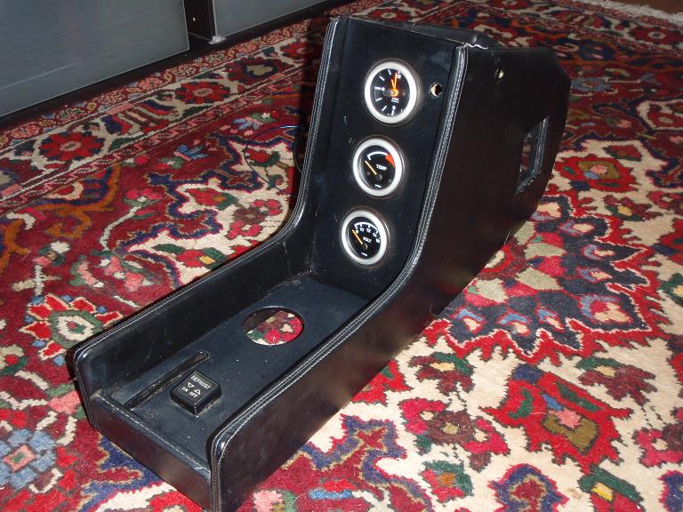

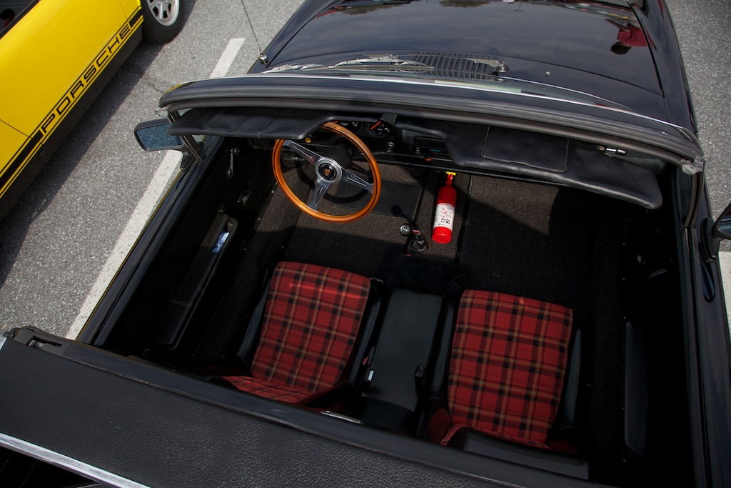

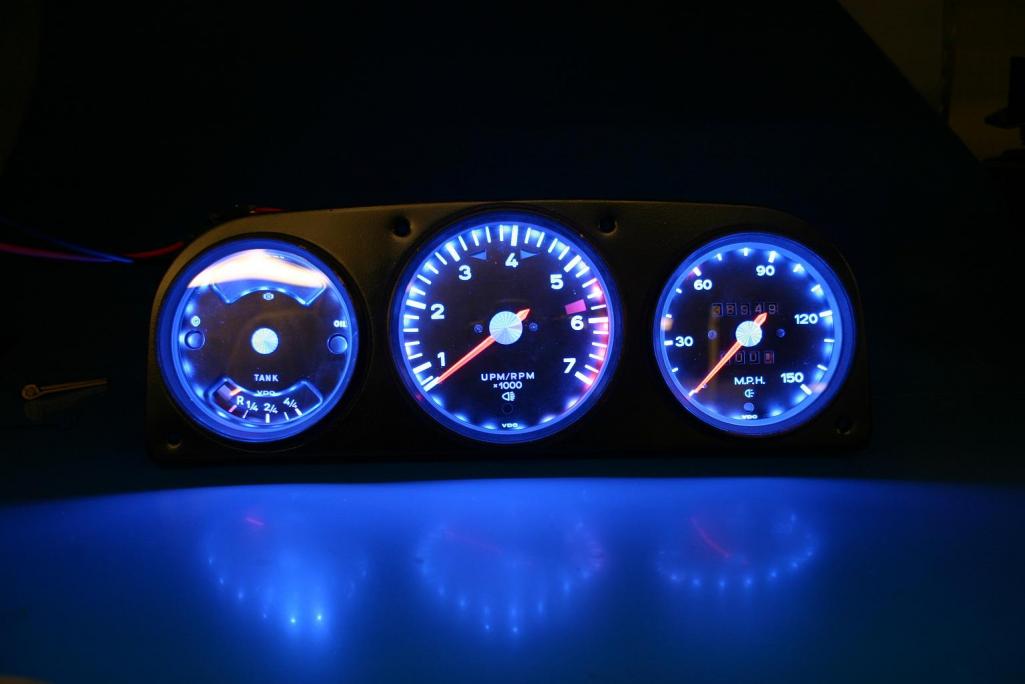

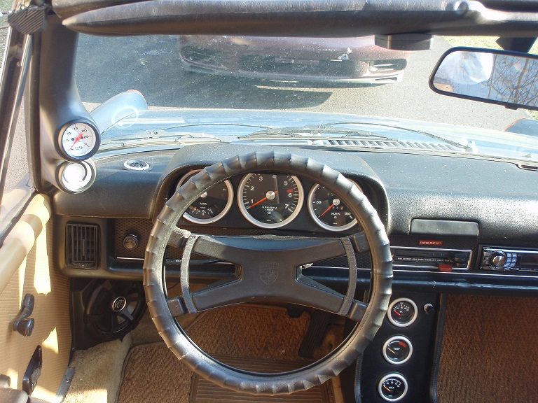

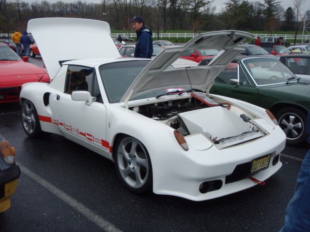

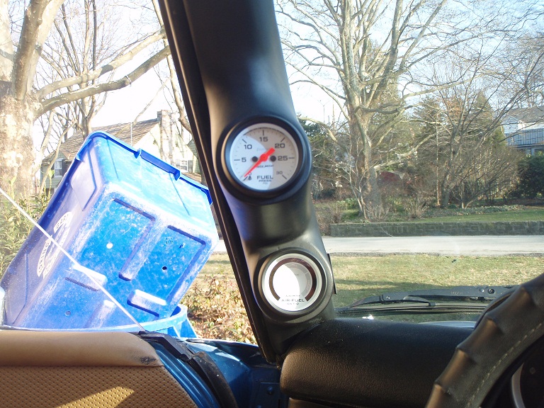

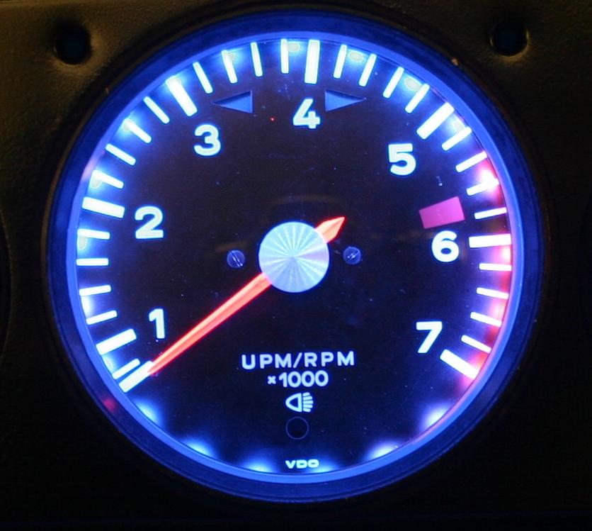

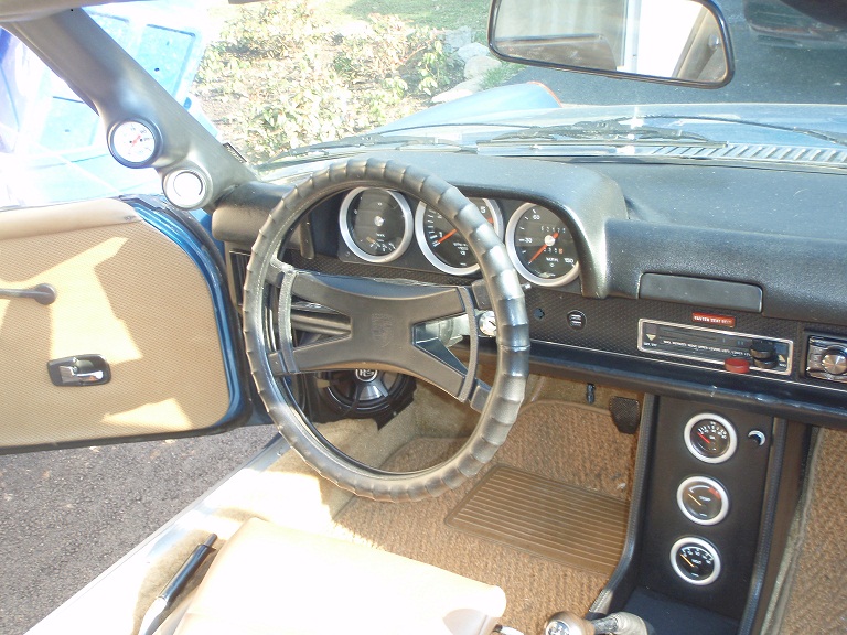

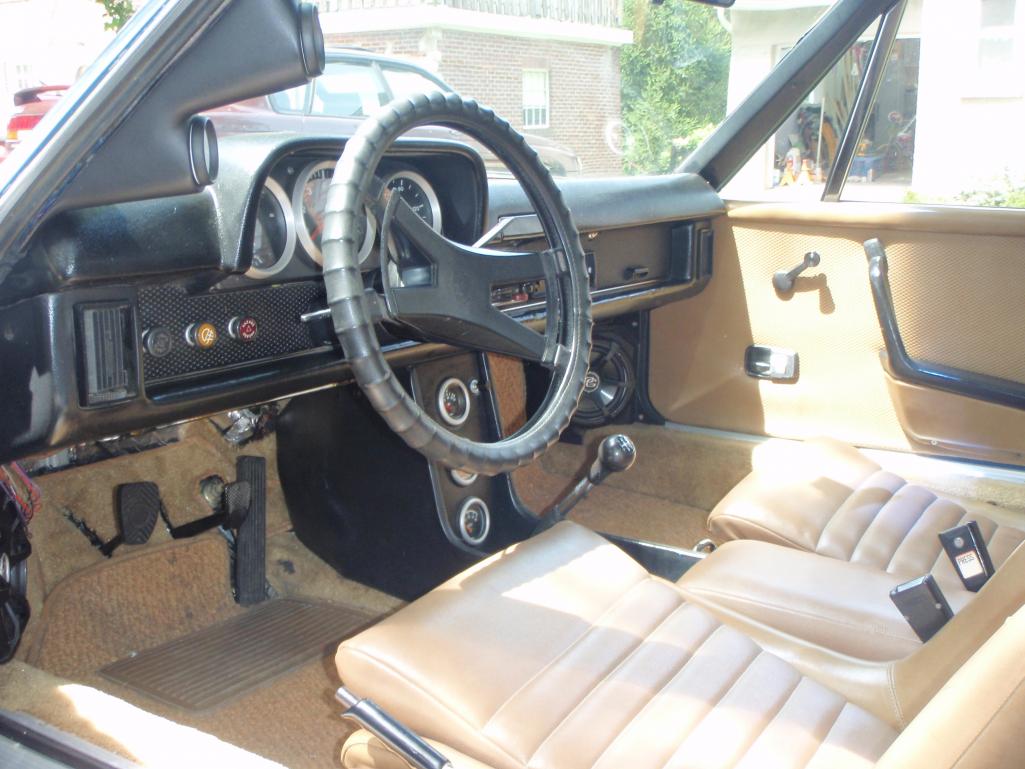

I went ahead and added some gauges to the teener today. (3) to be exact. I got rid of the clock and replaced it with an oil pressure gauge. It is smaller than the stock gauge, so I used a bit of superglue and managed to get my aluminum ring to fit pretty well. I didnt want to loose the uniform look with the trim rings I purchased. The other 2 went on the pillar, a fuel pressure gauge to monitor the D-Jet, and a Air Fuel gauge to keep in tune. biggrin.gif I did not want to install the pillar at first, but bit the bullet when i saw the alternatives. I actually really like it Attached thumbnail(s)

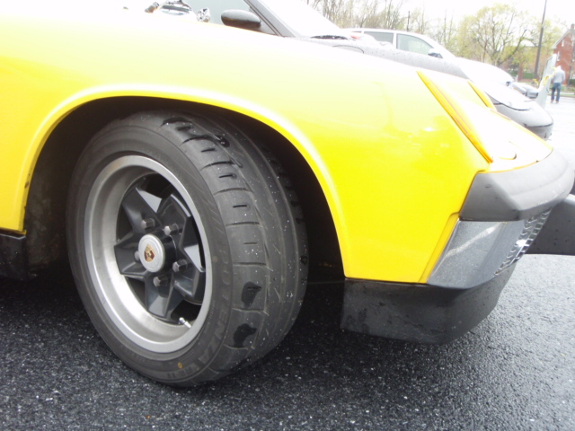

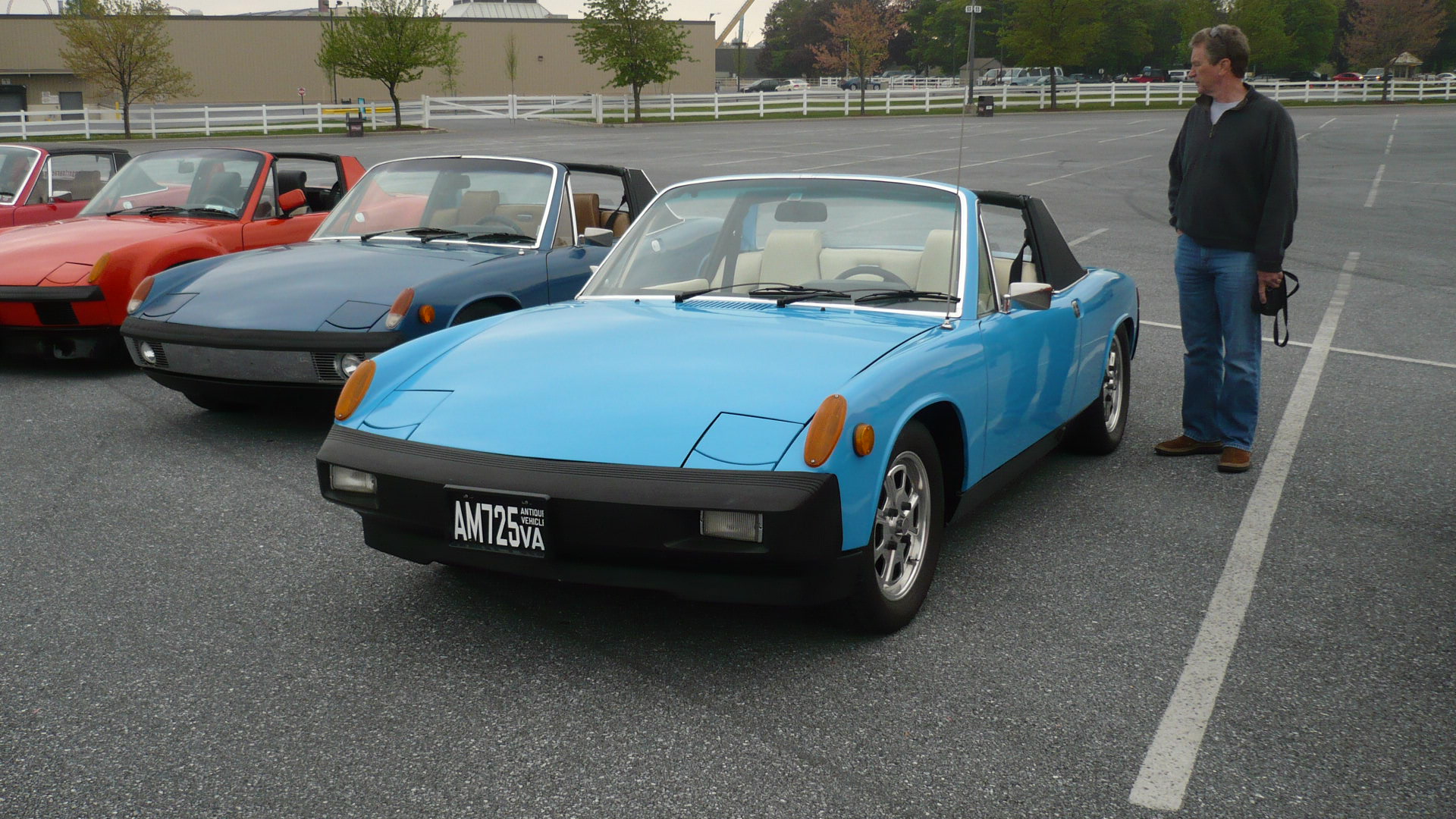

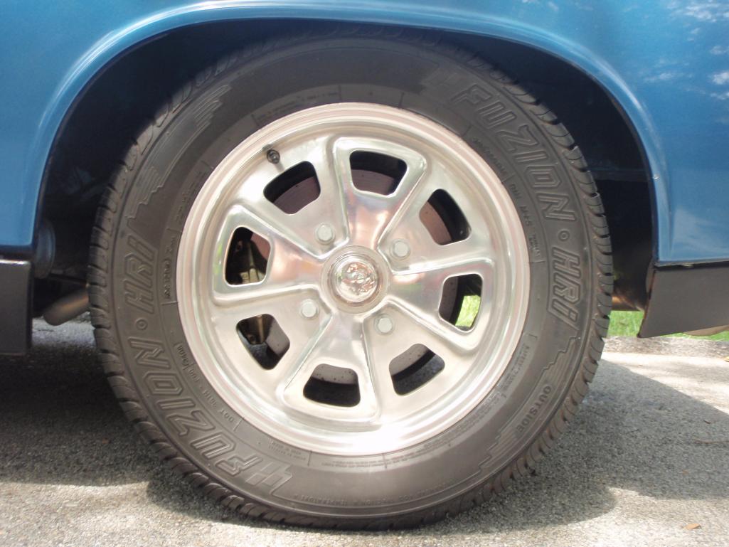

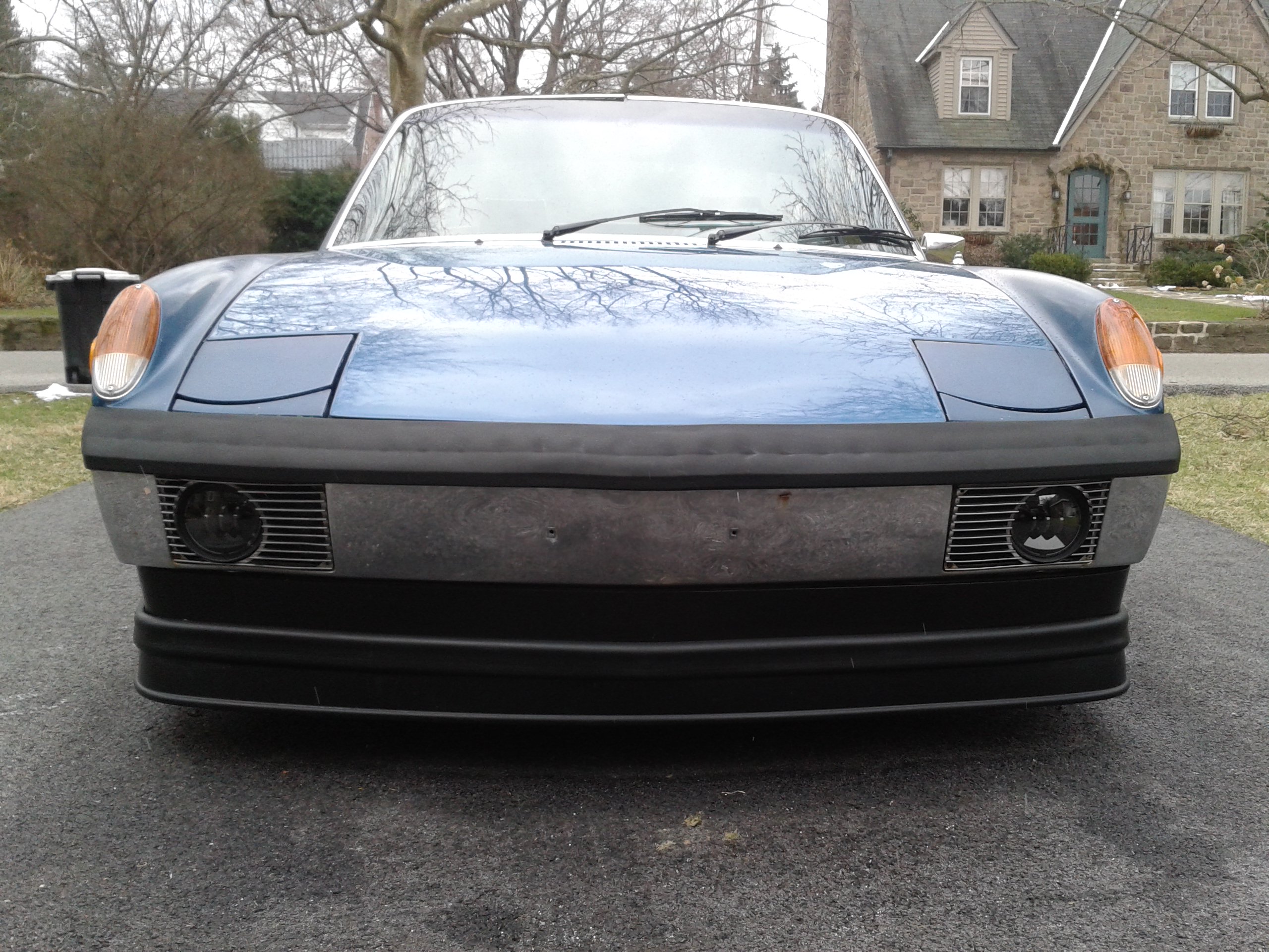

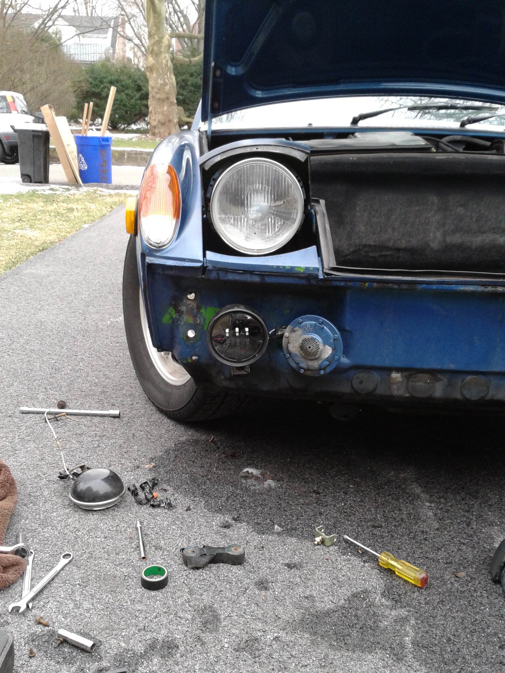

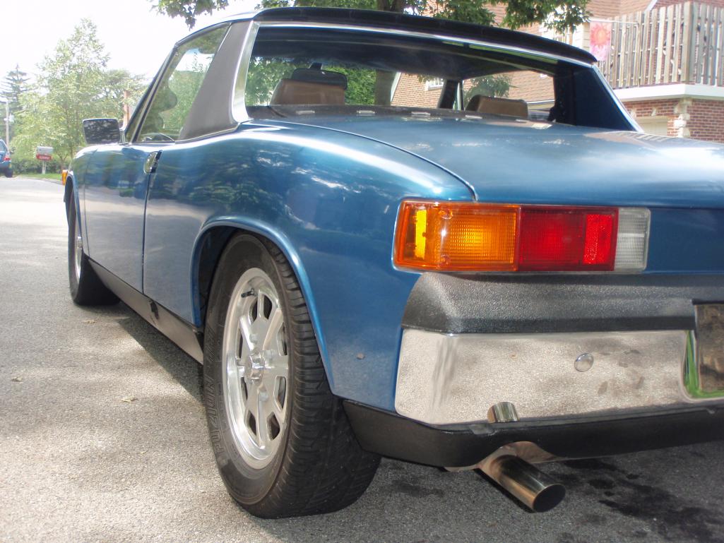

I orderd some wheel spacers to get the front wheels pushed out to fill in the wheel wells. The front track on the 914 is actually about 1.5 inches narrower than the rear. Finding 4 bolt spacers was not easy, but the hubcentric ones I found are absolutly awesome. I had to get some custom bolts that were 20mm longer than the 38mm stock bolts. The spacers are 20mm each. The front track is now the same as the rear, and it looks bitchin Attached thumbnail(s)

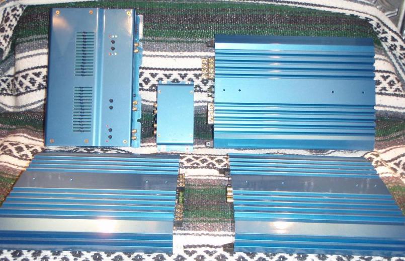

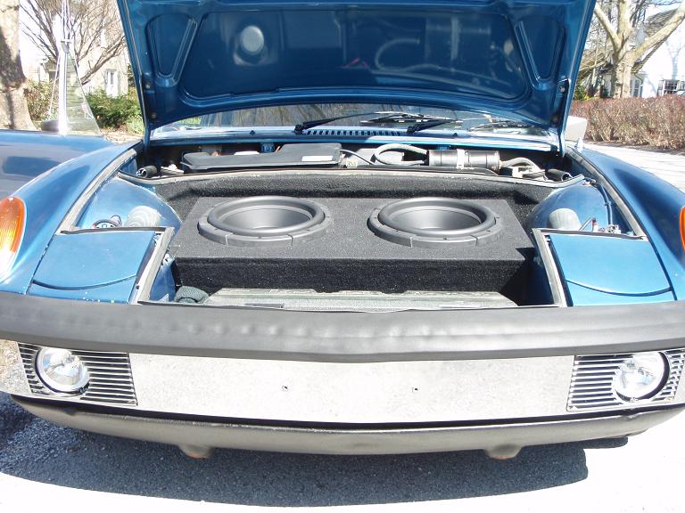

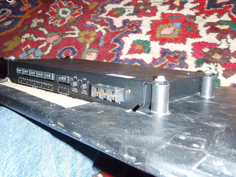

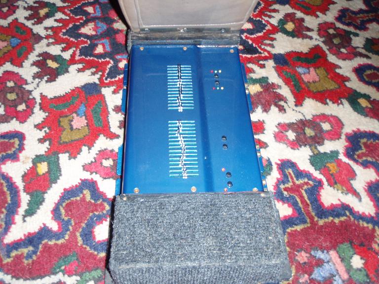

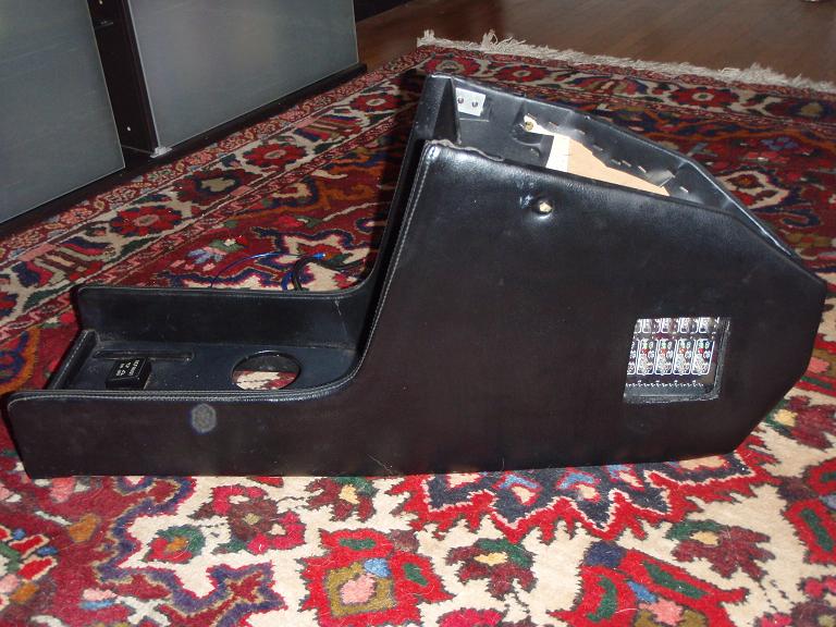

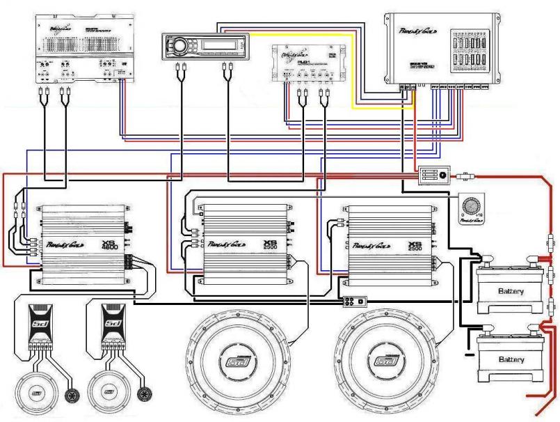

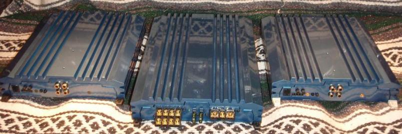

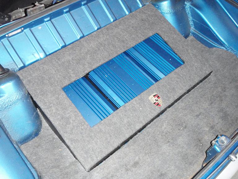

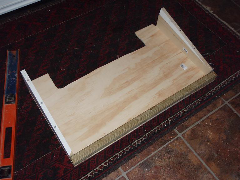

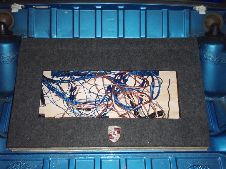

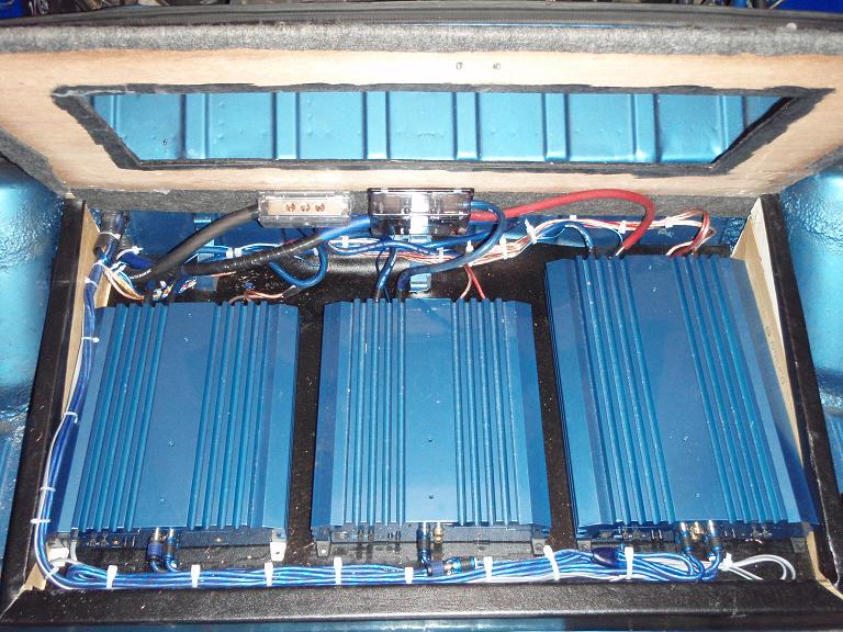

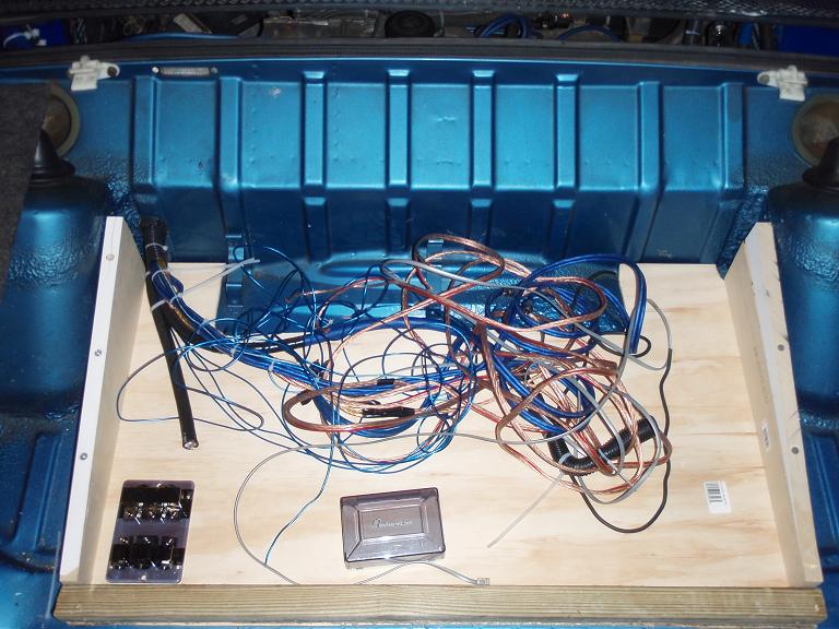

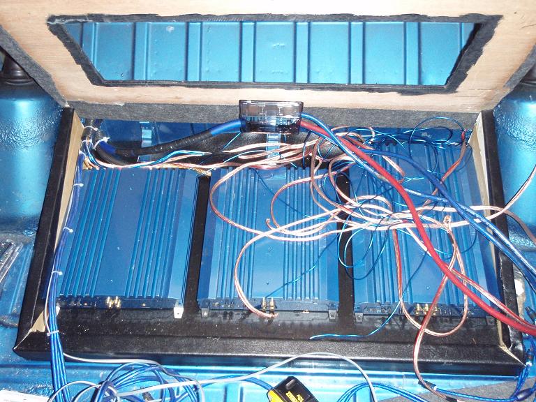

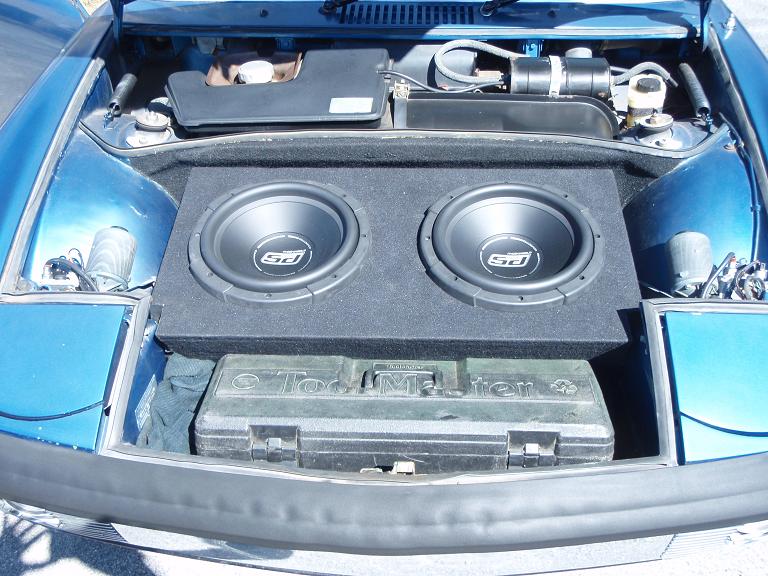

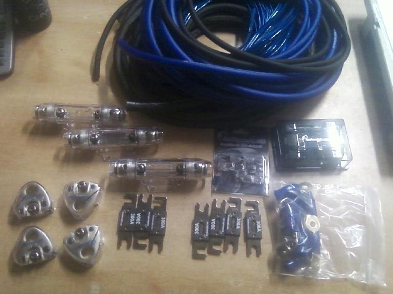

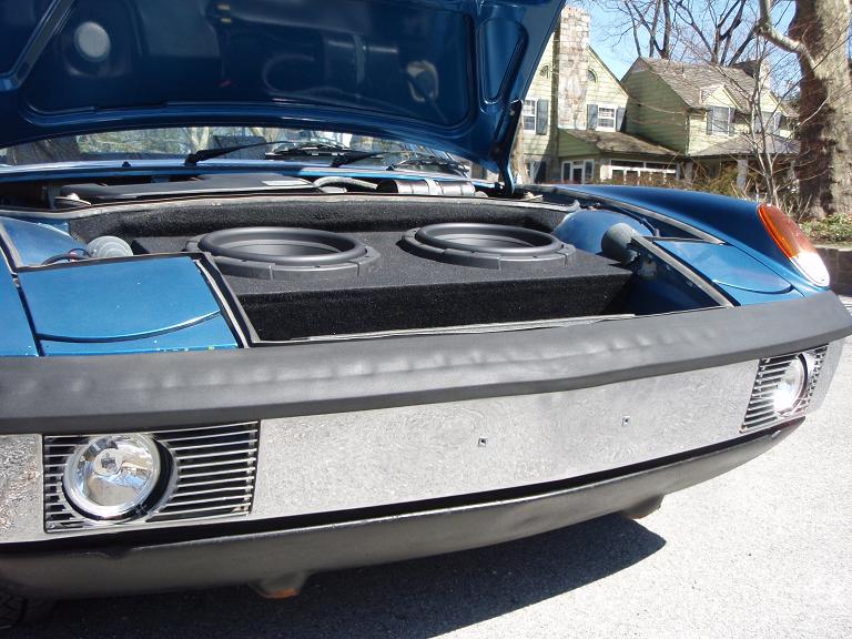

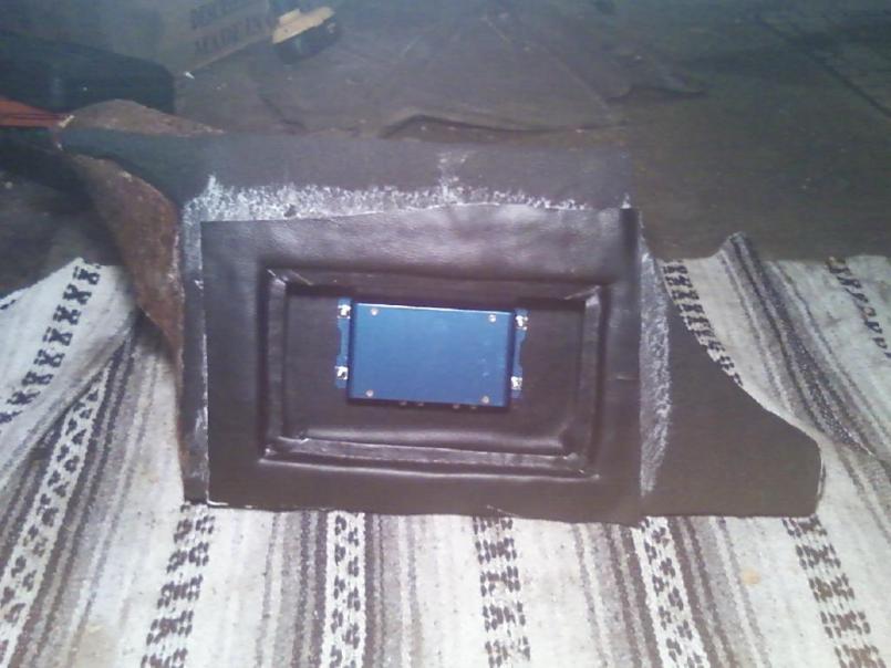

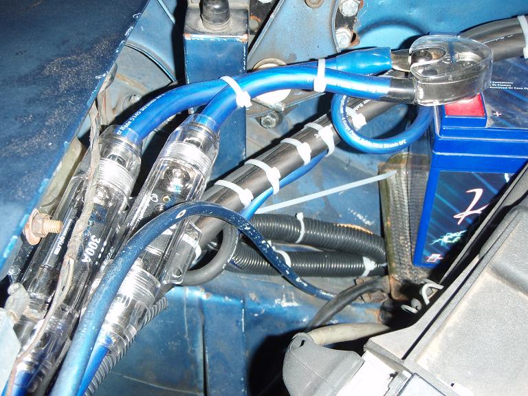

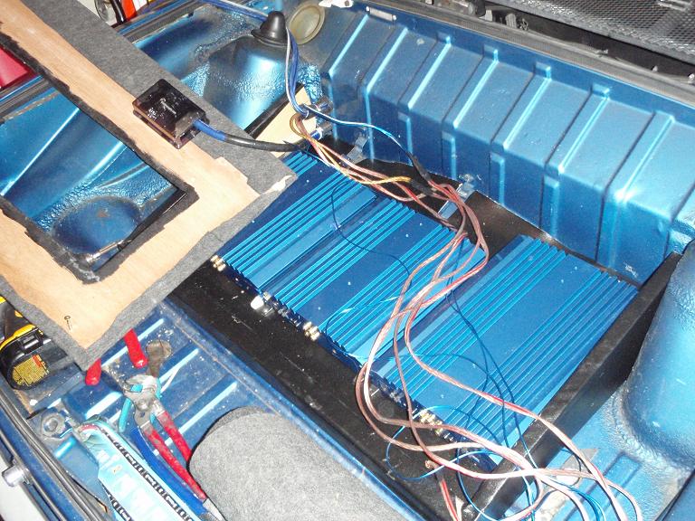

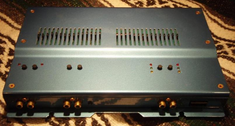

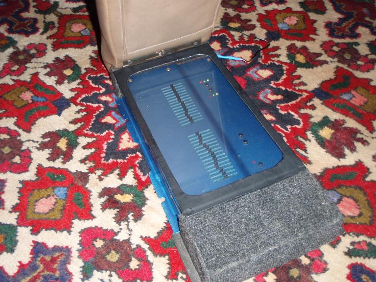

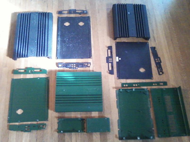

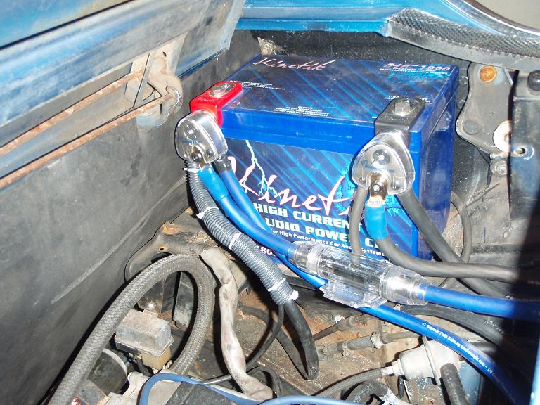

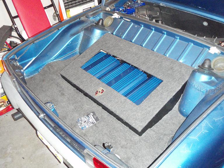

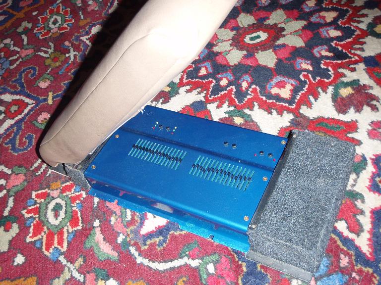

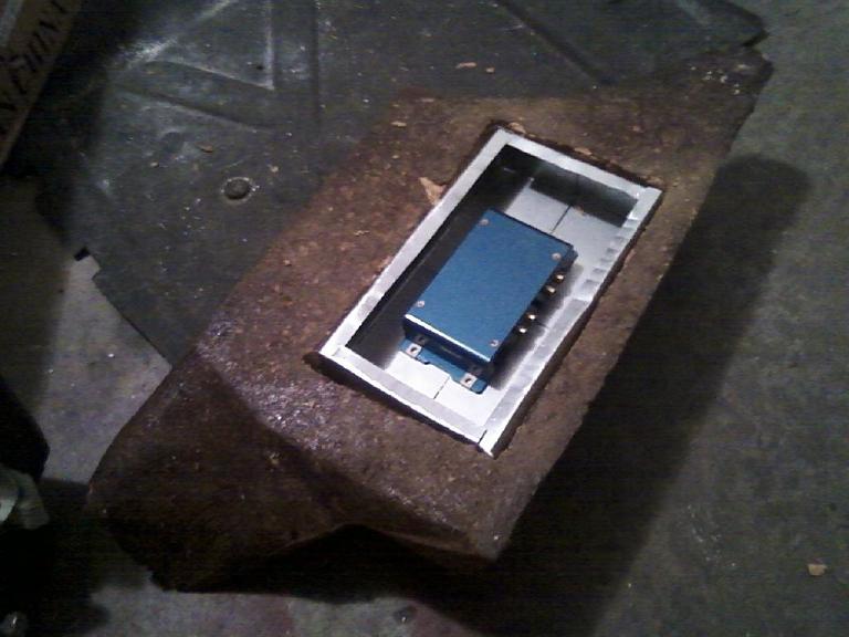

Here is the list of what i got: > CDA 9887 Headunit w/ 4volt preamp output X 3 (im gonna use 2) > Phoenix PLD1 Line Driver will feed the 2 bass amps > Phoenix EQ215i Equalizer w/ 15 adjustable frequency controlls for each channel to feed the mid/high amp > Phoenix XS2500 Amplifier X 2 I will be running one of these for each 12" woofer Bridged into 1 Channel @ 2 Ohms rated at 300 watts X 1 Continuous output I also have the LPL44 remote bass knob to control both amps you need adjustment with the top on vs off > Phoenix XS 4600 Amplifier This will be for the component set Bridged into 2 Channels @ 4 Ohms rated at 150 watts X 2 > Phoenix DD5 Desmazes Delayeator This little Baby turns on and off each amplifier and processor it has adjustable delayed fused circuits for the remote and power wires to eliminate any noises when components are turned on or off. (very cool) > Phoenix RSDC122 12inch Woofers X 2 Each woofer has dual 2ohm voice coils Rated at 600w Rms / 1200w Peak > Phoenix RSD 6.5ds Component Speakers 6.5 inch component w/ tweets Rated at 120w Peak The Plan: Headunit goes into the stock position. PLD1 goes in passenger footwell, hidden under carpet. DD5 goes into center console. EQ goes between seats, hidden under center cushion. LPL44 Remote knob mounts to new center console. 3 Amplifiers in rear trunk desigend by Me 6.5 drivers go into fiberglass kicks. Tweets go on the pillars or dash. Woofers go in front trunk w/ another wood/glass enclosure. All of it completely hidden from view. Attached thumbnail(s)
