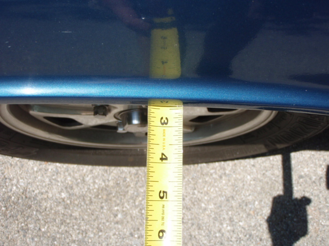

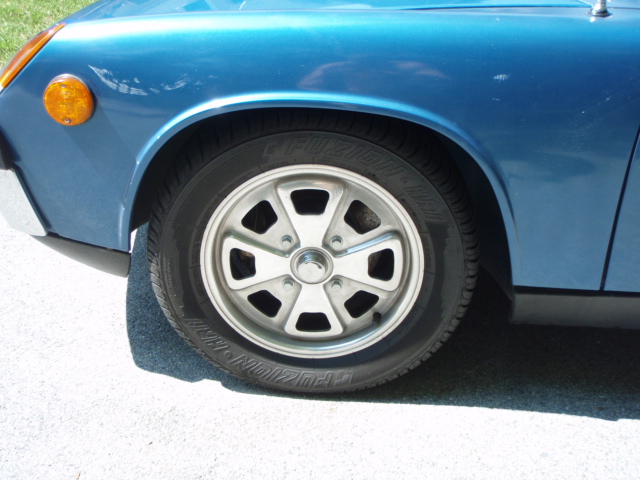

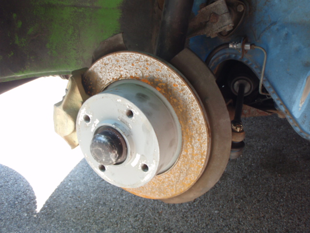

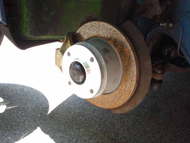

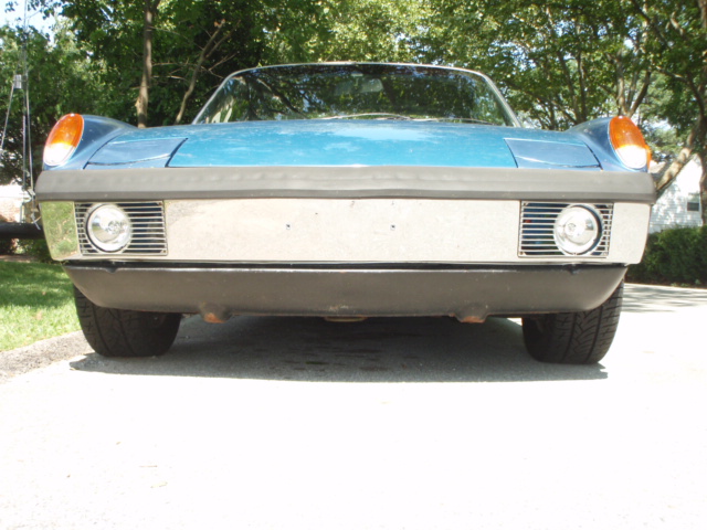

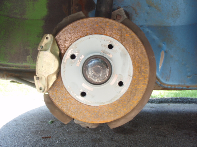

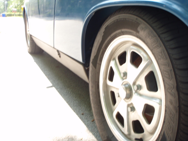

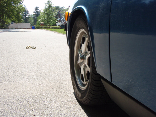

I orderd some wheel spacers to get the front wheels pushed out to fill in the wheel wells. The front track on the 914 is actually about 1.5 inches narrower than the rear. Finding 4 bolt spacers was not easy, but the hubcentric ones I found are absolutly awesome. I had to get some custom bolts that were 20mm longer than the 38mm stock bolts. The spacers are 20mm each. The front track is now the same as the rear, and it looks bitchin Attached thumbnail(s)
