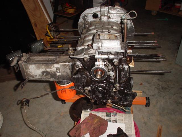

entry Jun 8 2010, 07:49 AM
Attached ImageGA002547

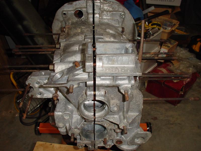

Attached ImageAttached ImageAttached Image

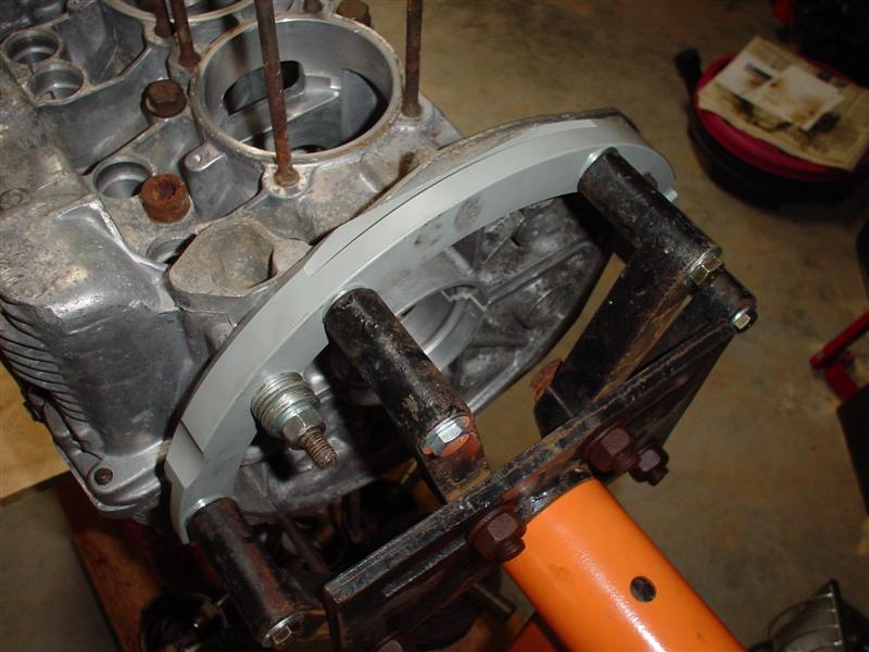

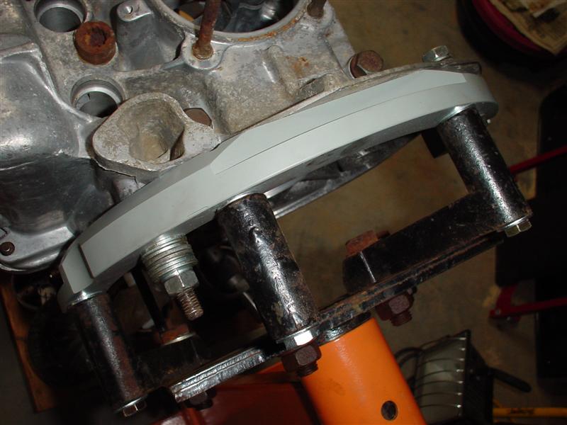

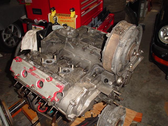

I picked up the case, heads and crankshaft from the machine shop yesterday and mounted the case on the engine stand.

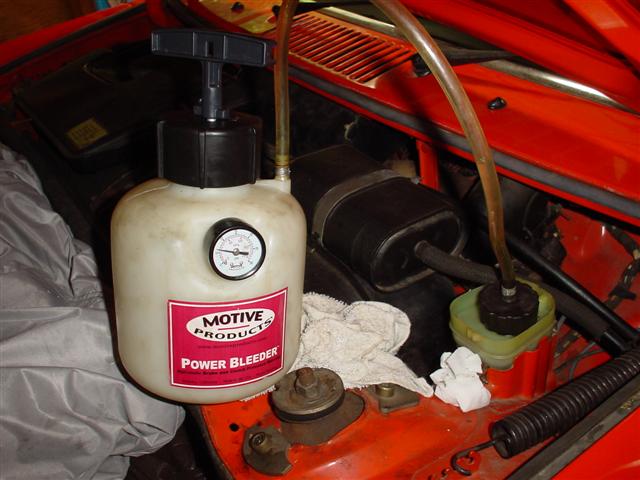

entry May 3 2010, 04:35 PM
Attached ImageFlush brake fluid
Attached ImageTighten LF wheel bearing

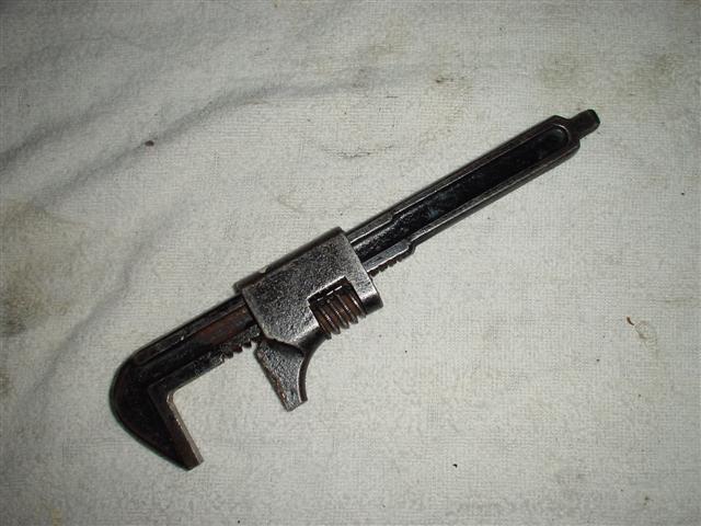

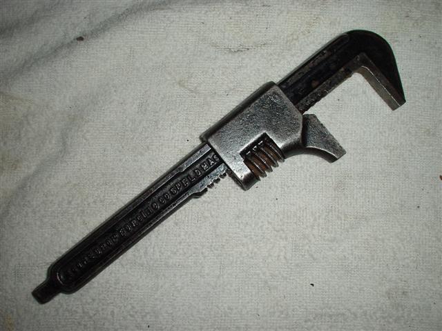

Attached Imagehand wrench

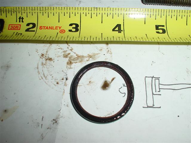

Attached Image029.105.245 B sealing ring /rear crankshaft seal $95 qty: 1

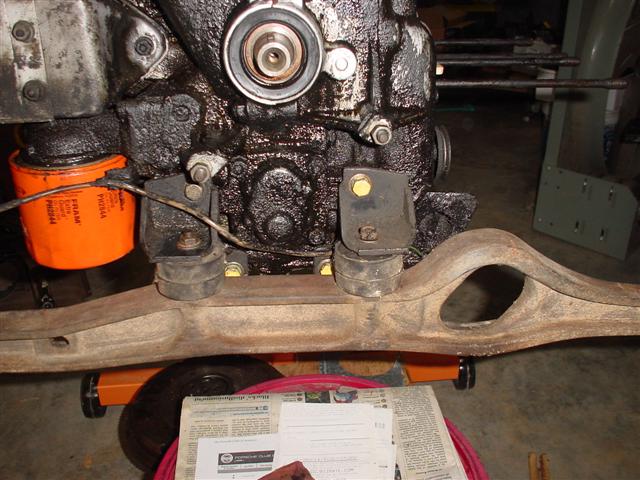

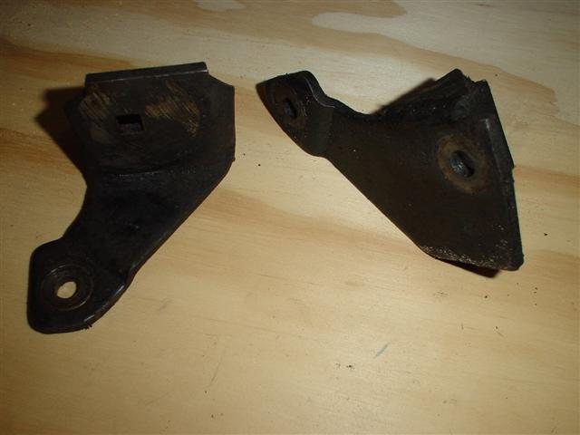

entry Mar 15 2010, 02:09 PM
Attached Imagedipstick

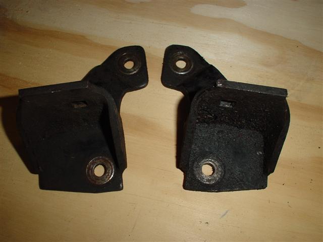

Attached ImagePET 1/1A 039.199.221 support, left
Attached ImagePET 1/1A 039.199.222 support, right

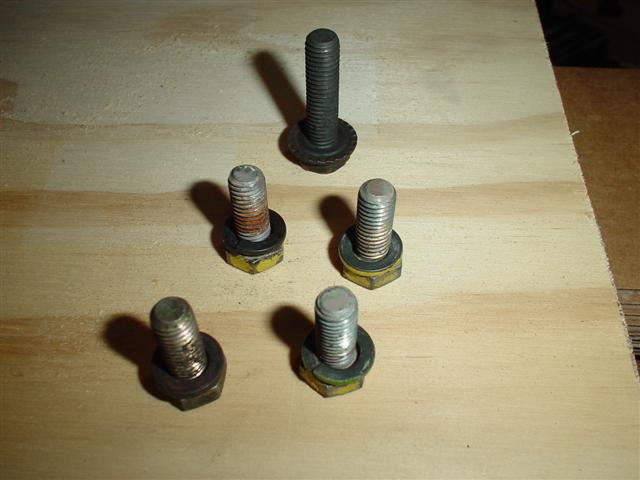

Attached ImageN 014.329.1 bolt, hex M8x20 self locking

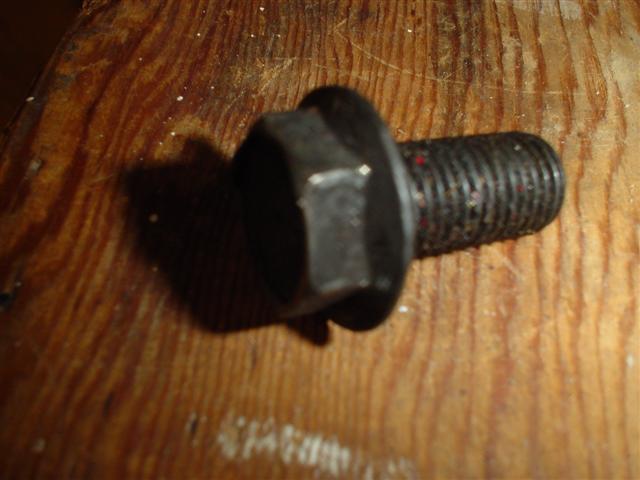

Attached ImageM8 hex head bolt with washer
Attached Imagetorque 21.7 ft lb (3mkg)
Attached Imagehex nut and washer engine mount 039.199.231

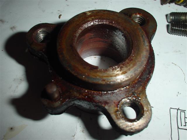

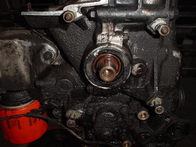

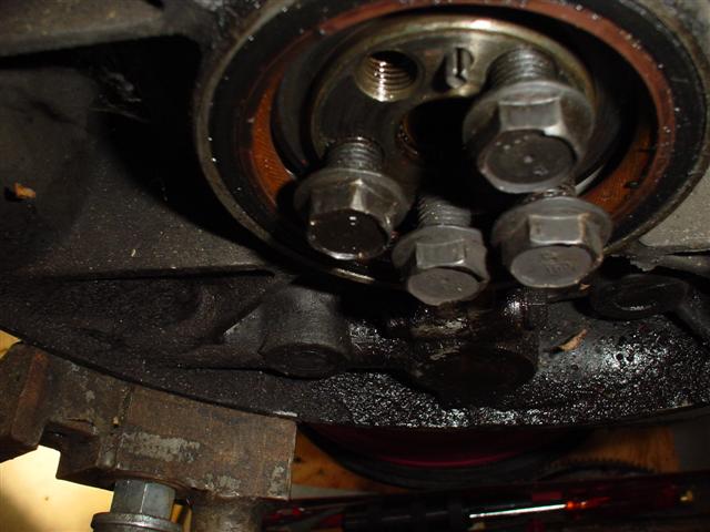

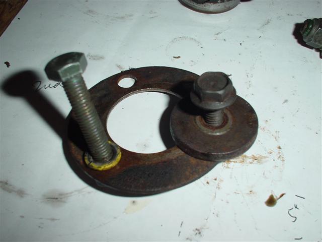

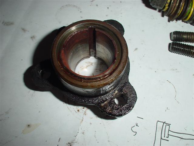

entry Mar 13 2010, 09:06 AM

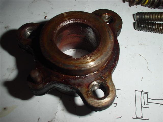

Attached ImagePET 115-00 #2 021.119.119 hub qty:1
Attached ImagePET 115-00 #4 021.119.125 A sealing ring qty:1
Attached ImagePET 112-00 #14 N 012.708.2 woodruff key 4 X 5 qty: 1

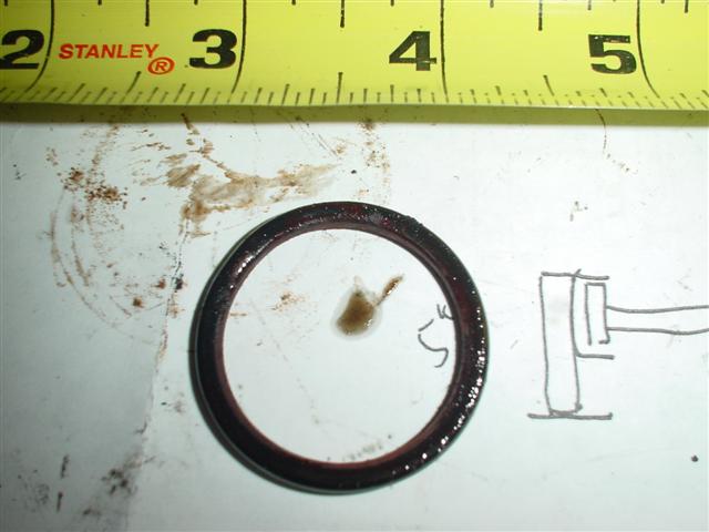

Attached ImagePET 112-00 #13 021.105.247 A sealing ring $ 62MM qty:1 E ?

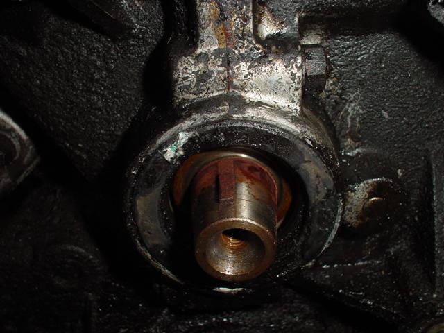

Attached ImageAttached ImageAttached ImageAttached Image
The hub finally came off with a surprising amount of energy in the release. The hub bolt and washer were turned in (but not enough to tighten against the hub) in case the hub sprang off with enough energy to shoot it as a projectile, this acted like a teather and there was an audible "tink" when the hub popped off.
