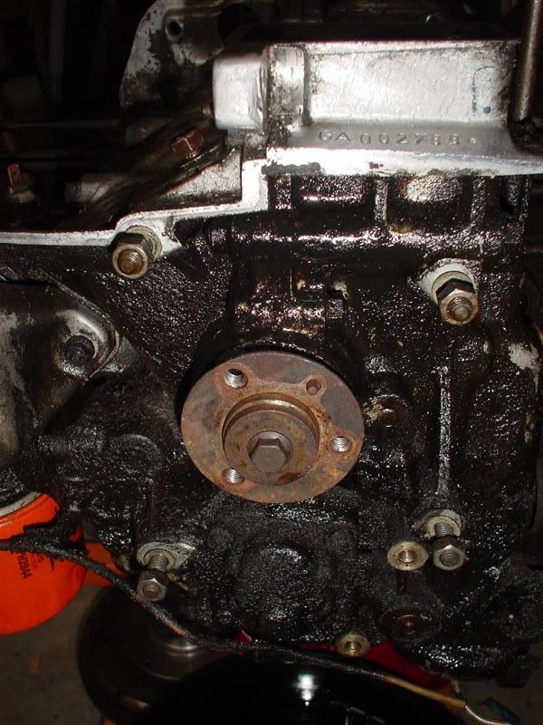

Attached Image021.119.119 hub
Attached ImagePET 115-00 #3, 5, 9
#3 021.119.121 spacer qty: 1
#5 N 014.326.1 hexagon-head bolt M 8 X 30 self locking qty:1 E
#9 021.119.131 washer qty:1 E

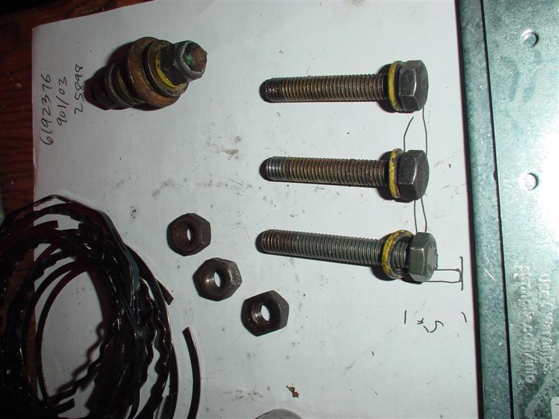

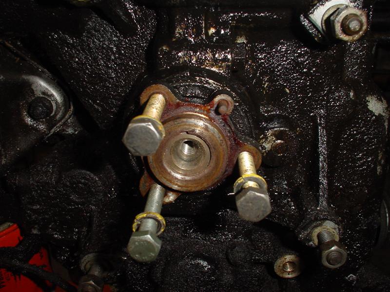

Attached Image3 bolts threaded the entire length

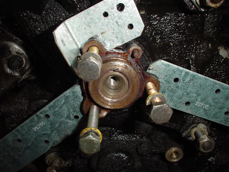

Attached Imagemetal stock behind hub
