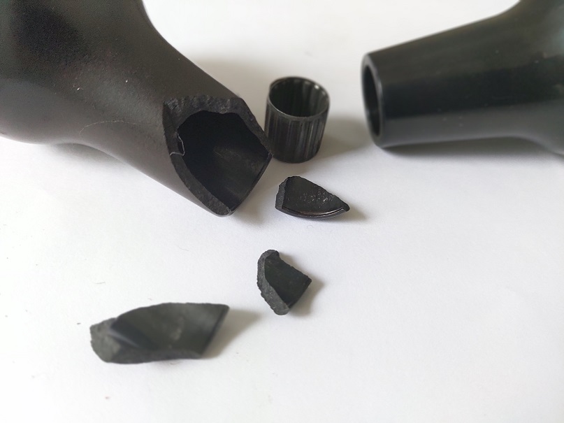

The shiftknob on my 73 1.7 was a bit loose. I pulled it off, came of easily.
The crushsleeve also came out. I did not understand how to refit is so it was tight, so I searched on 914world. I read the trick to use a strip of paper or felt over the shifter and then push the knob over it.....and being Dutch that sounded like a cheap solution !

well...when I pushed down the knob I cracked the brittle original shiftknob in several pieces....unusable (IMG:style_emoticons/default/sad.gif)

Sounds like the knob was already cracked. That is why it came loose from the shifter in the first place, and then the felt just split it wide open.
I have tried many options, and have had a "second" quality knob I made on several of my tools held on with felt. It does work, but it also needs to be refreshed every now and again as the felt gets compressed. I've found paper to be better.
As for the original crush ring - the tip above nailed it. I start with the ring 1/4 into the sifter bore. Place that over the shaft. And then tap it down with a wooden or leather or rubber mallet. Never use a metal hammer.

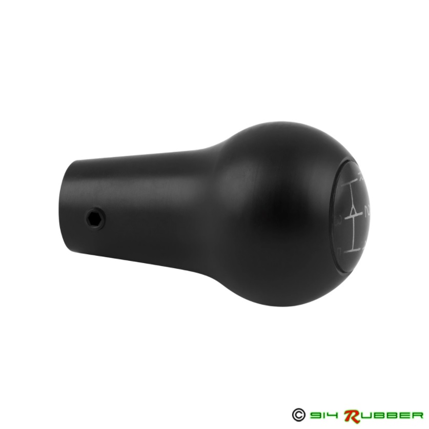

I have found that the best way to solve this problem is to drill a small hole in the base of the knob and then screw in a set screw. Forget the crusher rings, they always fail at the most inopportune times. If you do it right, you can use a very small screw that is recessed and no one will ever notice it.

WE actually sell them this way if you screw it up. It's not easy.

Why don't you put the screw towards the dash so it is less visible when you are sitting in the car?

That's a nice knob at a good price- the NOS Porsche knob is about $185..... good observation re the set screw too.

Actually when the knob is installed on a stock shifter the angle back makes it less visible than on the front surface as it is slightly angled back. It's actually less visible at the back.

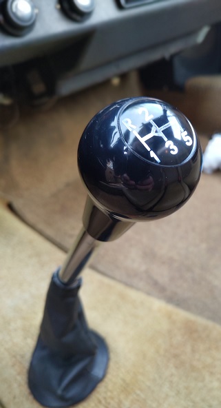

as promised an update on this small task....
old cracked one plus its pieces and the new one
New one ...Ok...so I put the crushsleeve on the stick itself and pushed down the knob over it.
But it did not seat right..... and pulling it off was still easy.
So attempt 2 was to insert the crushsleeve in the knob already and push it down on the stick.
A little wiggle/twist in the end and it is now firmly attached
another thing done. Small task but one gone from the to-do list !
Thanks for the tips and hints on this easy task.
