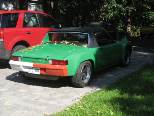

I've made a lot of progress. Most of the nagging details have been fixed, although there's still a few things left. I'm beginning to think about making an appointment for the Motor Vehicle inspection !
In any event, here's a couple of pictures:

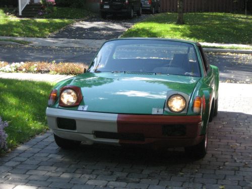

I know the colour scheme may not gather unanimous praise, but it's what I'm going with, for now. In real life, the white is not really white, but a yellowish beige, which works better with the green and orange.

It looks really nice. Hope we will see it at the Por-Volks next year.

Congratulations Michel - is it moving under it's own power?

I like the color combination. The car looks really nice. BTW where did you get your front GT bumper and GT valance? They look like they fit well. Did you have to do alot of trimming to make them fit?

Hoods, rockers, bumpers and the front valence are from Getty design. There was only minor fitting required and I found the quality to be very good.

In real life
nice!
but i see longer wheelstuds and spacers in your near future ... (IMG:style_emoticons/default/biggrin.gif)
the front looks like it could use at least 2" spacers on each side ...
(IMG:style_emoticons/default/smile.gif) Andy

I was looking at that tonight. I do have a pair of 3/4 spacers in the basement, plus 4 quarter inch ones. I'll try them on and see what happens. If it looks like I need them, I may get longer studs.

Been following your build and have enjoyed your posts. I will be useing some
of the ideas I have seen in your thread. I love the color, but forgive me I still
can't get used to the bumpers. But that my problem. She is bad, have fun.

I'm not quite used to the bumpers either ! I may yet change the color of the bige to black.
