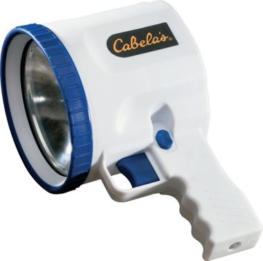

Cut off the handle and JB Weld. 1,000,000 candlepower gets the job done

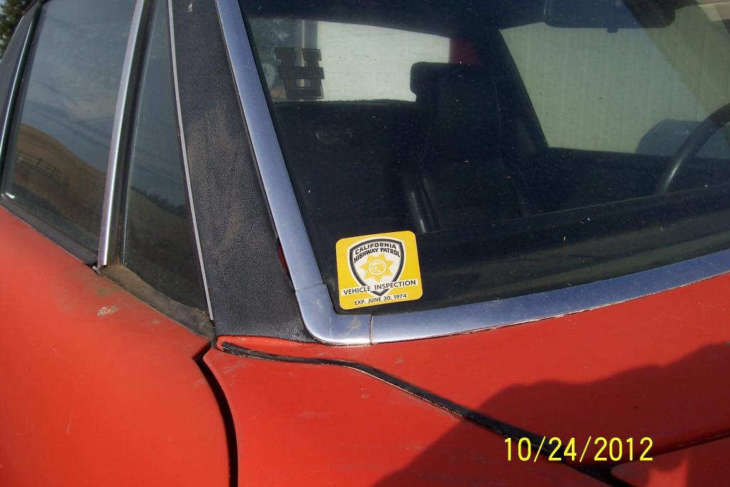

DOT or NOT, I think you'll be fine, since CA doesn't have vehicle inspections anymore.
Coincidentally, I recently saw a pic of a CHP vehicle inspection sticker on 914Eric's car. How many of you CA guys remember these (IMG:style_emoticons/default/confused24.gif)

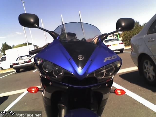

These are the lights I was thinking about stuffing into the turn signal buckets. They're from a 2003~2005 Yamaha R6.
I 'd rearrange them to mount vertically rather than horizontally

Member No.: 11,125
I bet those motorcycle lights are too big.
euro911
post Dec 3 2012, 05:50 PM
Post #58
Posts: 8,937
Joined: 2-December 06
From: So.Cal. & No.AZ (USA)
Member No.: 7,300
I didn't have a set to measure, but they looked close. I'm sure they'd need to be trimmed down on the sides to fit the buckets (IMG:style_emoticons/default/sawzall-smiley.gif)

QUOTE(euro911 @ Dec 1 2012, 12:08 PM) *
The only other suggestion I could make, would be to mask off and paint the back side of the lenses to cover the areas that expose the bucket, only allowing the bulbs to be visible (IMG:style_emoticons/default/idea.gif)
That's an emissions inspection label, IIRC. I used to issue them.

euro911
post Dec 3 2012, 06:18 PM
Post #60
Posts: 8,937
Member No.: 7,300
I remember the CHP performing roadside inspections, where they'd check vehicles' lights, horn, muffler (excessive noise), ride height, etc.
