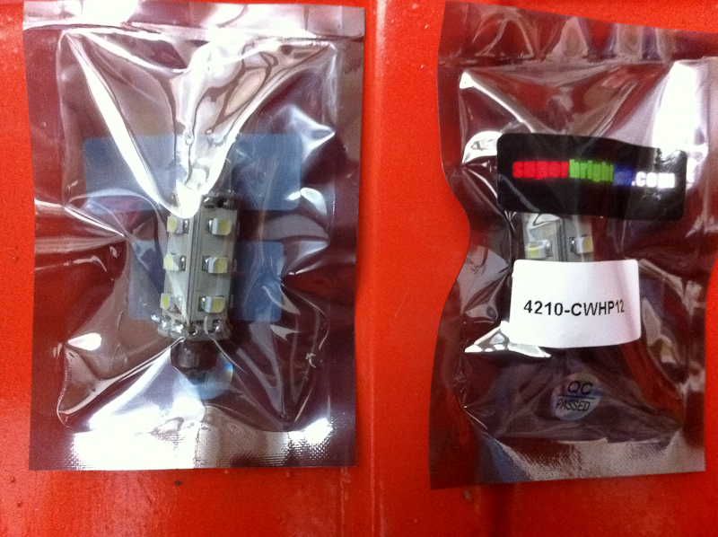

I got the LED bulbs today, from superbrightleds.com They are festoon-type 12-LED 42mm. I haven't tested them yet but suspect they should work nicely. I'll try to make progress on the installation tomorrow.

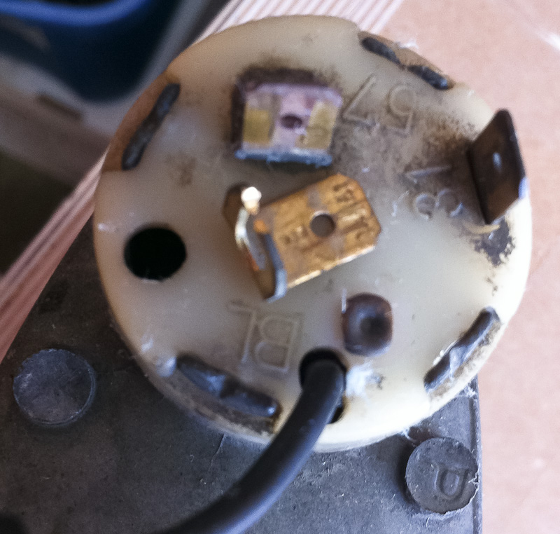

I found the culprit(s) preventing the running lights from working. One of the connector tabs on the front left assembly had broken-off. Just one of those old car things, probably exacerbated by the stiff suspension and track driving.

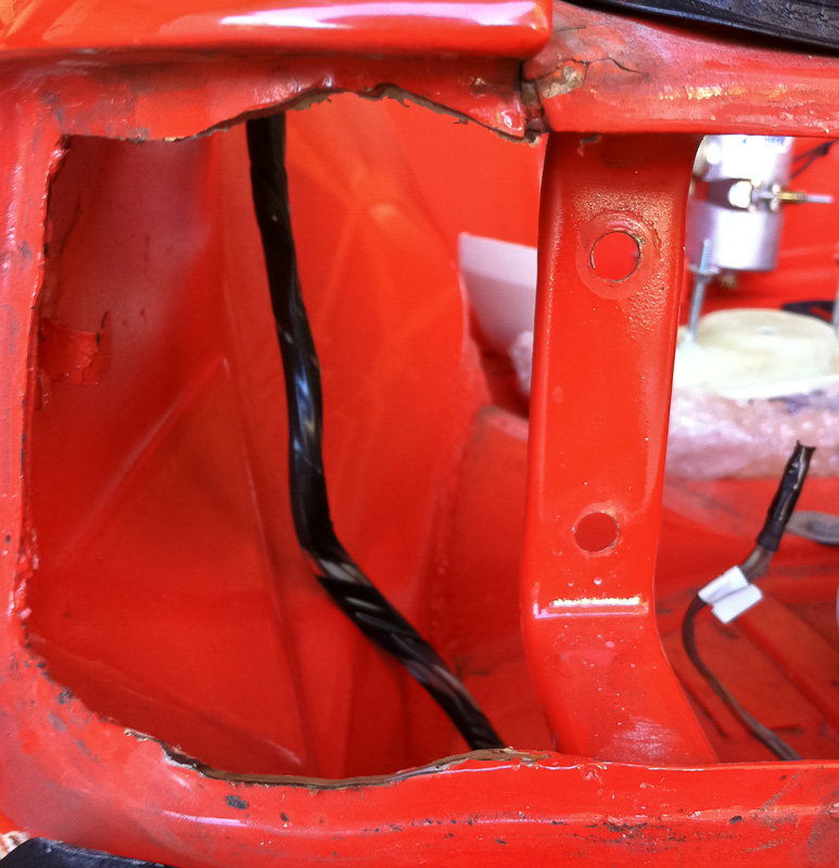

I finished-up the wiring harness prep so it was time to move to the fiberglass housings. They need a little bit of clearance for the outer bulb recess. I suppose you could cut/grind off some of the fiberglass but it is not very thick so I chose to clearance the body sheet metal instead. Air tools make this quick work. Cosmetics not important since the lamp housing covers it up.

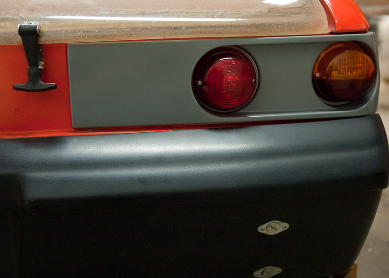

Test fit of the housings before paint. They are now primed and have an initial coat of medium/smoke grey paint so we'll see how that looks tomorrow.
I also have to decide whether to use seals or omit them. This car is not water or windproof in any regard anyway.

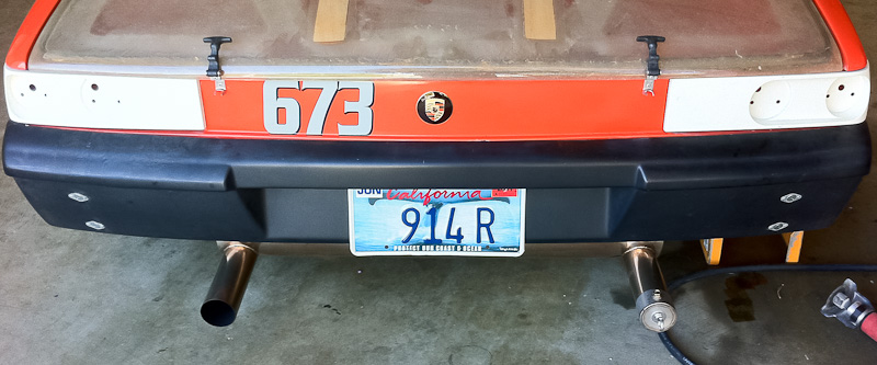

Is that a fiberglass rear bumper??

QUOTE(NC_Colfax @ Sep 12 2010, 03:40 PM) *
Yep, and it has some quickie repair work due to a trailer unloading incident. I have a new one but I'm not terribly happy with it and will probably just fix this one a little better at some point.

Anyways, work keeps getting in the way of progress but I finished a reasonable 10-foot rattle can paint job, assembly and installation of one side. I think the grey will look decent and will post a full-car pic soon. Worst case, the way I wired them up, the stock assemblies can be easily swapped back in place in a few minutes.
I will try to do an A/B test of the LED brake light vs. incandescent too -- the LED 'looks' very bright but it's hard to tell unless they're both lit up side-by-side.
