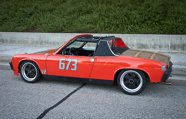

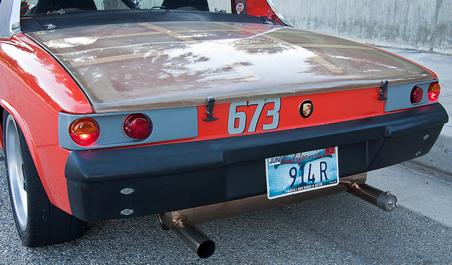

I finally finished this little project today. The wiring, prep & paint, and assembly definitely took a bit more time than I anticipated. Part of it was because I had to chase down some existing electrical gremlins in the front light circuit, and I was fairly anal about the new wiring so I labeled everything and used covered crimp connectors with heat-shrink tubing and so forth.
The fiberglass pieces are a bit rough in terms of fit and finish, I must say, as with many other aftermarket body parts for our cars. They could stand to be be shaped and realigned a bit whenever my car goes in for body and paint work, but I think they're fine for a race car.

One off-topic question though:
What's with the capped exhaust pipe? Does it make a difference in sound for street driving? Just wondering as I'm about to start a 2.7 conversion myself and I'll be looking at exhausts at some point.

QUOTE(JmuRiz @ Sep 20 2010, 01:41 PM) *
Yep, it quiets down the exhaust noticeably. This is an "R" type M&K muffler which is very free-flowing and loud, borderline un-streetable when uncapped. (Especially since the County Sheriff station is right around the corner.) The cap came from Ben McFarland, the builder/owner at M&K, although I attached it differently because the clip/clamp he supplied only stayed on for a few minutes.
