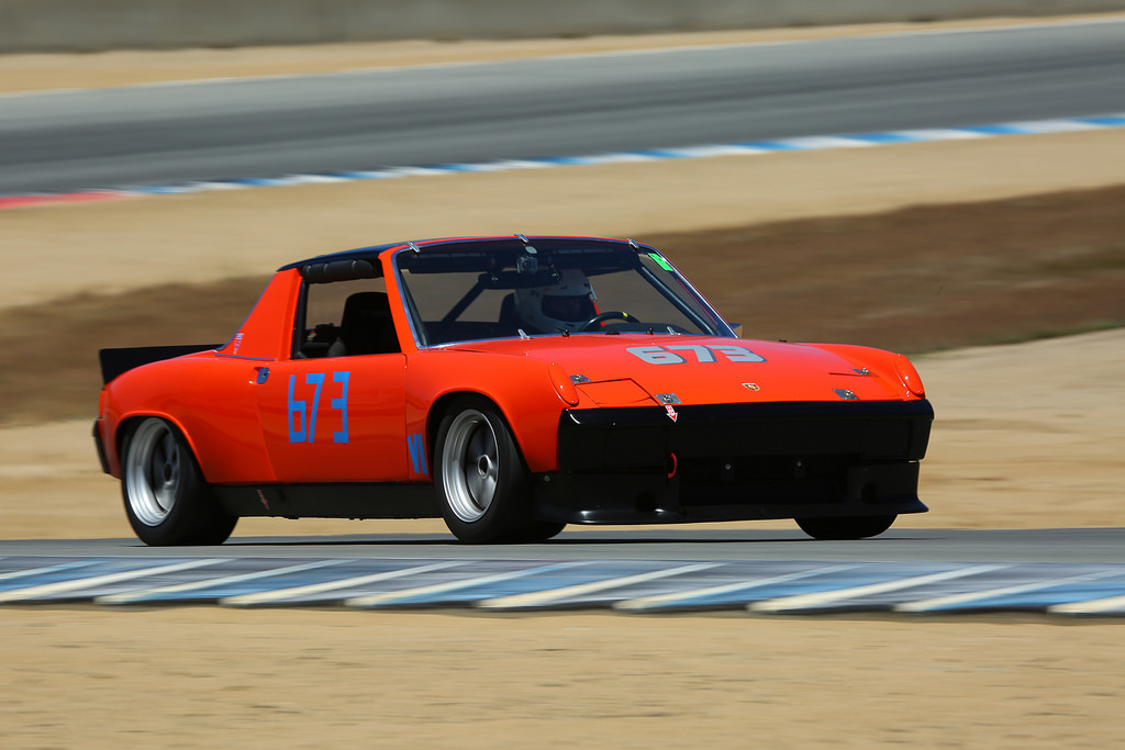

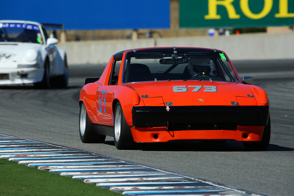

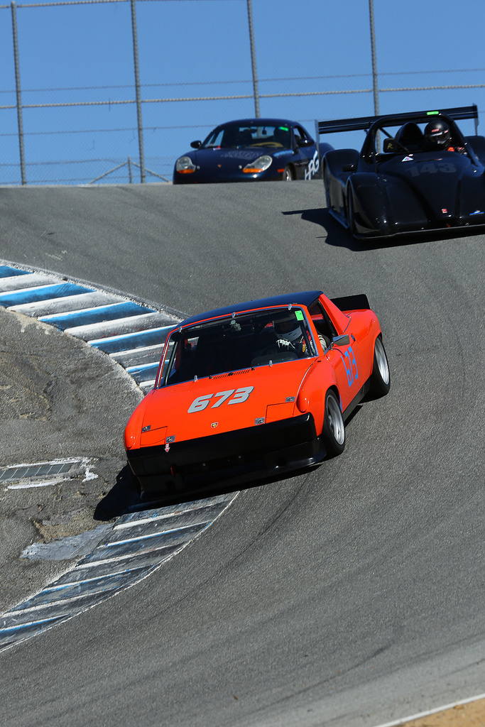

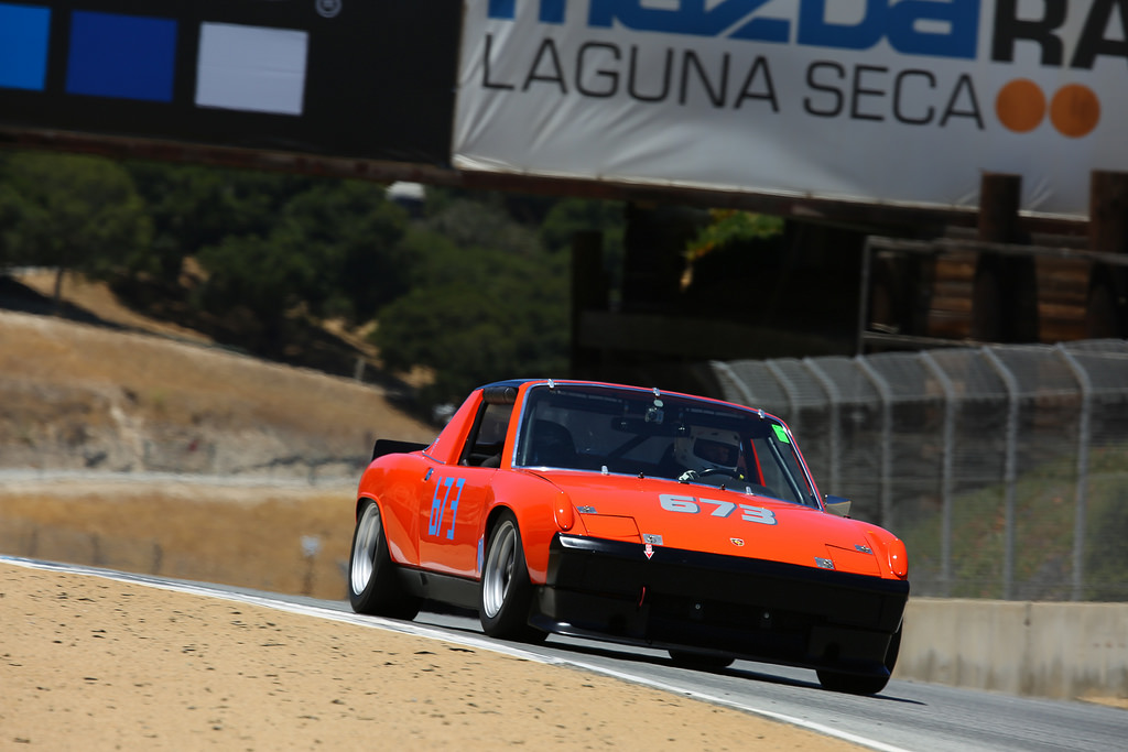

Hi All,
Well, 914R has made another big step towards being "done". Marco Gerace at TLG got my Webers really dialed-in nicely as well as doing a full service and coordinating a windshield replacement. John Esposito then repaired/reworked my front Tangerine flares for clearance and blended the paint masterfully. John also fixed other minor damage and installed the Sheridan rear spoiler I've had for a while. Both shops are top notch and I highly recommend them.
I headed straight to Laguna Seca (literally) after the work was finished. The only bummer is I didn't have time to order and reapply real numbers on the doors -- paint was blended-in -- so I had to use cheesy masking tape. This was also my first time on the new set of Braid 15x8&9 RSR finish Faches and Hoosier R80 radial slicks.
WOW - the car is stellar. (IMG:style_emoticons/default/smilie_pokal.gif) The grip is shocking and the engine pulls very strong. I've never driven Laguna before but quickly settled to 1:50's and Sunday I got into 1:47 if not 1:46 territory. Unfortunately my data acq system is malfunctioning but official transponder times should be on MyLaps shortly.
My big lesson-learned was re. brake cooling. Laguna is HARD on brakes. Mid-weekend I switched from Pagid Black to Orange front pads to try to alleviate serious fade after ~20 minutes on track but that did not help much. I then realized the deep Sheridan front spoiler was blocking airflow and I have not yet hooked-up the ducting. So, Sunday I switched to a less deep spoiler and the problem vanished (but I went slower.)
Here are a few shots. I'll post video this weekend!

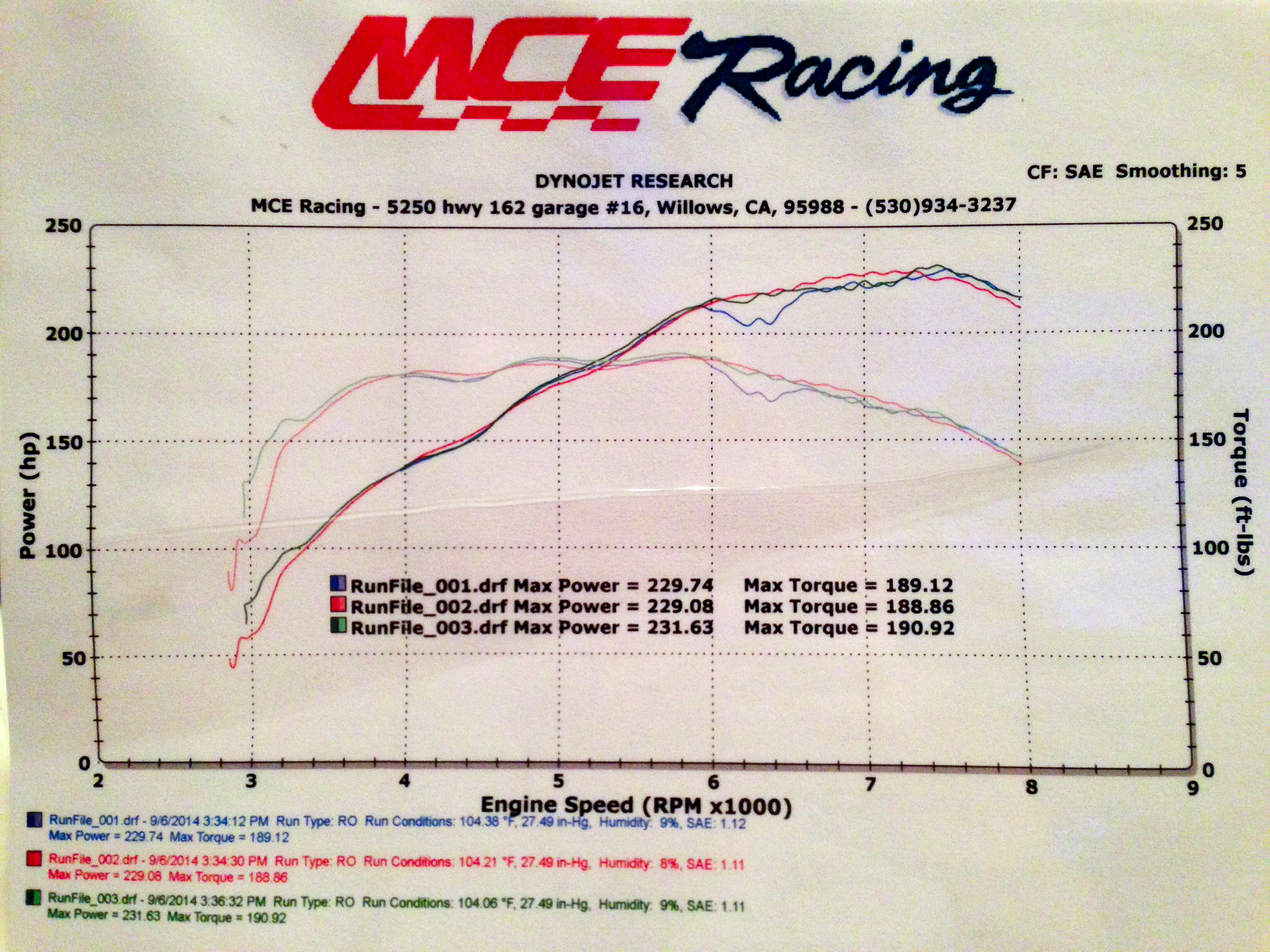

Well, 914R and I had a pretty good day at Willow Springs today. It was HOT and my times were 2-4 secs off where I want/need to be. (Tomorrow = better tires, a little cooler and less braking!)
I had a fairly spectacular spin and off in the 5-6 section which I might have caught on video. No damage or injury other than minor cracking in the front spoiler, which can be fixed easily (fiberglass). I got the classic faceful of desert sand and dust. (IMG:style_emoticons/default/sad.gif)
Also I took the opportunity to do some dyno pulls in case I pull the trigger on moving to a GT class. The engine is supposed to make high 200's at the crank so the wheel hp is not a surprise. You can see from the jiggly lines that there is some Weber funkiness going on above 6K RPM which we'll try to tune out at some point.
Note the temperature -- 104F
