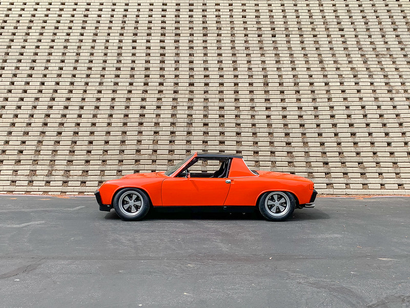

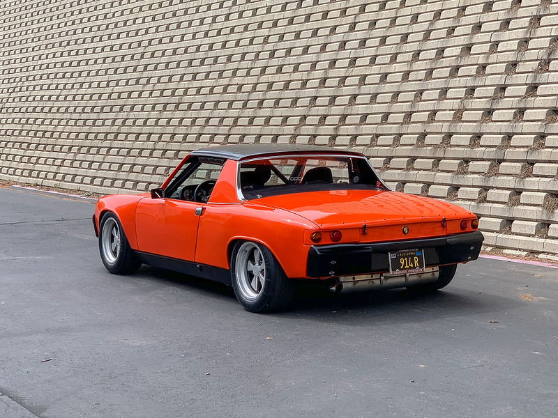

Some of you may have seen my earlier build thread on the 914club site. In a nutshell I have a 73 2.0 that I converted to a six in 2003. It's now heavily modified and race-prepped, powered by a stout 2.7 twin-plug engine.
The car currently weighs 1988lbs without fuel or driver; my POC minimum class weight with gas and driver is 2209lbs. It's still narrow-bodied and I am running 16x7 Fuchs with 205/45 Hoosiers. As you might guess, the car is significantly grip-limited and traction-limited in the rear especially. It basically tears the tread off R6's within 6 run sessions or so.
Here is its current state:
(IMG:http://www.914world.com/bbs2/uploads_offsite/farm6.static.flickr.com-21-1309645382.1.jpg)
914R at Streets of Willow by cjcam, on Flickr
(IMG:http://www.914world.com/bbs2/uploads_offsite/farm6.static.flickr.com-21-1309645383.2.jpg)
914R at Willow Springs by cjcam, on Flickr
