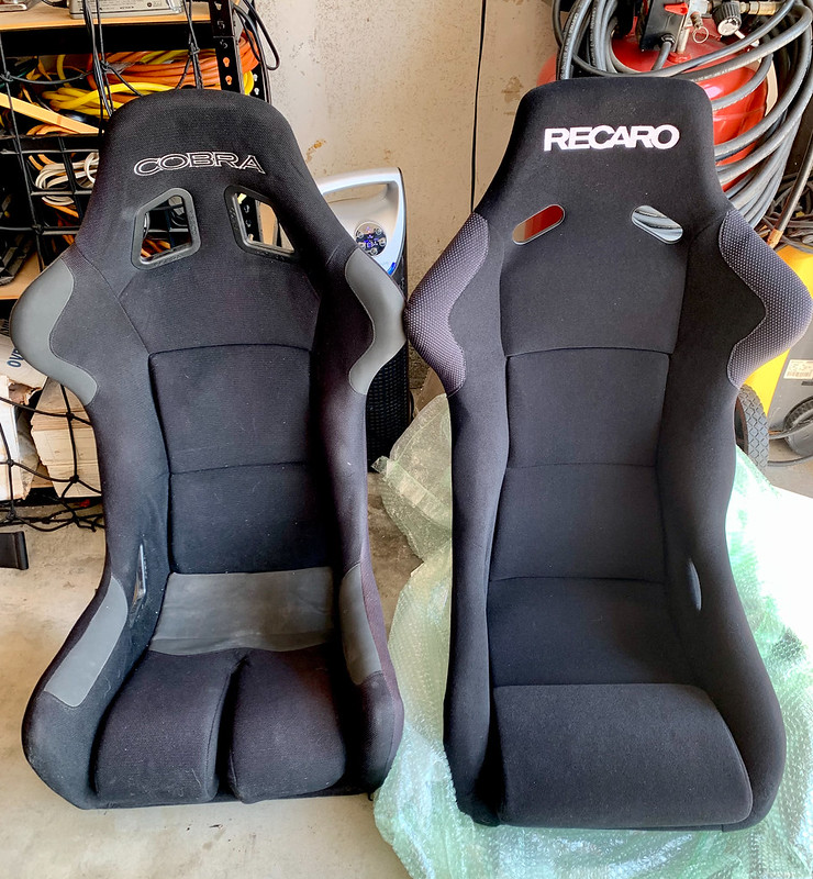

Here are the seats, old (Cobra Suzuka) and new (Recaro Profi SPG). I was hoping to find Recaros that were extremely close to the size/shape of my old Cobra Suzukas and these seem to be. These are the standard narrow versions which gives me added motivation to stay in shape lol. (Plus lucky for me the large version model just got recalled.) Worst case I believe the Suzukas and other options are still available if these don't work out well.
(IMG:http://www.914world.com/bbs2/uploads_offsite/live.staticflickr.com-21-1657815967.2.jpg)

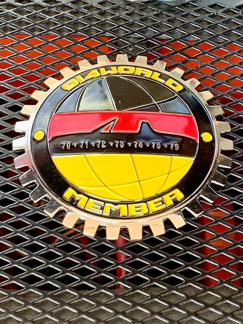

Yesterday I finally installed this crest from our friends at 914rubber, and now I'm making good progress on the new Recaro seat and Schroth harness installs.

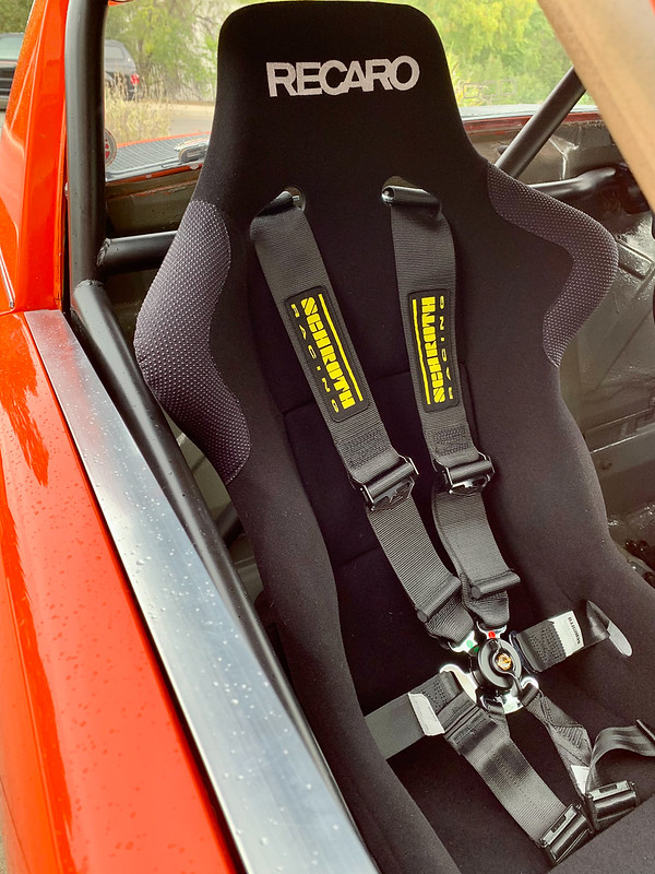

I'm so lame at keeping this thread updated. Anyway, the car has now survived about 5 local test drives so that's great news. It's only gone a few hundred miles total in the last few years... (IMG:style_emoticons/default/unsure.gif)
The new seats and harnesses are in and working well.

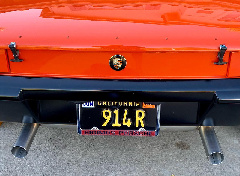

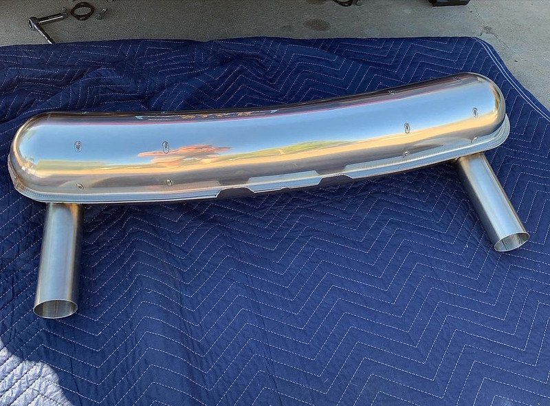

Last weekend's project was installing this gorgeous 2-in/2-out RSR style Dansk from PMS:
(IMG:http://www.914world.com/bbs2/uploads_offsite/live.staticflickr.com-21-1664410029.2.jpg)
which sounds similar to my old 70mm 'sport' 1-out Dansk, which is a good thing, but a little 'throatier'. I'm sure it's a bit louder from the outside but from inside the car it sounds nearly identical to me. The carbs and fan still really drown out all else from inside the car.
(IMG:http://www.914world.com/bbs2/uploads_offsite/live.staticflickr.com-21-1664410029.3.jpg)
