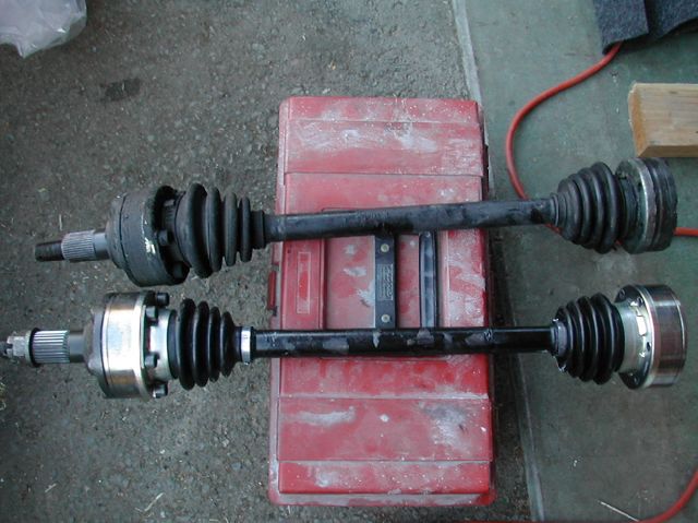

Without worring about axles or attaching to the transmission, the question is;
If I install 71 911 hubs and stub axles on my 914, can I bolt the 944 CV unit to the stub axle?
Wes

SirAndy   The hubs will work. The stub axles will not. You...   Feb 5 2008, 12:09 PM
Wes V   I get the impression that to be able to bolt the 9...   Feb 5 2008, 12:23 PM
SirAndy   My question on "model specific" has to ...   Feb 5 2008, 12:33 PM
Wes V   Thanks to all, but one last (dumb ass) question; ...   Feb 5 2008, 02:05 PM
ClayPerrine   The hubs will work. The stub axles will not. Yo...   Feb 5 2008, 02:42 PM
SirAndy   The stub axles he has won't work with 944 cv ...   Feb 5 2008, 04:01 PM

Wes V   SirAndy; Can you please confirm that what you are...   Feb 5 2008, 11:42 AM
SirAndy   Am I correct that you are using the modified 914/...   Feb 5 2008, 12:16 PM
John   I ran into a similar situation with early 911 stub...   Feb 5 2008, 12:22 PM
Cap'n Krusty   No. It's the OD of the CV joint. The Cap...   Feb 5 2008, 02:41 PM
ClayPerrine   I use late model 911 hubs and 944 stub axles. Both...   Feb 5 2008, 02:43 PM
John   I use late model 911 hubs and 944 stub axles. Bot...   Feb 5 2008, 04:32 PM
