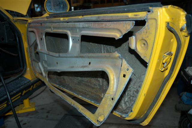

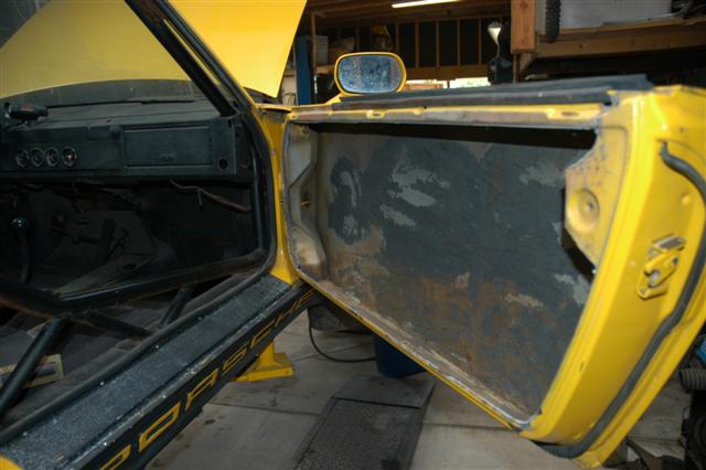

From Joe's Build Thread:
Weihged the doors 75 uncut door skin 41 lbs
and a 75 cut to the bare minimum 27 lbs.
(IMG:http://i140.photobucket.com/albums/r38/Joe_Sharp/Picture009.jpg)
I see some seriously heavy ass-dragger power mirrors on those doors... (IMG:style_emoticons/default/biggrin.gif)
pete
Heeltoe914
post Apr 16 2008, 12:01 PM
Post #23
Posts: 1,135
Joined: 31-January 06
From: Tujunga Calif,
Member No.: 5,506
I think the numbers for the doors may be a little off. If you remove the tar as well and the hardware it should come out at about 10-13 pds from what I have gotten.
Joe can you tell me how you cut that heavy bar out? Was it only attached at both end or spot welded along the sides.
