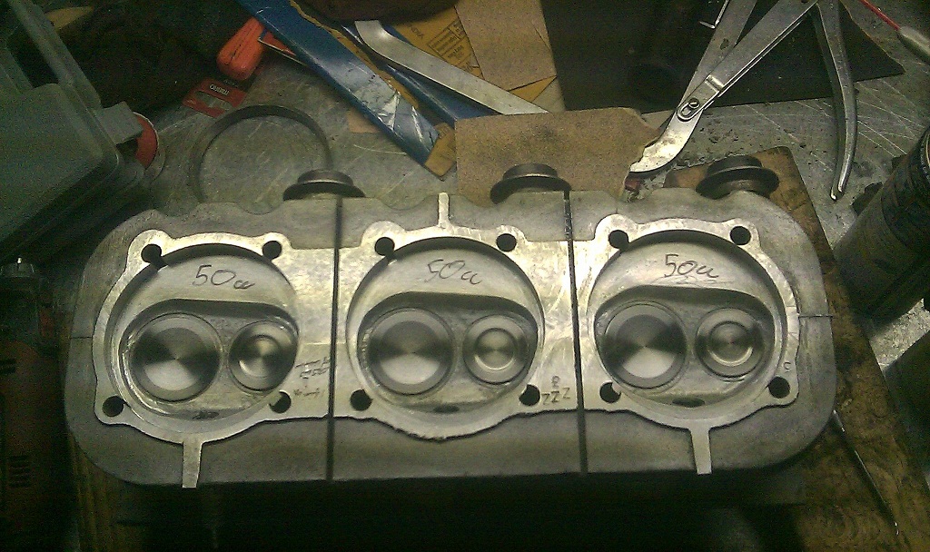

Had a good day working on stuff. I got one head basically done. I managed to get them flycut so that there is no step for the sealing surface. This helped bump up the CR closer to what I was looking for. I then removed material from around the valves (unshrouding). This will allow the heads to breath better: bigger valves, bigger ports, and unshrouding (IMG:style_emoticons/default/smile.gif)
I also changed over to stainless valves since I could get the easier than the stockers and they are not expensive.
I polished the chambers up a bit, but I can see that shining them is not gonna happen as it is way too much work and not really necessary for my application.
I CCed the head and all chambers are at 50cc which is perfect. I have calculated what needs to be removed from the cylinders and can now tell the shop next week to get things moving further along (IMG:style_emoticons/default/smile.gif)
Before:

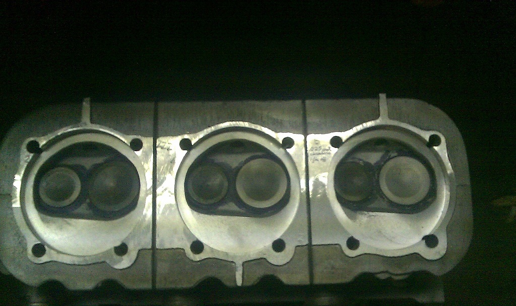

All I have is a cell phone, the wife took the camera to England with her.
After:

Are there going to be any problems with the holes for the head studs open into the ... not combustion chamber 'cause the cylinders will seal against the head ... where the circumference of the opening for the cylinder intersects the hole for the head stud (best I can describe it w/decaf). But then again, the hole for the stud will also be sealed at the case and by the washer and nut at the head end.
hot_shoe914
post Jul 24 2011, 08:19 AM
Post #1079
on ramp passer
Posts: 3,807
Joined: 20-November 07
From: Earle, Ar.
Member No.: 8,354
http://littlerock.craigslist.org/cto/2501895129.html
Dr Evil
post Jul 24 2011, 10:58 AM
Post #1080
Send me your transmission!
Posts: 23,041
Joined: 21-November 03
From: Loveland, OH 45140
Member No.: 1,372
QUOTE(type47 @ Jul 24 2011, 08:17 AM) *
No. I already ran heads like this, with the holes you mention, and it is a proven design. The cylinders seal against the surface, not the sides.
