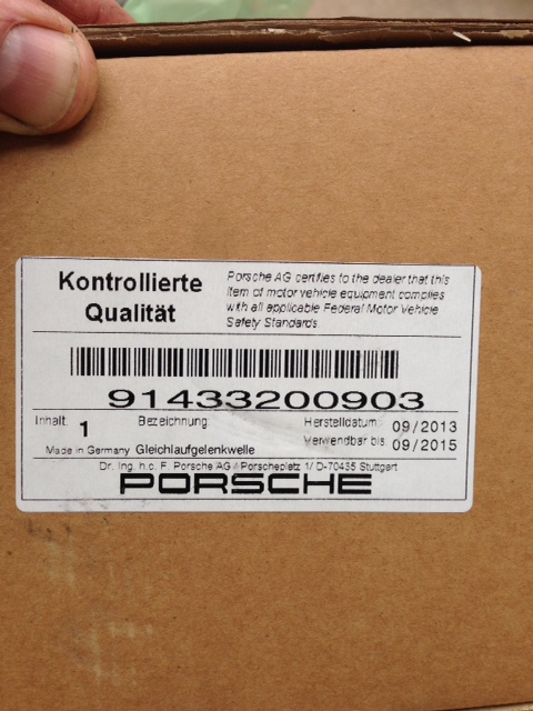

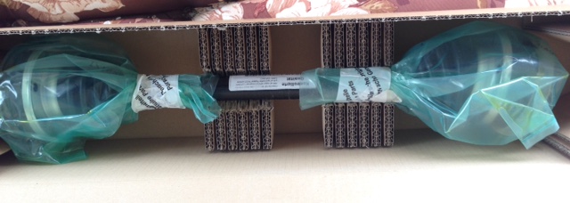

Amphicar770   New axles came in. Looks like they are indeed mad...   Jan 9 2016, 01:29 PM
Kansas 914   New axles came in. Looks like they are indeed ma...   Jan 9 2016, 02:46 PM
