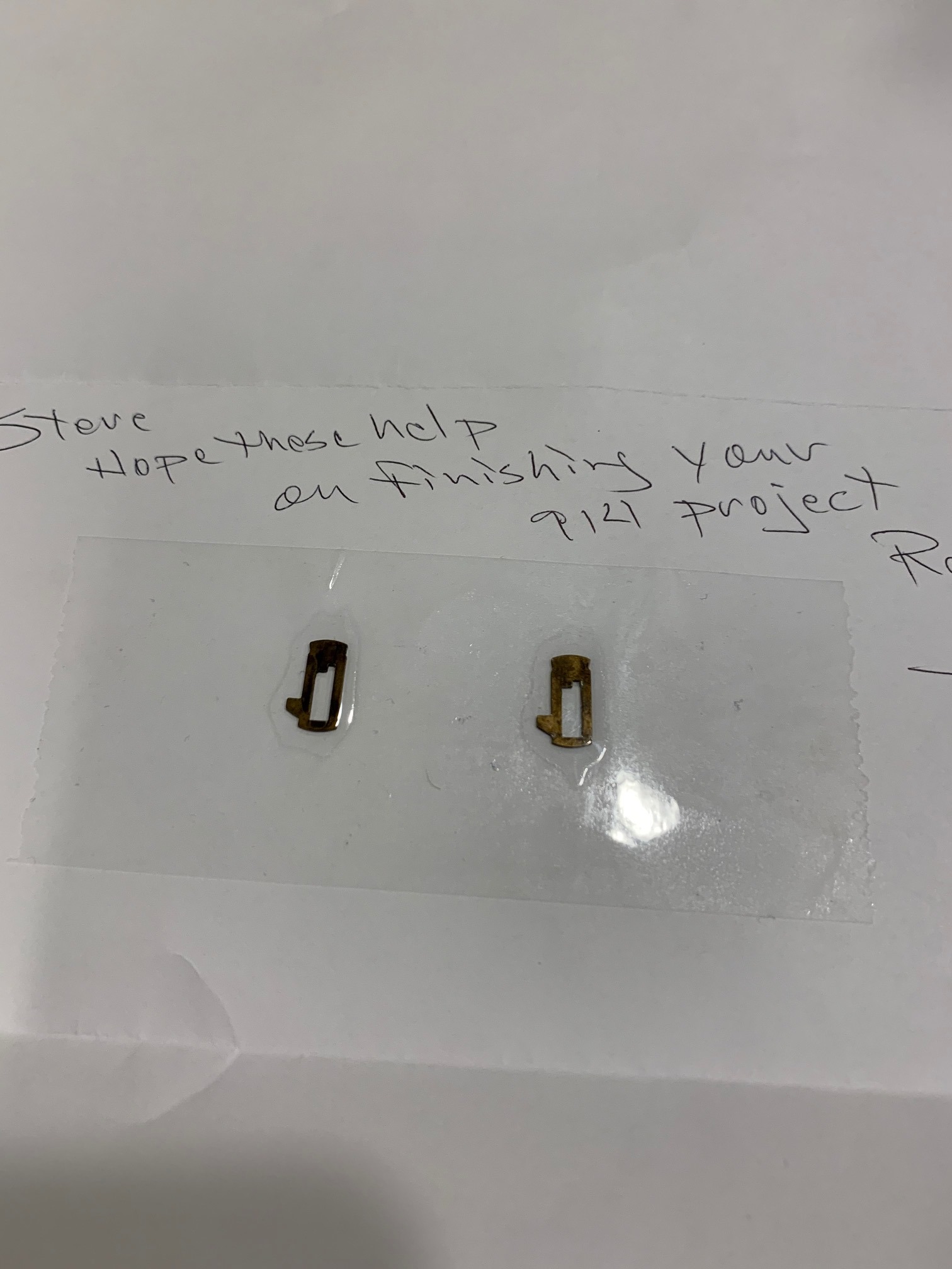

QUOTE(johnhora @ Jan 7 2020, 12:57 PM) *
Steve...PM me your mailing address and I'll send you a couple...John

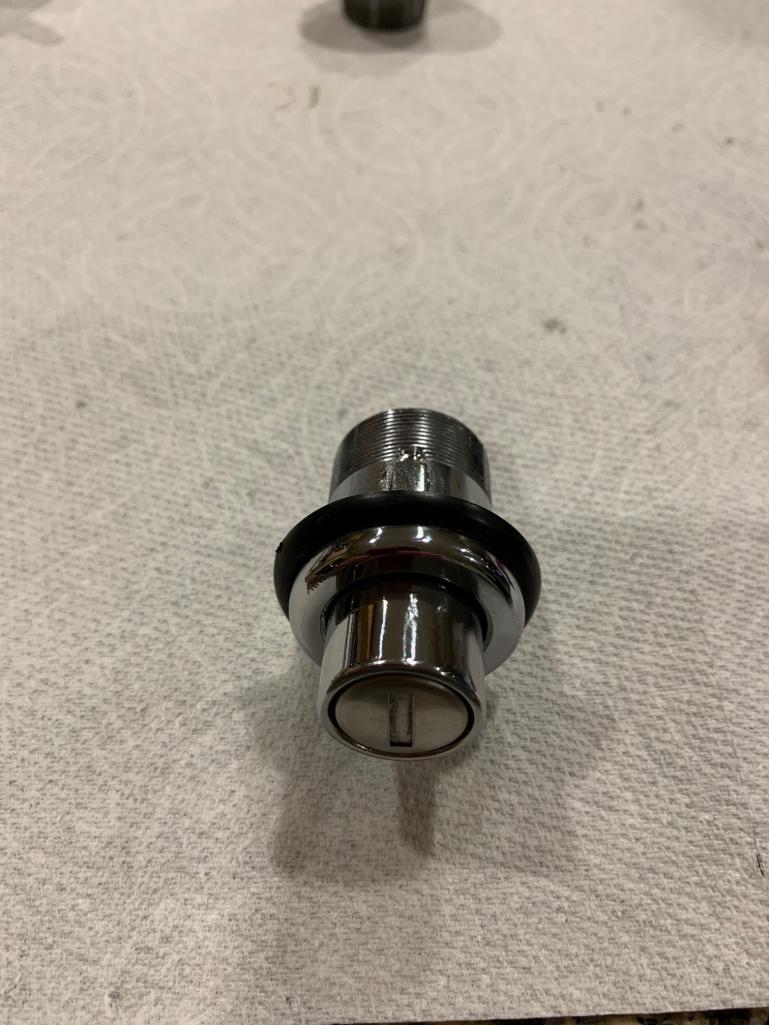

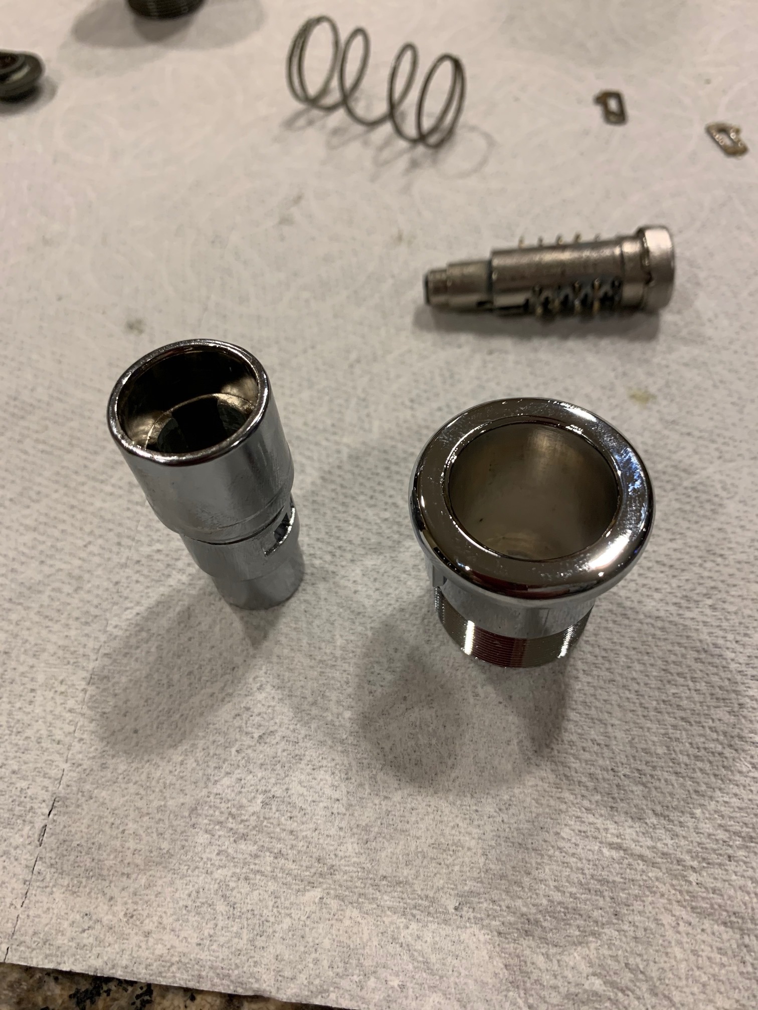

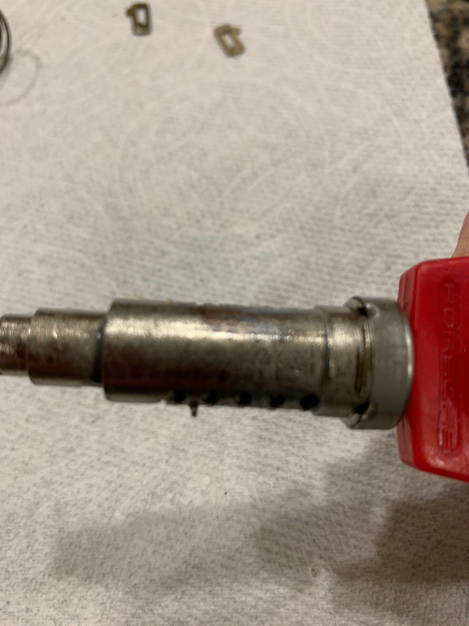

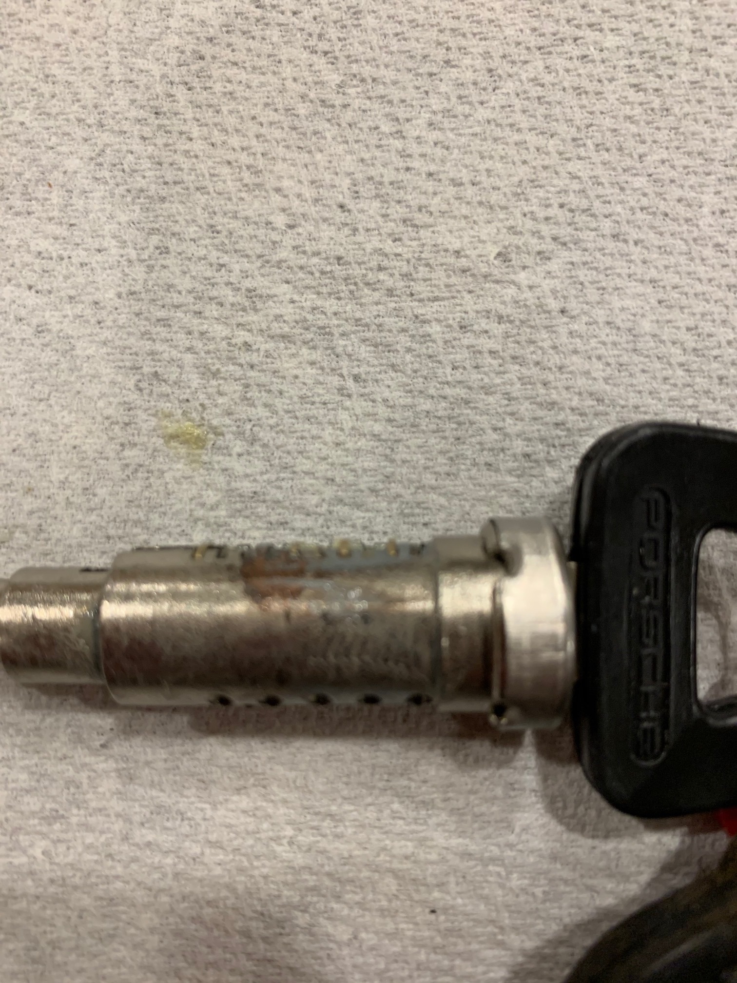

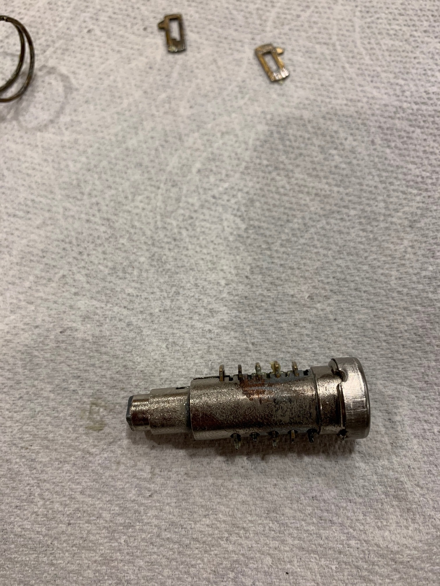

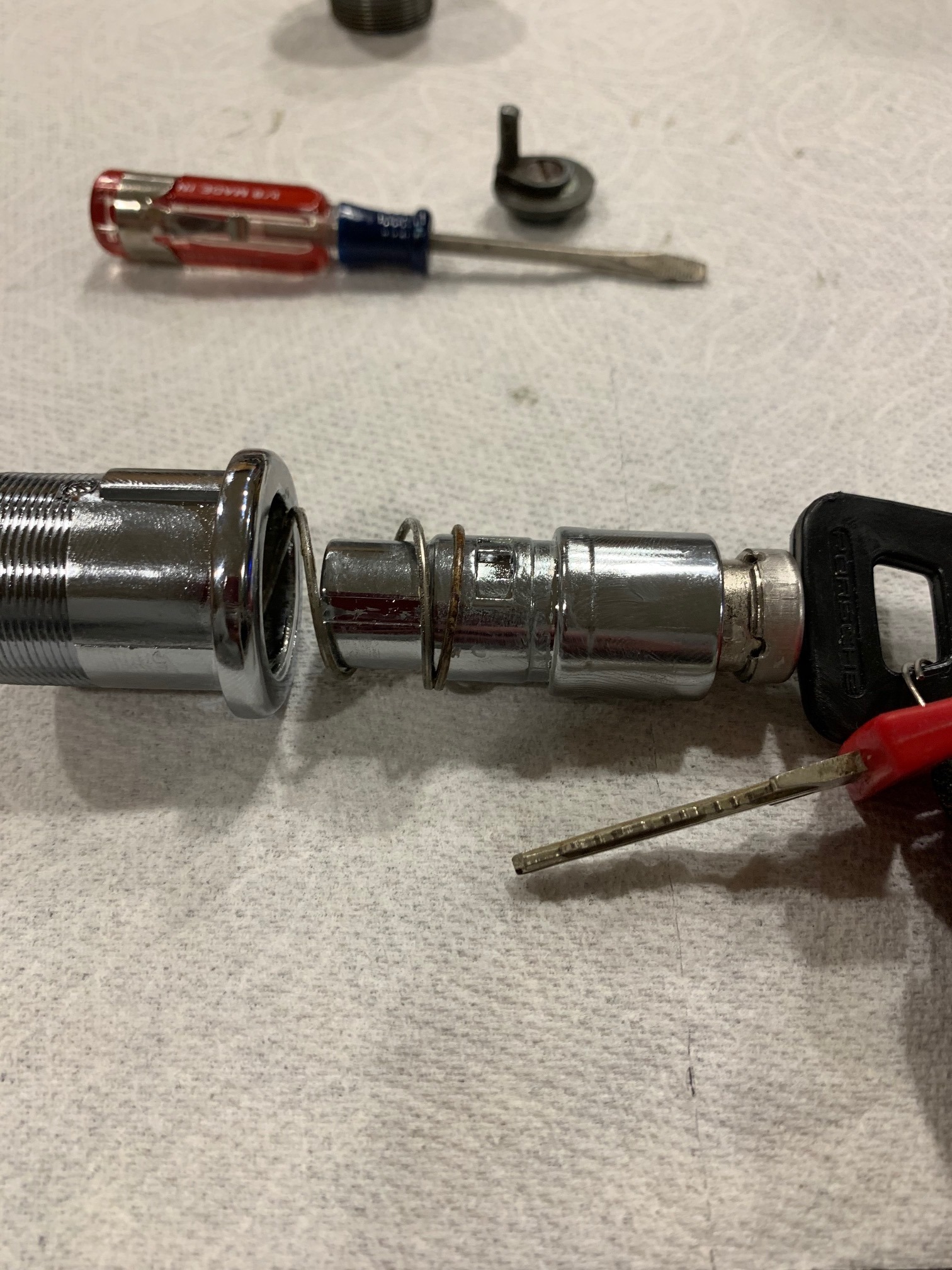

Just a follow up to my trunk lock. A big THANK YOU to John for sending a couple of these "lock wafers"
I had a master key cut tracing the valet key at a local hardware store so once I had the wafers , it was time re-key the lock.
The end result is i now have a correctly functioning master key and valet key
You can visible see the step
Wafers releasing
I had to try a few different slots, once I got the right one the Master key grabs all of the wafers...nice and flush
Valet Key inserted and you can see how it does not grab the "valet wafer"

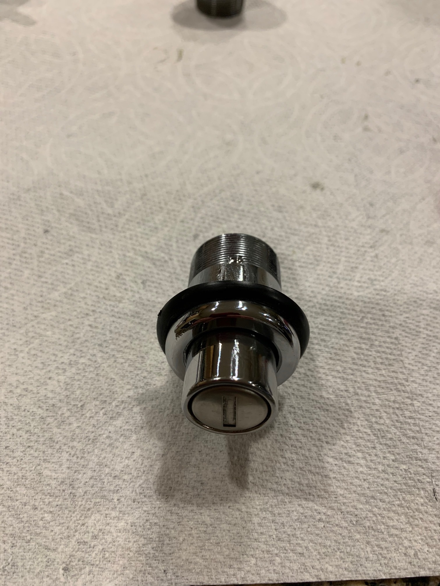

I decided to use the URO rear lock as my Ebay replacement was pretty beat up
This is a very nice and reproduction
Lastly, was reassembly and reinstall into the car

Can the valet wafer go in any slot?
stevie 77 930
post Jan 15 2020, 11:47 AM
Post #26
Posts: 3
Joined: 1-April 15
From: Chatsworth, CA
Member No.: 18,583
QUOTE(PCH @ Jan 15 2020, 09:38 AM) *
"I had to try a few different slots, once I got the right one the Master key grabs all of the wafers...nice and flush"
