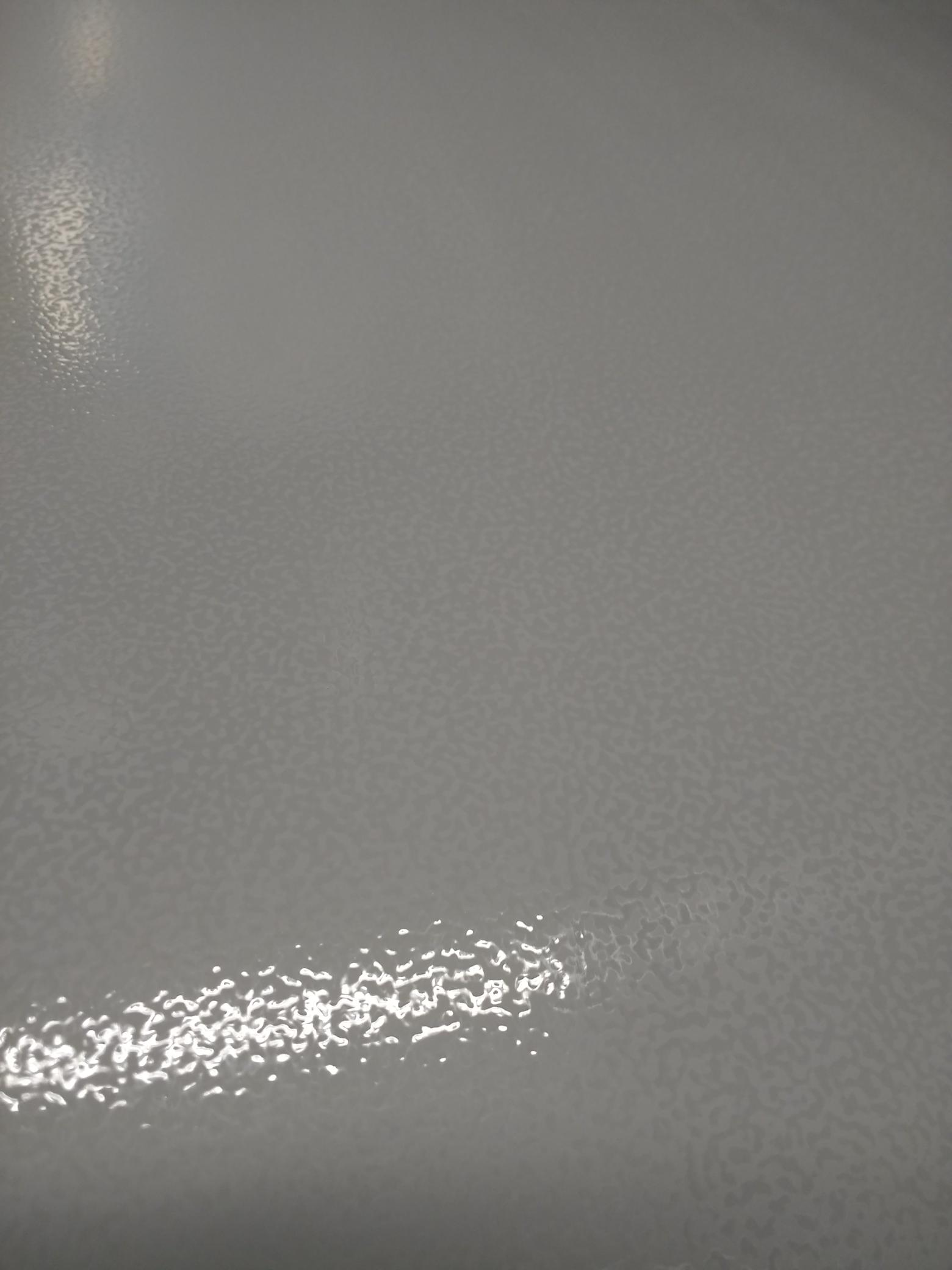

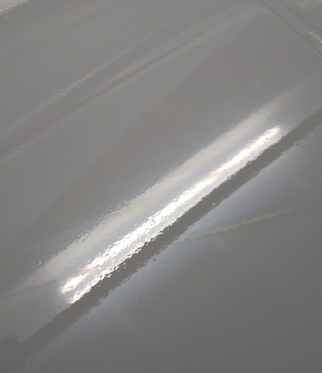

So I painted my car. Got some orange peel, thought I'd see if anyone had ideas for getting rid of/minimizing it.
After painting:
After sanding with 1000 grit. The lighter areas are where I sanded, the darker areas are the lower points of the orange peel:
Option 1:
I'm thinking I need to go to 800 grit, then 1000, 1500, 2000, then polish. Before I do I thought I'd see if anyone else thinks this is a good idea based on what they may have done.
Option 2:
I can re-paint it. I'm thinking I will sand with 400 grit to rough up the surface and then re-spray.
Option 3:
I can polish it more, but the orange peel is still noticeable on the smaller pieces I've tried. I used a Torq X polisher, white pad, Chemical Guys V32 polish. I thought it might get smoother as I polished it with finer and finer pads/compounds, but I don't want to burn thru the paint. I put 3 coats of paint on.

Oh dear,let it dry and start again,your paint is too thick ...not enough reducer ,or you are possibly running low air pressure,with single pack I run 35-40 PSI,on the top clearcoat I run same pressure and a bit more thinners,from mermory I go 1:2 ratio basecoat then 1:5 ratio on clear ,then I go piss thin on the last clearcoat.

That's a bit of orange peel for sure. I would tape all the edges on one panel (don't want to sand or burn through) and wet sand it some more to see if you can get 90% of that flattened out and then try polishing. Just take your time. Good luck. (IMG:style_emoticons/default/beerchug.gif)

You are going to need to go through the grits by starting with a heavier grit. Very easy so you do not go through it. Think of it as mountains and valleys. You need to sand the mountains down to the valleys. Tape the edges as someone said so you do not go to fare on them with the color sanding.
You need to CK it all the time so you do not remove too much.
Do not sand with that much pressure. You will get it. The worst you can do is need to repaint so give it a shot. It takes an eye. When it is flat all over go to finer grit. Remember when you have it flat all you need to do is remove the last scratch and put the finer scratch in. I go in a different direction and when the scratches are going in the new direction go finer till you are sure you are at a fine scratch where you can buff from.

Single stage? What paint are you using?
Go 30% more reducer than you were using. Change your air pressure at gun regulator to 30psi, Adjust your spray to 6-8" of surface.
Spray test piece with another 3 coats after 400grit wetsand and clean up with wax/grease remover.
Show us what you've got. Be careful with runs.
If you plan to wetsand always do 4+ coats. or 2+ coats after full coverage. I did 7 on mine. it took 3 to get full coverage. I wet sanded out 1-2 coats and have 5 coats on the car and can wetsand the car again 2 times to eliminate imperfections down the line.

What temp reducer are you using? and how hot was it in the booth at spray? Its really hot out and normal reducer is designed to be sprayed at about 70deg.

I would wet sand again.. Then see what you have left to buff. Anyone that's painted before has run into this before at least once.

definitely need to wet sand with finer and finer grits; don't wet sand with anything finer than 1000 unless you want to just paint the panel again. or be sanding from now until 2020. Trust me, it takes a lot of sanding to get the panel flawless;
no reason to use polish until you've got to at least 1500 if not 2000 grit.
change the sandpaper frequently; it gets loaded quickly

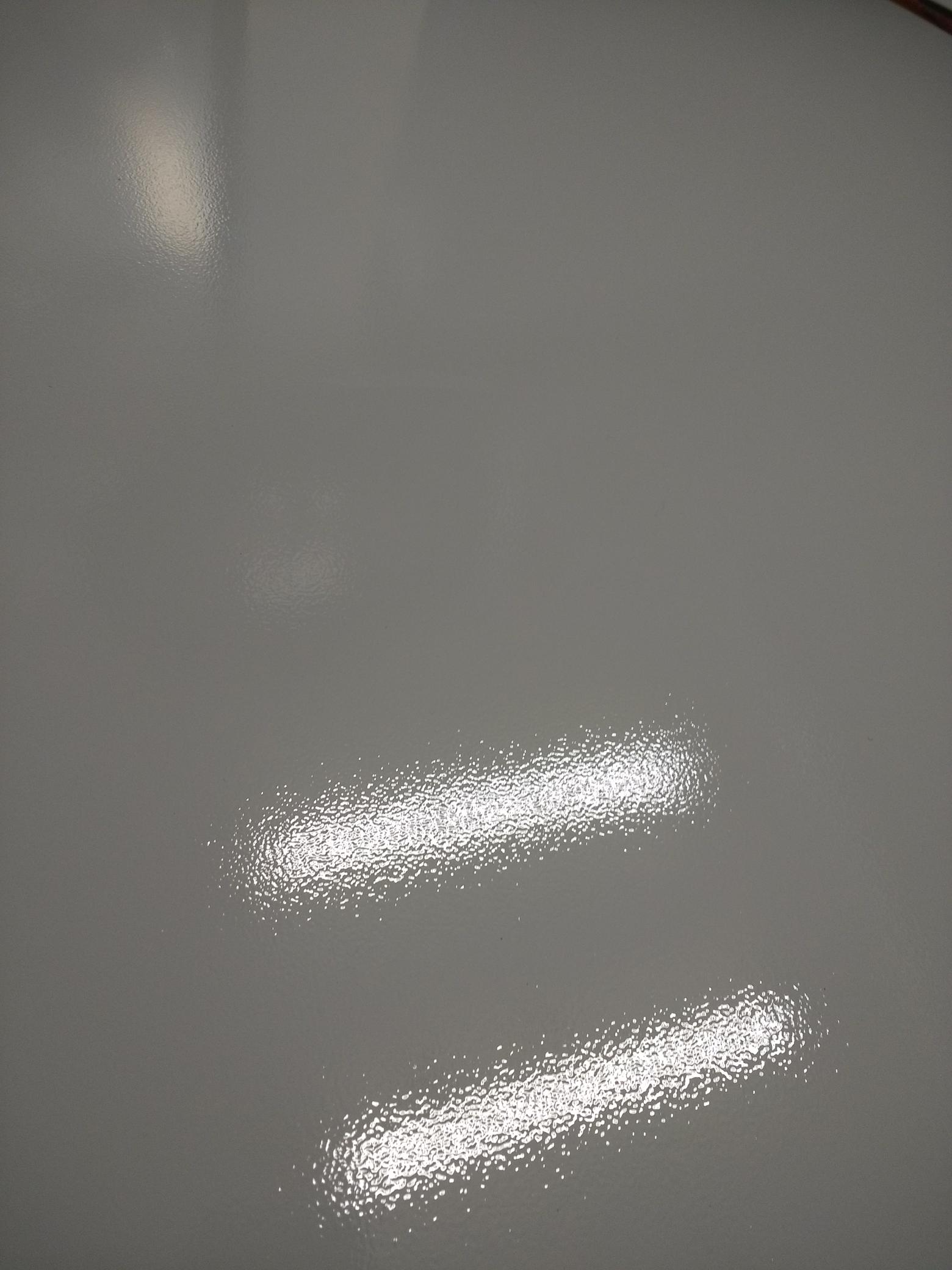

Here is the result after wet-sanding with 800-1000-1500 then polishing with V32 and then V36 polish (Chemical Guys).
They are still some depressions from the orange peel that look like dots and there are some scratches. I thought I got these out; they appeared after I polished.
I'm thinking I need to paint one, maybe two, more coats so I have enough material to sand off.
Should I use a machine sander (DA), or keep doing it by hand?

I would wet sand with 400, clean, prime and repaint.

(IMG:style_emoticons/default/agree.gif) that’s what our shop would do. You don’t want to machine sand unless you really know what you are doing.

Yeah Jeff...I kinda think you need more paint also.
Using a DA for prep is fine but I wouldn't recommend for color sanding.

Hand sand only. No DA sanding for color sanding.

Also, use a guide coat to show missed sanding scratches and low spots. A dry guide coat applies evenly and will show you when you have sanded it enough. There is a white guide coat available for darker paints and primers.

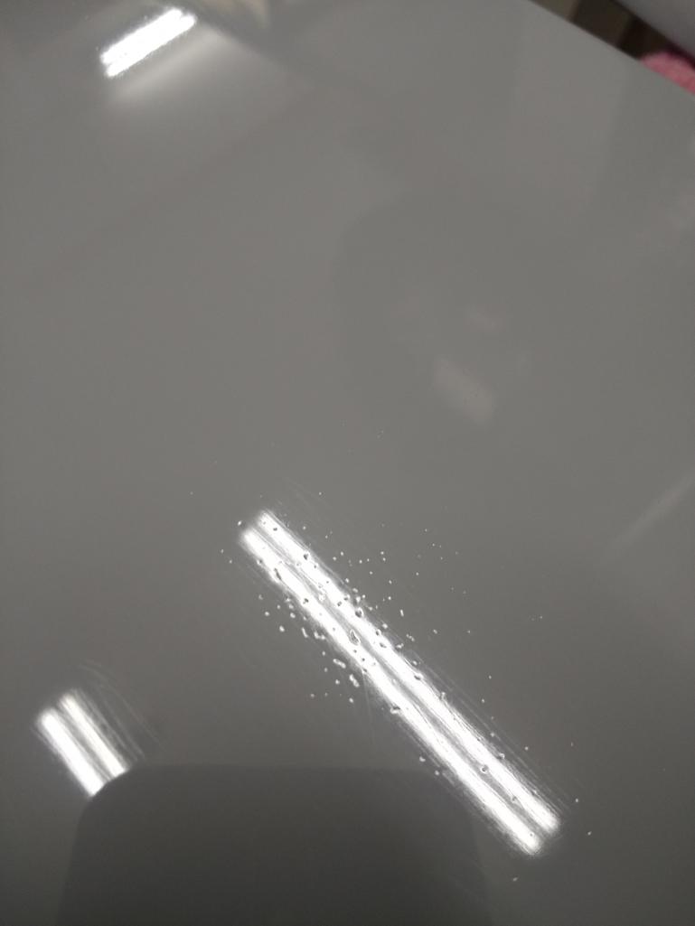

Here's the latest. I sanded with 400, cleaned with a red Scotch pad and something called "prep and wash" from R-M. I mixed the paint with a little extra reducer (4:1:1.5). The engine lid turned out decent:
The doors still got some orange peel. Not quite as bad as before, but still not what I was hoping for:
I turned down the amount of paint (1-2 turns) and sprayed at about 10-15psi at the gun.
It was 81 degrees and about 40-50% relative humidity. The first coat went on well, then I waited 15 minutes for the paint the flash, then did a second coat. The second coat seemed to have more orange peel.
When I paint, should I just paint a first coat then paint a second coat right away? In other words, go over the surface twice on the first coat?

I ran into the same issue with 70F reducer when it was about 90F. The paint dried so fast the orange peel never settled down to a sheen. Instead of getting the correct temp reducer I used a lot of reducer to thin out the paint. It went on better but still got some orange peel.
