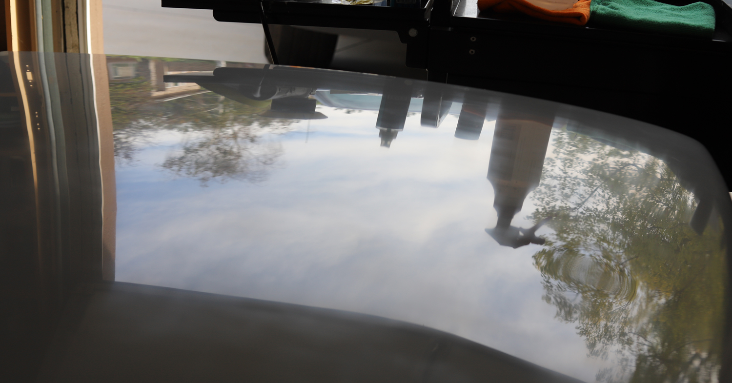

Here's the latest.
SANDING
I sanded 1000-1500-2000. Divided up the hood into 9 parts. Sanded with 1000 grit for about 3 minutes per area, then sanded with 1500 for about 2 minutes then sanded with 2000 for about 1-2 minutes.
POLISHING
Polished with Chemical Guys Hexlogic yellow pad (the roughest one) and V32 compound. Again, divided the hood into 9 areas. Went over each area 3X, taking about 2-3 minutes per area. In the demo videos, they went over the area once, maybe twice.
I had to re-polish a few low spots, since they are hard to see until all the compound is wiped off.
BTW, what is the best way to remove all the compound? I just wiped it with a clean microfiber towel. There seems to be a bit left.
A picture for your viewing pleasure:

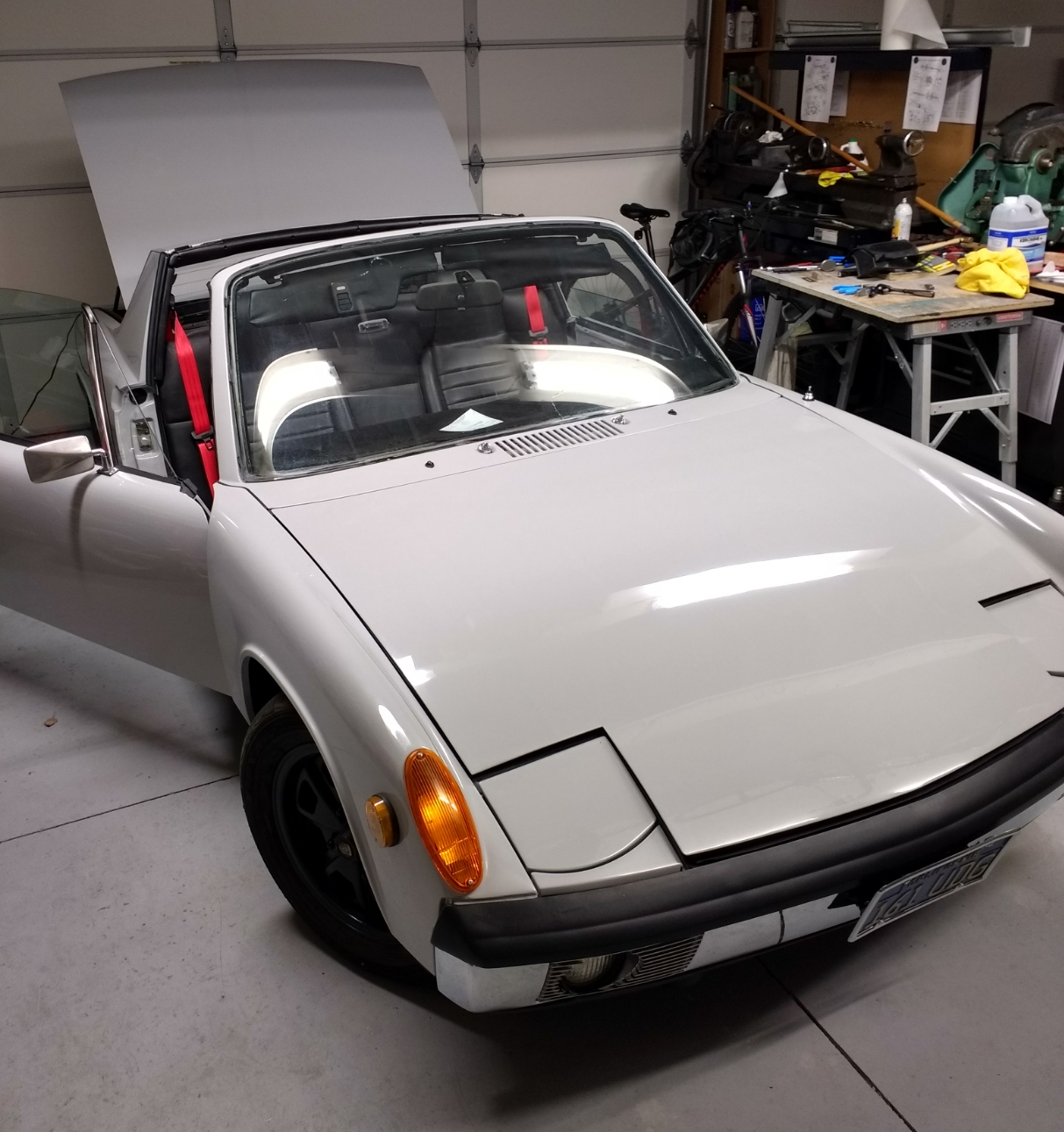

I'm done! I hired a guy to polish the car since I needed it done and just didn't have the time or patience to do it all myself. It took him about 20 hours to polish it.
They are some flaws and areas where the paint was too thin, but it looks good overall.

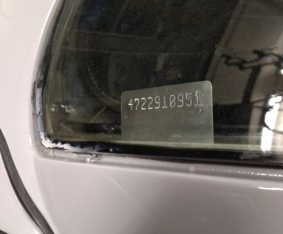

Oscar: here is a picture of the A pillar VIN tag. I made it a bit long to account for any future trim.
Thank you again for making this I really appreciate it.

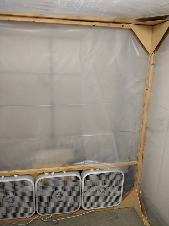

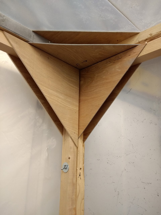

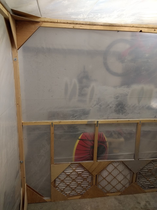

PAINT BOOTH
Here are some pictures of my paint booth. This is a smaller version I'm using to paint a roof and some other non-914 items, but it is built the same way.
I pulled air in thru furnace filters with box fans I got at Home Depot. The wood is 1-3/8" square stock. The corners are 1/4" plywood. I attached them with wood screws and heavy staples. I used 1/4-20 screws and wingnuts to attach all the panels to each other. I made 8' x 8' panels and covered each one with heavy plastic. I used staples to attach the plastic.
I should have put paper of the floor. It didn't keep out all the dust, but it was good enough.
