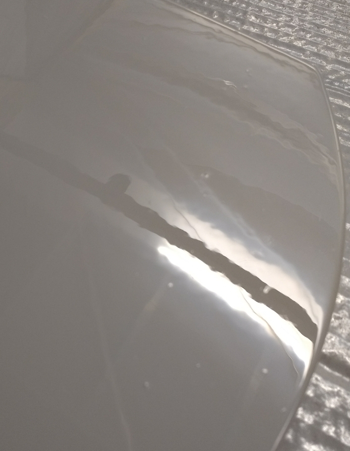

Here's the latest:
Still a bit of orange peel. However I think I figured it out this time. I would test the gun with a quick burst and the gauge would read 30psi. However, when I pressed and held it the pressure would drop. I re-adjusted the air flow knob. The air flow got quieter and sounded different. I discovered this while cleaning the gun. I really thought I had this dialed in before but apparently not! (IMG:style_emoticons/default/headbang.gif) What's interesting is the parts I sprayed quickly were turning out pretty good, like this headlight cover. It has a nice, smooth coat. That was because the pressure was higher:
The good news is the body is ready to be re-sprayed, so I can apply what I've learned. The bad news is I need to sand and re-spray the hoods and doors. At least they will have lots of paint on them! It will also give me a chance to make sure I've got it this time. I only have a little less than a quart of paint left, too.

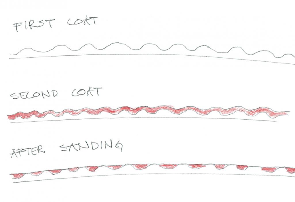

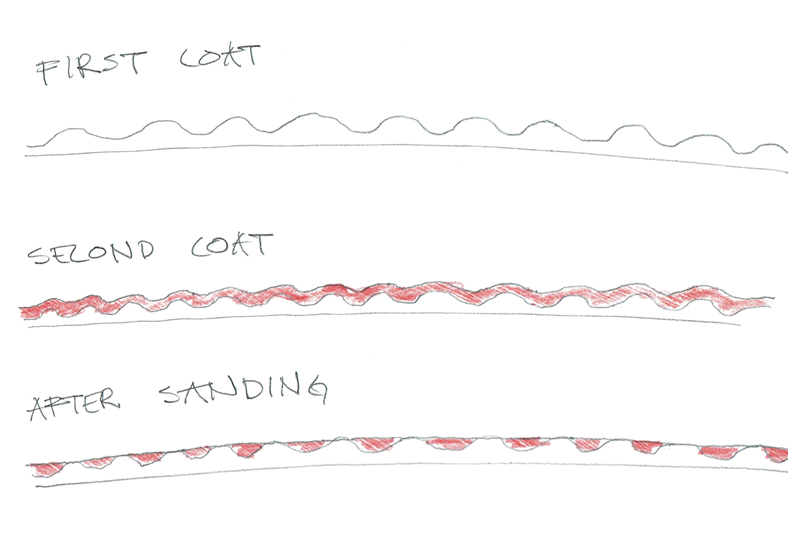

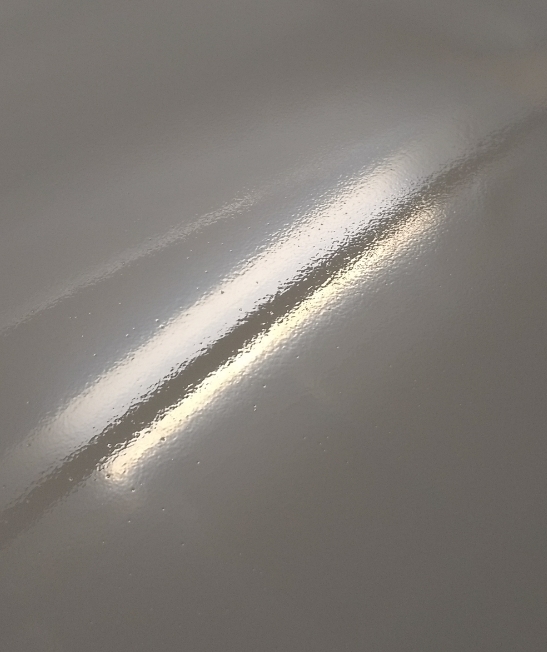

So, I'm still getting some orange peel. I thought I could sand it out. I'm not sure what I'm doing wrong.
QUESTION 1:
In theory, I paint the 1st coat with orange peel. Then the 2nd coat goes on. It fills the "valleys" in addition to adding to the "mountains". I should be able to sand the taller mountains down and get a smooth finish, correct?
QUESTION 2:
This is probably related to question 1. I'm getting small pinholes in a really shiny field of smoothness after I sand with 800-1000, then polish. I'm guessing these are the bottoms of the "valleys". I'm thinking I'm not sanding down far enough or not using the right grit sandpaper (I start with 800 or 1000 and wetsand it) or I'm not polishing it enough. I use Chemical Guys V32, then V-36 with a Torq X. I let the polisher spin and don't press hard (it doesn't spin if I do).
QUESTION 3:
Spraygun at 30psi at the handle gauge, right? How much pressure drop is there to the tip? The tip says 10 psi max. Compressor is set for 90 at the outlet. Is there a range of psi that could work? In other words, does 5 psi make a huge difference?
Any tips, help, etc, would be appreciated. I'm getting tired of sanding out my screwups! I'm also running out of time (and paint!); I start back up at work soon and I also want to be done before my neighbor complains again.

How long are you letting it sit before you color sand it?
There can be fish eyes that can be like craters.

1. Yes.
2. Pinholes are typically from something called solvent pop and is a real PITA to get prevent on some paint. I would talk to your paint supplier and describe the issues your having. Make sure you have good filtration of water and that you have adequate ventilation of the materials. What's happening is little bubbles are coming from the first layer and trying to escape but not able to.
3. This should help
https://www.learnautobodyandpaint.com/spray...ssure-settings/

After you color sand, wipe it clean and look at it under a bright light. Any low area will show as shiny. That can be a valley that you did not bring up to the mountain top.

If you have a contaminant on the surface no amount of paint will fix that, you'll only be making it worse by adding more paint on top.

Thanks all. Here are my responses:
I'm letting it sit for a week before sanding. The paint supplier told me to wait that long.
I didn't think it was solvent pop causing the pinholes, thanks for pointing that out. I wait 15 minutes between coats; maybe I should just spray one coat, or wait longer.
I wipe the surface down with surface prep (Prepall) right before I spray. My paint area isn't perfectly clean, and I've got a few bugs that have landed in the wet paint. They just sand out. But, for the most part, there doesn't appear to be any evidence of contaminants. One thing I heard over and over was "CLEAN the surface, then clean it again!".
I looked on youtube and elsewhere to learn. I thought I had this down. I painted a hood a few months ago and it looked great. I think I need more specific help pertaining to my situation (the weather, psi, equipment, paint type, etc.). I thought some of you might have some insight, so thanks! (IMG:style_emoticons/default/beerchug.gif)
I think Oscar is right-the weather is not helping. I'm even using high temp reducer and hardener (for 85-100 degree conditions). It was about 85-90 degrees (50% humidity) in the garage when I painted at about 10 am.
I can paint at night, but I think it pisses off my neighbor. I'll try one more coat (early in the morning) on a door at higher psi and see what that does. I'm going to dial this in on the doors and hoods before I do the car body!
