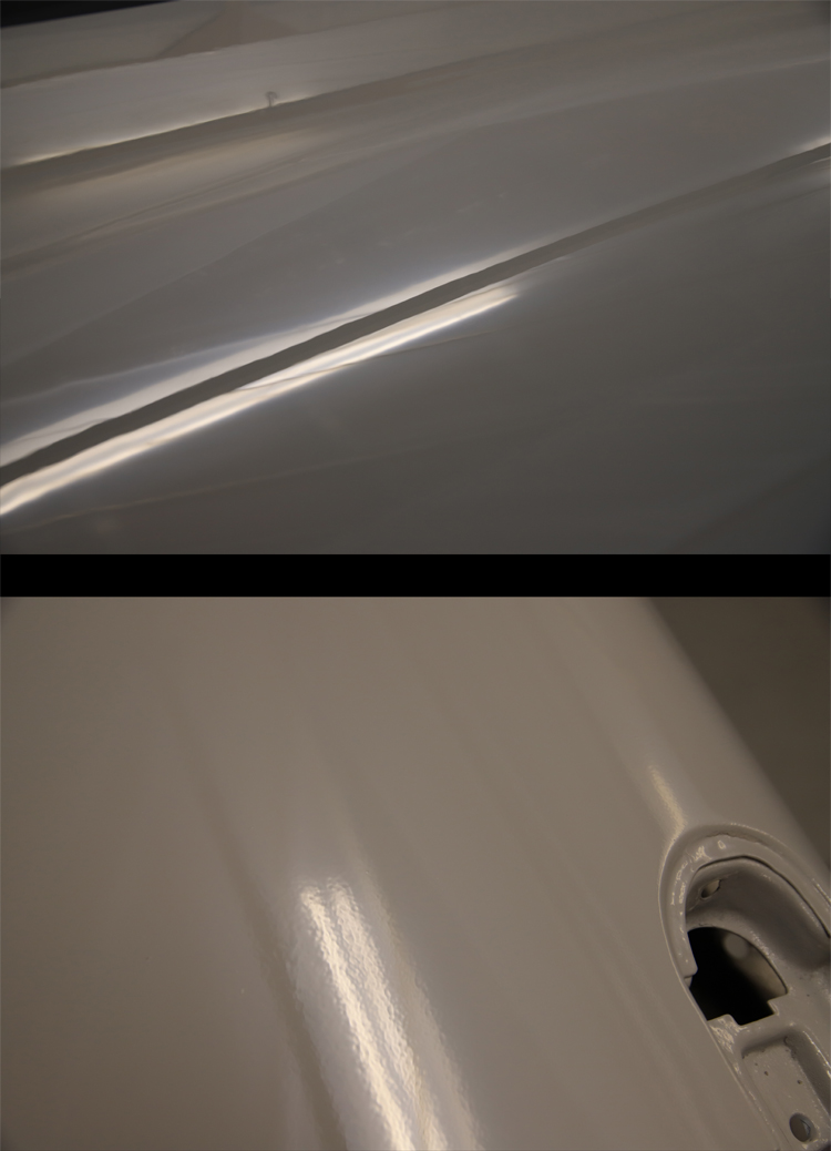

Here's the latest:
I painted both doors. I put on 2 coats, one right after the other while it was still wet. They both look pretty good except for some orange peel in a few places. It doesn't seem as bad as before. I'll try sanding it out. It looked really good when I first sprayed it, then as it dried the orange peel appeared.
The gun was intermittently not spraying paint, but otherwise it went well.
It was 85-90 degrees, 45% humidity at 9 am.

I thought I read in one of your posts that you were running 10 to 15 psi at the gun which is real low. 25 to 30 psi is better. From what I have learned from the net is 10 psi is at the tip of the gun but is unmeasursble. The pressure must be sustained obviously and with small compressors that can be difficult to do. Thus small parts its ok. A good test is release just air out of gun, set the pressure, and continue releasing while watching the gauge see just how fast it drops off on you. I had a 20 gal compressor once that gave maybe enough time for one coat on a small fender at the required pressure. It got way better with my 60 gallon.

QUOTE(Andyrew @ Aug 1 2018, 10:04 AM) *
What kind of gun with what size tip are you spraying with?
This one, with a 1.4 tip:
https://www.harborfreight.com/20-oz-profess...-gun-68843.html
I thought I would try a cheap gun first, then buy a nicer one, but this one seems to work fine. Everything I read said it's really the technique, not just the gun, that makes for a good spray job.

QUOTE(Costa05 @ Aug 1 2018, 11:22 AM) *
Yeah, I was spraying at that before I learned my lesson. I upped the psi at the gun to 30 and got much better results. I didn't realize how much pressure drop there was. The air even sounds different.
I did just what you suggest: I pressed and held the trigger to see what the pressure was staying at. Before, I just pressed and released and got about 30 psi, but that was just a burst. It would go down to 10 or so when I held the trigger for spraying. My gauge was covered with paint, then when I cleaned it with acetone, the plastic got fogged up. I sanded with 2000 and polished it up so I could see it again.
I don't get as much paint on anything, like I did before, so I've been able to see the gauge while spraying.

You already have a ton of great feedback on this thread but I thought I would add my $0.02 as well from my introductory painting experience.
First off, I am not a fan of HF guns for spraying topcoats. Some of the more experienced guys can make this work but I just don't think those guns have enough adjustment and do a good job of atomizing paint. That's just my opinion. I bought a devilbiss starting line gun kit. Two guns and accessories for under $200.
It sounds like you are using the right temp reducer, but when in doubt always choose the slower (higher temp) reducer and just allow more flash time between coats to avoid solvent pop.
PSI at the gun should be 35-40 with the trigger depressed. Make sure you are setting this pressure correctly, it can greatly affect your outcome. As others have mentioned, make sure your air is clean.
Make sure you are applying medium wet coats with a good 50% overlap. If you aren't getting enough paint on the panel, it will never get a chance to flow out. A lot of times I have to remind myself to slow down when spraying.
After spraying 3-4 coats of color, give the paint a full 24 hours to shrink up and flash before assessing orange peel and other conditions. It takes time for the paint to reach it's final appearance state but it's 80-90% of the way there about a day afterwords.
When wet-sanding, start around 1000-1200 and work up in stages. 1000 - 1500 - 2000, etc. You will need either rotary buffer (dangerous to novice users) or a dual action with enough throw and aggressive pads to get ALL of the sanding marks out. I can general get around 95-98% correction with my dual action using a microfiber cutting pad and meguiars M105 cutting compound. Tape off your edges when sanding!
I'm sure there are other tips I can think of but that's a fair amount of information for now. Your last efforts look much better than when you started. This isn't an easy trade to master, but with a lot of practice and perseverance you can get pretty good at spraying paint as a hobbyist.

QUOTE(aggiezig @ Aug 1 2018, 01:25 PM) *
Thanks for the advice. Always appreciated! (IMG:style_emoticons/default/beerchug.gif) Where were you a few months ago! (IMG:style_emoticons/default/poke.gif)
Yeah, I use the slower reducer. I can wait.
I noticed the psi has a huge effect. I'm just an idiot and didn't do this right the first few times. I now check the psi with the trigger depressed.
I never did find any good advice on how fast to move the gun. I tend to go too fast on the big panels. I noticed on the small pieces I was getting a good finish; I was going fast over them.
I sand by hand unless I'm re-painting a panel. I've burned thru the paint too easily. I've even sanded thru it by hand, especially on the edges. Once I get a good finish, I will tape the edges.
I should have practiced more! (IMG:style_emoticons/default/headbang.gif)
