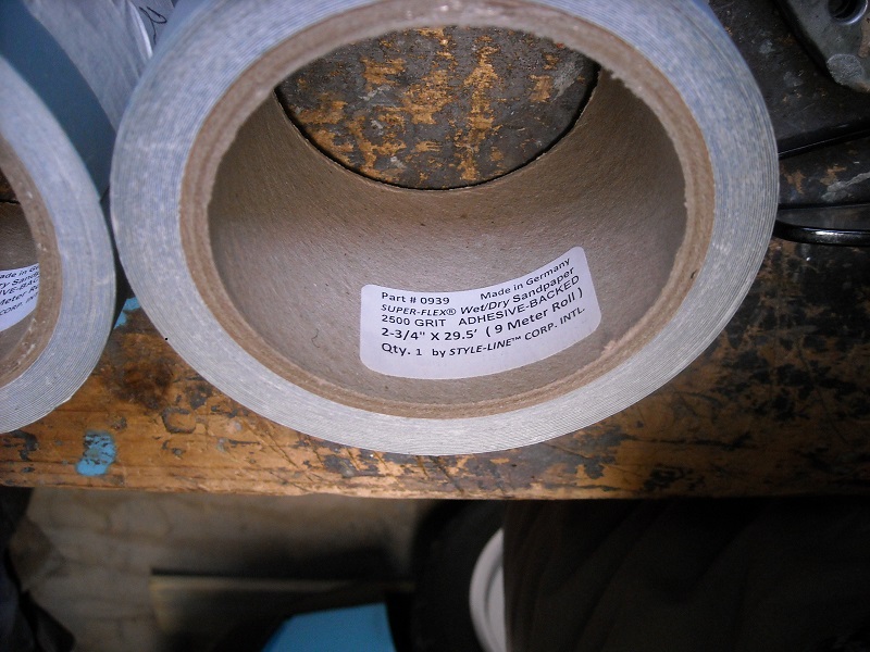

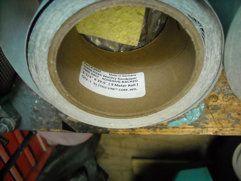

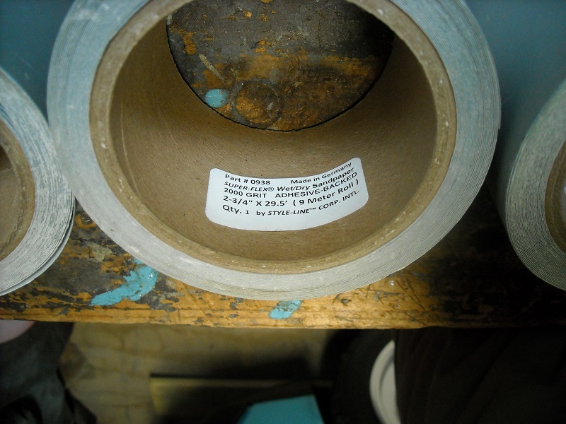

+3 on Kevin Tetz. I learned most of this from his videos. I also bought some sanding supplies and tools from Eastwood. I just wish they had 800, 1000, 1500 and 2000 grit for the long Durablocks. Their house brand sandpaper is pretty good. I'm using 3M and it works, but clogs and wears out fast, even though I'm using water.
I don't remember where I bought it but you can get the finer grits in adhesive backed rolls for the longboards.
maybe these pics will help. 1500,2000,2500. I think I also have some 800 and 1000
AND Made in Germany...
Attached ImageAttached ImageAttached Image

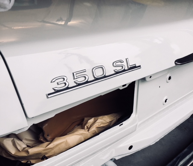

QUOTE(mbseto @ Aug 1 2018, 09:06 PM) *
Man this is a clinic. Almost makes me want to try to paint my own car.
Jump in and do it. I'm on my second car; bare metal repaint in the original color. This is after two coats of single stage. Still 2-3 more coats to apply. Once you learn how to do it, you'll look at car purchases differently. It's an enormous of work, the most I've had to do, but super rewarding and saves a TON of money.

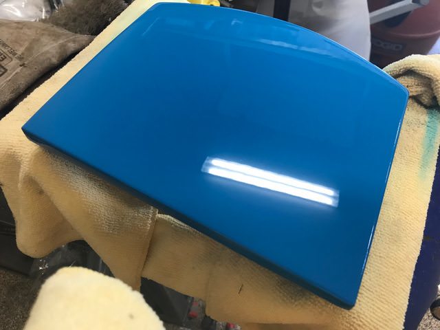

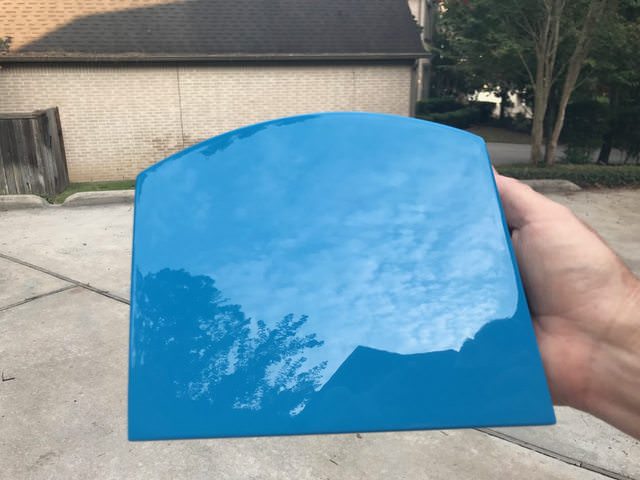

I think that with enough trial/error & practice you can do a pretty bang up job yourself. You just have to be realistic with your expectations and also be willing to work at it for hours and hours. I think all said and done I will have between $2,500 and $3,000 invested in my paint job. That includes paint guns, sanders, primers, good quality paint, undercoating, fillers, supplies, etc.
Prior to my current project, I had zero experience. I am learning as I go and pleased with my results.
This is using PPG DCC Concept single stage acrylic urethane in Mexico Blue. After a cut with 2000 and compound with M105.
(IMG:http://www.914world.com/bbs2/uploads_offsite/i.imgur.com-19557-1533263956.1.jpg)
(IMG:http://www.914world.com/bbs2/uploads_offsite/i.imgur.com-19557-1533263956.2.jpg)

Nice job! Yeah, it's taking me lots of practice. I'm using the hoods to dial it in since they are easy to sand and re-paint.
QUOTE(aggiezig @ Aug 2 2018, 07:39 PM) *

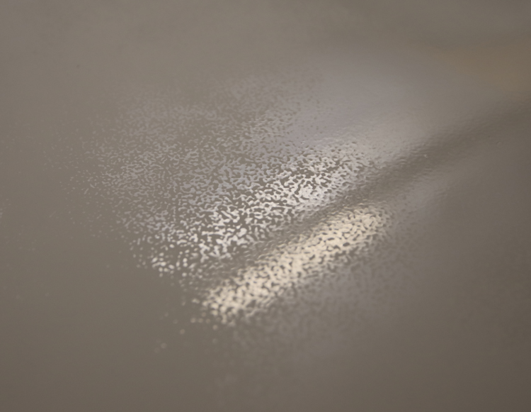

I'm STILL getting orange peel.
To review, here's the set-up:
1. 33 gallon compressor (8.6/6.4 CFM @ 40/90 psi, 2 running HP)>25' coiled hose>2 moisture filters>25' 3/8" hose reel>"pumpkin"-style filter>regulator>gun.
2. Gun: the $70 Harbor Freight one. I clean the gun thoroughly after use, by the way. All the important parts look new when I'm done.
3. Spraying single stage paint (R-M brand) at 30 psi (at the regulator). Using high temp reducer. I use mid-temp hardener. I mix the paint well to the proper proportions. I'm wondering if the paint is not going on wet enough? How do I tell, other than the obvious "it looks wet"?
4. 80-90 degree weather, 40-50% humidity in the garage. I made a makeshift vented "booth" to keep the dust and wind out.
5. I'm about 6-8" away. I'm not sure of spraying speed; maybe 12 inches per second?
6. I'm getting orange peel that will not easily sand out. I'm starting with 800 and using a long block. There are still shiny spots. How much orange peel is acceptable and sands out with 800 or 100 grit? The images I've found have way less than I'm getting.
7. Does the gun really matter? Should I get a better gun? The one I have seems to spray just fine; I think I am the problem! I've heard that better guns atomize better, but I've also heard that the painting conditions matter, too. Is there a price point at which the quality of the gun actually shows up/makes a difference? In other words, are guns below say, $100 all pretty much the same and I gotta spend at least $200 or whatever to get better quality that will actually matter?
I know it's as art, but I thought I've done everything "right", but I'm still not getting good results.
