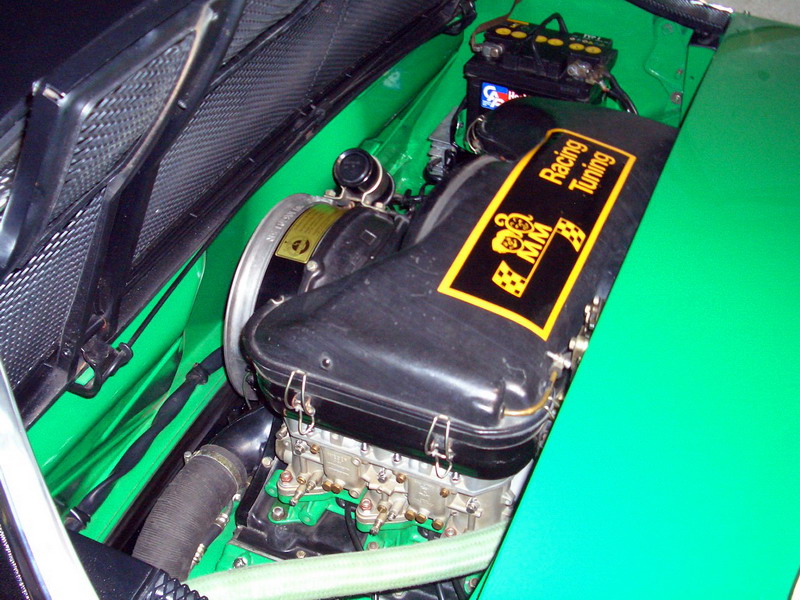

Can we uneducated non-six owners see a pic of the part?
1970 Neun vierzehn
post Nov 6 2013, 07:22 PM
Posts: 3,199
Joined: 16-March 06
From: cincinnati, ohio
Member No.: 5,727
QUOTE(Pat Garvey @ Nov 6 2013, 03:26 PM) *
Pat,
I believe this is the part in question (minus the large sticker of course)
Rand

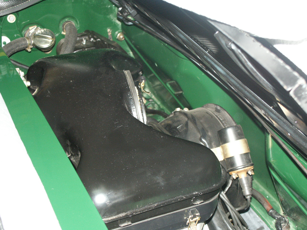

QUOTE(1970 Neun vierzehn @ Nov 6 2013, 08:22 PM) *
Looks like the snorkel is missing. Mine faces the passenger side.
Subjective, yes. The factory air cleaner is quieter than the rain hats, however my butt says the rain hats provides a bit more kick.

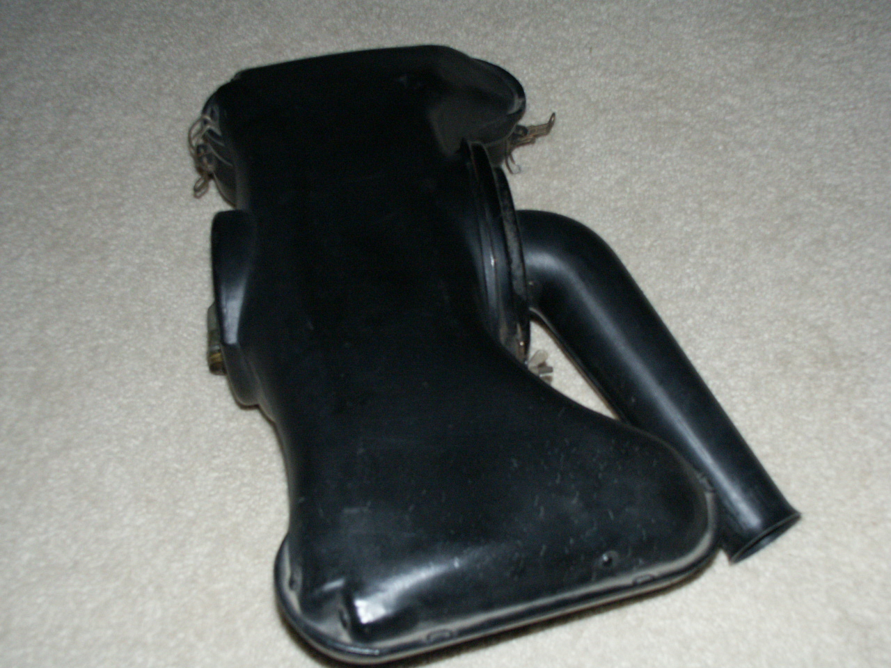

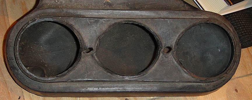

they were plastic

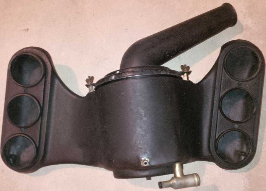

here is a bottom view
sixnotfour
post Jan 4 2014, 09:12 PM
Posts: 11,273
Joined: 12-September 04
Member No.: 2,744
what no cold start nozzles ??

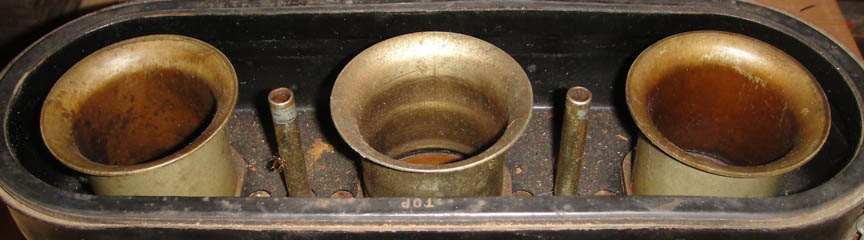

Here is the result of a fairly mild melt from the carbs popping flame back.
The outer 2 air horns are plastic, the center one is metal..
