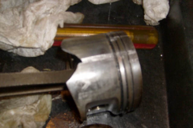

This has been a long saga this summer. The trouble started before the last rebuild. I had a head gasket failure and a broken spring. This caused seat damage in one cumbustion chamber. I had the head repaired and cut. When I assembled the engine I may have had one cam advanced causing a valve collision or I could have just had a valve stem break, or I could have damaged a ring during install... Who can really know.
Anywho.. I brought my heads in to a head specialty shop to have them evaluated. The head guy told me it would cost a minimum of $ 900.00 plus parts to repair the damaged head. When I asked him how much these heads were cut he didn't know... He didn't even really know how to check them. I told him to box them up and I would come get them.
Now, an uncut 928 head is 24mm measured off a boss on either end of the head. Mine were in the neighborhood of 23.4 to 23.6mm. (one was cut like a wedge...could have been like that before the rebuild) That is in spec as you can use a 1.4mm gasket opposed to a 1.0mm gasket to bring the specs close to stock.
I figured I'd get a unmolested set. These are not easy to find or cheap when you do. I sourced a set of heads from a very reputable 928 source. They hit my AMEX for (are you sitting down) $ 1000.00. I brought these heads into my local Chevy guy machine shop with all the 928 head info I could gather. They measured the replacement heads and discovered they were at 23mm, needed intake guides and a couple of valves, and a resurface. I shipped them back for a refund and had my heads fixed. My heads are now 23mm, (at where the replacement heads measured)
BTW: For the guys that don't know, My engine is a euro spec "S" engine. It's factory rated at 300hp. Stock compression is 10:1 the cams are "S" cams, the throttle body is way larger that US spec engines as well as the inside diameter of the intake runners, the intake and exhaust ports are larger, the combustion chambers are smaller and the valves are bigger. The heads and intake are very desirable in 928 circles.
It cost me $ 770.00 including the welding repair of a very bad hole punched through the intake seat by the exhaust valve stem, new intake guides and 5 valves. The work looks great!
BTW: The complete gasket plus the added cost for the thick head set, rod bearings, Loctite case sealant and stuff were over $ 800.00.. This is not a Chevy kids.
(snip)
So cutting the heads causes chain slack which the tensioner takes up either retarding or advancing cams. Does one cam retard and one advance, or do they both advance? If they both move the same direction, how much (how many degrees)? If you advance or retard 4deg, assuming you don't lose too much valve clearance of course, won't make a huge difference with a mild cam that a factory would produce.
Also, were the other five valves bent? If you only have a single valve that had an issue (like snapping off (IMG:style_emoticons/default/sad.gif) ) then probably a valve failure v. contact with the piston. If it interfered enough to break it off, you would probably see bent valves elsewhere too. If the others needed replaced just due to guide problems and therefore stem damage, probably not an interference issue.
(snip)
Yes, advanced one cam more than the other. Others are using 7 deg offset keys with less cut on the heads. The euro "S" engine is an interference fit engine. Every mm count's.
Valves were bent from collision.
Lastly, have you looked into custom copper head gaskets? I have no clue as to availability for a Porsche, but for the 'merican V8 stuff, you can get them in a wide variety of thicknesses. We ran some .100" thick ones for a guy that bought used NASCAR heads with 38cc chambers to get the compression back down a little. They can be tough to get to seal, but I just put a very thin layer of hi-temp RTV around the water ports whenever I used them and got lucky every time.
Copper gaskets are available. But this is an open top block. I'm not comfortable running a copper gasket.

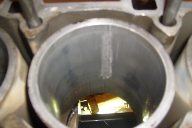

I've exhausted everything I can do to remove the broken stud from my spare block for now. Maybe the machine shop can get what's left out some day. I pulled the engine out of my car and tore it down. I found a galled cylinder wall and broken piston. After I dropped the valve in my 4.7 "S" engine, I purchased two used pistons and reassembled the engine. I think one of the used pistons I purchased was cracked or somehow damaged.
Here's the block.
I think this block can still be bored from 4.7 to 5.0. So, I'm back to extracting the studs. I have all but one removed. It's really stuck and I'm working on it slowly. If it breaks, I'm screwed. This is my last block.
Edit: up date: I just removed the last stud from my "S" block. I'm sending this one to the machine shop tomorrow.
