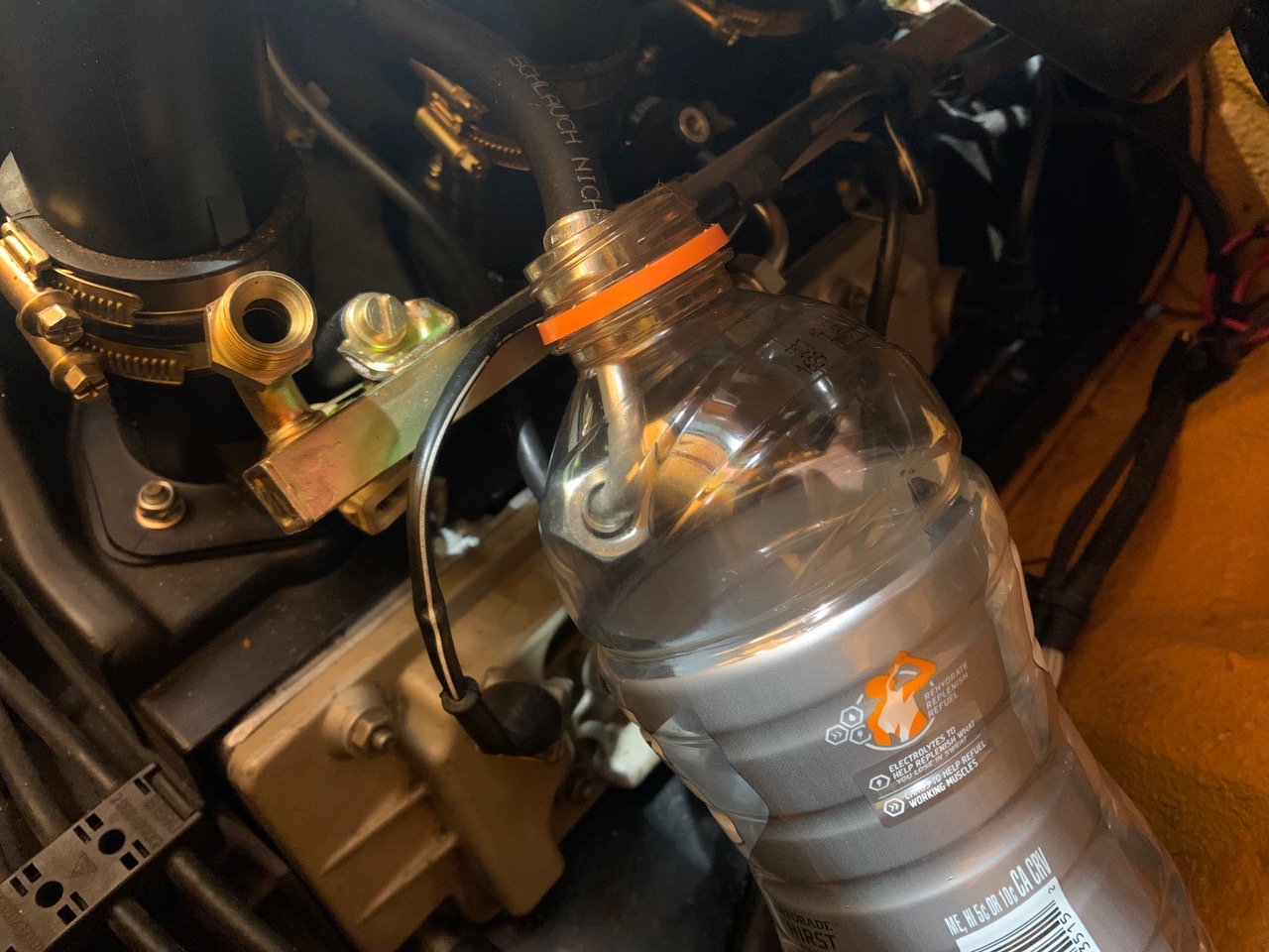

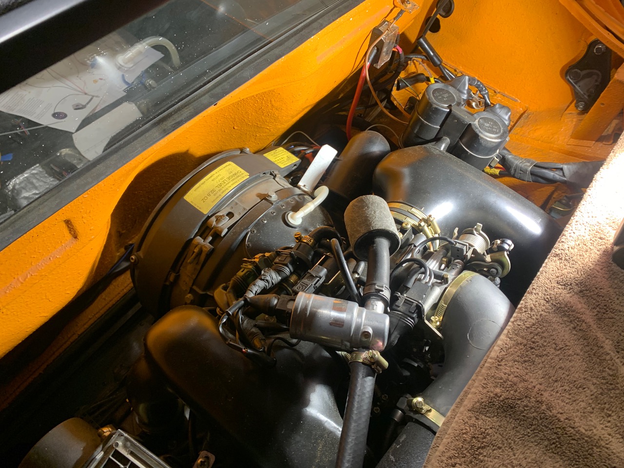

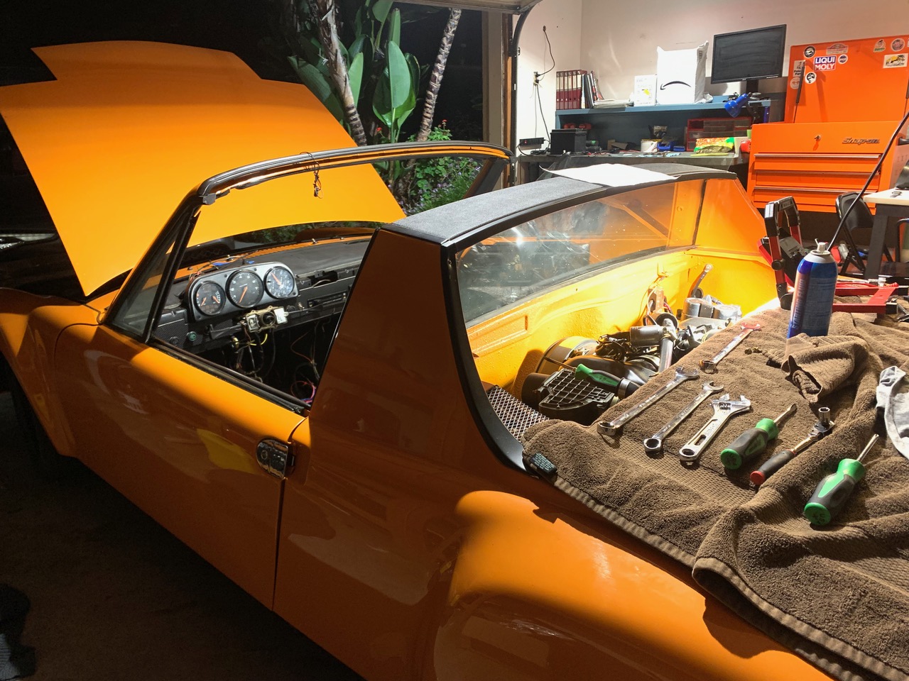

I mentioned previously that the car was running rough. I suspect it's the injectors. As a precaution I'm also going to take this opportunity check or replace the following. I don't foresee this as a big problem, because I've had the car running in this configuration for 10-20 minutes at a time, but we'll see....
- Servicing the injectors: As much as I would like to get new ones, at $250 each, I just can't see it happening.
- New Fuel Pump: This unit sat for a while and I remember there was something 'finicky' about it before reinstalling it. Further, it's been with the car for atleast as long as I can remember and sat 'dry' for the longest time. Also, when I turn the ignition ON and the system is on, it seems a bit loud. Something here doesn't seem right.
- Check the fuel lines: These are new, but I'm going to check underneath the tank, in the tunnel and out the rear firewall for any 'kinks'.
- Lower the fuel filter: I made the mistake of mounting the fuel-filter above the fuel pump in the front trunk, and a bit too high. While it's easy to get to, clean and replace, it's too high and I need to lower lower it to about the same level as the fuel pump.
- Install a pressure Gauge on the passenger-side fuel rail: I'm sure I can do this, I'm just not sure how to yet.
Getting ready for each of these, I spent last night removing the injectors and wanted to be careful because I've already detailed the engine bay. Pretty straight forward, just started at the Passenger-side fuel rail and disconnected the supply line. It had a bit of fuel, but nothing that a water-bottle and a rag can't handle. From there, just disconnected each hose tot eh pressure regulator and engine fuel system and repeated the same on the Driver-side. For those that are doing this for the first time, give yourself about 1.5-2hrs, have a few rags and take your time. It gets a bit cramped in the 914 engine bay, but it's not too difficult with light, a Gatorade/Bottle handy and the tools on-hand (16, 17, 18, 19mm wrench). (IMG:style_emoticons/default/bye1.gif)

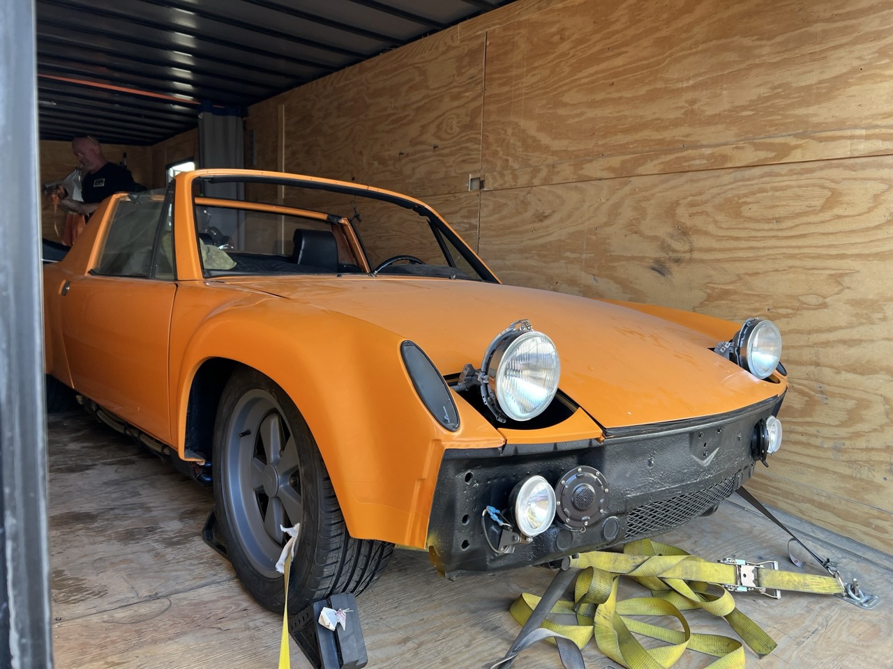

It's been a non-stop couple of years, but I'm happy to say I'm here for it. After much internal-wavering, I decided to contact several restorers/shops here on 914World. Every person and shop I spoke to was incredible, though I eventually decided on Ben Martin of Martin Mid-Engine for the project after he was able to carve out time to visit myself and get an in-person look at the car here in San Diego.
From there, a few months passed and in early-July, the car was on its way to the PNW - thanks to the help of my lovely-assistant, a very-dedicated 'hot shot' hauler, and Ben himself.

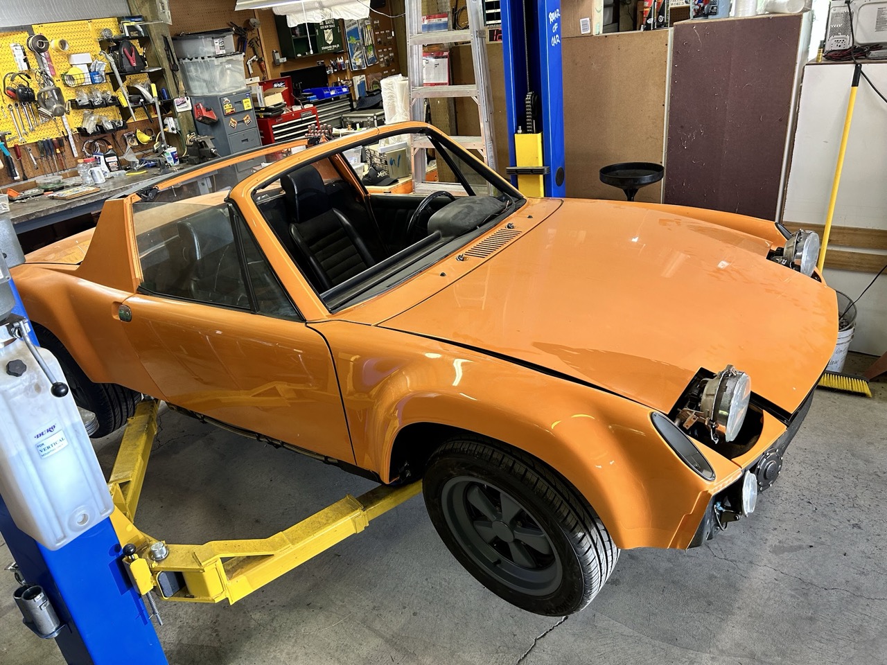

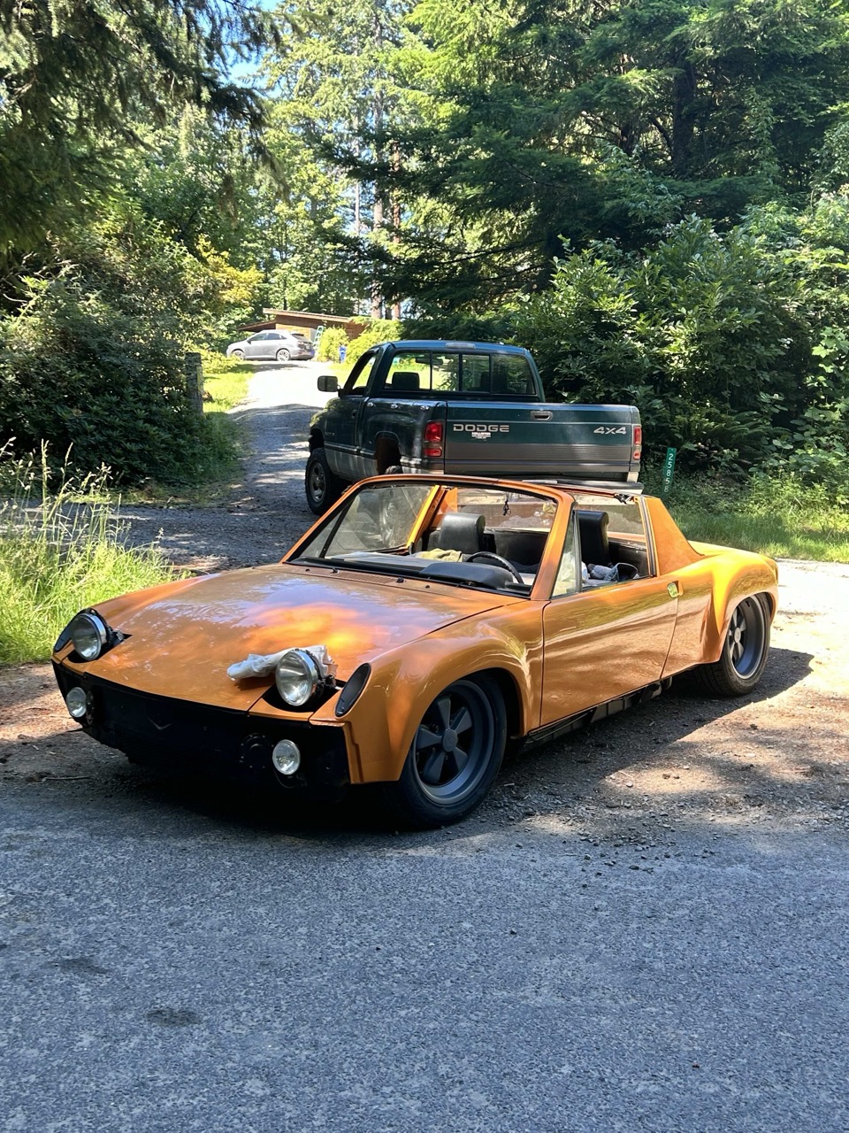

Keeping the thread going, a few progress photos from Martin Mid-Engine HQ. Very grateful for this as well, because my work is going to be 'checked over' by another set of experienced eyes and hands! Likewise, I feel better knowing the key-components such as Brakes, Suspension, Steering, Motor and Transmission are getting a once over and a second-look.

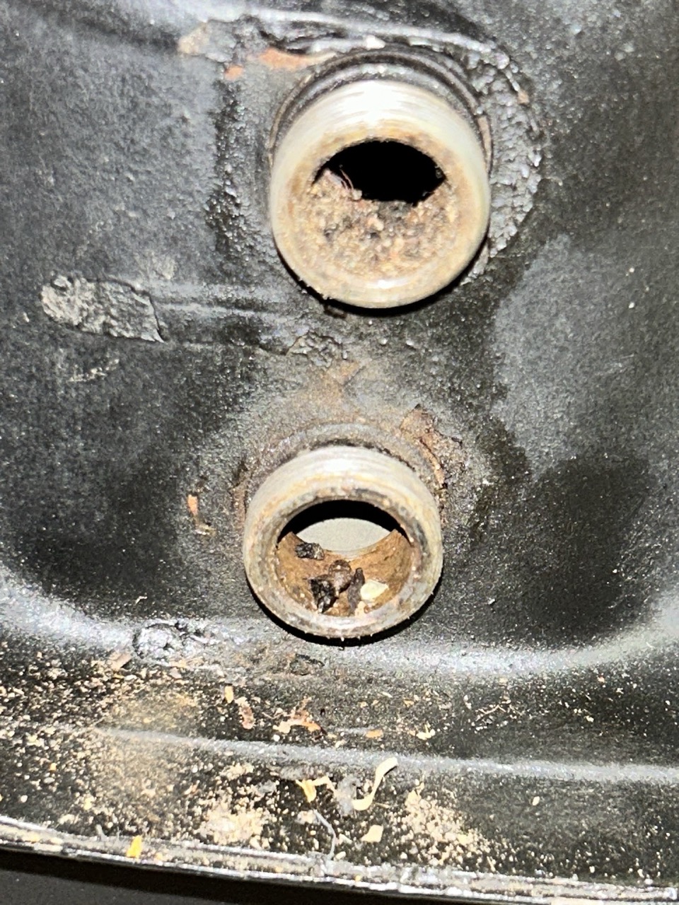

Seen here, the car on the lift getting an initial sorting as well as a 'restart' of the engine. You can see in the photos the level of grime from the wrong-lines being used for fuel. I think I mentioned previously that the previous owner had mistakenly run hydraulic lines for fuel, which degraded and resulted in a lot of 'crap' going to the injectors. As of now, motor and ECU are running, and we have an operating clutch. Downside for this week, appears my stock / OEM

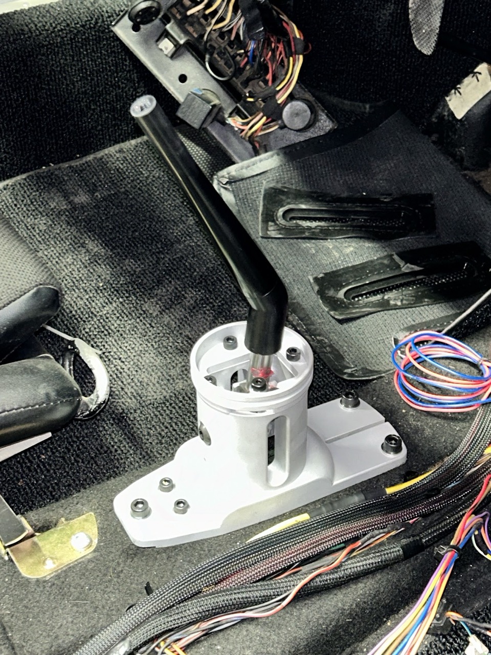

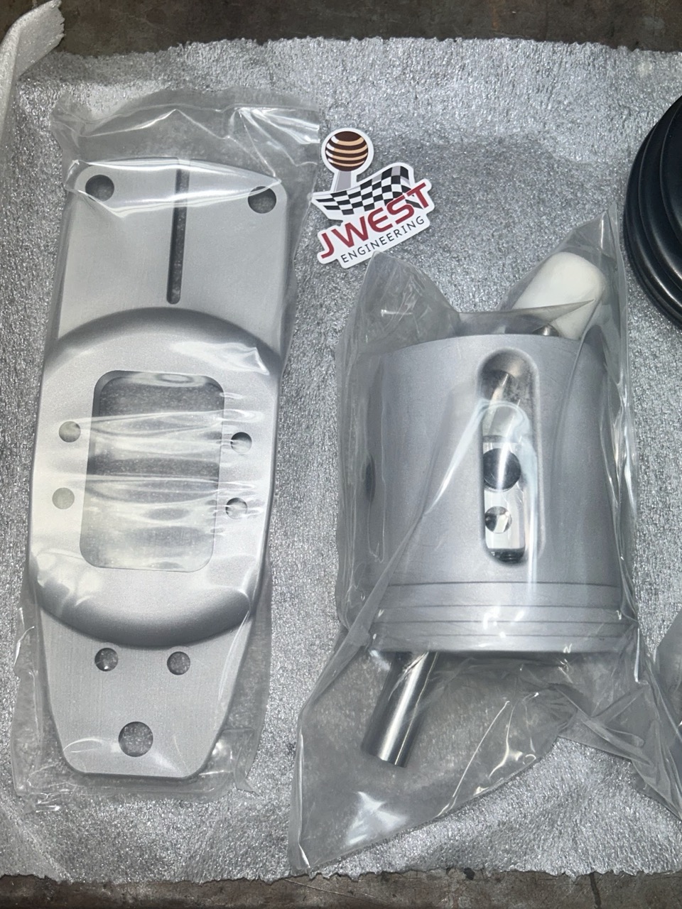

Another mistake, on my part, is that I forgot to convert the shift assembly from a previously 901-unit to the 915 assembly. Happy enough, a quick-call to JWEST resulted in a delivered Rennshift unit. So nice!
'Shiny-parts' and 'Oily-parts' photos below, until later friends (IMG:style_emoticons/default/bye1.gif)
