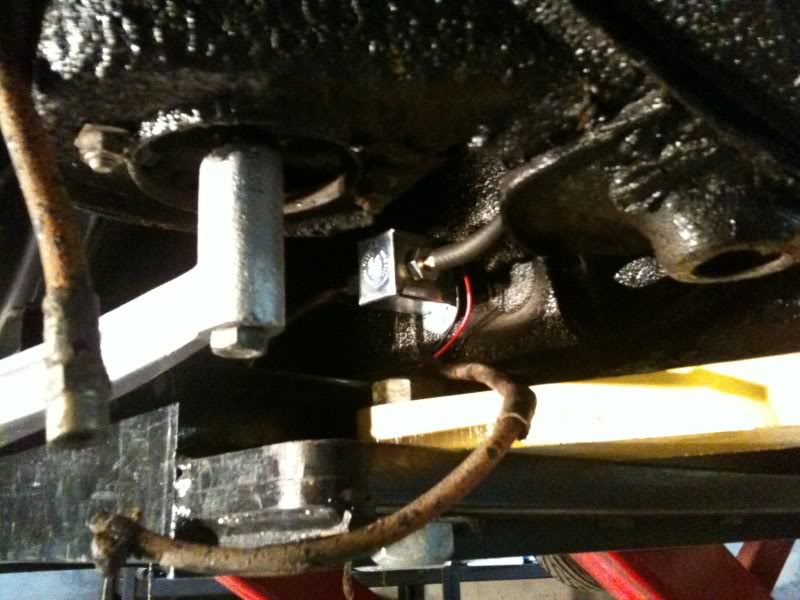

New location of the fuel pump....
(IMG:http://www.914world.com/bbs2/uploads_offsite/i16.photobucket.com-9478-1278049862.1.jpg)
(IMG:http://www.914world.com/bbs2/uploads_offsite/i16.photobucket.com-9478-1278049863.2.jpg)

Will that fuel pump move enough fuel for those carbs?
Awesome build - I just read your thread from start to finish!

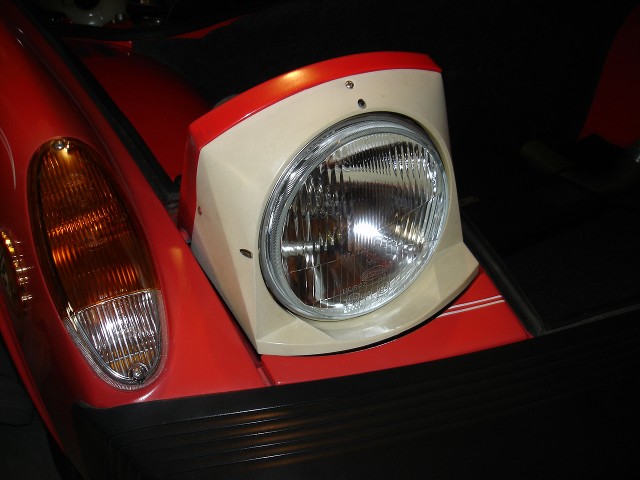

Headlight surrounds:
Looks like you have the original 1970 white ones that had been painted black.
If you want, I have black ones off of my '76 that have <85,000 miles that you can have. I'm back dating with the early white ones on my car, as pictured above. You might want to attempt restoring the white surrounds, at a later time. They're rare and correct for your model year.
Let me know. I'm in Carlsbad.
