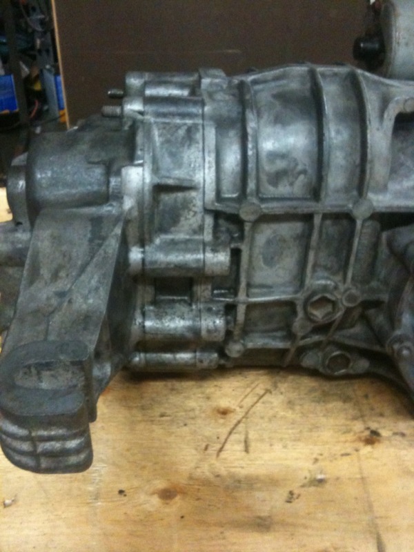

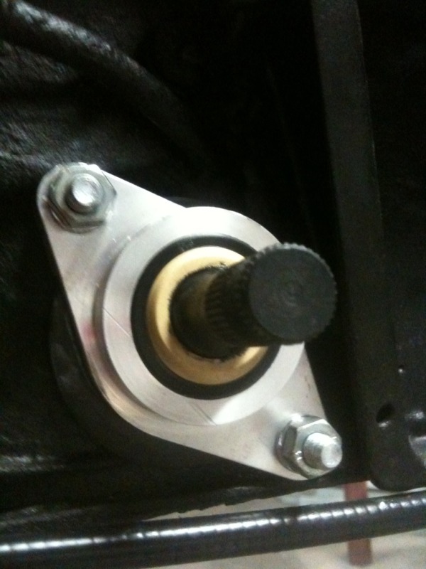

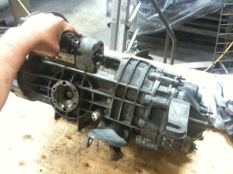

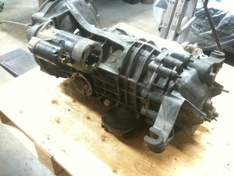

Back tracking a little, as I promised myself I wouldn't update this until the engine was in.... So i'm going to rewind a bit and explain the process leading up to the engine actually getting in the car.....

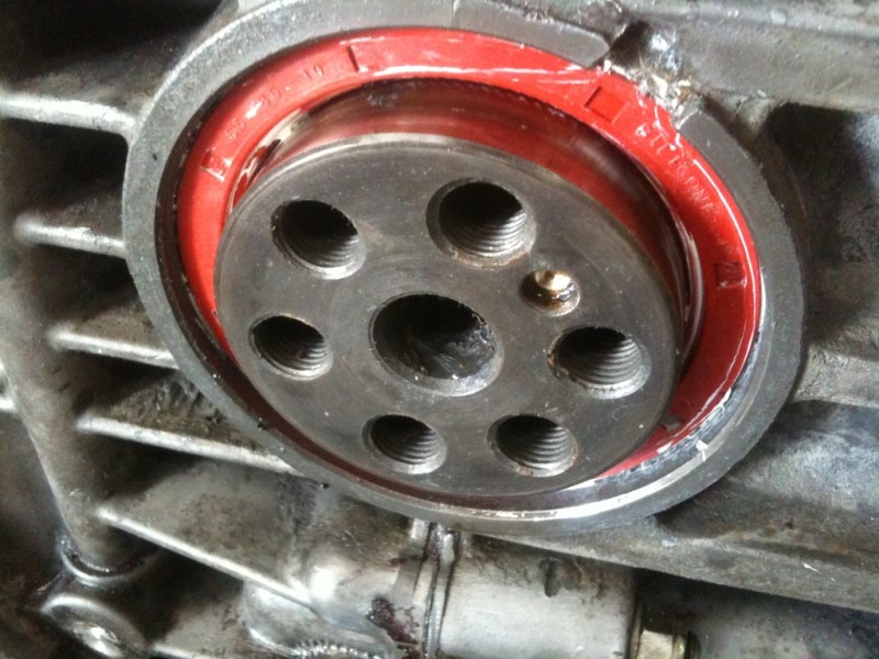

See as I wanted to get all the components ready, I made sure to first clean the transmission. This took about 2-3 hours of hardcore scrubbing with brushes, engine cleaner, and rags. Though it still has an aged look, all the 'gunk' is removed from the transmission. Brents (wertygrog) came over the same day I was doing this and look at me in shock with the amount of filth I was covered in.
(IMG:http://www.914world.com/bbs2/uploads_offsite/i16.photobucket.com-9478-1311955474.1.jpg)
(IMG:http://www.914world.com/bbs2/uploads_offsite/i16.photobucket.com-9478-1311955475.2.jpg)
(IMG:http://www.914world.com/bbs2/uploads_offsite/i16.photobucket.com-9478-1311955475.3.jpg)

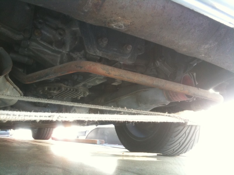

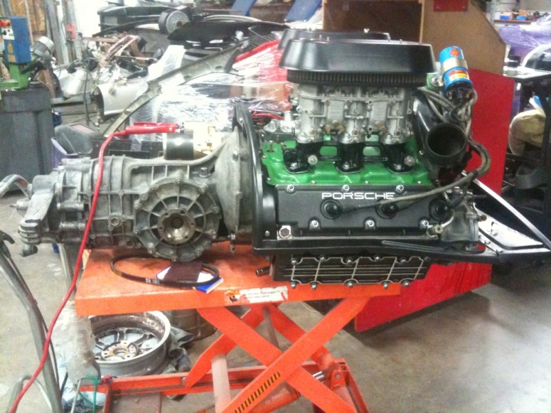

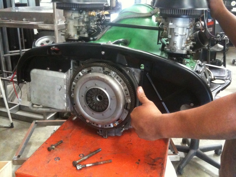

On Monday my Dad and I effectively took most of the the day off, and finally installed the clutch, pressure plate, and flywheel. Compliments to this as you may have read earlier in the thread, where a new pilot bearing, new rear main seal, and cleaning of the area behind the flywheel, and in a 'while we are here' move, we ended up installing a high torque starter... why not, right?
(IMG:http://www.914world.com/bbs2/uploads_offsite/i16.photobucket.com-9478-1311955476.4.jpg)
(IMG:http://www.914world.com/bbs2/uploads_offsite/i16.photobucket.com-9478-1311955476.5.jpg)
(IMG:http://www.914world.com/bbs2/uploads_offsite/i16.photobucket.com-9478-1311955477.6.jpg)
(IMG:http://www.914world.com/bbs2/uploads_offsite/i16.photobucket.com-9478-1311955477.7.jpg)

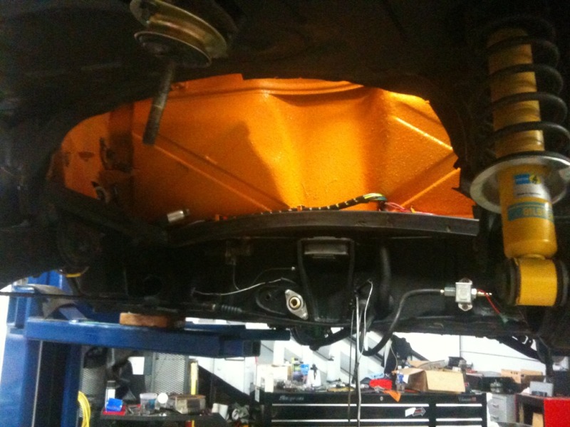

At this point, the engine was just about ready to go in, when we realized we had to install the Jwest shift linkage kit. Important note: If you have a stock /6 motor mount, this requires a bit of alignment and creativity.
(IMG:http://www.914world.com/bbs2/uploads_offsite/i16.photobucket.com-9478-1311955478.8.jpg)

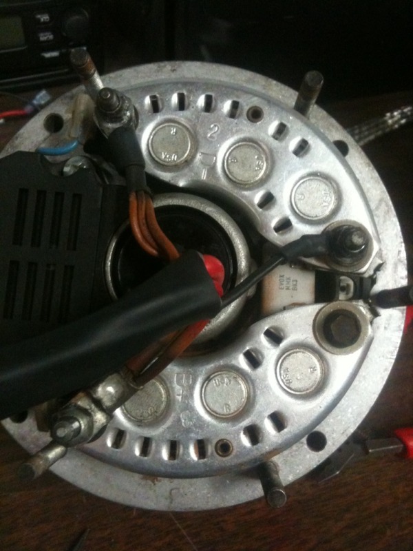

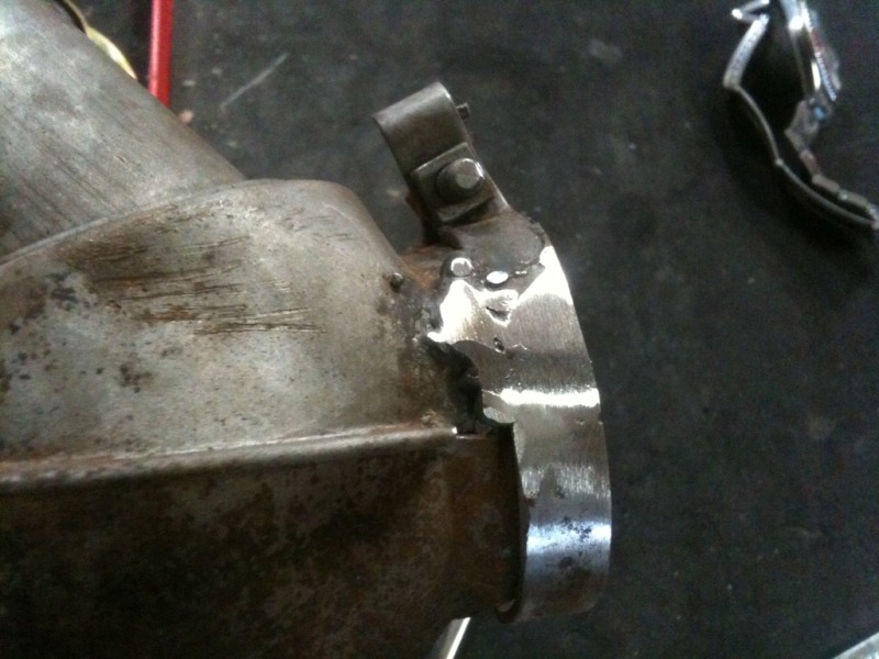

With the Jwest kit installed, and the engine below the car, we almost forgot about the fan belt, it was here that caused a bit of delay.

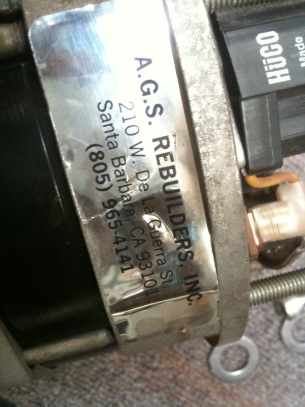

Important part: Unfortunately for me, the stud coming out of my original alternator had only 3-4 'spacer rings' on it for mounting the belt 'pulley'. Whoever installed this previously while the engine was in the car must have had one hell of a time, because the stud was nearly stripped. YOU MUST HAVE 6 RINGS ON THE STUD AT ALL TIMES.
This setback forced me to 'update' my alternator. I had to take the entire fan component off a 3.0 SC (this had the 'newer style' stud, with an allen bolt in the center for better control), that we have sitting around, disassemble the mount, pop off the fan, remove the cone, disassemble my original, rewire the new alternator and re-assemble everything. Rather annoying when you have your engine ready to go into the car. (IMG:style_emoticons/default/headbang.gif)
However, the silver lining of all this was that the 3.0 alternator was recently rebuilt. Nice.
(IMG:http://www.914world.com/bbs2/uploads_offsite/i16.photobucket.com-9478-1311956925.1.jpg)

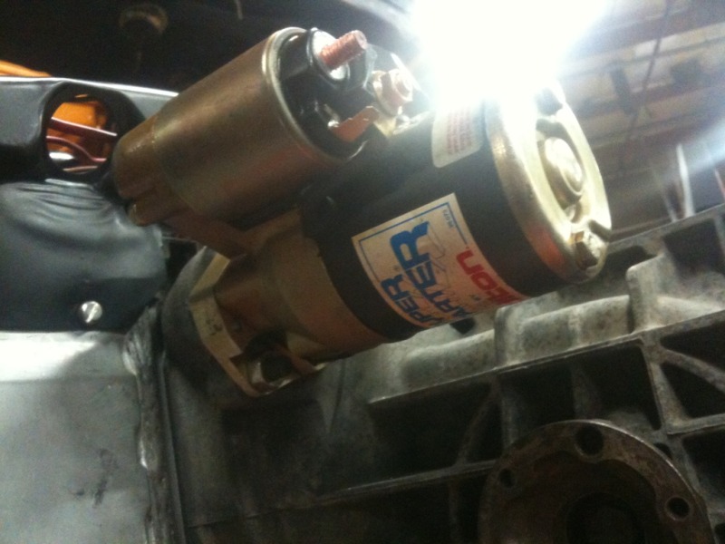

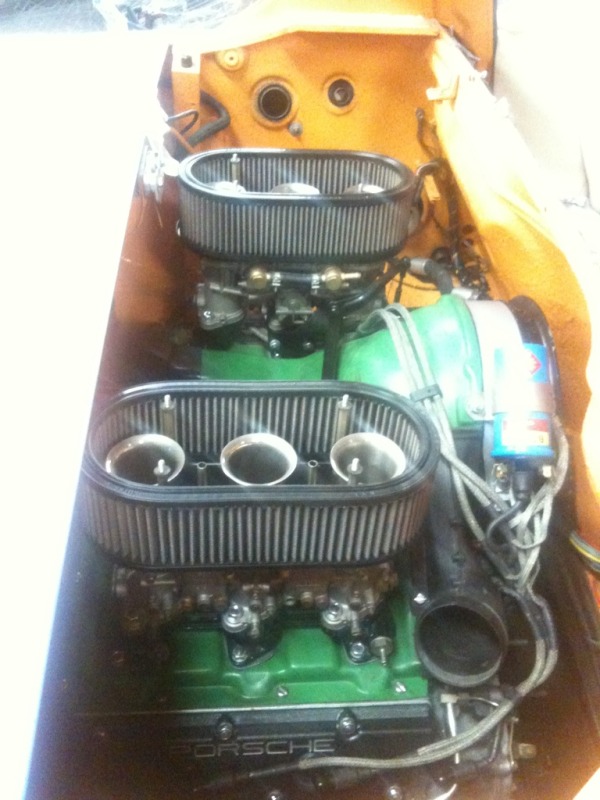

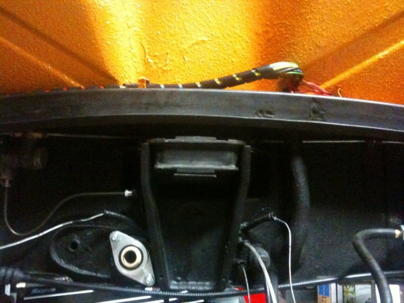

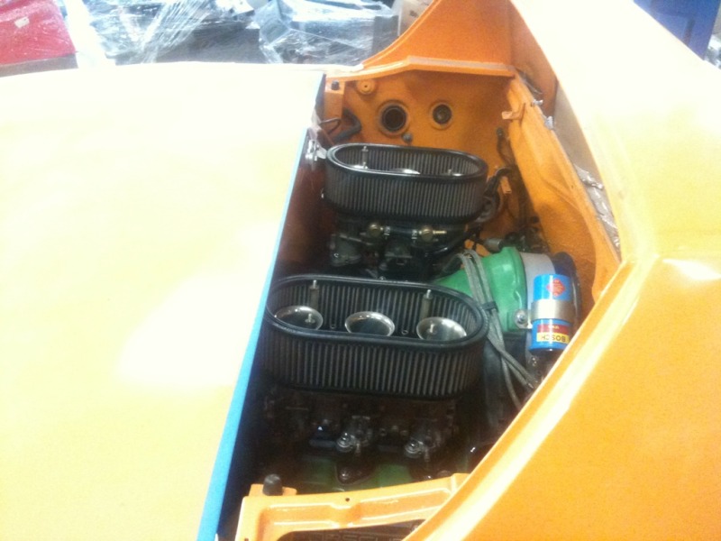

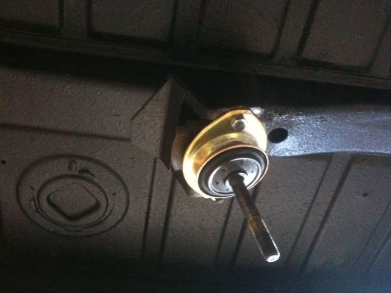

Finally, with the alternator installed, pulley on, and starter on, it was time for the engine to go in the car, right after a quick photo for posterity.
I made sure to put the bolt facing down, I think it's easier to access it and take off the nut if you should need to drop the engine. As for the rear mounting portion, we added new 911 style mounts.
It was actually rather easy to get the /6 in. Using the stock mount, you do not have to take off any sheet metal during your installation.

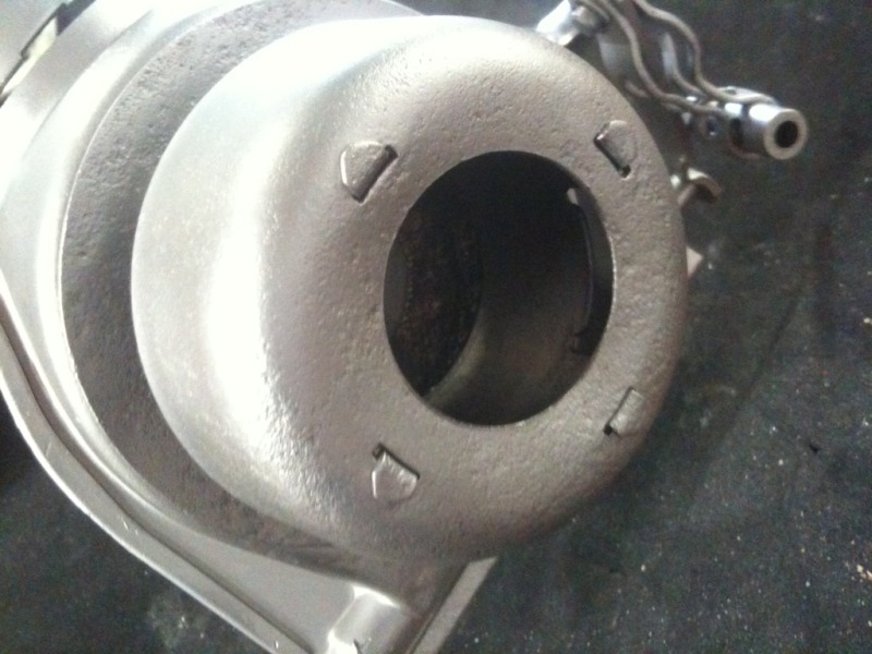

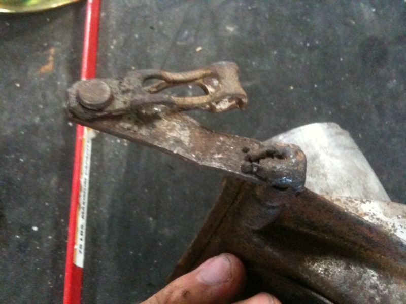

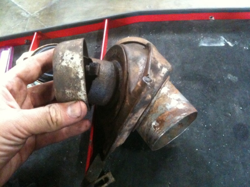

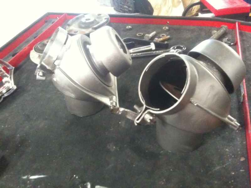

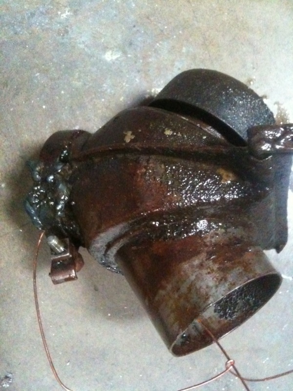

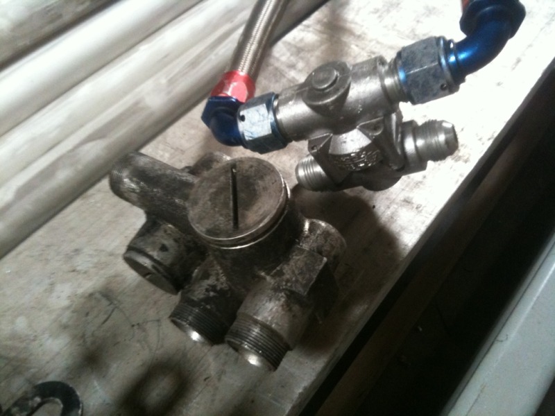

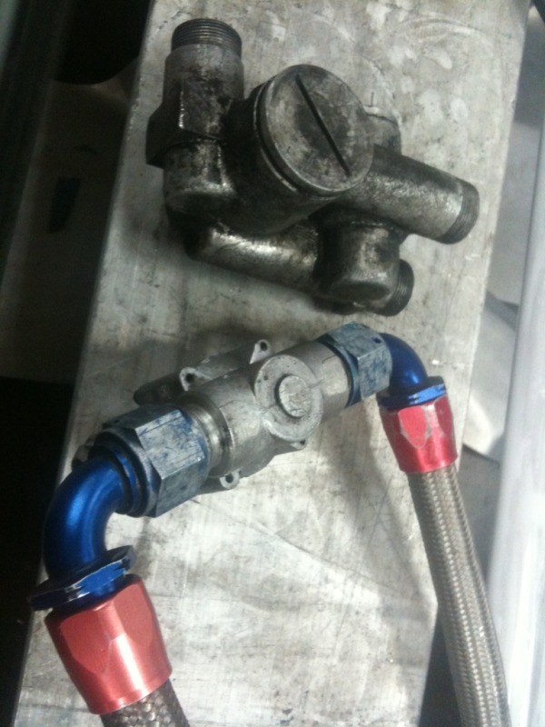

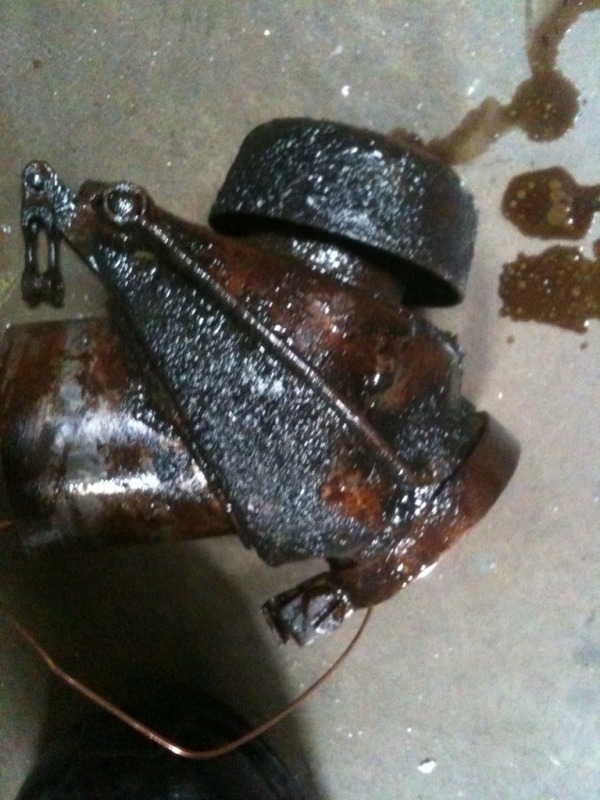

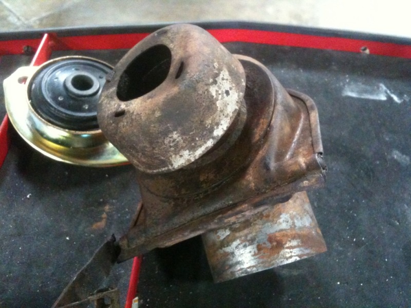

Now that the engine is in, I think i've 'turned the corner' and the project is going to go much faster.

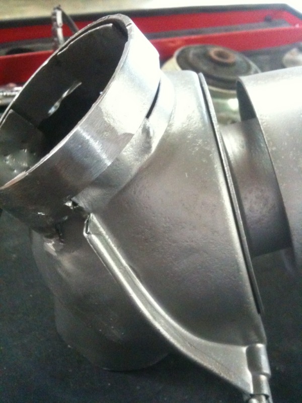

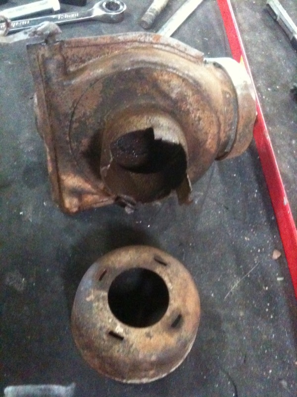

One of my favorite things to do on this project has been to find components of the car that look horrible, torn apart, essentially gone, and bring them back to life. Today, I concentrated on a set of Factory /6 heater flapper boxes I found in storage.
After a bath in the parts cleaner, I pulled them out to discover that while one was alright, the other was in pretty bad shape, having been welded together at one point, the lever bent, and the 'top' coming off.

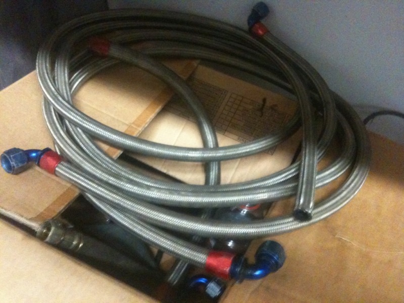

It's time to move on to 'fun stuff'! Like braided lines. I think for now, I'm going to route the oil lines almost as a stock /6, with the exception of adding the thermostat (not sure which one yet). Once I have the car on the road, I'l either add a GT style cooler, or a fan cooler near the transmission. Any opinions on either?

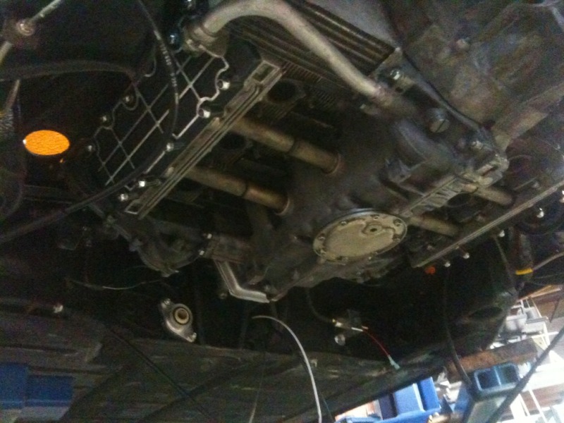

I had a similar instance last month, Mark. I was heading to Vegas, and prior to the trip I was trying to get my car done, with my fall-back being the 3.6 if the 2.9 wasn't finished. Turned out, that I ended up taking the Wagon as some friends needed a ride, but thats not the important part of the story. Somewhere North-East of Riverside, we hit traffic for about an hour, with temperatures at around 105, and I remember thinking to myself, "Wow, I'm gonna need a cooler".
I'm fairly certain that the guy who was running this engine before me (in a 911) had an additional cooler set-up, because the oil line was modified to bend around the back of the engine.

That oil line "bent around the back of the engine" is the stock 911 setup. Think about it!
It didn't go to a cooler .... it went to the oil tank.

Hmm, I always thought it went similar to a /6 on a 911, just without the bend next to the cooler. But then again, I was basing that off of the 3.2 I have on a stand here in the shop.

Now I'm confused, because I just checked on the SC outside, and the oil line is different than the one originally on my engine. I was under the impression that this was the stock setup on a 911, which is similar to a 914, only without the 90 degree bend at the end below the oil tank...
(IMG:http://www.914world.com/bbs2/uploads_offsite/i16.photobucket.com-9478-1312505841.1.jpg)
Whereas the following picture is of the line that was connected to my engine when I got it, it bends and exits under the flywheel and has a 90 turn next to the onboard oil cooler.
(IMG:http://www.914world.com/bbs2/uploads_offsite/i16.photobucket.com-9478-1301325067.5.jpg)
