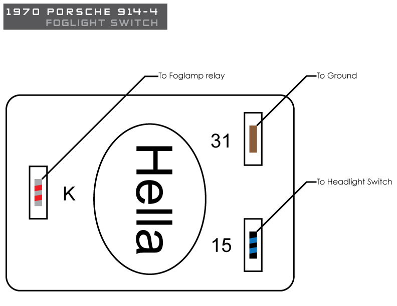

As for the project car, it's really crunch time. I want to have the car on the road in the next month, so I can have 2-3 weeks to clean-up and fine tune everything before Rennsport. I've been hard at work on wiring, and I'm trying to make additional wiring notes and translations for this conversion, as there are a few passing notes and tips, but nothing really on Paper.
The closest I really came was a set of notes Cap'n Krusty sent me, which have been pretty helpful, but other then that, there's not much in the way of something someone can pass on.
Below is an example of what I want to do for a conversion wiring diagram (albeit small), and my hope is that it will help more people in the future with their /6 conversions. I also hope to have other members involved, so that we can make it as accurate as possible.
I want to create diagrams for matching the relay baord to engine function, pin connections, /6 dahs switches, etc.

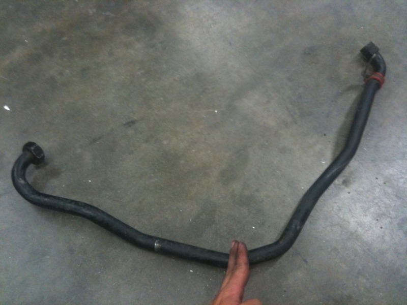

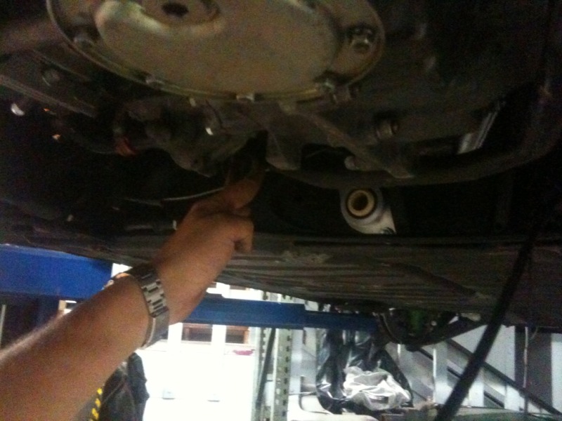

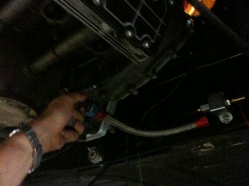

As for the car, I literally have a month before Rennsport, so it's full speed ahead whenever I'm not at work, which is basically from 3pm until 9pm, and even then I'm still 'available' (IMG:style_emoticons/default/dry.gif)

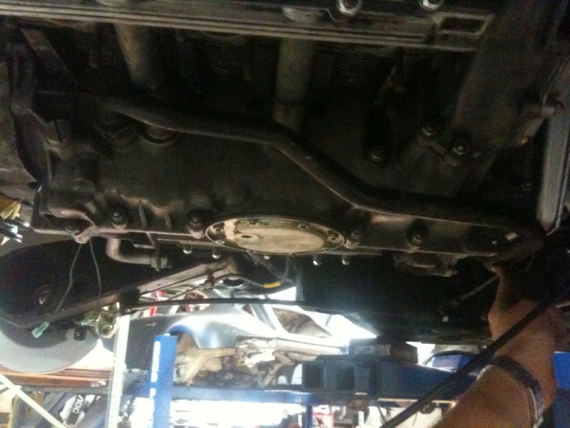

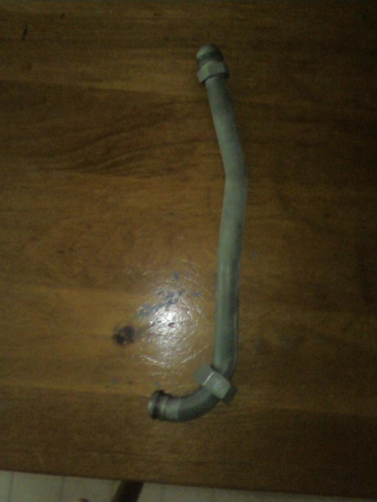

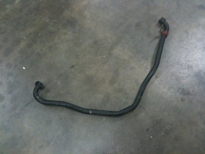

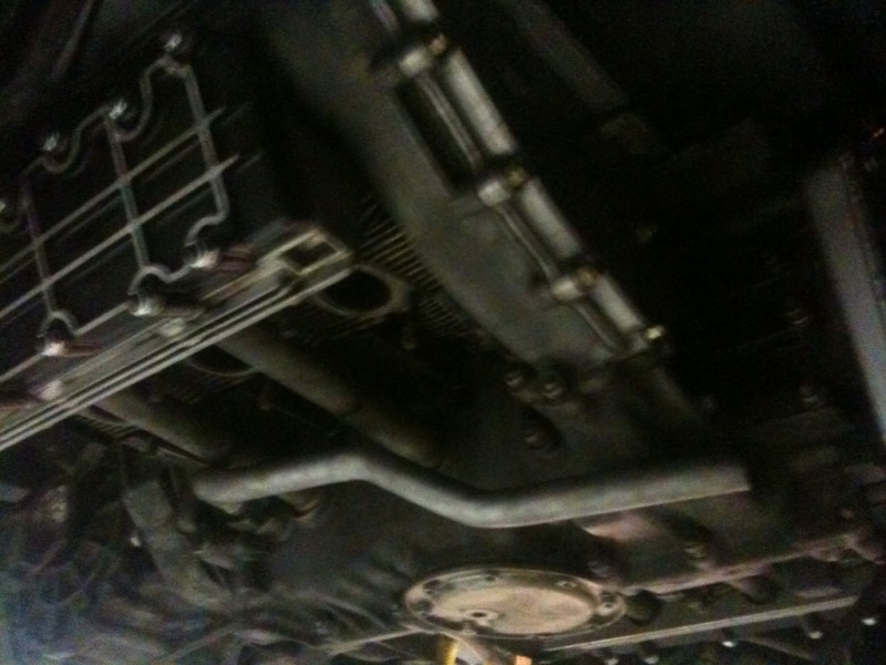

I've been working on the hard oil line for the engine. Originally, I was simply going to get a converter for the oil inlet on the bottom of the engine and run the stock /6 oil line, however, I'm concerned about oil volume, as my engine is a 2.9 where-as the stock /6 was 2.0.
After trying to find a few alternatives, and effectively getting 'blown off' by the guys at Patrick Motorsports, even after I bluntly told them, "Look, what do you recommend? Tell me, and I'll buy it....' I decided to-hell-with-it and I'm making my own. (IMG:style_emoticons/default/bootyshake.gif)
So here we go....
My main issues regarding the hard oil lines are:
-Volume
-Adaptors
-Space limitations (due to me using stock HE's)
-Alignment (clutch cables, shift rods, etc).

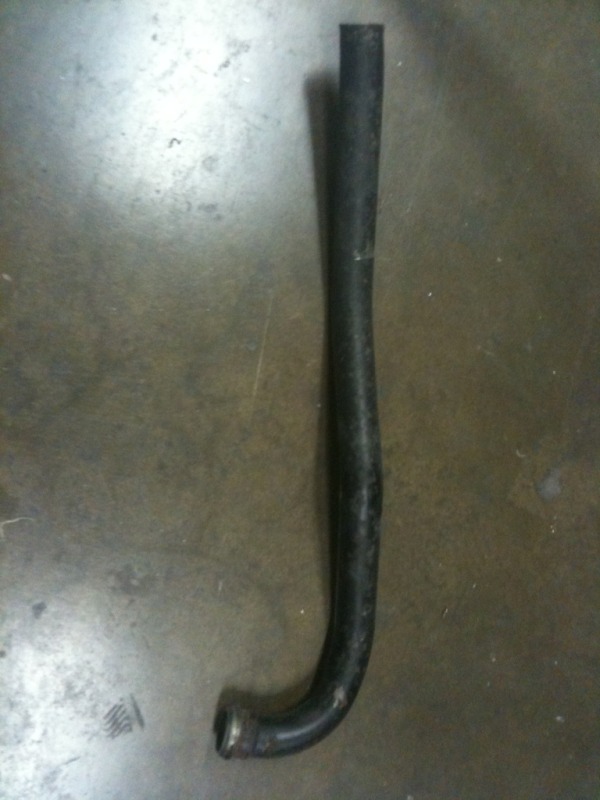

At first, I thought I would simply use braided lines with a 90 or 45 degree connector, as I've seen this done, but that runs me right into the HE's and is really loose. At that point, I realized that many of the photos where I have seen this done, the author of the conversion was running headers, which give you significant more space.
The next approach was using an oil line off a 3.2 engine, as it is the correct fitting to go into the bottom of the engine, and follows a very similar routing to the stock /6. However, this again had issues, as I would have to 'ding in' the HE sheet metal about 1/2' on the left side (acceptable and still maintaining stock look) but more importantly, the tube ran right in front of the shift rod outlet, which killed that plan all-togther.
(IMG:http://www.914world.com/bbs2/uploads_offsite/i16.photobucket.com-9478-1316014959.1.jpg)
(IMG:http://www.914world.com/bbs2/uploads_offsite/i16.photobucket.com-9478-1316014960.2.jpg)
(IMG:http://www.914world.com/bbs2/uploads_offsite/i16.photobucket.com-9478-1316014960.3.jpg)

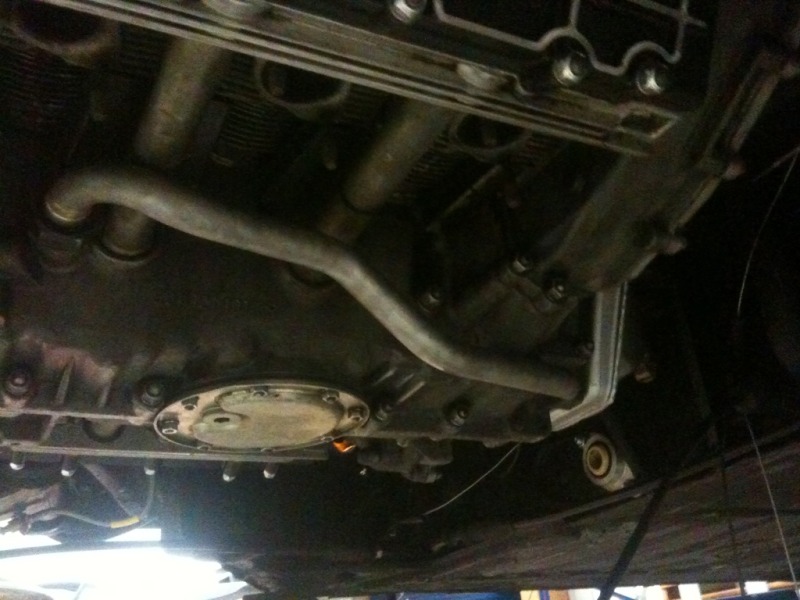

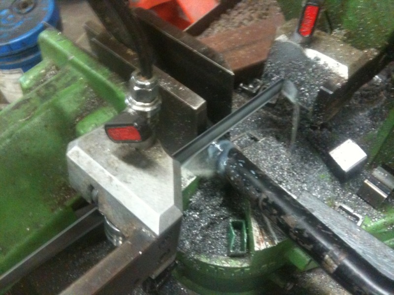

Just before I was about to say 'screw it' and go with headers, I resolved to try a hybrid idea by cutting the bigger oil line shorter just below the chain tensioners, welding a fitting onto the end (an adaptor for braided lines) and running the braided line to a thermostat mounted on the body on the passenger side, in preparation for when I eventually put in an oil cooler. For the time being, the thermostat ( which will be located where the Fuel Pump is currently, see pictures) will have one line going into it from the oil tank, then a 'U-turn' on the other side, to redirect to the exit, where it will go into the engine.
I'm not completely finished, as I have to weld on the fitting today, however, I've cut the tube, rolled in the HE sheet metal, and mocked everything up. OFr good measure, I sandblasted and rinsed out the oil line and had it sitting overnight in the part cleaner to get rid of any metal scraps, gunk, or sand.
(IMG:http://www.914world.com/bbs2/uploads_offsite/i16.photobucket.com-9478-1316014960.4.jpg)
(IMG:http://www.914world.com/bbs2/uploads_offsite/i16.photobucket.com-9478-1316014961.5.jpg)
(IMG:http://www.914world.com/bbs2/uploads_offsite/i16.photobucket.com-9478-1316014961.6.jpg)
(IMG:http://www.914world.com/bbs2/uploads_offsite/i16.photobucket.com-9478-1316014961.7.jpg)
(IMG:http://www.914world.com/bbs2/uploads_offsite/i16.photobucket.com-9478-1316014962.8.jpg)
(IMG:http://www.914world.com/bbs2/uploads_offsite/i16.photobucket.com-9478-1316014962.9.jpg)
(IMG:http://www.914world.com/bbs2/uploads_offsite/i16.photobucket.com-9478-1316014963.11.jpg)

So................... was it fun building that line? So much fun that you are just craving to build another one?
(IMG:style_emoticons/default/wink.gif) (IMG:style_emoticons/default/bye1.gif) (IMG:style_emoticons/default/biggrin.gif)
Had a similar experience with PM last month. All I wanted to know was if they could build thier short hard line with a metric fitting where it meets the soft line. Tried 3 times - no call back.
I want things nice and tidy undernieth, and I am concerend about having a soft line next to the headers, or having it sag.
All joking aside, if you are interested in making another, I would love to chat with you about it.
Great work!

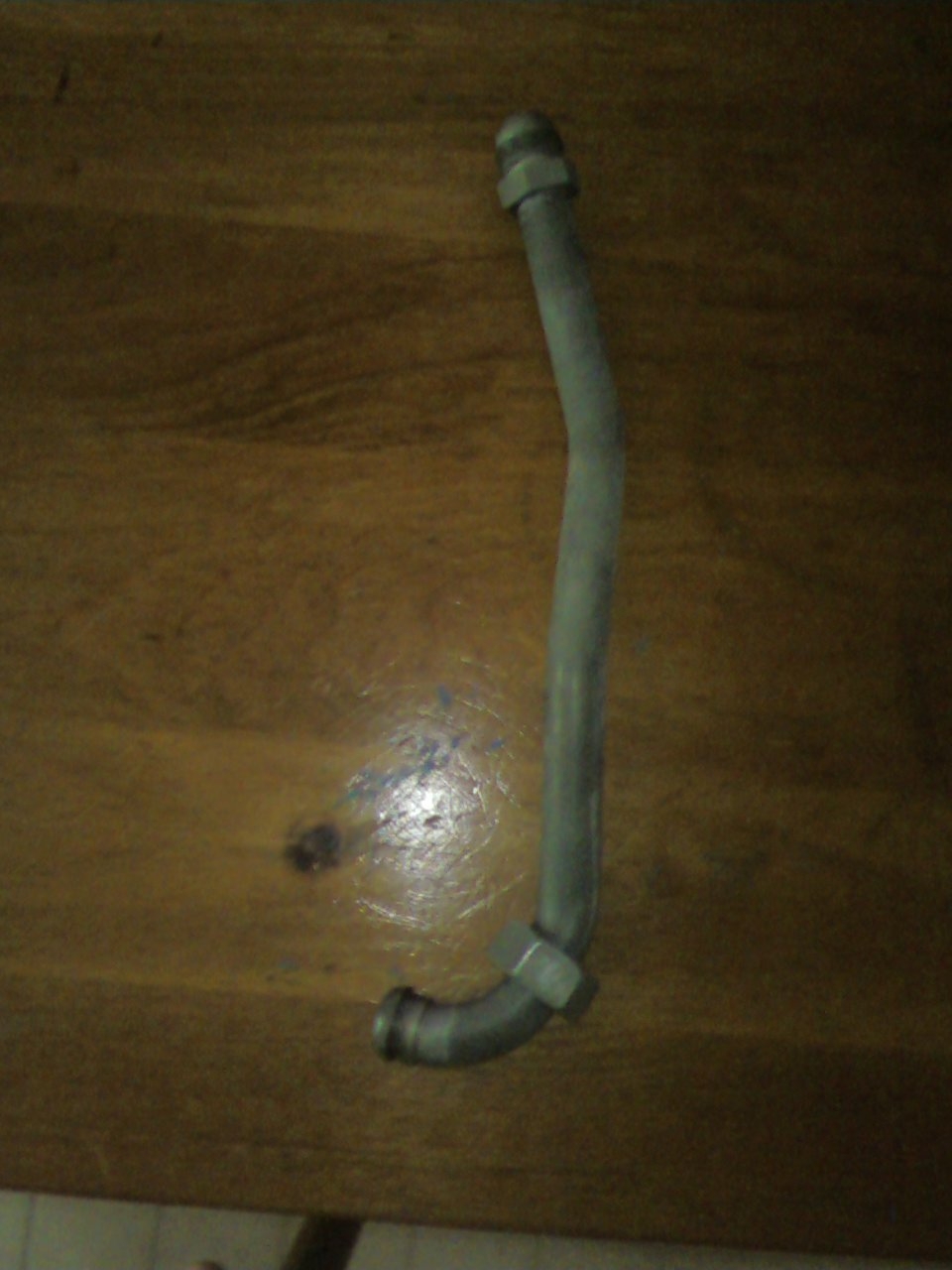

QUOTE(RiqueMar @ Aug 5 2011, 06:20 PM) *
QUOTE(SLITS @ Aug 5 2011, 05:44 AM) *
They changed the orientation with the SC.
You want a stock 914/6 hard line? .... have one in the garage.
I actually do have one, but I'm concerned about the line diameter, my reason being that the original /6 was a 2.0, whereas mines a 2.9, thus the conversion to braided...
Any thoughts?
And by the way.... Now that the engine is in, can I finally pop this on? I've had it for about 2-3 years!
(IMG:http://www.914world.com/bbs2/uploads_offsite/i16.photobucket.com-9478-1312582816.1.jpg)
I have one set aside too. (IMG:style_emoticons/default/smile.gif)

Here's a PMS 914-6 oil line. It was listed for $38 on ebay so I bought it. I think it was supposed to be $138. I think it could be made locally. I've called PMS before and Jim Patrick called back and sent info I asked for. Seemed very nice and patient with me on the phone.
Still wondering if the stock 914-6 hardline will work with a 3.2? Since the Cararra line is bigger, I'm thinking not but I have heard no real world experience or wisdom...
