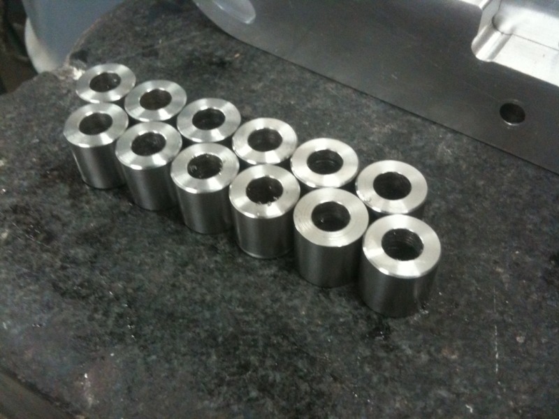

As far as exhaust goes, I finally produced a set of SS 'spacers' to make up for the difference in exhaust systems between the 911 SSI's and the stock /6 exhaust. A word to the wise, make sure to use thread compound as those nuts/barrel nuts will be Hell to get off.
(IMG:http://www.914world.com/bbs2/uploads_offsite/i16.photobucket.com-9478-1321647884.1.jpg)
(IMG:http://www.914world.com/bbs2/uploads_offsite/i16.photobucket.com-9478-1321647885.2.jpg)
(IMG:http://www.914world.com/bbs2/uploads_offsite/i16.photobucket.com-9478-1321647885.3.jpg)

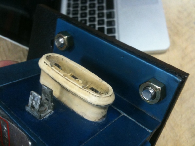

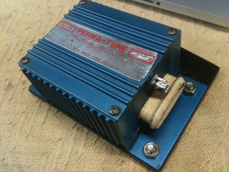

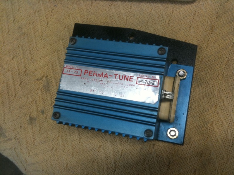

In reference to the CDI box, I'll be mounting a Permatune unit in the stock location for the /6 (which is the location for the FI unit in a /4). I've fabbed up a nice unit because, unfortunatly, I can't find the original /6 part that I have....
(IMG:http://www.914world.com/bbs2/uploads_offsite/i16.photobucket.com-9478-1321648071.1.jpg)

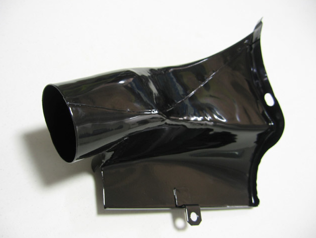

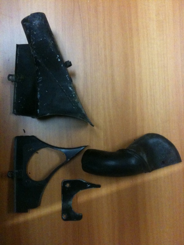

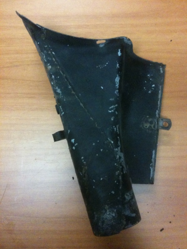

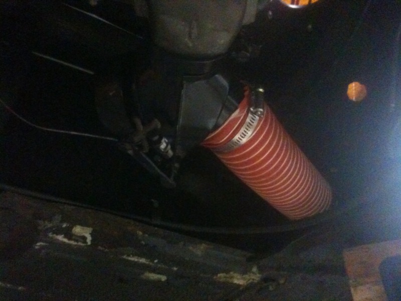

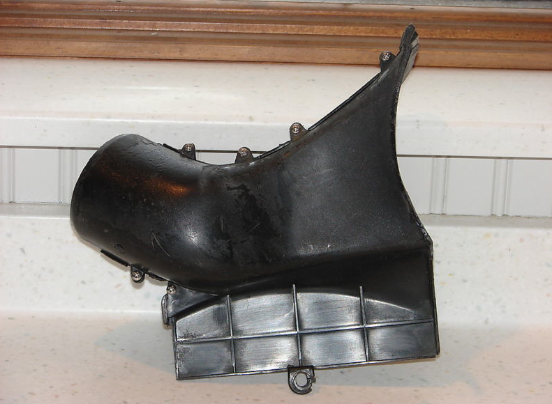

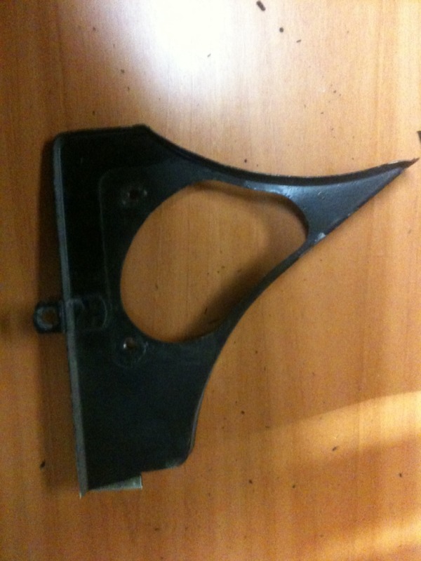

Ok, small update and a 'don't make my mistake' advisement for anyone reading this, in reference to the heating system.
In post-1974 engines, the heating system is a tad bit different in means of flow. For those of you running headers, this post really doesn't apply; slap some air block off plates, and you're set. For those of you that are a wuss like me, and need heat even here in SoCal, read on.
Unless you fab up a sort of warm air guide on each side of you're fiberglass shroud, you'll need to find a set of early warm-air guides (atleast in cases similar to mine, where you're running a post-74 engine, and stock /6 heat exchangers). If you're handy and confident (get it handy and confident? (IMG:style_emoticons/default/jerkit.gif) ) you can probably easily adapt the drivers side 911 block off plate with a 90 degree tube to match the left-side heat exchanger. All thats required is to drill a hole, and weld in the bended tube. However, the passenger side is a bit more tricky, as it came with a plastic warm air guide, and fabing up a block off plate may prove difficult as the distributer is right infront of said outlet. Luckily, the early style block off plate bolts right on. They can be had over at Pelican Parts, however, it's a bit pricey ($90), especially for us young-ones who are fiscally impaired at the moment. Should you need one, I recommend posting a WTB in the classified here or over at Pelican in the 911 section.
I've posted pictures below of the differences between early and late warm air outlets, as you can see, the hole diameter is a bit larger on the later style...
(IMG:http://www.914world.com/bbs2/uploads_offsite/i16.photobucket.com-9478-1321832341.4.jpg)

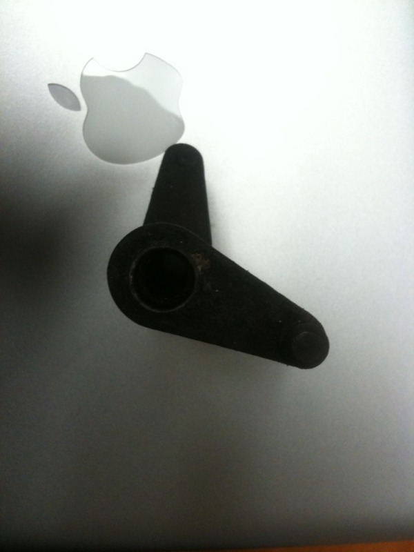

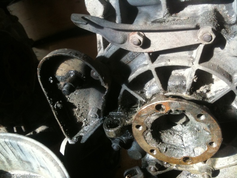

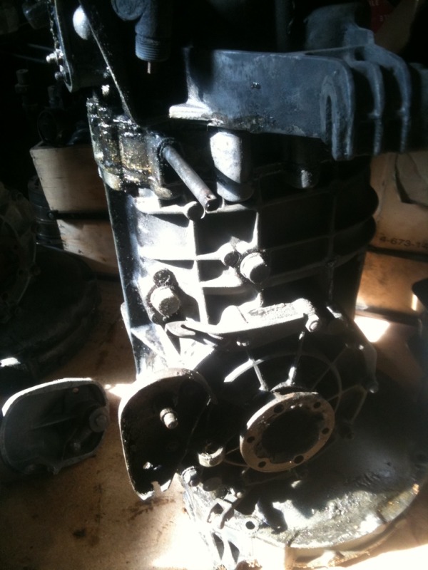

Had a bit of free time today, stopped by the storage area to check out the accelerator cable situation on a /6, and happend to find a bellcrank! Although I think it's to a 911, I'm fairly certain I can cut and readjust the angle.
/6 gurus: Do I need the small drop-down bar that I see bolted to the transmission just above the clutch pulley?
(IMG:http://www.914world.com/bbs2/uploads_offsite/i16.photobucket.com-9478-1322277876.1.jpg)
(IMG:http://www.914world.com/bbs2/uploads_offsite/i16.photobucket.com-9478-1322278086.1.jpg)
(IMG:http://www.914world.com/bbs2/uploads_offsite/i16.photobucket.com-9478-1322277877.2.jpg)
(IMG:http://www.914world.com/bbs2/uploads_offsite/i16.photobucket.com-9478-1322277877.3.jpg)

(IMG:style_emoticons/default/icon_bump.gif) for bellcrank and accelerator questions; it looks as though the one I found yesterday has an angle just abit more the 90 degrees, while a 911 one is about or less than 90 degrees, could I have ACTUALLY have found one of the parts I need?! Also, I see that on a /6, the bellcrank stud is drilled into the Intermediate plate, however my side shift does'nt have a spot for this, can I drill it anyway?

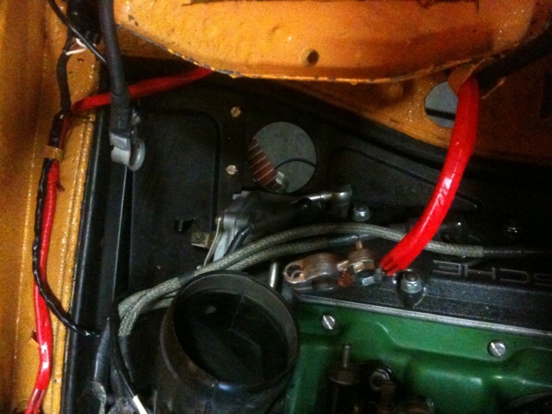

Been a little bit of time, but I'm finally getting in some of the stuff that I needed to finish the engine and get a test run going....
Much to the constant goading of Brent (wertygrog) I finally bought a CB rotary fuel pump (about $70) after everything is said and done. This weekend, I'll be relocating it to the front trunk, and running a new set of SS Fuel lines (if I can ever figure out how to get them into the tunnel.
Also, I've purchased an older set of warm air guides. I want to use the stock set-up as it was in the real /6's. They are a little rough, but nothing a little sandblasting, shaping, and coating wont fix....

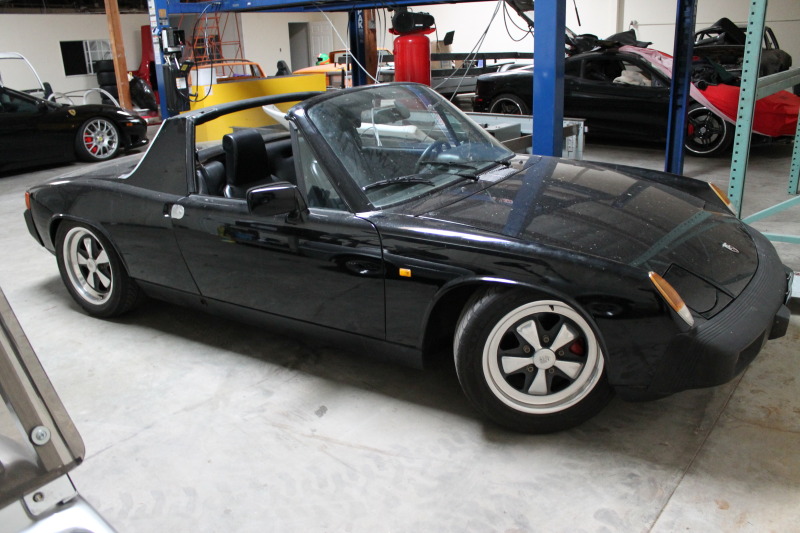

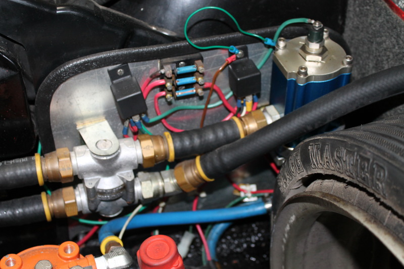

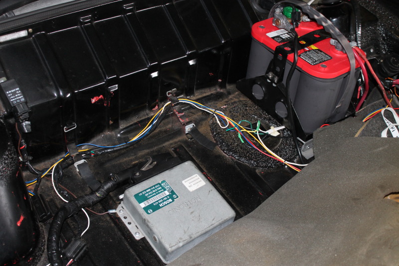

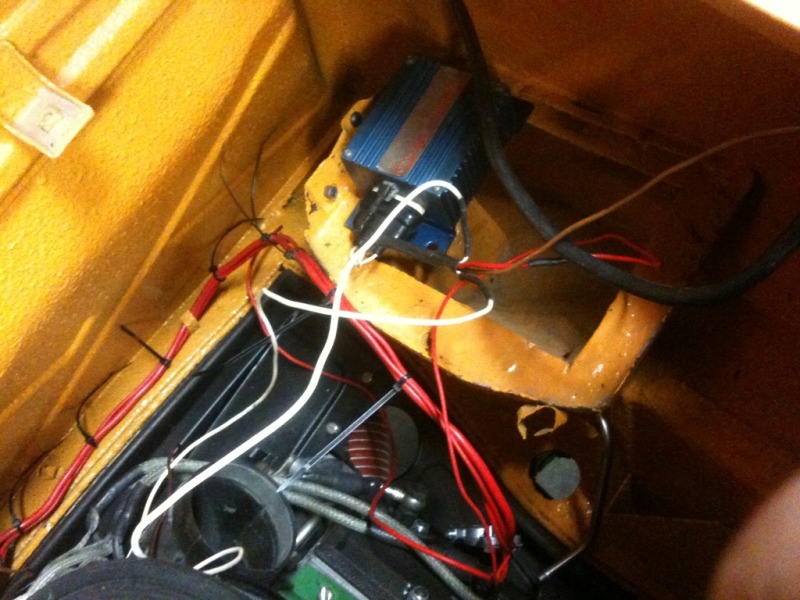

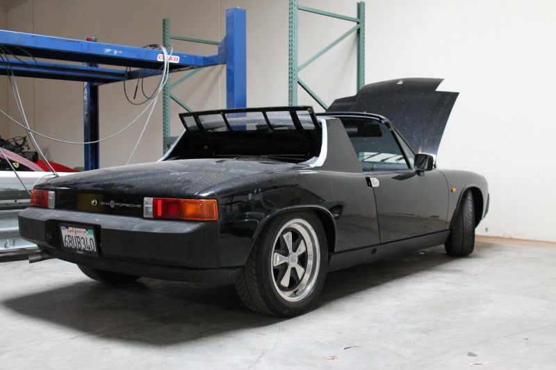

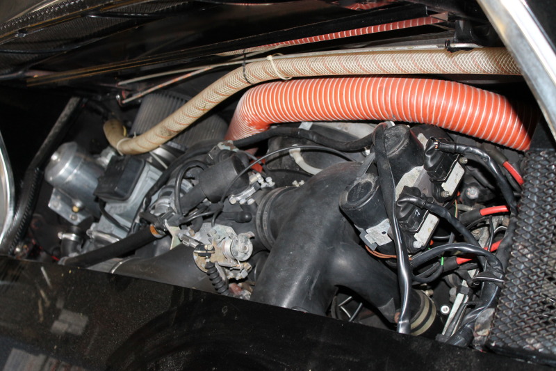

Ok, so here we go with 'Projekt 3.6'. For the last week or so, I've been gathering up information, reading conversion threads, and trying to get a whole bead on how I'm going to tackle this thing.
I really, really hope to have this done for The Route 66 Classic and drive it out there!
So far, this is how the black car sits right now. I'm doing my best to document everything from pulling out my 2.9 to putting in the 3.6. Although the car and work is a little rough around the edges, the logic and the implementation is pretty well executed. A little clean up, powder coat and some organization, and I think this will look great in my car!
(IMG:http://www.914world.com/bbs2/uploads_offsite/i16.photobucket.com-9478-1326762297.1.jpg)

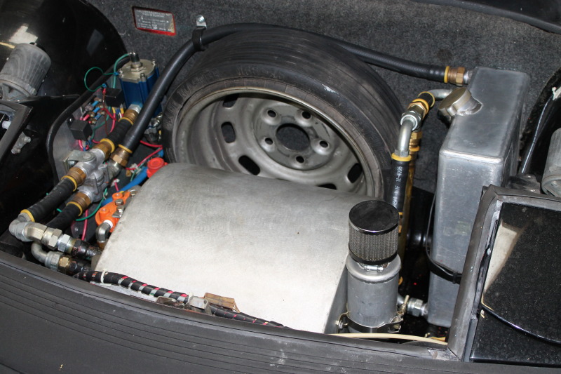

What's the story on that oil tank in the front of the black car?
It's kindda cool, how/where is it filtered?
Some really cool parts on that car!
RiqueMar
post Jan 17 2012, 12:16 AM
Post #597
Enrique Allen Mar
Posts: 2,264
Joined: 28-August 08
From: San Diego, CA
Member No.: 9,478
QUOTE(JmuRiz @ Jan 16 2012, 06:55 PM) *

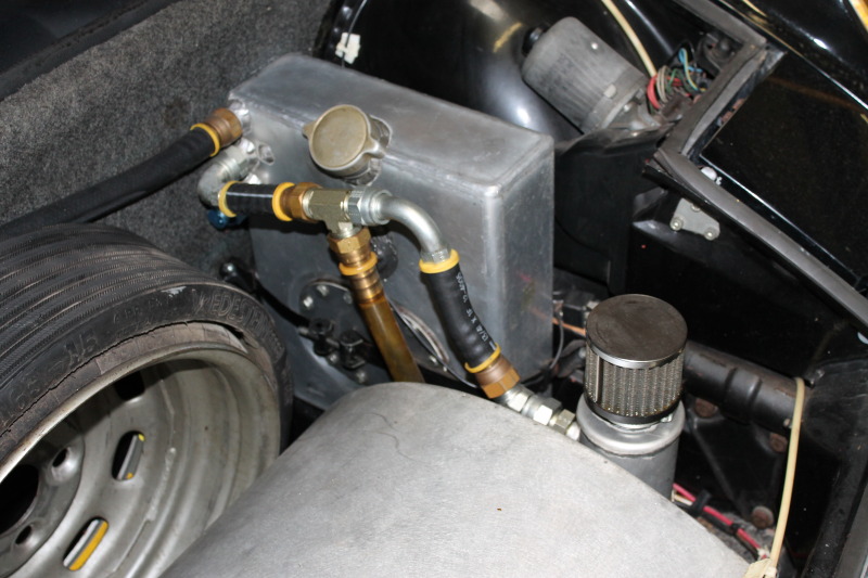

Car was used very much for AutoX, if I remember correctly, I believe having the tank up front freed up engine bay space for hoses, and acted as a bit of weight distribution.
The oil cooler setup is awesome, the only thing I do not like is that the oil lines run through the drivers dead pedal like the GT's, I'm going to try to work around that. Other than that, it's a great setup and never gets too hot, and I've been in Vegas/Utah in August as well as at Rennsport in traffic on a hill, awesome setup. Even has a mech to disable the system in a crash!
Thanks Nathan! Can't wait to dig in!

Good to know it doesn't get hot, always a plus.
If you find the name/size of the tank let me know. I have a full Patrick Motorsports oil-tank setup I have yet to install, but if I can make something work for less $$ I'd give it a try.
I'll let you know in the coming weeks. If your interested, I'de rather see it go to someone who could use it rather than it collect dust. I'm fairly certain it's custom, so no name/size reference here. I already have a factory tank installed with the holes cut, otherwise I'de be using it, it's a very good system, I just don't like feeling the oil lines beneath my foot.
