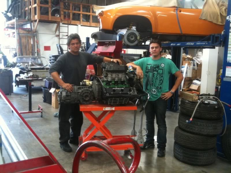

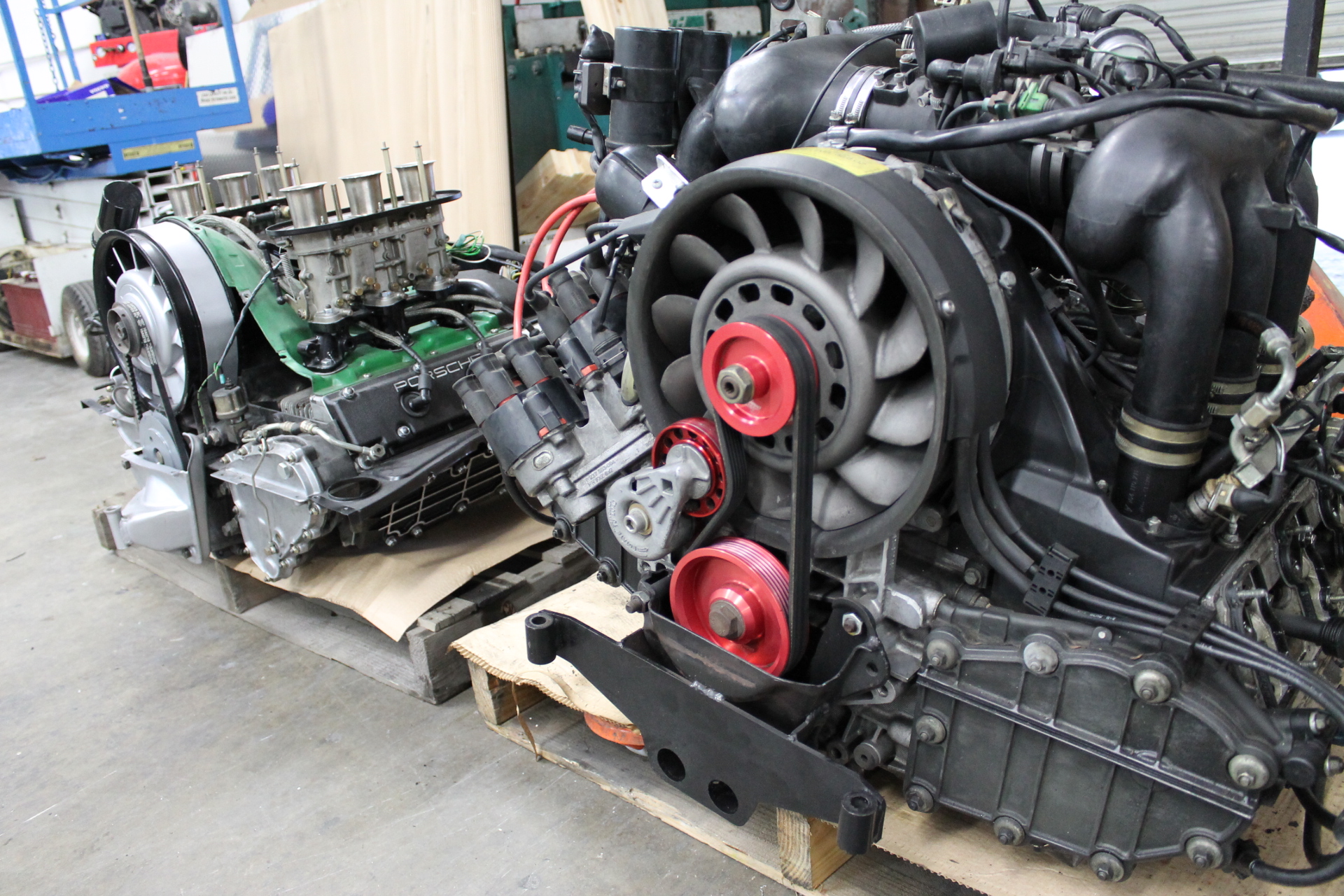

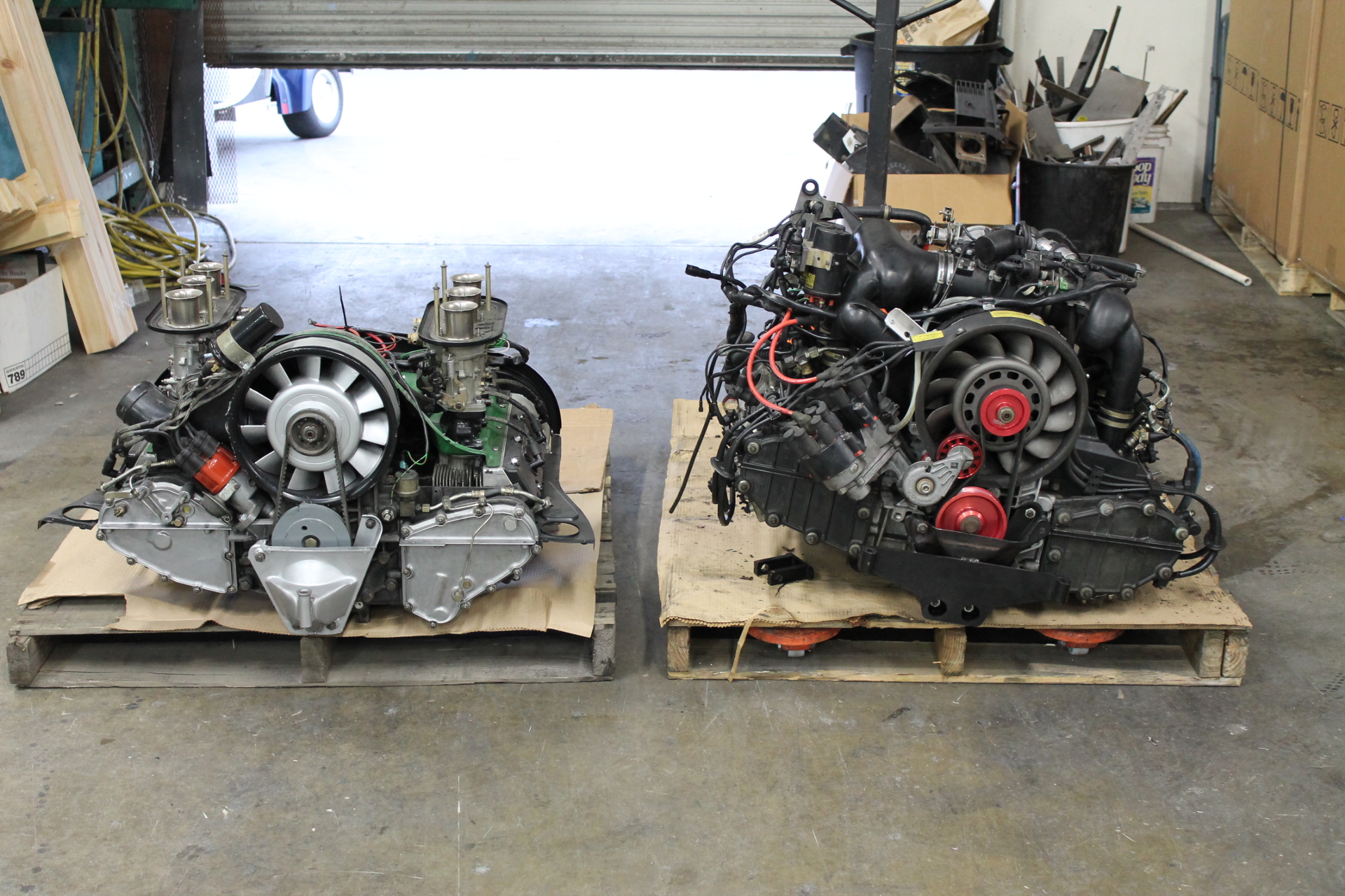

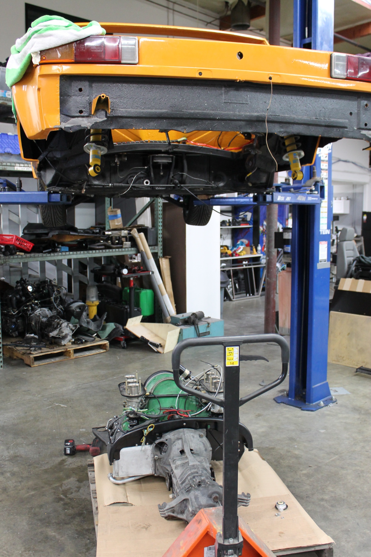

Lol. I'll see what is to become of the HE's. There's talk of putting my engine in the black car as it's already 80% a race car. Should we go that route, I'm doing headers, race prep, fiberglass bumpers, etc.
My car is once again on the lift, and now begins the assembly process. Not gonna lie, it makes me kinda sad to not use the 2.9 that, in my opinion, looks beautiful with all the work that went into it. The carbs, fan shroud, valve covers, etc.

It's been 3.5 years and you have a full blown shop. Put something in the car and get 'er done!

How's this for 'Get er' done!' (IMG:style_emoticons/default/smash.gif) (IMG:style_emoticons/default/smash.gif) (IMG:style_emoticons/default/smash.gif)

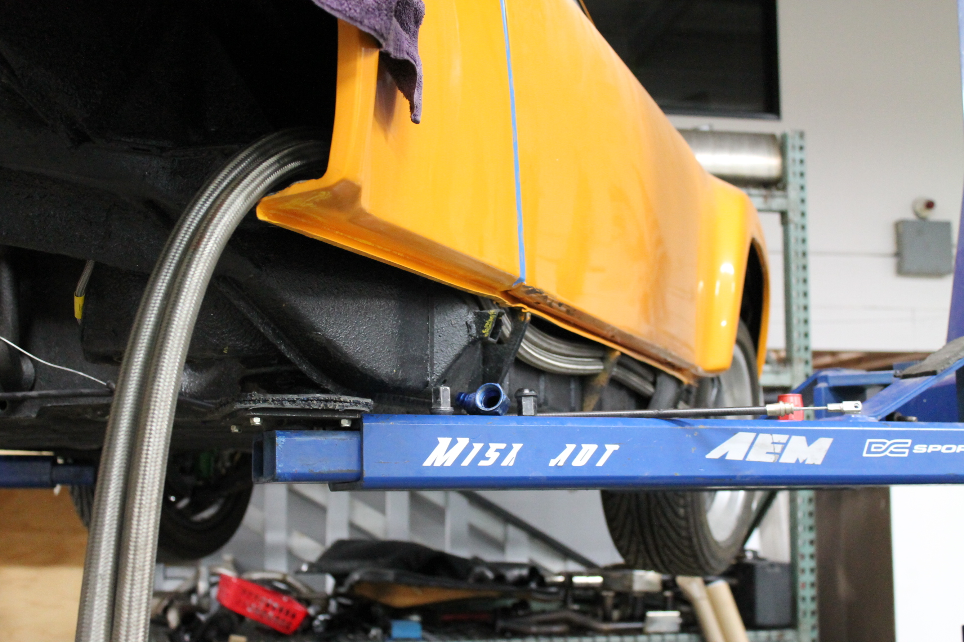

Now I'm focusing on the oil lines. Running them up front, and in the engine bay. It's irrelevant at this point which oil cooler setup I'll be using, my my concern is making the lines work from the front wheel back.
Elephant Racing setup (IMG:style_emoticons/default/drooley.gif) (IMG:style_emoticons/default/drooley.gif) (IMG:style_emoticons/default/drooley.gif) But alot of $$$$$

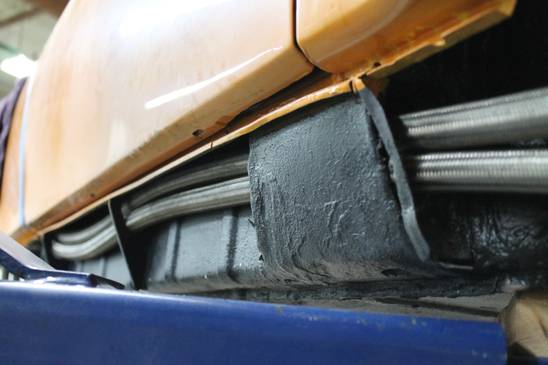

Unfortunately for guys my age, we are usually 'fiscally impaired', so I'll have to use some extra braided lines instead of hard lines. Is there a problem with this? I still plan on mounting them to the body to have 'straight' lines. In a certain aspect, I'de think 'soft' lines would be better for vibrations. Thoughts? Is there a good reason not to do this?
I think these are -12..... I also hope they'll be big enough!

braided lines are fine.. you may want to get a gasket in around the lines as they pass thru the 'long' holes, and perhaps install some adel clamps to keep them apart (for the same reason).

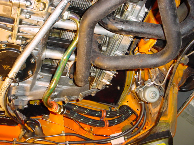

Do you have a pic of where the lines pass into the front wheel well and enter the front trunk? I ask because I'm planning a similar route for my lines -- all flex hose.

Hey Rich, I'm not quite there yet, my biggest concern right now is routing the lines in the Pass. side longs, and in the engine bay. I'm still waiting on my oil cooler, so I'm thinking I'll tackle that end of this week/early next week.
I'm still not quite sure how I'm going to route the lines inside the wheel well, as I like my car really low (occupational hazard of being Mexican). I'll have to check out how others have done it, but I believe they go along the side of the wheel well, or inside the cabin (slightly) and through the gas tank area.
AZ:
Most definitely. I'm going to try to get out to a supplier today and see what they have. At a minimum, I figure I'll need 3-4 2x adel clamps and need to fab up a sort of bracket to hold the Carrera thermostat. I don't believe the 911's needed them, as they used hard lines.
Work, work, work for Route 66! (IMG:style_emoticons/default/smash.gif) (IMG:style_emoticons/default/smash.gif) (IMG:style_emoticons/default/smash.gif)
