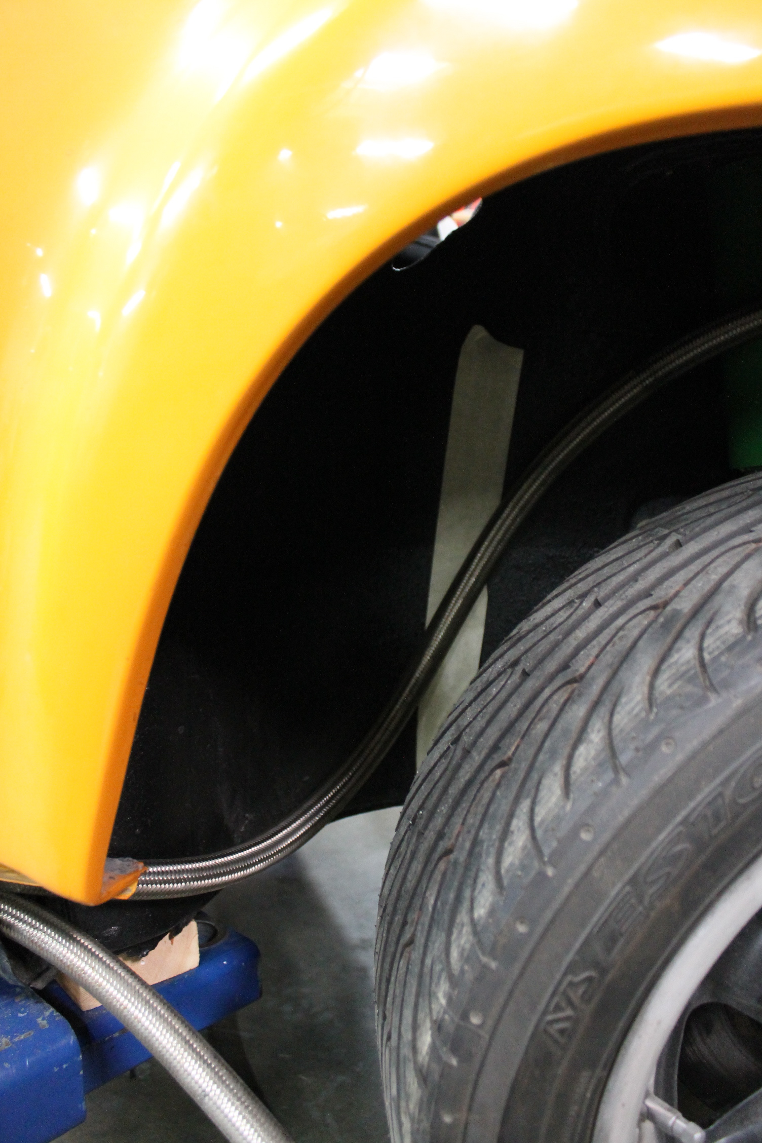

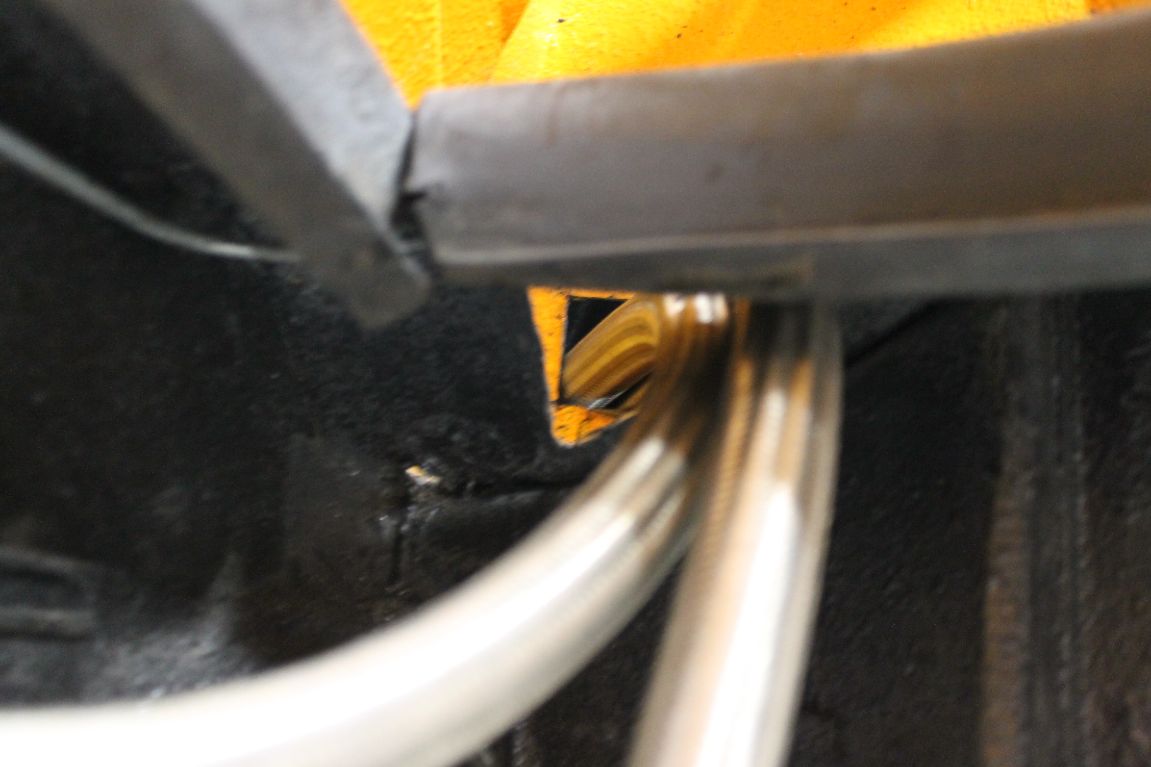

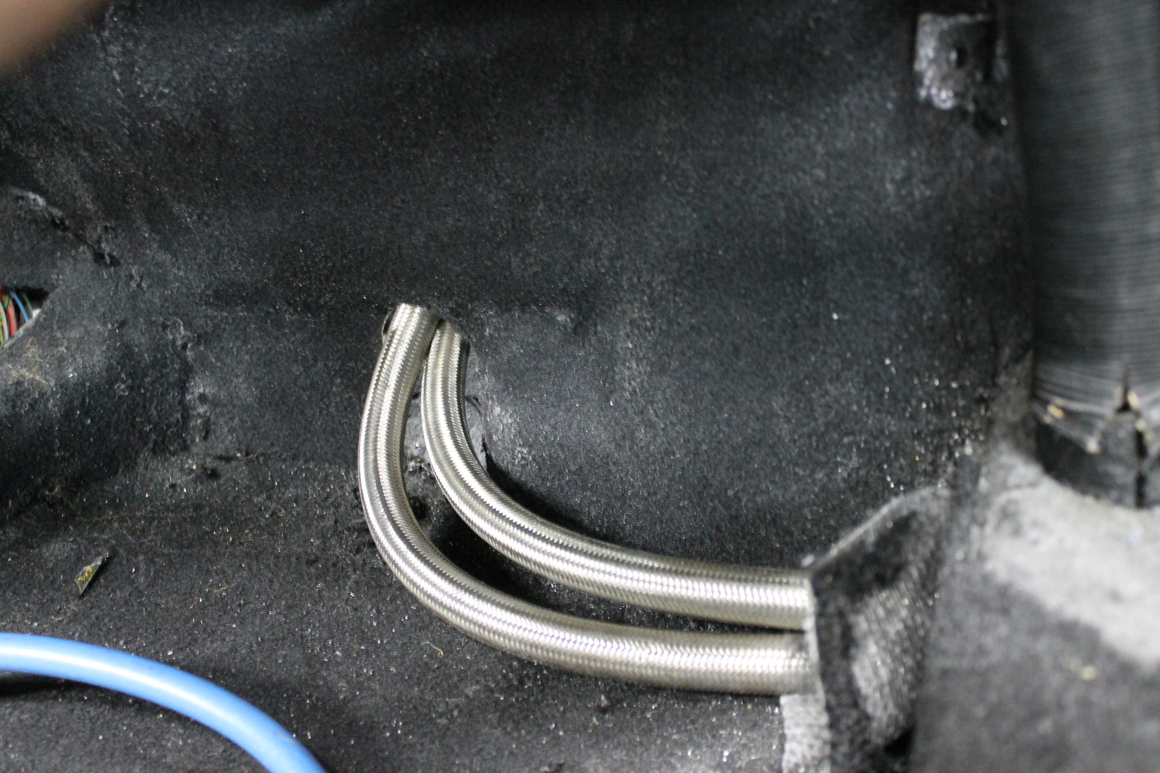

Oil lines pretty much run, however, my only concern now is how to run them in the front wheel well. I'm super paranoid about the wheel hitting and digging into the lines, so I think I'm going to run them in the gas tank area and through the front firewall.

I'd definitely secure them in the well.. I know there are lots of pictures out there.. maybe SirAndy's ?

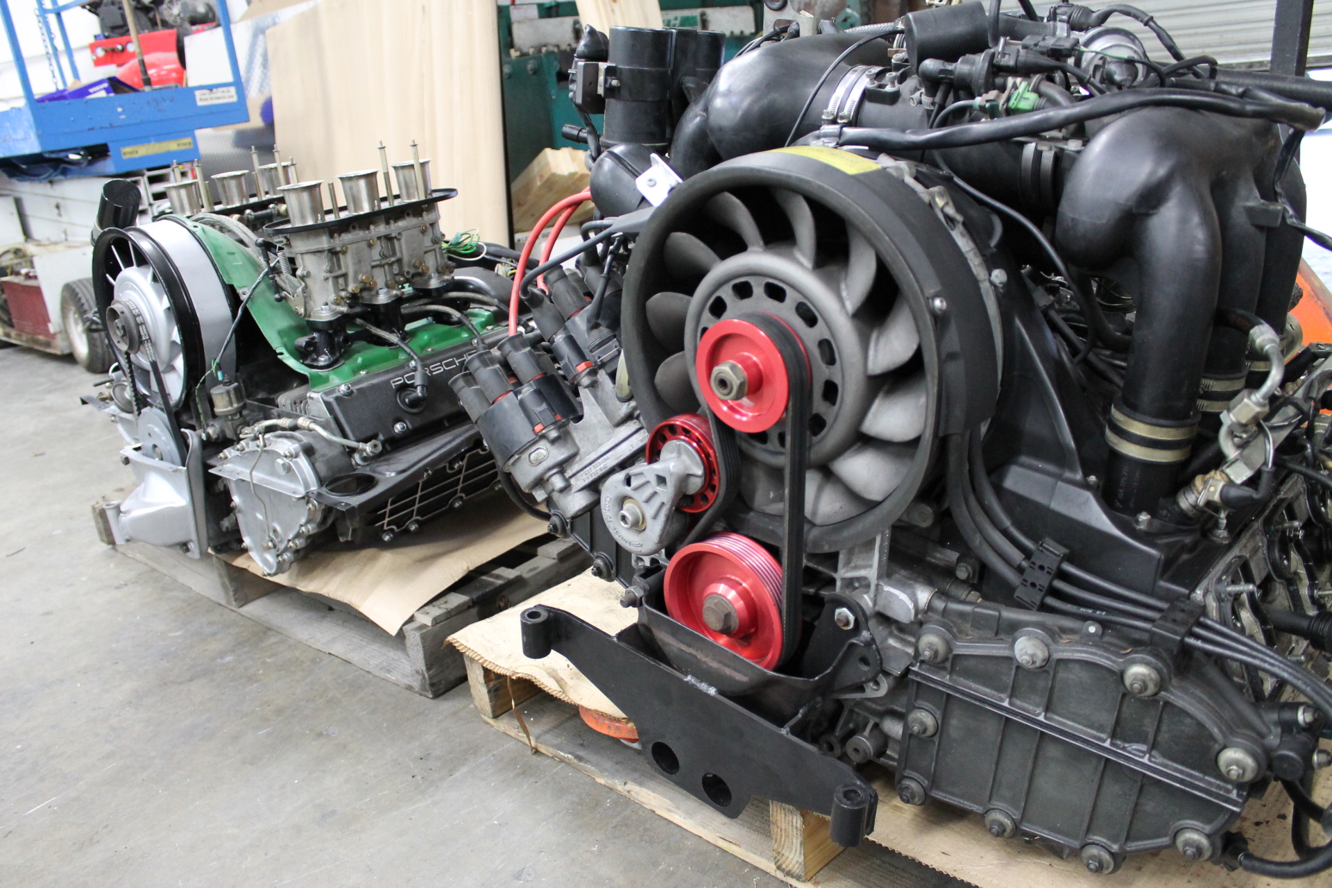

Late night build question for anyone still up; Can I use an early fan pulley system on the 3.6? The Clewett Engineering serpentine belt wont fit inside my stock motor mount. (IMG:style_emoticons/default/dry.gif)

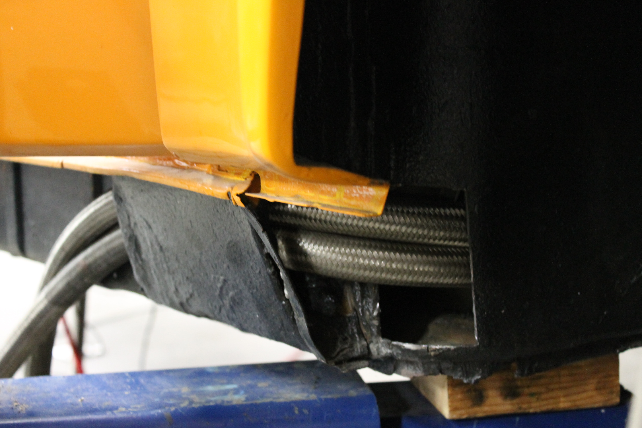

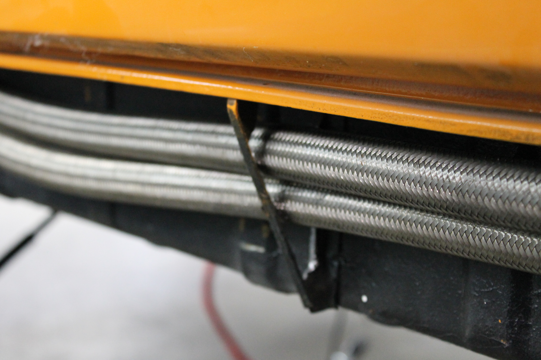

Well.... The issue of 'how do I route these oil lines' is pretty much solved.....
(IMG:style_emoticons/default/sawzall-smiley.gif) (IMG:style_emoticons/default/sawzall-smiley.gif) (IMG:style_emoticons/default/sawzall-smiley.gif) (IMG:style_emoticons/default/sawzall-smiley.gif) (IMG:style_emoticons/default/sawzall-smiley.gif) (IMG:style_emoticons/default/sawzall-smiley.gif) (IMG:style_emoticons/default/sawzall-smiley.gif) (IMG:style_emoticons/default/sawzall-smiley.gif) (IMG:style_emoticons/default/sawzall-smiley.gif) (IMG:style_emoticons/default/sawzall-smiley.gif) (IMG:style_emoticons/default/sawzall-smiley.gif) (IMG:style_emoticons/default/sawzall-smiley.gif) (IMG:style_emoticons/default/sawzall-smiley.gif) (IMG:style_emoticons/default/sawzall-smiley.gif) (IMG:style_emoticons/default/sawzall-smiley.gif) (IMG:style_emoticons/default/sawzall-smiley.gif)
I was sort of wondering about the oem mount...
If you use the early fan, will the alternator have enough umph for the dual plugs? I guess now you have to go BIG on the front cooler since it's the only one.
Maybe the Ferrari engine will fit (IMG:style_emoticons/default/laugh.gif)

I was probably explaining my problem wrong, but I'm not looking to use the early fan, but rather just the pulley system that goes from the crank to the fan OR I need to get my hands on a stock crank pulley and take it down on the lathe.

Not sure if it's just the near/far perspective, but that new 3.6 looks huge next to your old engine.
BTW what was the base for the old motor and what size is it?

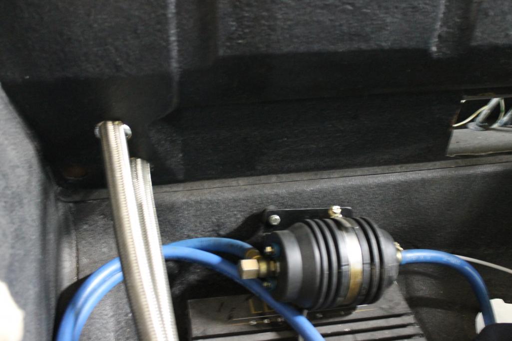

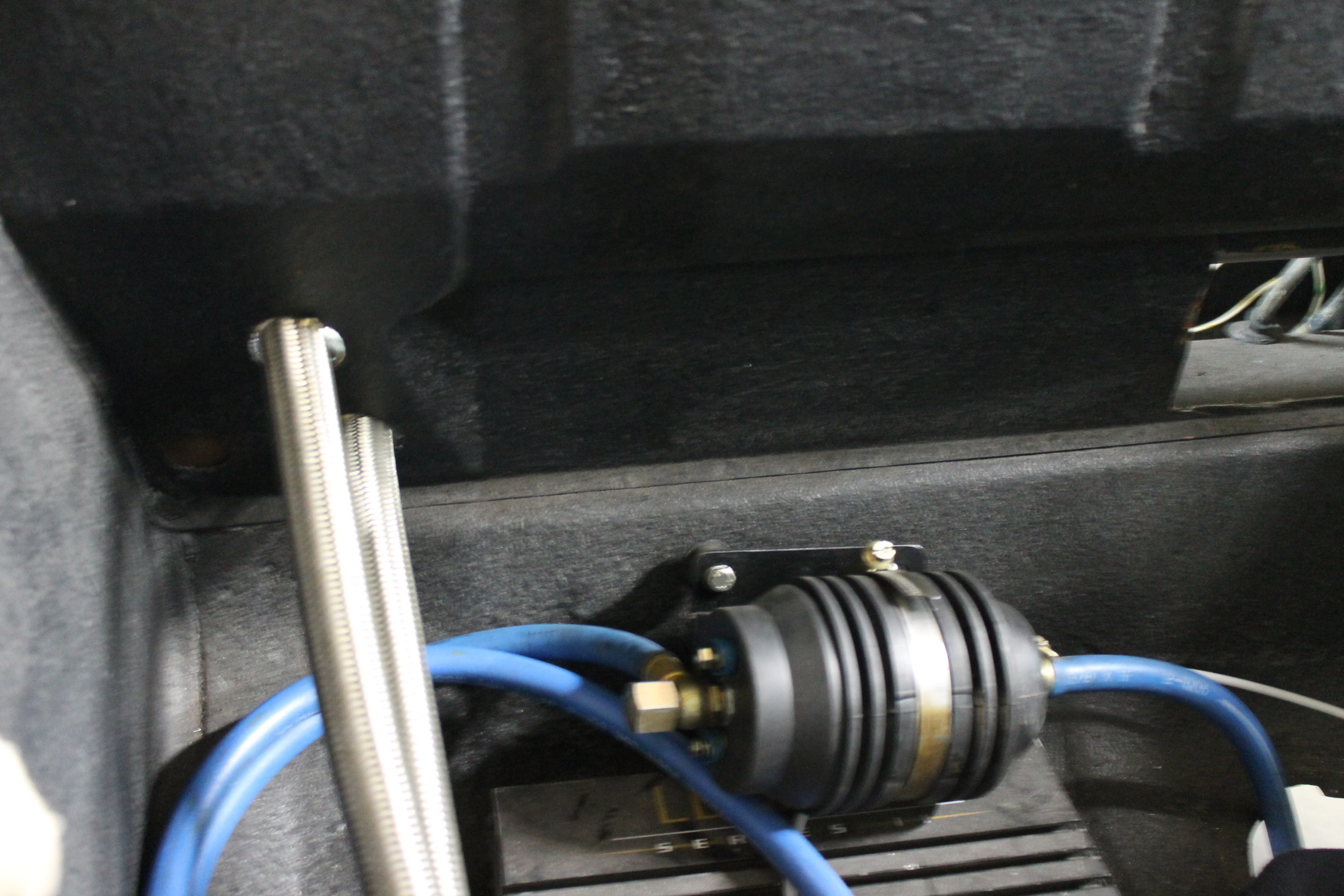

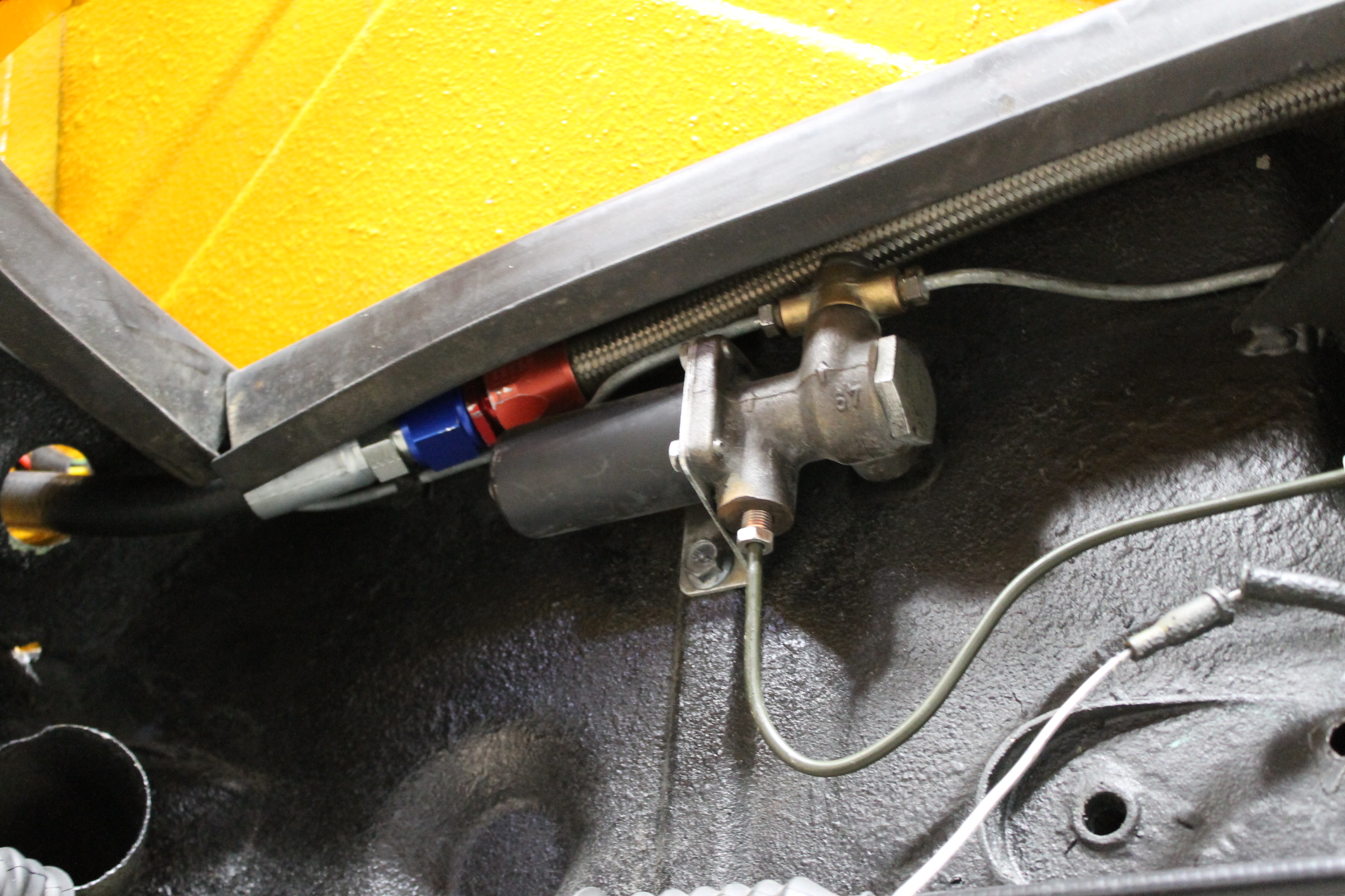

Working on the fuel system today.... What a pain in the ass these bulkhead fittings inside the tunnel are the biggest pain in the ass to connect.

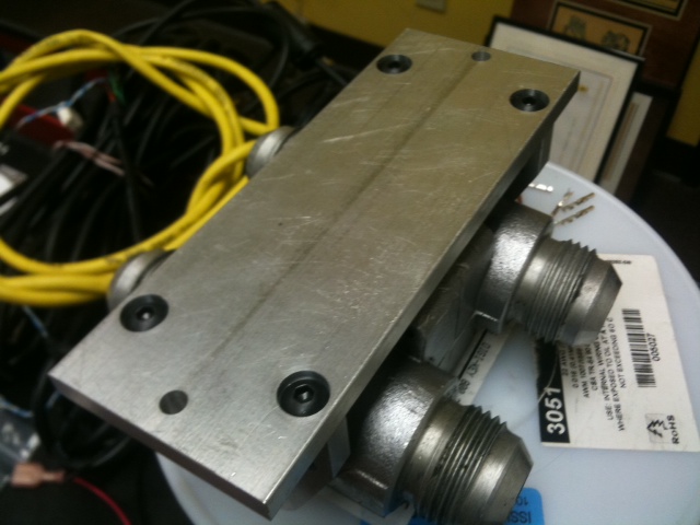

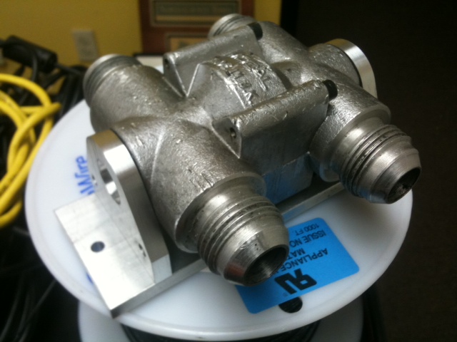

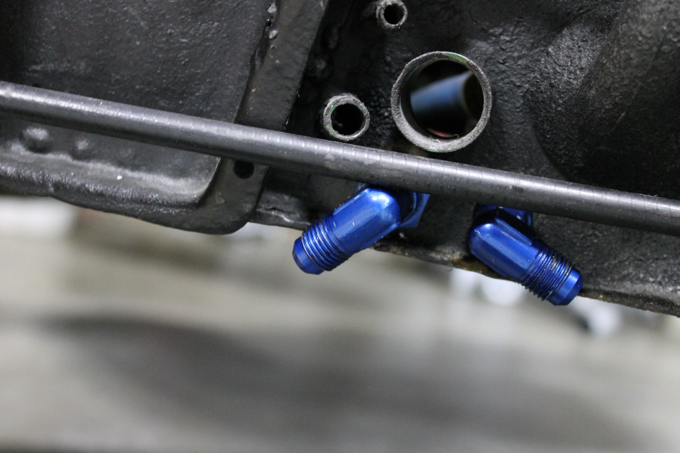

I never really liked the stock mount for the Mocal oil thermostat, apparently my Grandfather overhead this and surprised me with this!
